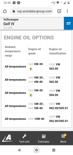

Andyrew Posted February 2, 2021 Share Posted February 2, 2021 Rocker cover Doesnt look like a ball ache in the pic but the discription sounds like a faff, so maybe thats for another time. Id dump the oil out and chuck some cheapo stuff in. Id guess 5w40 for this era of VW. Most VAG stuff seems to be that up untill 06 ish. You could drain the oil into a cleanish drip tray and have a look for any sparkle or clumped shite but id be surpised if the lack of changes has done much harm. Vince70 and stripped fred 1 1 Link to comment Share on other sites More sharing options...

Zelandeth Posted February 3, 2021 Share Posted February 3, 2021 To be honest, 3-in-1 would probably be an improvement on what's in there at the moment! I'd not bother too much initially - stick in whatever so long as it's about the right grade, run it up to get properly up to temperature, then drain it out. Check for any glitter in it. If it looks good, then change the oil and filter with the correct stuff. I'd then plan on changing it again after 100 miles, then keep an eye on the dipstick. Change it then at 500 miles or when it turns noticeably dark, whichever happens first. Then continue until it stays clean. Or the engine grenades... stripped fred, 95 quid Peugeot, Vince70 and 2 others 4 1 Link to comment Share on other sites More sharing options...
sloth Posted February 3, 2021 Share Posted February 3, 2021 that oils fine - ex vw tech here. however, vr motors are known for fucking timing chains, moreso when oil is not changed. i have a sad feeling youll change the oil a few times and then the chains and guides will let go. the sludge gets dislodged and blocks the tensioners. only true fix is to strip and clean and rebuild. if it comes good, it will need new spark plugs asap. otherwise it kills the coils and runs like cock. groovylee, Low Horatio gearbox, The Moog and 2 others 4 1 Link to comment Share on other sites More sharing options...

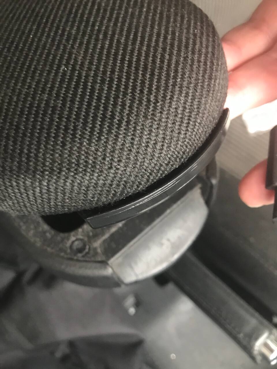

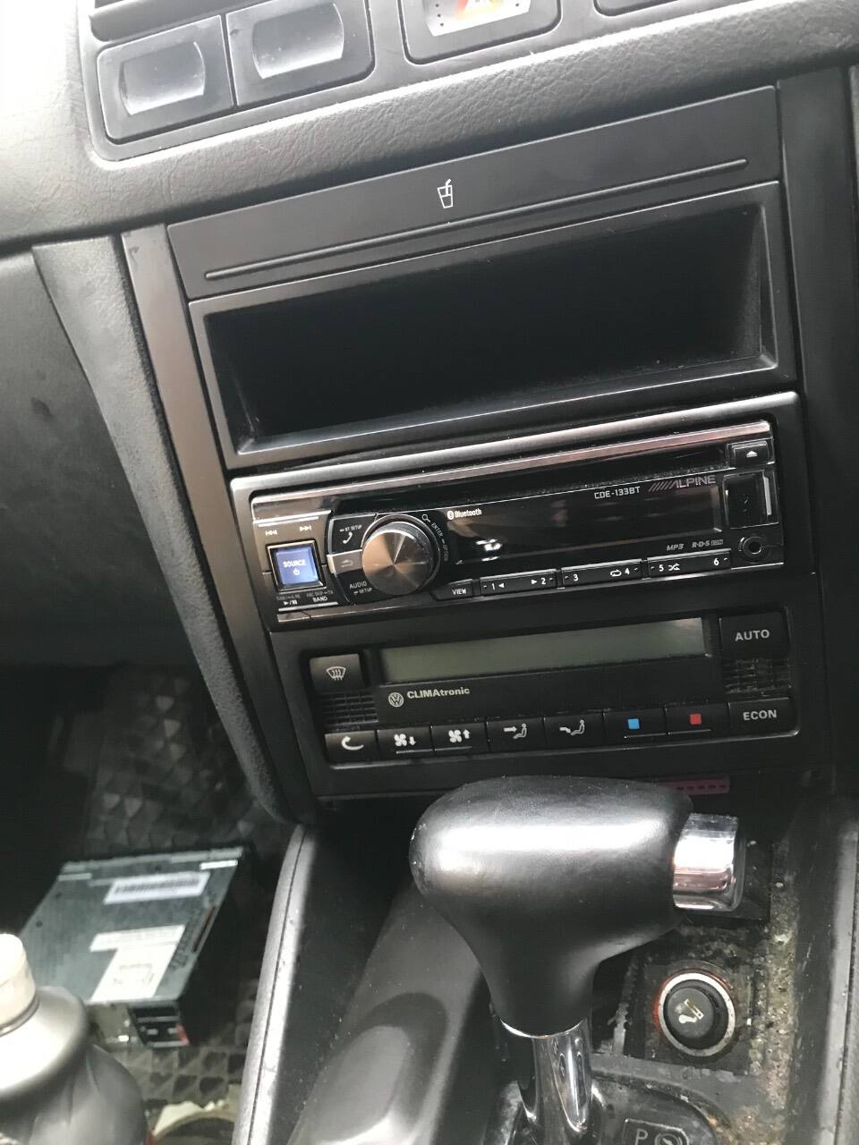

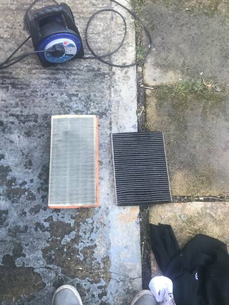

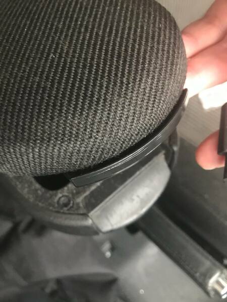

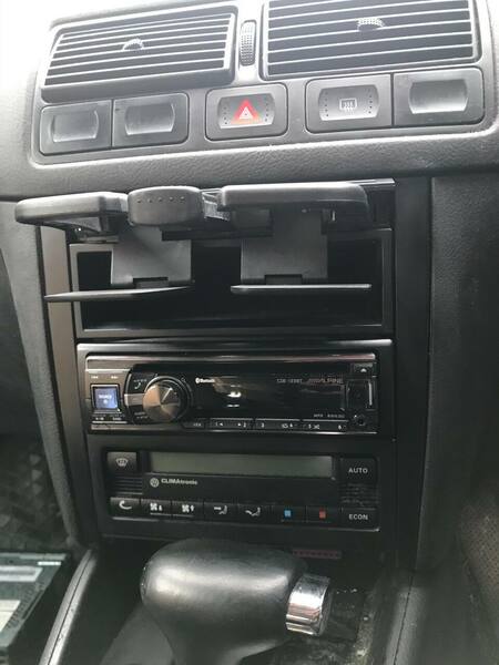

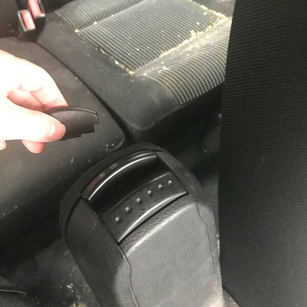

Vince70 Posted February 17, 2021 Author Share Posted February 17, 2021 I thought as it wasn’t raining I would fit the new battery today and while at it have another go at fitting the Bluetooth stereo and this time it works off the ignition and saves the presets which is a bonus I also changed the cupholders as the original one was stuck solid but the only problem the new one is a Chinese pattern part so has a very small gap and doesn’t fit as well as the VW original. While at it I also polished up the plastic around the stereo surrounding as I wanted to remove the scratched rubber coating. DVee8, Craig the Princess, Shirley Knott and 7 others 10 Link to comment Share on other sites More sharing options...

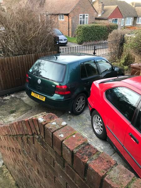

Vince70 Posted February 20, 2021 Author Share Posted February 20, 2021 Today I managed to get the car over to my place but it made a horrible noice when I went over the bump in the drive but hopefully I’ve not cracked the sump. So I think the first thing I’m going to do is pump the tyres up and give it a bloody good clean and pressure wash it underneath. So my driveway now looks like a 90s German warm hatch appreciation society gathering. I do prefer the E36 compact Ti to the golf though as it’s far more fun to drive. Tickman, FakeConcern, Dirk Diggler and 12 others 15 Link to comment Share on other sites More sharing options...

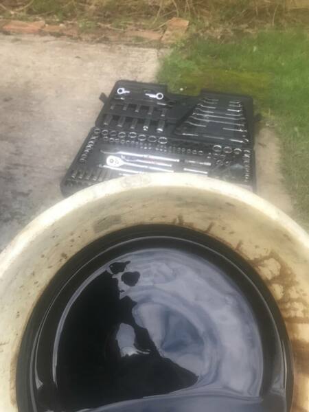

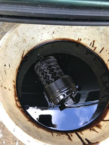

Dj_efk Posted February 21, 2021 Share Posted February 21, 2021 Post gory pictures of what comes out of the sump please. bigstraight6, Vince70, Lacquer Peel and 2 others 5 Link to comment Share on other sites More sharing options...

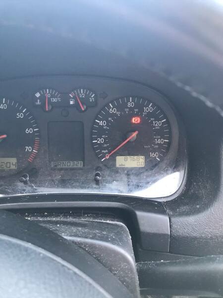

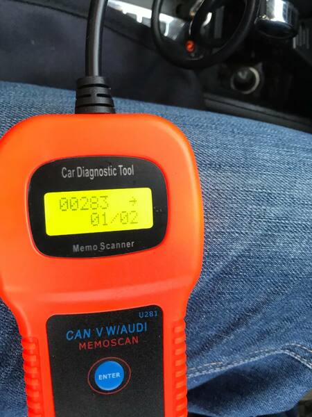

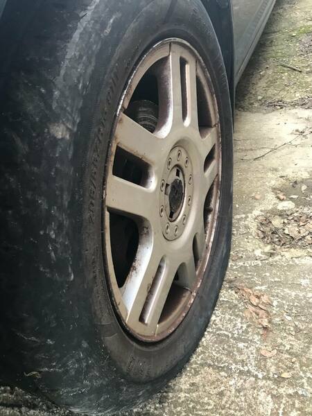

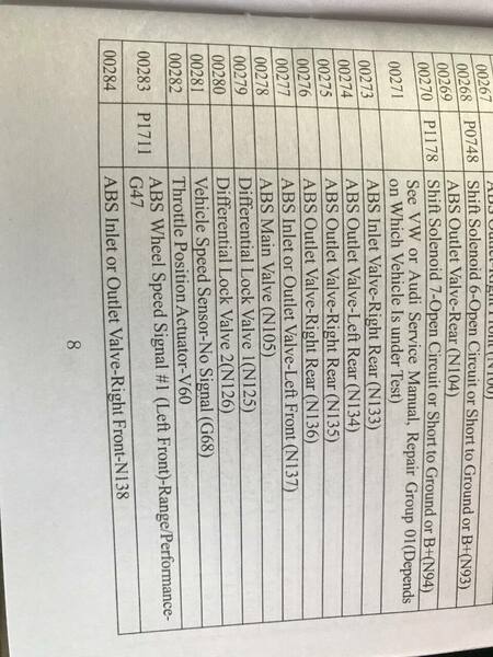

Vince70 Posted February 21, 2021 Author Share Posted February 21, 2021 Today I had a spare 10 minutes so plugged in a cheap Chinese £10 vag code reader I bought on eBay and it came up with two codes and wanted to find out why the abs wasn’t working. I’m still none the wiser but I reset the codes and now the Abs light is out which is a nice little surprise. stripped fred, 500tops and The Moog 3 Link to comment Share on other sites More sharing options...
Vince70 Posted February 21, 2021 Author Share Posted February 21, 2021 The 0068 code was due to a knackered battery by the looks of it and the 00283 was due to this tyre I think. I really don’t know how anyone could drive round with flat tyres and not realise but apparently it was serviced once a year as it went for an MOT lol. Link to comment Share on other sites More sharing options...
Low Horatio gearbox Posted February 21, 2021 Share Posted February 21, 2021 8 hours ago, Dj_efk said: Post gory pictures of what comes out of the sump please. +1 Show us the sludge! Sheesh, bit minging inside and out. Vince70 1 Link to comment Share on other sites More sharing options...
Vince70 Posted February 21, 2021 Author Share Posted February 21, 2021 13 minutes ago, Low Horatio gearbox said: +1 Show us the sludge! Sheesh, bit minging inside and out. I will do and it’s the only car I’ve ever got in with rubber gloves and wipes as it really is that minging. I’ve actually put a seat cover on the driver’s seat just to stop myself getting dirty. If the weather is good next week I will spend sometime giving it a good clean and I think the dirt has actually protected the seats from any wear lol. Low Horatio gearbox 1 Link to comment Share on other sites More sharing options...

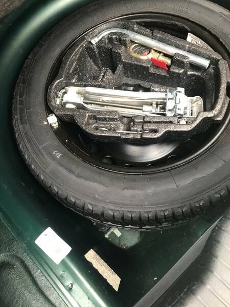

Vince70 Posted February 22, 2021 Author Share Posted February 22, 2021 Today I was going to give it a good clean but the weather has put pay to that. But I did have to find the locking wheel nut for Wednesday and was pleasantly surprised by the condition of the boot as the spare was a brand new Michelin tyre that’s never been out the cradle. Also I repaired the armrest today with a new button that only cost a couple of pound off eBay. spartacus, Low Horatio gearbox, loserone and 2 others 5 Link to comment Share on other sites More sharing options...

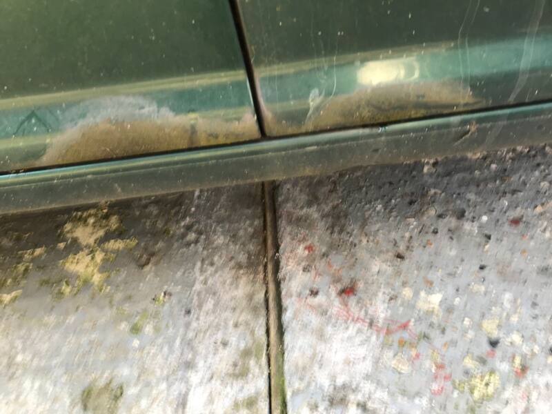

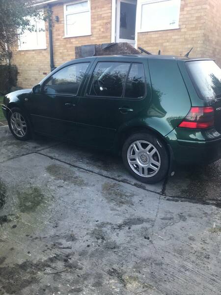

Vince70 Posted February 23, 2021 Author Share Posted February 23, 2021 Today I managed to get outside and give it a clean and was pleasantly surprised how good the bodywork was after 6 years of not getting a wash or polish. The car is absolutely rust free apart from a very small spot about 2mm on the rear door handle. The main damage was the clearcoat being damaged as the car was covered in seagull shite and used a bit of 2000 grade wet and dry on those and a bit of polish. Also while at it I changed the pollen and air filters. If the weather is good on Friday I will drain the sludge out the sump and if I get time change the plugs. I think what helped is I waxoyled the doors years back and it’s leaked over the years and protected the car. IMG_2750.MOV DVee8, Low Horatio gearbox, Dan302 and 10 others 13 Link to comment Share on other sites More sharing options...

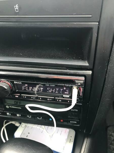

Vince70 Posted February 24, 2021 Author Share Posted February 24, 2021 I wasn’t going to work on the car today as I was just going to get the tyres done but in the end I steam cleaned the interior and also tuned the Bluetooth in to an old iPhone 6 64gb I rebuilt using old spare parts and it works a treat. The tyres were done earlier than expected so thought I would do the first oil/filter change but had to dig out the pela pump as I didn’t have enough ground clearance to get the sump plug undone. As you can see the old filter had collapsed but I can’t see any shiny particles in what came out around the filter but it was like gloopy tar. I’m not very mechanically minded and wonder if someone could tell me if the engine sounds okay Also it has trouble starting sometimes since I’ve changed the air filter but I’m not sure it’s one of those cars that needs your foot on the brake pedal when it starts as when you put your foot on the brake a light goes off when in park . Last time I had an Auto was my lovely reliable Rover 400 and don’t think I had to do it on that and that ran like clockwork. So the oil is a 5/30 magnatec with a top up of some cheap 5/30 I had knocking about and it’s doing the job of cleaning as it was black again after about 5 minutes. I thought the song title was ideal for this car lol. IMG_2804.MOV Squirrel2, GrumpiusMaximus, DVee8 and 3 others 6 Link to comment Share on other sites More sharing options...
