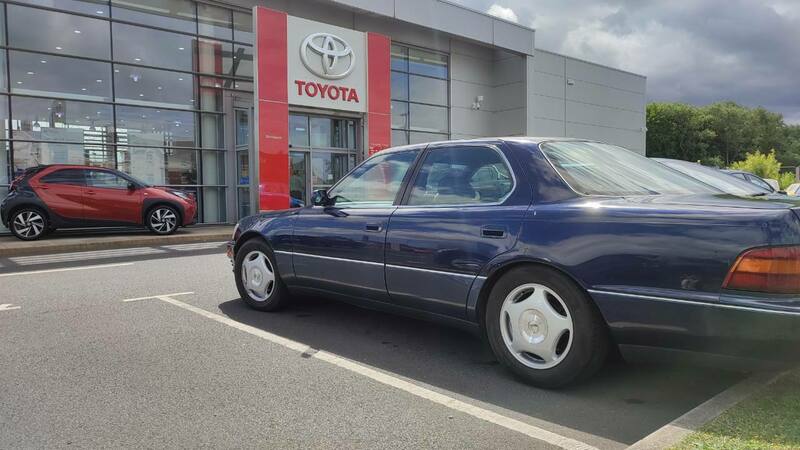

On the Toyota Celsior side: It runs again!🎉
After reinstalling the valve covers with new gaskets and sealant I've installed the starter and tested it just to make sure that I wouldn't spent hours reassembling things without actually working. Fortunately the car now started to crank over, thank god, anything else would have meant complete misery really. I've replaced the knock sensors while in there, each of which was obscenely priced despite being aftermarket and coming from Rockauto...
I've used this gasket kit specifically provided to dealers for a starter repair on an LS400, I got lucky and somehow found it on Ebay after reading the dealer instructions for doing the job in a random pdf I've dug up online, it had the part number in it, a part number that I don't think was ever made available to the public. To anyone finding this thread via google in 10 years time: 04007-06350 . You are welcome.
It came with everything I needed, plus a few extra gaskets for the EGR tube that (as it turns out) was not a thing on early Japanese market Celsiors. Which is a blessing as the EGR tubes are an absolute pain to replace, running down the back of the engine. I still have all the holes for the port drilled into the intake manifold but all of them are sealed off internally, pretty interesting.
Slowly putting it all back together, it's certainly an unusual intake manifold design.
And done (minus all the beauty covers). I refilled the coolant, checked for coolant and fuel leaks, couldn't find any so I thought it was safe to start the car.
Unfortunately I didn't take a video but the car started up almost instantly.🥳 Huge relief there as it meant that I can finally move it out of the way. However, since things went too well oil started pouring out from underneath the passenger side valve cover. Turns out one of the half moon shaped blanking caps Toyota also liked to use on their V8s (instead of a second camshaft coming out of the head) somehow got misaligned, causing the mating surface of the gasket to be slightly uneven. It's pretty interesting how much oil can pour out of a non-pressurized part of the engine...
Removed the valve cover again, spent an hour cleaning the sealant off everything, reinstalled it, hoping that it will all be sorted tomorrow when dry and I can move the car. Photo above was from the first try, it looks perfectly even there... On a side note, the replacement sparkplug tube seals were so tight that it shaved the rubber off of them while pressing them in:
At this point I replaced almost every component that would ever realistically break on this engine, minus the waterpump and timing belt. I sure hope that this means that this is the end of my engine woes and the car will behave from now on... I'll probably get it on my multi-car policy and book it in for an MOT soon then...

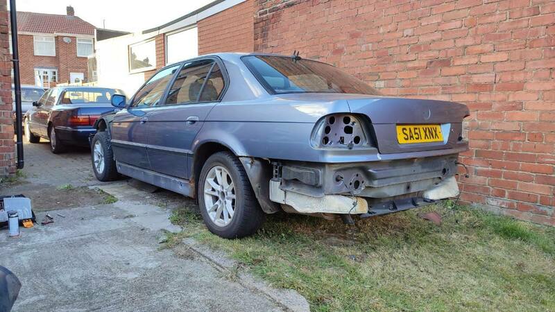

Once again its new car time! Only that its already f*cked.
As seen in the Glasgow Shiter needed thread last week a vehicle came up for sale in the Ebay tat thread that was hard to resist and required IMMEDIATE action. The main reason for that was that the asking price for the car was about as much as you'd pay for the set of wheels the car was standing on.  As you can imagine, the interest in the car was high and the seller not particular interested in anything but you showing up with cash, ideally straight away. The car in question was.......
Another BMW E38 7-Series! And its another 728i! This time however its the facelift, in Sport trim, with a few goodies that made the impromptu trip up to the South of Glasgow worth the journey. Thanks again to @cort16 for providing backup as its always fun* to show up in a somewhat rough neighborhood, with a stack of cash, not knowing what to expect. Fortunately the seller turned out to be a nice chap who for whatever reason negotiated the price down despite me saying that I'm perfectly fine with all the issues the car has considering the money he wanted for it.
And oh boy how many issues it has. The ABS light came on during a short test drive, accompanied with a pretty serious sounding metal grinding noise from the passenger front corner. I initially thought the sensor wire might be the problem. I had a look today. Turns out the dustshield is just losely hanging behind the brake rotor, and with the wheel bolts removed, there is nothing but the caliper keeping the rotor in place...
The car also has an check engine light. Apparently the previous-previous owner installed an M50 intake manifold, a popular mod for the M52 to gain a little more peak HP. That must be triggering a code. The car also runs a little rough on and off, it seems to happen at random times so Im not 100% sure what it could be without reading the codes. Aside from that the cats are missing (naturally) and every single panel has rust, excluding both front wings which got replaced with ones in the wrong color. The interior has the typical few broken bits as well.
None of that matters though as the car was bought as a parts donor. I need quite a few myself bits, and many of the Sport trim specific parts are easy to sell for decent money. I initially just wanted to take the wheels and Chrome Line related trim pieces and put the rest up for sale for cheap (if anyone still is interested after reading this, let me know...) but I honestly think that this car really only has its value in its parts. As you can see I've dug into things quite a bit already:
I'll continue to strip the easy bits and put them up for sale in the usual FB groups, if anyone needs anything thats available please let me know. The rest of the car will be sold as one (driving) piece, ideally its gone in two weeks as I need the space back.

The Celsior received a new battery, fresh oil change and is now insured and at Scaryoldcortina's garage to hopefully get an MOT soon. I popped by the Toyota dealership to order a few bits for it, unfortunately a bolt was the only reasonably priced/available part on my list, not too surprised so Amayama it is again. It was also the first actual drive in the car to find out what might still be needed.
There is some suspension clunking coming from the front which will most likely be front strut bar bushes that are tired (everything else looked surprisingly solid while I was underneath the car), the cheapo ebay special Maxpeedingrods (without an "s") coilovers do surprisingly well although I wouldn't be surprised if they are actually contributing to the suspension knocks I hear... The car rides fairly comfortably but has a certain bounciness to it that most likely is the result of less than ideal spring/damper tuning. I'll hold on to them for a little while though, the BC coilovers I got need a bit of tidying up anyway.

More improvements have happened to both bimmers. The blue 7 received the chromeline sill covers which really make the car feel that little bit more special and expensive when opening the door. I've also replaced one of the front bumper corner trims, still have to find a good one for the driver's side.
My other half's 7 received new bumper trim in the back, I also replaced the faulty PDC sensor while in there which means this car will hopefully not receive any further scuffs after its hard life in London. I will send of the cluster for the typical pixel repair when I'm back, get a new tire ordered to replace the spare currently on the car and replace the radio which suffers from the same pixel errors. It's pretty much in use now, if you want to buy the 2015 Fiat 500 Lounge that it replaced, let me know.
The ivory Mark VIII has finally received some love again. It's been stashed away for the last 2 or 3 years which really hasn't helped it cosmetically (nor electrically, the replacement air suspension relay died while in storage...). I've given it its first good clean inside and out in years and god what a difference it makes. I still have to stick the badges back on but the Ivory pearlescent paint looks brilliant in the sun and underneath lights. Realistically it would benefit from a respray as the clearcoat is going in places, I think its still a few years before that really needs to happen though.
The engine is a bit cleaner as well again, and the chrome 10-spokes polished up nicely with a bit of steel wool and elbow grease.
The A6 Avant finally received its set of OEM 5-spoke alloys (which I bought after Christmas for a crate of lemonade, see above). Not before getting two punctures on one side of the car though. I'm not sure if someone was mad about me parking in a particular spot for a couple of weeks or what but that really doesn't seem normal. Good thing these winter tires were close to the end of their life anyway...
The black Lincoln got out of storage as well (the E39 that needs it's sills welded will go into it's place instead until I have figured out who can do a 100% decent job) and will stay in Germany for its upcoming TÜV inspection. It's only insured from March to October so I'll probably use it for a week here, leave it at my parents, get it inspected/oil changed and then collect it again sometime next year.

Not much has happened recently. Been away for my brother's wedding in Germany, which was immediately followed by a work trip, at the end of which I immediately caugh Covid. I'm again gone for 2 weeks from the end of this week for actual holidays as none of the things before were planned when we booked them...
Nevertheless, FOTU is approaching fast so I need a set of wheels for the Corona EXiV, the tires are ancient and the journey far. The plan was to go for a set of period correct Japanese 2-piece alloys. However, as these are few and far between as most of them were 4-lug, and VERY expensive.
So with that being said, does anybody happen to know of a set of 5-lug Carina E or 1994ish Celica alloys that could suit the car? I'd like to stick with factory Toyota alloys of the period so all suggestions are welcome, even if you don't own a set yourself.
Bolt pattern is 5 x 100 54.1 center bore
For reference, these are the ones you could get originally:
