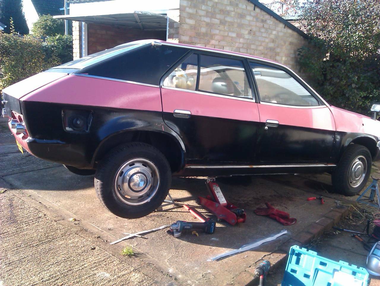

  3. Today the weather was absolutely stunning. Got my tools out to crack on with the sill repair on the Princess, really the only difficult bit of welding (that I know about) left to do, everything else is minor cosmetic things like wheel arch lips that are easier to deal with. Just lately the car has been letting off a faint whiff of petrol. It always has, to be fair, throughout my decade or so of ownership. I kept looking for leaks and wet patches and couldn't find any, the lines and tank were always dry so I always put it down to Old Car Stuff. That meant I didn't worry about it too much today when welding up the sill. I had already replaced the very trailing edge of this sill some years ago, that repair is still sound. The damage is along the rest of the sill for the bottom inch or so. It looked frilly but more alarmingly is that when I actually cleaned it up the outer and inner sill weren't attached which only became apparent as I started removing the rusty strip. The cause of the rust is that in the past before I got the car, someone cut the original outer sill off but left the bottom inch of it attached to the inner sill. Luckily, the inner sill is still really solid so no need to do work there, and it explains why there was nothing to see needing repair underneath the car. They then slapped a new sill over the top of everything and didn't attach it very well along the bottom edge. They also didn't put any protection inside the sill. How it's lasted as long as it has I don't really know. Some years ago I salvaged an outer sill from an orange Princess I used to own that was too rotten to save. Fortunately, it had a brand new outer sill attached on one side which ended up being a perfect donor for this repair, what was left being just long enough and the right section to match what I needed. It took me longer to clean the original outer sill off the car than it did to prepare the patch and then I set to welding it in. Still going smoothly I made a start grinding off the knobbly bits of welding since I was having to do this laid on my back so the welding looked pretty ugly, and the petrol smell was getting quite strong. I still couldn't see anything amiss, there was just some water dripping out of the drain at the front... wait.. what drain? I very quickly downed tools. While the car was jacked up with the nose down, the front hard line had started to drip fuel at an increasingly alarming rate. All of the hard fuel lines on this car have underseal on them, have the entire time I've owned it, and it's been through numerous MoTs with no bother on this front. Today was the day it failed. Once back on the level the leak slowed and then stopped, which was a little odd. It was now too late to finish the grinding and any pinhole chasing so I threw some paint on and ordered some new copper fuel line, rubber fuel line, clamps, and pipe bending tool all of which came to about £35. One job I did want to do is drop the fuel tank so I can refit the rubber grommet around the filler neck and repaint the filler pocket properly. It was a job I was saving for another time but since I'll be replacing the whole fuel line I might as well do it at the same time and then I'll finish the grinding and welding on the sill once I know things are fuel tight again. I feel like I've had a bit of a near miss today with this one.
  4. Hecking sun came out! Princess has assumed the position so I can trim away the frilly bits of the sill. Cause of the frill is someone in the past had left the bottom inch of the original sill still attached to the (remarkably solid) inner sill and then just slapped a new outer sill on top of it all. No protection inside this sill either, I'm astonished it's lasted this long without bigger issues really. Just having some lunch and then we shall glue it all back together again.
