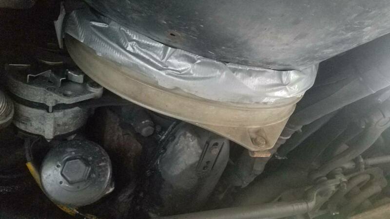

mat_the_cat Posted January 1, 2022 Author Share Posted January 1, 2022 I confess that I've been bodging something on this for years. Between the fan shroud (mounted on the engine) and the radiator shroud there is a small gap, where a rubber seal normally sits to accommodate movement. It's never had one in my ownership, so I've used duct tape to provide some kind of seal for the airflow. This is a PITA when changing the cambelt, so when I found one for sale I snapped it up. A bit fiddly to stretch into place, although still easier than tape which does its best to stick to everything other than what I want it to stick to! Once that was done I bolted up my new undertray. It's still missing the piece linking the front and rear sections together, but that will be easy to fabricate from an aluminium sheet. Matty, Dyslexic Viking, GrumpiusMaximus and 5 others 8 Link to comment Share on other sites More sharing options...

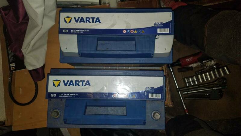

mat_the_cat Posted February 22, 2022 Author Share Posted February 22, 2022 Proof that things just aren't made like they used to be!! I got 8 years from my last starter battery - this one has only lasted 7 Still, I can hardly complain, so out with the old and in with the new. Happy cranking once again! 30 mile test run went ok, so hopefully no imminent problems this year. cobblers, bunglebus, GrumpiusMaximus and 5 others 8 Link to comment Share on other sites More sharing options...

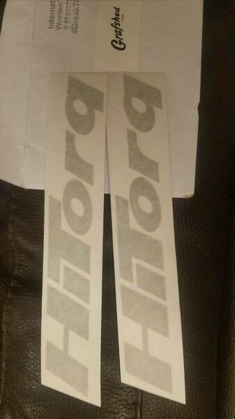

mat_the_cat Posted March 6, 2022 Author Share Posted March 6, 2022 This has always been missing the correct grille badge whilst in my ownership, so I think it must have been replaced at some point. It's been a minor annoyance,Ā but never seen one come up for sale. Next best thing is to get a sticker made! Another owner did the donkey work a while back, so I contacted the seller and they still had the design, fortunately. It feels like somewhat of an ironic claim, when compared with a modern van, but was pretty impressive for the era. I've got a few of them so when I tidy up the plastics I can put a new sticker on then. But for now it's an improvement chodweaver, Asimo, cobblers and 9 others 12 Link to comment Share on other sites More sharing options...

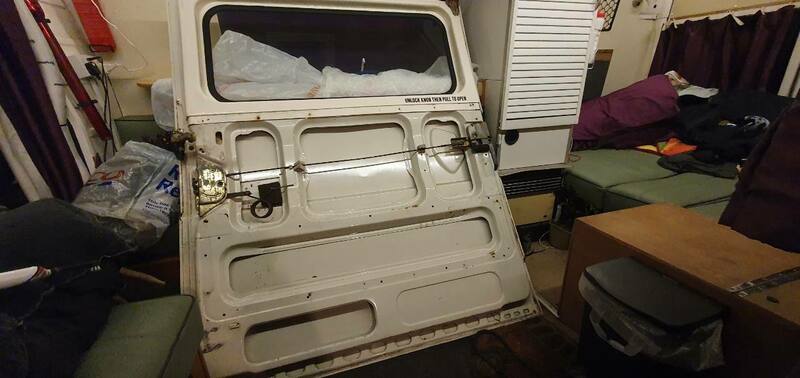

mat_the_cat Posted April 22, 2022 Author Share Posted April 22, 2022 Just returned from a week away - campsite was pretty quiet for an Easter BH weekend. Clear skies, plenty of sun, but a cold wind. And lastly, the reason for the trip! It was a bit cramped with the door inside, but only the one night like that fortunately! Looks in pretty good condition, although the exterior paint has what some people would describe as patina. I'd say it'sĀ very thin and starting to rust stain, so not quite a bolt-on swap. 1000 miles, and I'd like to say it didn't miss a beat, but there is something not quite right. You might describe it as a misfire, or surging perhaps - at certain rev/load combinations it doesn't run perfectly.Ā At 2k rpm under load it will chug a bit- varying rpm with a constant throttle position. If you ease off from full throttle, or drive through the problem to higher revs, all settles out again. Similar at 2.5k rpm, but only with a light load, i.e. cruising at 50mph. A light load at other revs is fine, and if you accelerate, it stops the unevenĀ running.Ā So it's fairly easy to drive around the problem, but it's not right. I'm puzzled as to the cause, but probably wise to get injectors overhauled,Ā and possibly the pump. I realised while we were away the the May MOT I clearly remember last year was in fact April, so it ran out if test mid-trip!Ā Not using it for a couple of weeks will give a bit of time to sort out any reliability issues.Ā I've ordered a few more bits and pieces for it, as it's amazing what you remember when you're actually living in the vehicle for a while. Dick Longbridge, GrumpiusMaximus, Coprolalia and 3 others 6 Link to comment Share on other sites More sharing options...

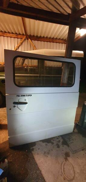

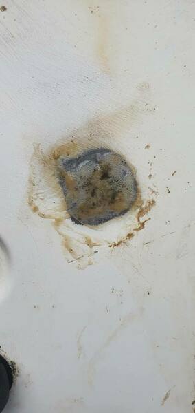

mat_the_cat Posted April 25, 2022 Author Share Posted April 25, 2022 Putting the mechanical issues on the back burner for a moment, and onto the bodywork. This is the picture which sold me the door! Am I mad, you might think, to drive 700 miles at 25mpg for this! Quite possibly, but there is method in my madness. Firstly, the door is very straight. Secondly, there is no crustiness around the edges. And it still has the original stickers above the handle, suggesting factory paint. I'd much rather treat a bit of surface rust than rot, or who knows what behind a load of filler and a shiny paint job. I'm painting the lower half anyway, so not a massive deal to sand back the thin paint and rust. Here is the door in all its glory! You can see what appears to be a rust trail below the window, and my heart sank slightly. Was the whole frame rotting out and leaking? So I started to clean away the grime to see how bad it was. It's taking a helluva lot of elbow grease, but it's starting to look like the 'rust' is actually just lichen! Still a long way to go, but I can afford to be more aggressive with the lower half, so I may use a sanding pad. Has my gamble paid off? RayMK, Back_For_More, cobblers and 9 others 12 Link to comment Share on other sites More sharing options...

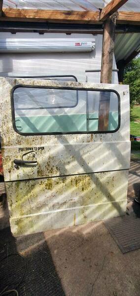

mat_the_cat Posted April 26, 2022 Author Share Posted April 26, 2022 I think I'll call that a win! One small spot of rust, and that's it š Although half a day to get to this stage...time for bed now. coachie, Dyslexic Viking, Dave_Q and 14 others 17 Link to comment Share on other sites More sharing options...
