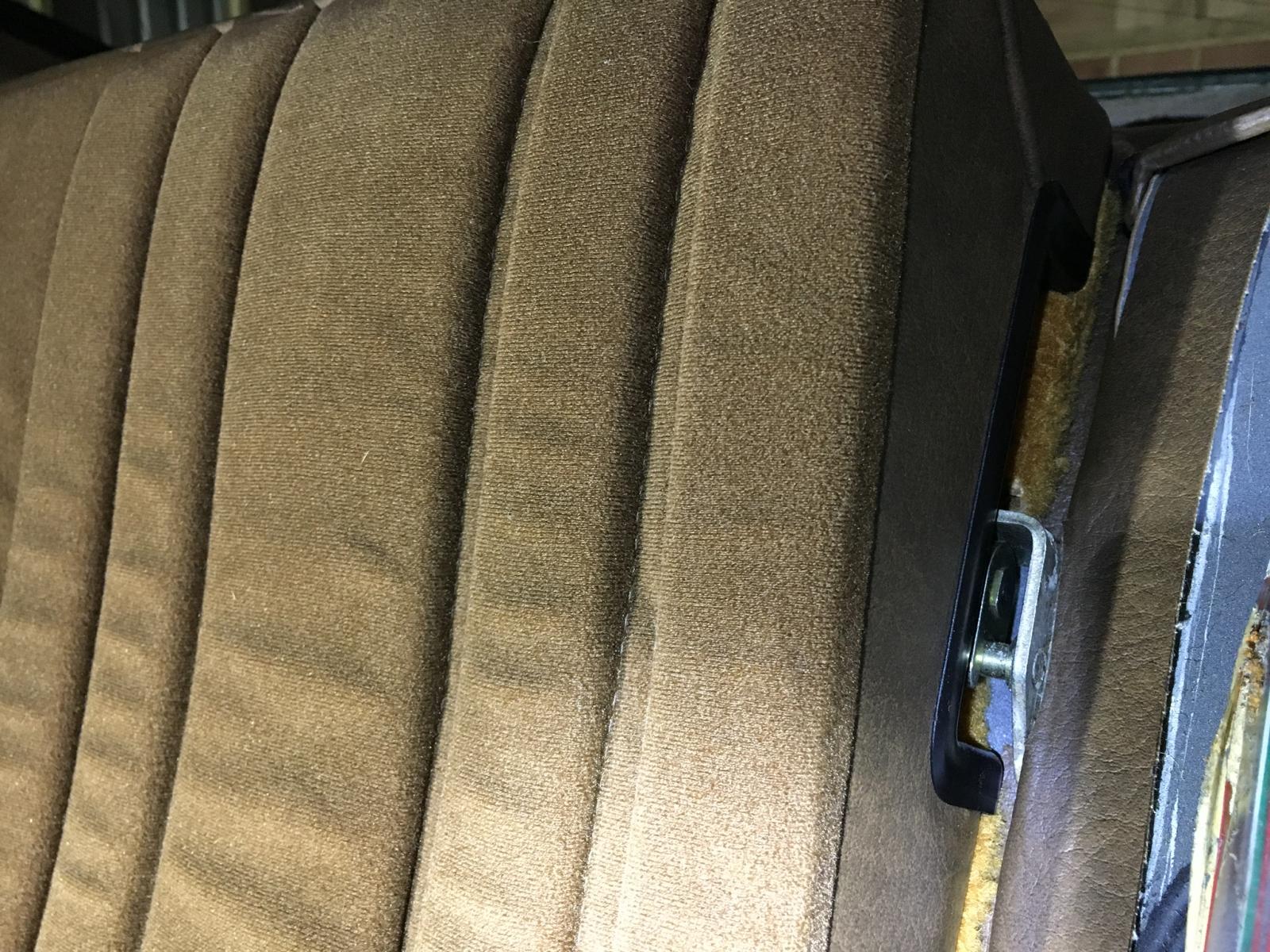

Skizzer Posted January 3, 2018 Author Share Posted January 3, 2018 The seat back doesn't lift out as I'd hoped - there's no room for the latch to clear the striker without fouling the housing. You can sort of see it in the picture. This was a setback, and led to swearing. However there was enough movement in the seat back to get a wrench under the parcel shelf and lever it free on one side without doing serious damage to it, which meant I could just get my fingers to the seat back release handle. The handle is a big recessed lever that you have to slide through a 180 degree arc - it's completely over-engineered. More swearing happened but I got there in the end. So finally I'm in. Actually releasing and then fixing the boot mechanism is a job for another day. This rings a bell actually (mine is cort16's old one). Turning the key left and right while operating the handle. More of a quick, flicking turn of the key...Good suggestion but already tried it, to no avail. Asimo, M'coli, SiC and 21 others 24 Link to comment Share on other sites More sharing options...
