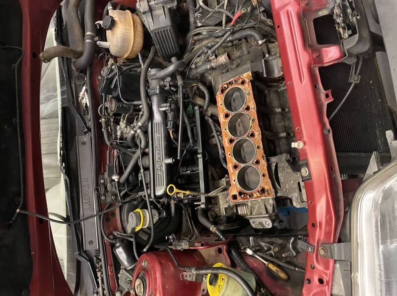

Kiltox Posted April 20, 2020 Author Share Posted April 20, 2020 Well, the head’s off The Moog, Skizzer, jumpingjehovahs and 7 others 10 Link to comment Share on other sites More sharing options...

Kiltox Posted April 22, 2020 Author Share Posted April 22, 2020 So the head’s off, and it looks like there is a sign of a HG leak - the sign of dried KSeal on the valves is the biggest indicator. Original gasket I reckon, so that’s a good sign when you’re looking at a KSeries, right? Fair old amount of work still left to do before she’ll drive again - long waits for parts and consumables isn’t helping but there are far worse things going on right now!! Jenson Velcro, johngarty, Angrydicky and 4 others 7 Link to comment Share on other sites More sharing options...
Isaac Hunt Posted April 22, 2020 Share Posted April 22, 2020 Good progress. When I did our MGZR, I left the inlet manifold as you have done. I left the exhaust manifold in situ, but several ways to skin the cat. i used a cam locking tool but wasn’t aware that a crank lock tool was avail, so didn’t use one. the elastomer gasket ‘may’ have been replaced. Not everyone uses an MLS gasket. I read that the MLS gasket is more sensitive to exacting liner heights. I used a BG Gaskets Elastomer gasket and later heard from an ex factory engineer who worked on K Series that the BG Gaskets are the best. Mine had been on for 55K and 6 years. watch the tensioner, I was told by a MG specialist that the HBOL actually shows the tensioner installed incorrectly. Our car was indeed installed incorrectly and it was a causing tensioner failure. i installed as I ‘was told’ and again, that was 55k ago. i’ll see if i’ve got my ‘notes diagram’ and take a photo. Kiltox 1 Link to comment Share on other sites More sharing options...

Kiltox Posted April 23, 2020 Author Share Posted April 23, 2020 Thanks - those notes seem to be for the automatic tensioner though I believe some people jam a screwdriver into the flywheel rather than using the crank lock tool (and some don’t bother I guess) - each to their own. The tool I actually used is for a Ford because the Rover one I ordered is in Royal Mail’s covid limbo... Link to comment Share on other sites More sharing options...
Isaac Hunt Posted April 23, 2020 Share Posted April 23, 2020 Yes, notes are for an automatic tensioner. I don’t know what year they changed Link to comment Share on other sites More sharing options...
Kiltox Posted April 23, 2020 Author Share Posted April 23, 2020 Just now, Isaac Hunt said: Yes, notes are for an automatic tensioner. I don’t know what year they changed When I ordered the kit I was under the impression that only really early stuff has a manual tensioner and given 98/S is late for a 216 cabriolet I thought they’d have changed over. Alas, I was wrong. Isaac Hunt 1 Link to comment Share on other sites More sharing options...
St.Jude Posted April 23, 2020 Share Posted April 23, 2020 9 hours ago, Isaac Hunt said: the elastomer gasket ‘may’ have been replaced. Not everyone uses an MLS gasket. I read that the MLS gasket is more sensitive to exacting liner heights. I used a BG Gaskets Elastomer gasket and later heard from an ex factory engineer who worked on K Series that the BG Gaskets are the best. Mine had been on for 55K and 6 years. I've read this about liner heights. Sometimes in engines that have overheated the liner can slip. But there is a tolerance (as with everything) of a few imperial things of a thingymabob. Interesting what you mention about the BG Gaskets Elastomer gasket. I suppose these gaskets would work without a problem up until an overheat scenario. But how likely are K-Series engines liable to get to this point if you switch to a PRT instead of the normal thermostat? Link to comment Share on other sites More sharing options...
