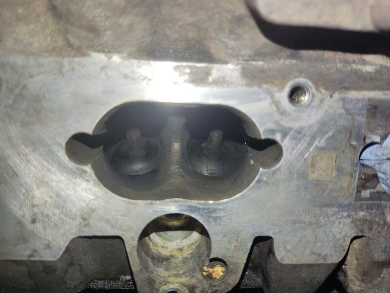

Dave_Q Posted December 8, 2023 Author Share Posted December 8, 2023 As above I decided to get on with getting the inlets cleaned and the injectors sent off before places close down for Christmas. As ever, getting the inlet off was something of a pain. Most bits weren't too bad to remove but I had to get some new 1/4 drive stuff to access some of it. This bolt which holds a support bracket to the block was the worst, you can't fit 3/8 extension through the gap nor is it quite straight. The inlet ports look about right for the mileage, have seen worse TBH. I've ordered some walnut dust and a shit gravity blast gun, I'm gonna give it a go with my little 22l compressor. I reckon it will work, albeit slowly. Expecting to hear back from the injector people today, kinda hoping they find something wrong on cylinder 1 as none of these look particularly worse than each other for carbon. CGSB, beko1987, J-T and 6 others 9 Link to comment Share on other sites More sharing options...

Dave_Q Posted December 17, 2023 Author Share Posted December 17, 2023 Some progress. The £12 blast gun was, probably predictably, shite. It did blast stuff out but the size of the thing meant I couldn't point it where I wanted to. I bought a Draper kit which is pretty much a plastic bucket with a hose attached to the bottom and this was much better. It still wasn't amazingly powerful but it shifted the majority of the build-up. I got round the lack of oomph by scraping, then blasting, then pouring carb cleaner down and scrubbing with a little brass brush on a drill, then repeating, Sounds long but was about 30min per cylinder. Injectors came back with a clean bill of health, they apparently passed the flow test before cleaning but have had new filters and seals and a good clean anyway for £80 all in from Bob Beck Fuel Injection on ebay. Got to pick up some gaskets and stuff tomorrow then throw it all back together. Fabergé Greggs, Back_For_More, SiC and 5 others 8 Link to comment Share on other sites More sharing options...
