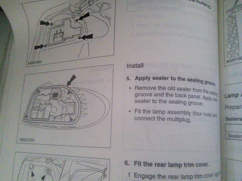

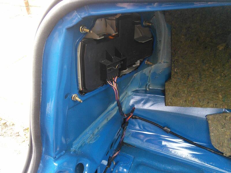

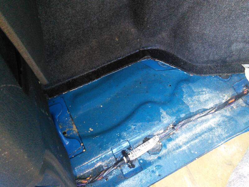

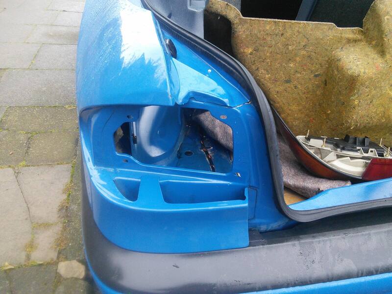

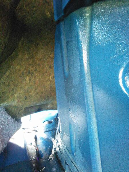

egg Posted October 22, 2019 Author Share Posted October 22, 2019 Boot leak is getting worse... Let's strip things down. Bit mouldy here The highest point seems to be the side of the strut mount, or is that just condensation? I have seen this happen to others you see Anyway, let's get the light off That's thick old sealant. What type of sealant should I use to reseal? @sierraman will know... Link to comment Share on other sites More sharing options...
sierraman Posted October 22, 2019 Share Posted October 22, 2019 Any really, I’ve always used clear silicone sealant. A bead round that usually sorts it. Sometimes they can also leak through the rear wiper grommet, it goes hard and the wiper spindle wears it out. Worth checking that, a new OE one is a few quid. Also make sure you have a boot floor left, the later ones are much worse for this but I’ve had them where the spare wheel well was perilously thin, a whack with a hammer and it’s be through. egg and BorniteIdentity 1 1 Link to comment Share on other sites More sharing options...

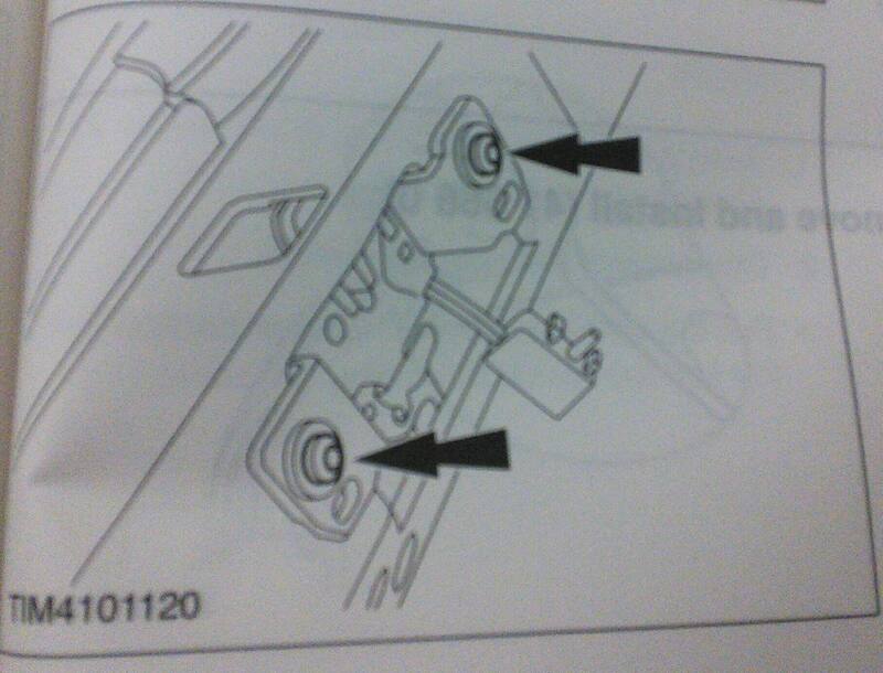

egg Posted October 22, 2019 Author Share Posted October 22, 2019 Thanks. Spare wheel well is dry, luckily. Just tried adjusting the boot latch - but gorilla'ed one of the torx and stripped the thread, what a donkey. So that will have to stay where it is. Should have climbed inside the boot to get a better angle. Apparently moving the latch down can tighten the boot seal. But using a watering can doesn't reveal any water getting past the boot seal anyway. Also popped the side vent off (inside the rear door) seems dry enough - so probably not the source. So, re-seal the light and hope... Should have been doing this in the summer. I changed the wiper grommet as a precaution last winter. Link to comment Share on other sites More sharing options...

sierraman Posted October 22, 2019 Share Posted October 22, 2019 Word of warning... if you use PU sealant (tigerseal etc) you’ll pretty much have to smash the lenses off to take them off. You access the bulbs from the inside but you never know. Chances of the silicone damaging the steel are very very minor, I’ve done this repair on these cars many many times and never had corrosion as a result. At one time you were able to replace just the seal but chances are supplies of those now will be useless. You could run a bead of sealant round the lens (off the car) then let it cure then refit the lens. But that’s a less than ideal way. Link to comment Share on other sites More sharing options...

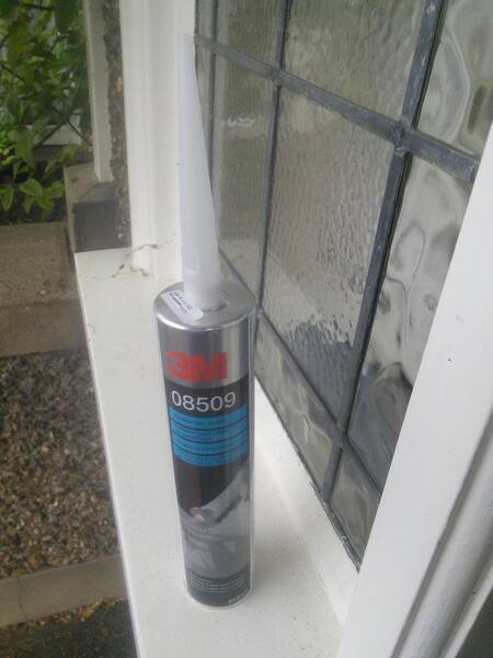

Ben_O Posted October 22, 2019 Share Posted October 22, 2019 Personally, I would just get a tube of non setting windscreen sealant. As has been said, avoid any adhesive sealants as they are a little too permanent. I use a non set by 3m and it marvellous for sealing up without actually bonding. Goes nicely round door apertures under the rubber seals too. Run a nice chunky bead in place of the existing stuff and when you bolt the lamp up, it will squidge up and seal properly. Cheers Ben egg 1 Link to comment Share on other sites More sharing options...
egg Posted October 22, 2019 Author Share Posted October 22, 2019 @Ben_O - this one? https://morelli.co.uk/3m-windscreen-sealer-325ml Thanks. Link to comment Share on other sites More sharing options...

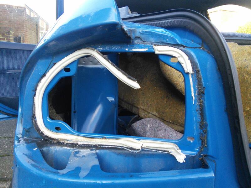

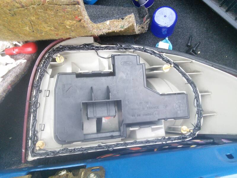

egg Posted October 24, 2019 Author Share Posted October 24, 2019 I cleaned up the whole area I got some sealant I applied, I did some more after this, but time will tell if it was enough I've left the boot in bits, and now we await some rain to see if it is ok. By the way this isn't bodgery, it's the approved Ford workshop manual approach RobT, mrbenn, Skizzer and 1 other 4 Link to comment Share on other sites More sharing options...
Ben_O Posted October 24, 2019 Share Posted October 24, 2019 Yep. That's the one. Ben egg 1 Link to comment Share on other sites More sharing options...
Ben_O Posted October 25, 2019 Share Posted October 25, 2019 Just having another look on a computer screen instead of phone and the only thing I would have done differently is to have cut the plastic nozzle down on the tube of sealant so that you get a neat continuous chunky bead of sealer. The way you have done it should be fine though but if there is any slight water ingress, then it might be worth cleaning it off and going for the chunky bead instead. Cheers Ben Link to comment Share on other sites More sharing options...
egg Posted October 25, 2019 Author Share Posted October 25, 2019 Yeah, I though about that too Ben, just after I started, but then it's quite a narrow channel to get the sealant in, which is why I carried on with the small nozzle. I need to pop outside and check it, as we had a bit of rain yesterday. Link to comment Share on other sites More sharing options...
