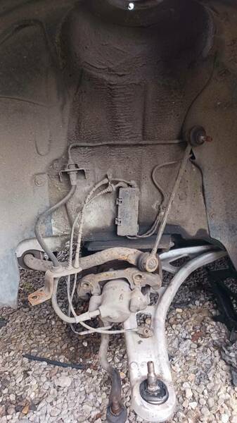

I had a day off work today - it was a "free" day, we were given an extra day's leave as a Christmas present but it had to be taken in December or January.  I treated myself to a lie-in, then pottered about for a bit.  I finally poked my nose outside at about noon, and found that it wasn't actually that cold in the sun, although my hopes of going for a bike ride were dashed because the bits of road that hadn't been in direct sunlight were still covered in ice.  So I decided to jack the BMW up and see if my newly-acquired rattle gun would be able to undo the strut pinch bolt.  It wasn't.  It took a while as my compressor is a bit feeble so will only run the gun at full whack for a few seconds at a time before I have to stop and let it catch its breath, but I gave it enough ugga duggas that if it was going to come undone it would have done, and it didn't budge.  So I'm going to have to get the breaker bar on it, which is probably going to snap the bolt like it did the other side.  Great.  The shock is proper knackered though so needs doing.
I then jacked the other side of the car up and did some more dismantling, ready to hopefully fit the replacement hub and strut tomorrow.  Everything that needs to come undone has come undone - the only potential stumbling block will be recalcitrant ball joints, I didn't get as far as digging out the splitter today as the sun went behind the houses and it suddenly got very cold.  The only casualty was the bolt holding the ABS sensor into the hub knuckle, which snapped off as I assumed it would, but the sensor came out of the hub easily enough and I'm sure I have a bolt in my stash that'll fit the new hub.
Tomorrow is supposed to be slightly warmer so hopefully I'll be able to crack on.  Sunday should be milder still but windy enough to blow the car off the jacks so I might not get much done then.

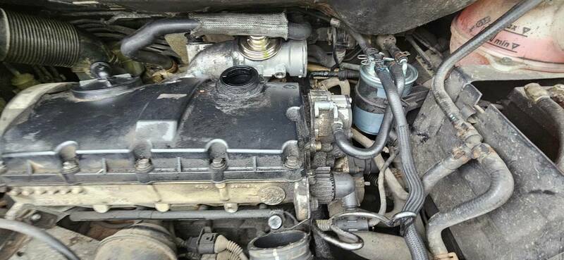

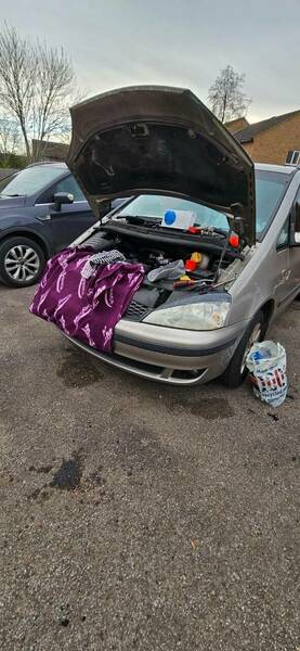

So I decided to get the egr fitted only 5 bolts, last bolt was dam slow winding in, not even like was cross threaded... well after all the grief it's still the same , low speeds ok... but then lack oomph, I'm  wonder if boost pressure issue
New* hub and strut fitted to the Z4.
It took rather longer than I'd hoped as both ball joints put up quite a fight, but they came apart eventually.  Fitting the new strut was easy, although I did waste a bit of time trying to get it to seat in the hub properly until I realised that you have to have the pinch bolt completely out or the locating lugs on the strut will catch on it.  Then once I'd fitted and tightened the pinch bolt I then realised I'd forgotten to hang the brake flexi bracket on it before I fitted it, so it had to come out again.
It's all back together now though.  More or less anyway - the track rod end ball joint nut is a bit knackered after I battered it with a hammer to try and get the ball joint to come out, so it now can't be tightened all the way, and the new M12 nuts I had in my stash are the wrong thread pitch.  So I've put the original nut back on for now with a load of washers packing it out so it's tight - it's going to need to come off soon anyway as I knackered the dust cover so I'm going to need to fit a replacement one of those.  I knackered the bottom arm ball joint dust cover as well, but there's quite a bit of play in the ball joint (odd as the arm looks fairly new, although braying the feck out of it with a splitter probably didn't help) so it's going to need a new arm before long, so I'm not going to bother buggering about with the dust cover on the old one.
Wheel bolts were a bit of a twat to refit as well - to start with I thought I'd bought some weird spec hub with a different thread for the bolts, but turned out it was just where the hub had been sat around and the threads had gone badly rusty.  Plenty of grease on the bolts and winding them in with a long bar soon sorted that.
I went to see a mate last night and mentioned my BMW suspension woes, and he offered to lend me his big 230v rattle gun to see if that'd get the other side pinch bolt out in one piece.  I was dubious, but somewhat to my surprise:
So that's a relief as it means I don't have to change the hub on that side, so no buggering about with ball joints (assuming I can persuade the strut out of the hub anyway...).

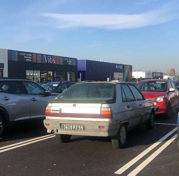

Spotted out walking this morning.
