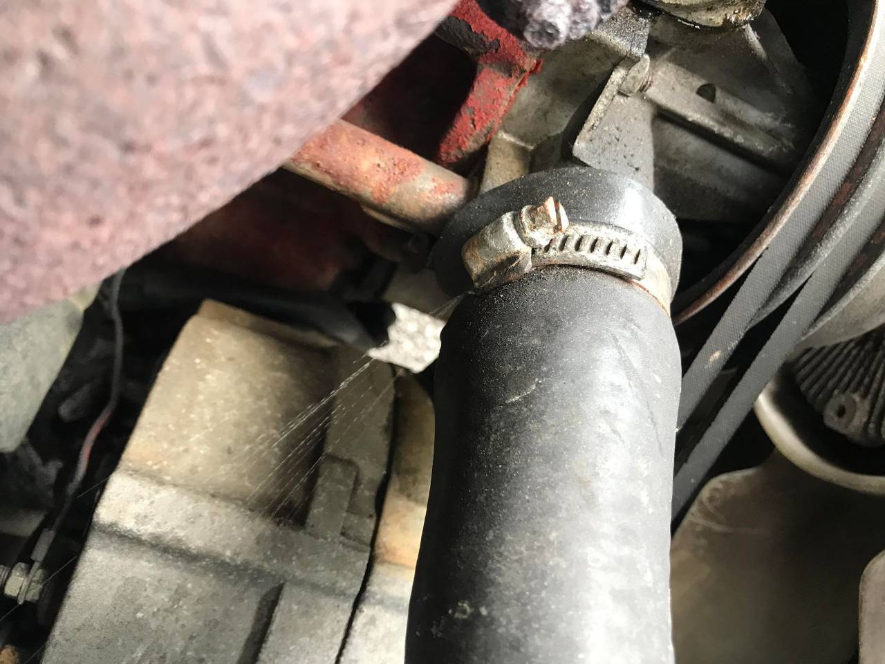

On the way it did develop an incontinence.
Ah, yes. The rad hoses I'd diagnosed as being fucked many moons ago. Turns out that buying new hoses and then not fitting them doesn't fix the problem.
It made it home fine with a coolant top up. I also spied some oil spilled down the side of the block that definitely wasn't there before and checking the oil level saw it significantly below the min mark! Topped up but a full service and investigation is on the cards.

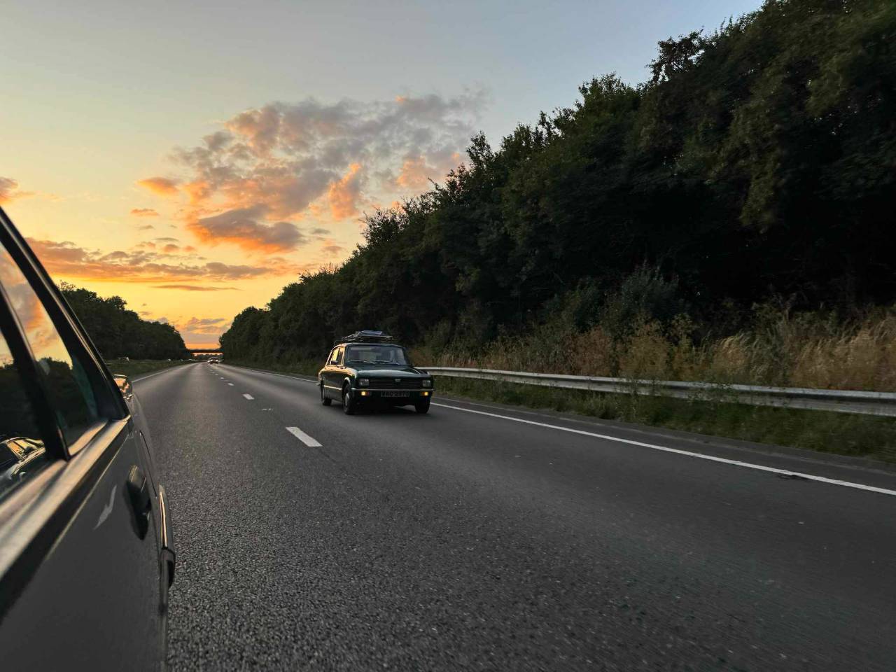

At least @Idriveaclassic got some good photos in passing as we plodded on.
