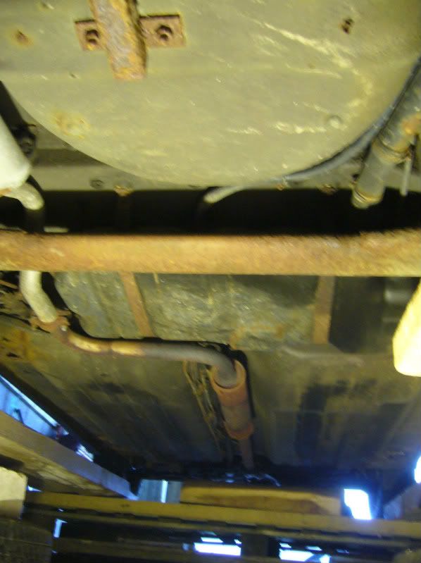

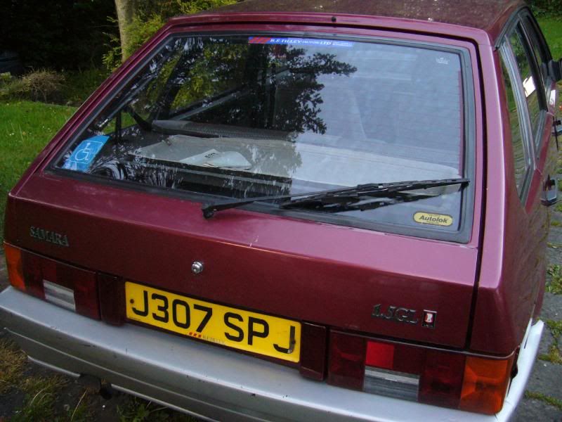

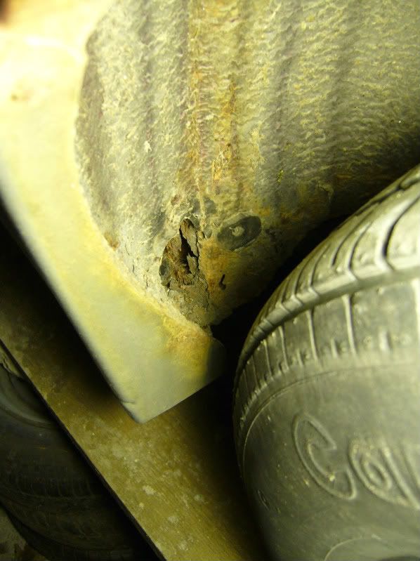

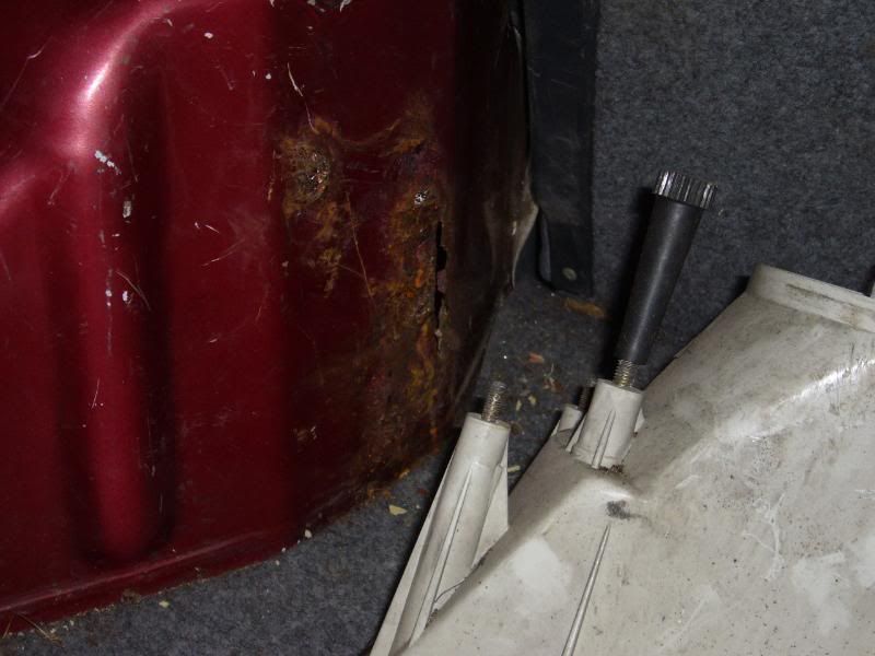

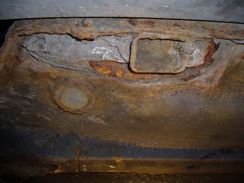

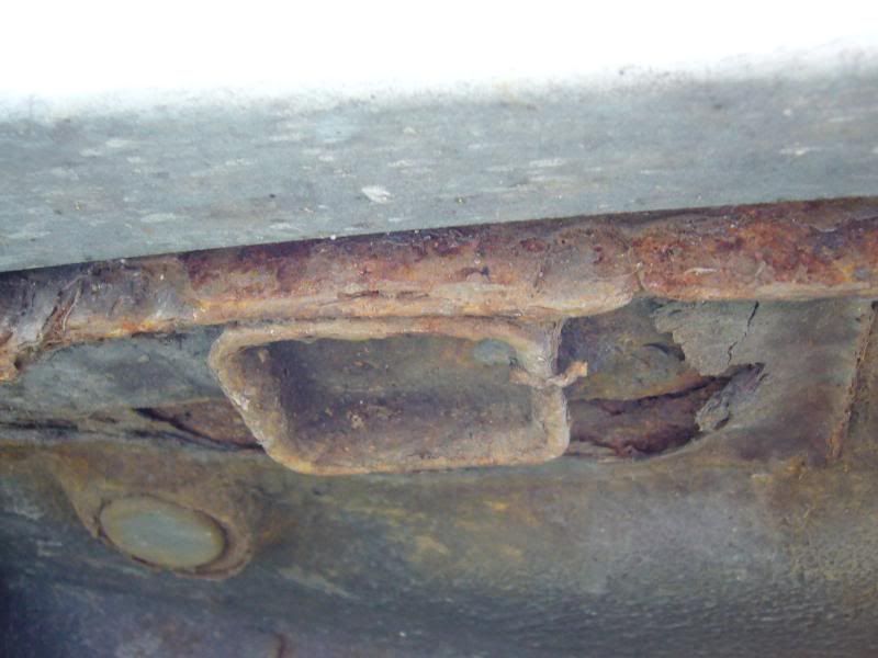

Mr_Bo11ox Posted May 20, 2011 Share Posted May 20, 2011 Sterling work there Krooj!!! That looks like an honest old tank, I think its well worth £150. The rot looks moderately bad but i'm sure it can be dealt with OK. The body looks very straight. Plus it sounds like you met some right characters which is often half the fun of 'shiting'. Nice one! Link to comment Share on other sites More sharing options...

Barrett.in.the.USA Posted May 20, 2011 Share Posted May 20, 2011 Can't add much to what everyone else has said, this is a properly good save here. Looks like it'll be a solid old thing with the welding done. To be honest for 150 squids it's worth spending a bit to get the rot sorted properly, you'll probably end up with one of the best Samaras in the country... Can't wait to see it all nice and polished with those bumpers cleaned up. Hope you're planning to take it back to see Edwin & Jean when it's looking a bit healthier?? Link to comment Share on other sites More sharing options...

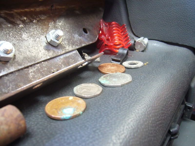

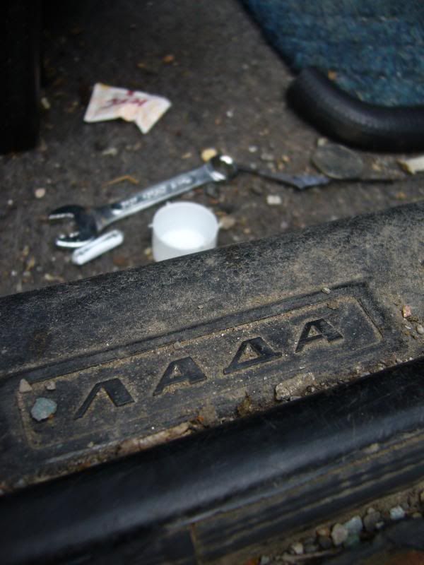

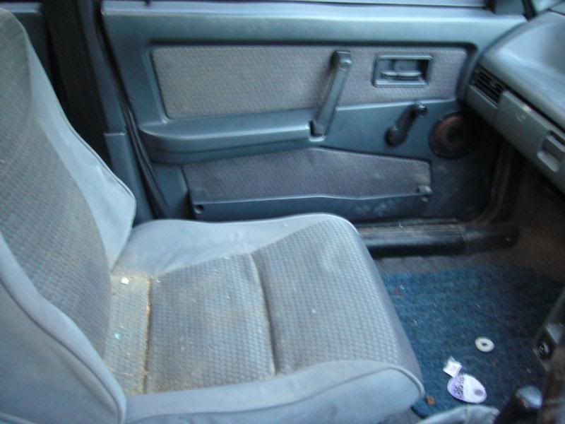

scooters Posted May 20, 2011 Share Posted May 20, 2011 what have the evil old biddys being doing in the interior!!! did you notice any 'Fritzel' style mysterious extensions in their house? .....I don't think they are what they seem! Link to comment Share on other sites More sharing options...
boobydoo Posted May 20, 2011 Share Posted May 20, 2011 ^^ Yeah, I thought that. If I was selling a car I'd at least hoover it out first...was there a secret stash of Edwins mucky mags in the boot? Link to comment Share on other sites More sharing options...

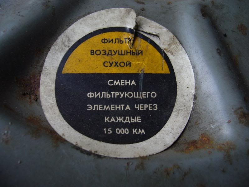

KruJoe Posted May 22, 2011 Author Share Posted May 22, 2011 No idea what it says... òþ÷ôушýыù фøûьтр = air filter The sticker is on the filter housing, I'm guessing it says something along the lines of "change the element every 15000km". Cool eh? Link to comment Share on other sites More sharing options...
Rod/b Posted May 22, 2011 Share Posted May 22, 2011 I think it says "Hang air filter from a tree and bash with a stick until dust stops coming out every 15000 km" (NOTE: I am NOT an Emeritus Professor of the Russian Language) Link to comment Share on other sites More sharing options...

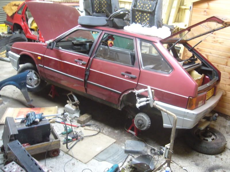

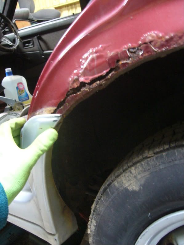

KruJoe Posted April 17, 2012 Author Share Posted April 17, 2012 Holy thread ressurection, Batman!This POS has gone nowhere in the last year, it has lived on in my sig and so too in the shed. It has been my intention all along to get it legal and take it out as often as possible so that I may fully enjoy the fantastic* driving experience. This was the last we saw of it. In the summer I told you ...Sadly ... I've not had time to show it much love yet, snowed under with work. I've taken it down the road a few times to keep it loose, and washed a huge pile of bird crap off the bonnet, otherwise no progress. I'll keep you all in the loop as things progress! So as promised, update time. To have a closer look at it's underbelly, I 'constructed' an inspection ramp out of pallets and broken breeze blocks. It wobbled like a bastard and had me touching cloth, so I fcuked that idea right off. But after I'd been inside for a cup of tea and a nice sit down, the Lada was still up in the air, so I peered underneath. NSF jacking point The grey stuff I think is dried mud. NSR footwell / inner sill NSR wheelarch / sill end Most of the undercarriage looks serviceable. Oh dear - dampness on the tank. That would be it - looks like hose clamped onto hose on the filler neck. 'Jack the test' won't like that. OSR jacking point. OSF matches the rest. And that was it. I put it away for the winter while I was off spotting for y'all in Thailand. So, the beginning of the end, think ye? GOOD WORK Think again. Some proper progress has been made; I have weld burns on my fore-arms to prove it! I'll bring you up to date next time next time I'm on, but rather than scratching my arse in front of the laptop, every spare 10 minutes is spent on my back getting filthy. My aim is for you to see this at Chumley in three and a half weeks. Wish me luck! Link to comment Share on other sites More sharing options...
Cavcraft Posted April 18, 2012 Share Posted April 18, 2012 Got to love the Autoshite ramp, that's effing brilliant! I'd love to see this car (and ramp!) at Chompley. Link to comment Share on other sites More sharing options...
skattrd Posted April 18, 2012 Share Posted April 18, 2012 Excellent save, and I hope the welding goes well. That ramp is somewhat worrying, good work on reversing up the thing, I wouldn't have liked to have tried that.If you're welding the inner sill or anything that may go through to the interior its less stressful if you remove the interior carpet and have someone inside the car on "fire patrol" with extinguisher/bottle of water. I'm usually on fire patrol, not the welder Link to comment Share on other sites More sharing options...

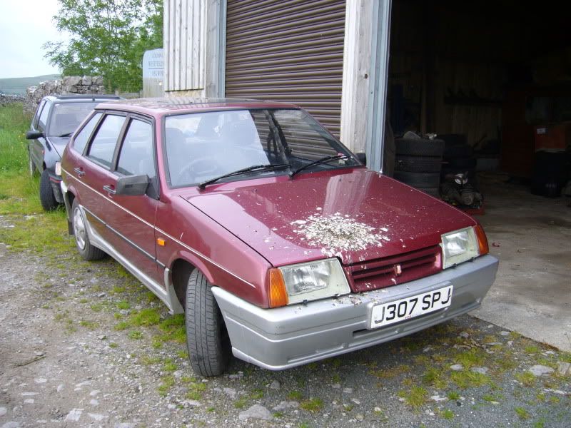

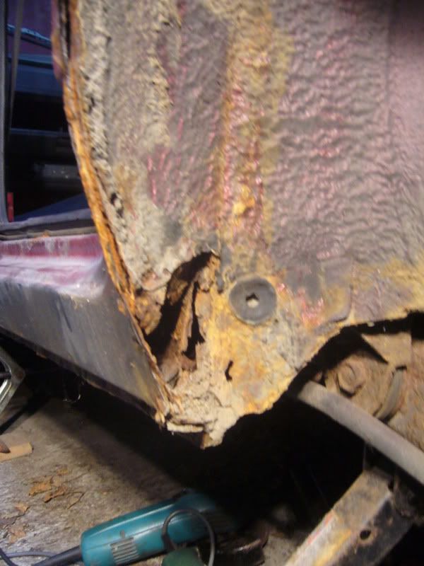

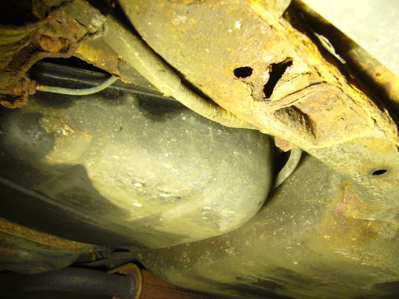

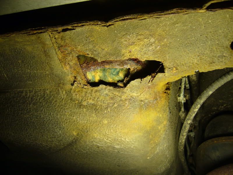

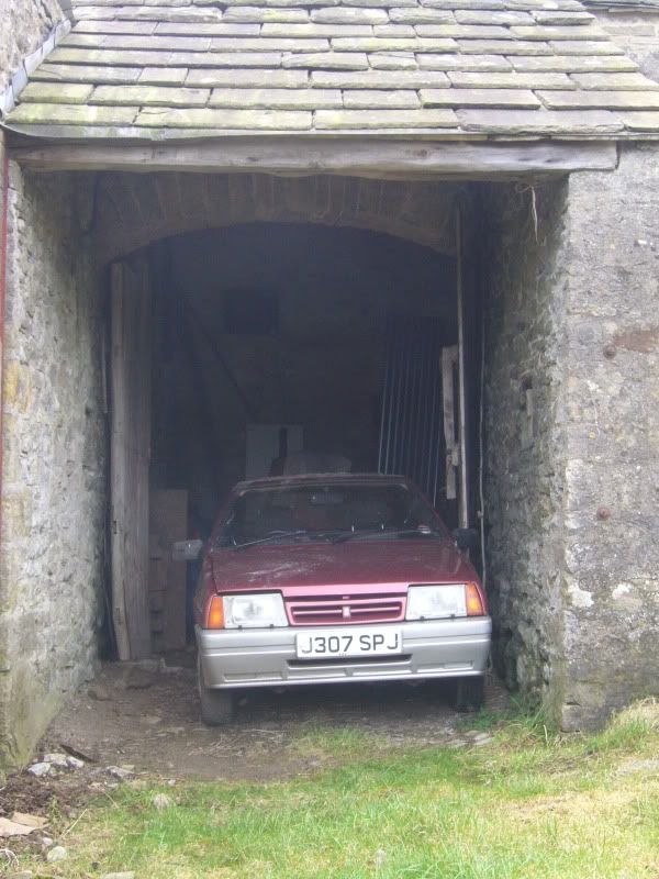

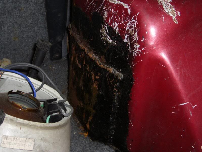

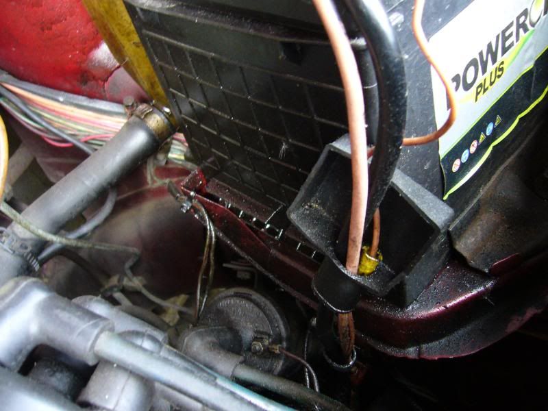

KruJoe Posted April 18, 2012 Author Share Posted April 18, 2012 Thanks for all the encouraging comments guys. Now I have declared my intentions, I have you all on my side to get this thing to Chodley. Sadly I won't be towing a low-loader with crap to re-construct the ramp there. However, I have a few more super-shite mingebag bodges to share with you - watch this space... Barn find! So, after a winter in a damp barn door in the Yorkshire Dales she fired up after a glug of juice down the gullet. Winnar!The battery I'd kept on a windowsill in the house with a solar trickle charger on it. I brought the BX in to jump it off, but didn't need it. Let's get crackin' with the knackin'. I figured with all this floor welding, I'd have the seats and carpet out, not only because I could see underlay from below the car, but because the interior was minging, I mean really skanky. And the front seats are shit, like trying to drive whilst sitting on a milk crate. I couldn't live with that for long. The seats have an unusual sliding mechanism; they slide at the back, but pivot over this rolling bar at the front. As a result, they offer no support under the thighs when pushed forward or back. Rancid carpet out. That'll clean up. 74p cashback! There was impressive layering of different under-lays and sound proofing. Only the rectangular felty one in the NSF foot well was rotten and crumbly, so that can easily be copied and replaced. As a mojo booster, I decided to try to fit these seats from the 214 I'm breaking in the top field. The colour is almost a perfect match, they're the right size and fairly comfy. ACE! After hacking off the back of the runners, they bolted straight in, and I fashioned front brackets from old dexian or summert. That worked a treat, but the gearstick still rests on my left thigh, even in 3rd gear. I considered grinding it off and welding it back at an angle, but I discovered this in time: There's a handy spline on the linkage where it goes into the back of the gearbox, under the diff. I'll have a go at adjusting that when the seats go back in.Happily, the floor was surpisingly clean under the carpet (apart from the assortment of self-tapping screws that had been dropped between the layers as those pesky vodka-addled Ruskies threw this effort together). OSR foot well: Opposite side: This is how it was below: And so the grinding began. An easy one to start. Yes, I do like to get my money's worth from grinding disks!A patch was coaxed out of a mangled section of 309 front panel. I can usually find some scrap with creases in the right places. Note the wet 'fire sponge' on stand by. I also shielded the rest of the interior, and importanly the windows from sparks. They can soon screw the job up. Before you rip into the 'pigeon shit', this was my first EVER attempt at welding sheet metal on a car. I have only have a gasless mig that I found in the shed and repaired with bits from a BMX. I think my father bought it from an agricultural sale in town - he tends to go along and bid £1 on junk if it doesn't look like it's selling. So his workshop just fills up with crap. He didn't even know what it was 'til I told him! Beggars can't be choosers, so I bought some gasless wire and a nozzle tip, and it sort of works ok now. I hate it to be honest - there's no adjustment of speed or power, only lo/hi. High burns holes for fun, so low it is. I'm getting better. I have a £30 arc welder, which I love using, but it's only good for really chunky stuff, anything less than about 3mm it shreds. As this thread goes on, you'll learn this truly is a minge-bag project. I ought to tot up sometime, but I think we're still under £250, including a whole new exhaust system and a welder I can't use on it. I had a tickle with the grinder underneath and went around it with the shitmig again, just because I could get to it, and needed the practice. Looks better* for it anyhoo. The nearby wheelarch... You can see the hole in front of the wheel. I shit you not, these side skirts are held on by two self-tappers at each end, and the fact that usually the doors are closed! I told you this was a quality machine. That hole grew a bit, as they do... We'll leave it at that for now. More later. Any advice much appreciated (other than 'Take it to the bridge!), I'm very much a noob at this! Be gentle...G'night. Link to comment Share on other sites More sharing options...
catsinthewelder Posted April 19, 2012 Share Posted April 19, 2012 Storming progress My old welder ended up being gasless due to faulty parts so I fully understand you're pigeonshit woes. If it looks ok after a tickle with the grinder all is ok if possibly not too structural. Link to comment Share on other sites More sharing options...
skattrd Posted April 19, 2012 Share Posted April 19, 2012 Good job just getting stuck in there, learn by doing No criticism from me on the welding, as I have never tried it myself, so any attempts from me would likely be worse, it can always be ground back. I would like to learn to weld, but my BIL can weld so I generally let him, I just do fire patrol and grinding duties. Link to comment Share on other sites More sharing options...
cobblers Posted April 19, 2012 Share Posted April 19, 2012 I always loved the 1970s BL ribbon cable wiring, clearly someone with a back to front R and a load of Zs in his surname shares my sentiment! Nice work mate! Particularly enjoyed the size of the guano pile on the bonnet, I bet that took some shifting! Link to comment Share on other sites More sharing options...
