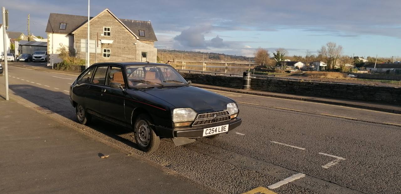

dollywobbler Posted November 27, 2020 Author Posted November 27, 2020 Wiper. In other news, the GSA's short burst on the road came to an end. Put some miles on her during a rare dry spell. But as you can see, she really needed a wash. That's better. The suspension on this car never fails to amaze me. Less good is the windscreen, which is very badly scratched. Winter sunshine be like... Not ideal. I think I'll need to replace that. But, storage beckoned and indeed, it poured with rain last night, so I'm glad she's away again. Lacquer Peel, Mrs6C, adw1977 and 5 others 8
