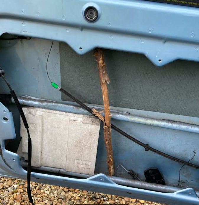

This morning's bit of fun* AutoShite discovery - pull door panel off to investigate 'loom problem' (no windey, windey and central locking). Discover all the components (minus window regulator) have been carefully* stored in there after repair by Fred Flintstone Mechanicals Ltd
Of course am missing a few nuts, bolts, clips etc etc
I've had this pleasure* before, but I now feel quite smug in that my window holder-upper was a length of 2x4 and not a peasant's stick.

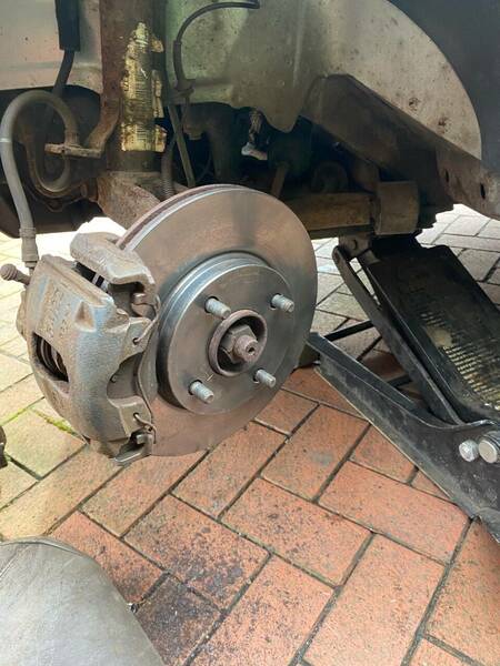

Helped Pat out with his Fiat Doblo which need a new door mirror after someone reversed into his van and smashed the original.  Not a terrible job, however it was pretty annoying that the way the interior trims were done means you have to remove the whole door card to get access to one mirror bolt and one of the wiring plugs (one for the heater element, one for the tweeter in the interior trim).  If the door card had been sculpted just slightly differently it wouldn't have to be removed.  You'd think a work van would have things like mirrors designed to be as easy as possible to replace since they're the most likely thing to get bashed off in use.  The manual remote adjuster stalks are rubbish too, for some reason they're flexible so you can't actually move them the full travel to properly adjust the mirror because the stalk bends before moving the mechanism.  Might as well have just left them as manual adjust mirrors where you push on the glass itself, which is what we ended up doing.
In other news, the Princess is rubbing the front driver's side tyre on the arch liner on full lock again now that I've actually refitted the arch liners.  It's always been this way, and it was worse when I first got the car because the front tyres were too big.  One thing that was surprising was I forgot how much difference to noise intrusion the arch liners make.  I think there are marginally more pros than cons to the liners so they can stay... a decision I shall no doubt regret later this year when they have to come out for some minor works to the bodywork behind them that I can't attend to just at the moment but that's a problem for future me.
I got it fixed with a £20 mech from Ebay although it was a Rennow so no silly cables like this one.
It gets better - there's that stick on the back end and a 26" piece of free polypipe to the front of the door - whoooo!
The entire inner skin with the missing regulator attached plus already wired up slides and so on is £35-ish on eBay for an Ali-Express option (£26 off a breaker for a pukka VW one) so it's not that much of a ballache.
I do have to puzzle out how the central locking fits back together and then cross fingers that the locks will then work - it looks like all the actuators and connecting wires are present - just piled up inside the door :-)
