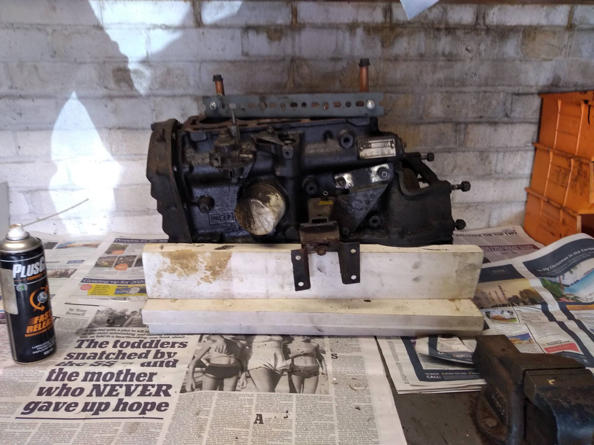

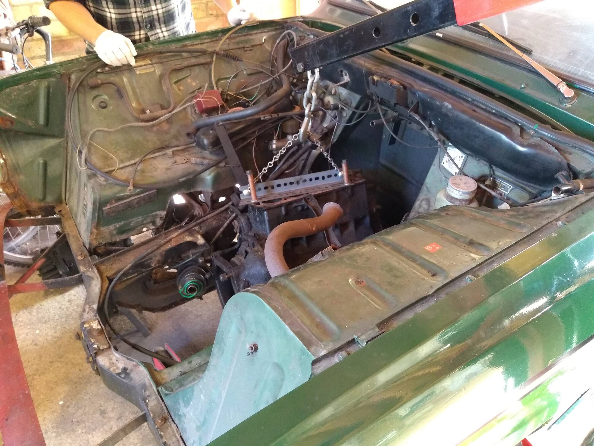

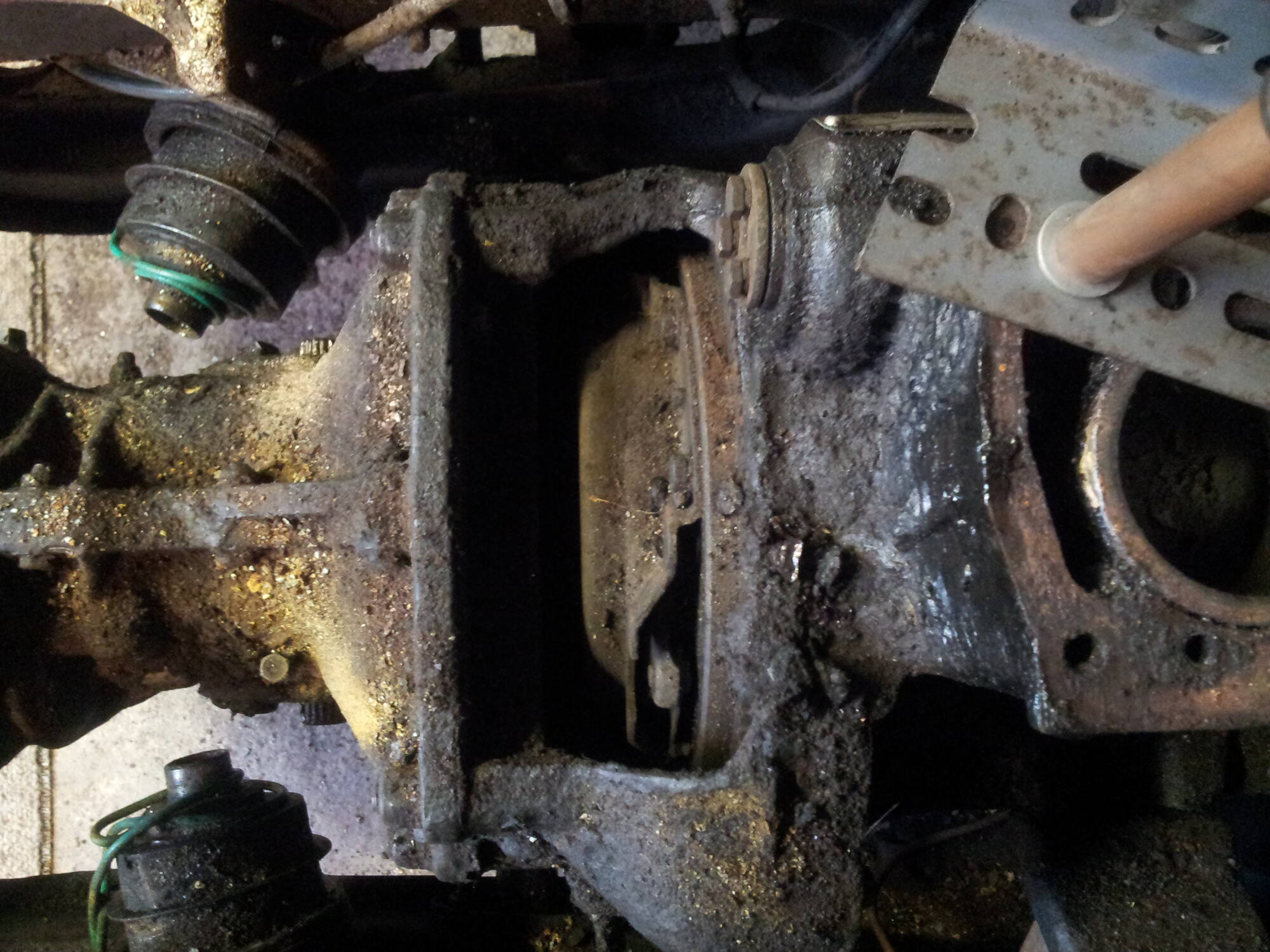

I had already managed to remove the driveshafts (see above) and then the gearbox, which came out fairly easily with the front panel out of the way.
Does anyone know if there is supposed to be a cover over this hole? The  clutch and flywheel assembly appear to be exposed to the elements, with no sign there has ever been any sort of cover over it. Seems like a recipe for shortening the life of the clutch plate.

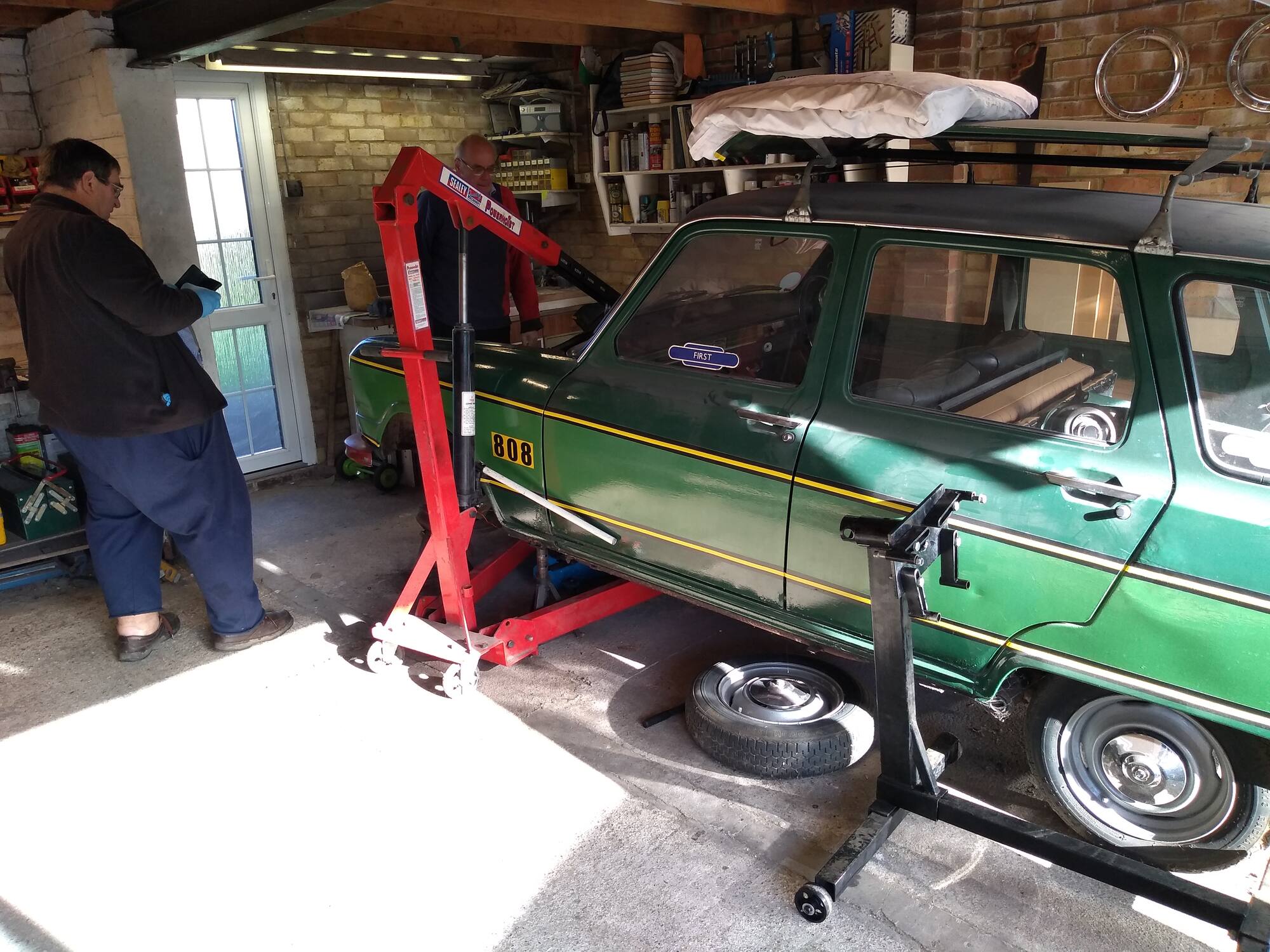

I had also disconnected everything from the engine and unbolted the engine mounts, so the engine was just resting on the chassis rails, ready to be lifted out.
Andyrew kindly brought along his engine crane, so battle could commence.
Initial position:
Andyrew was rightfully concerned that the piece of chain I had found, which looks like it had come from an old pull and clank cistern, would not be up to the job, so he added a long webbing strap before we proceeded.
All strapped up and ready to go. SixCylinder records the event for posterity.

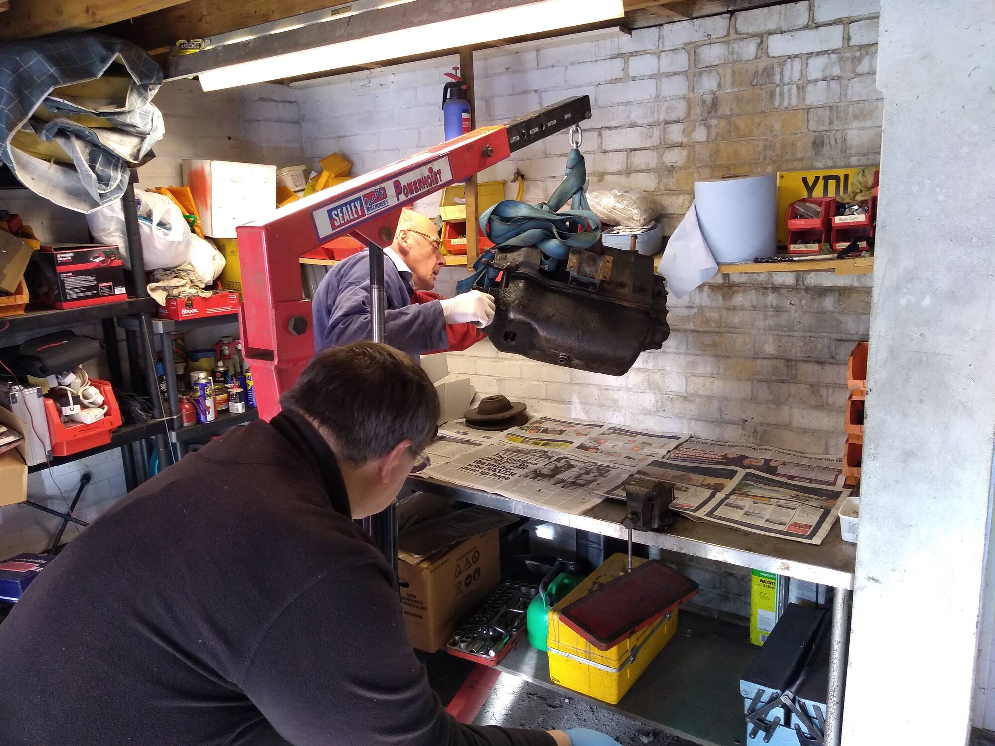

It's out! SixCylinder mans the pump, Slowsilver guides the way and Andyrew oversees proceedings.
Heading for the safety of the workbench.
A gaping hole.
The eagle has landed.
Stay tuned for the next thrilling* episode, where we tear it asunder and reveal the horrors that lie beneath.

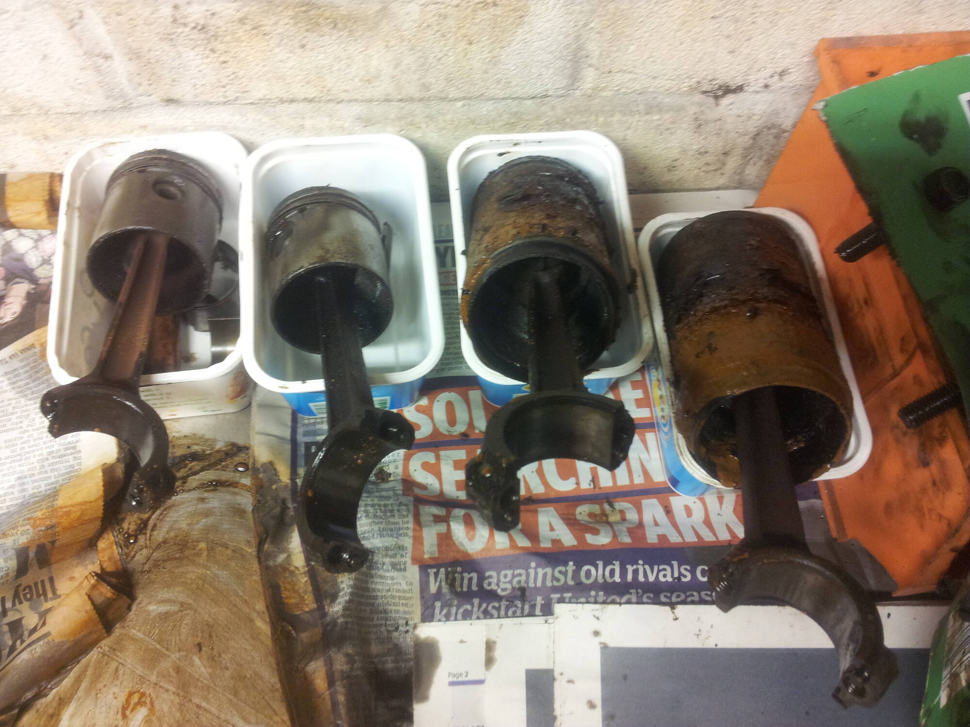

At this point we tried to push the pistons up in the bores, but no dice.
On reflection we should have left the liner clamping bar in place and then belted the pistons up the liners, but by now we were flagging and common sense went out of the window. So we removed the bar then thwacked the con rods upwards.
The two pistons at the timing gear end slid out nicely and, apart from a couple of stuck rings, looked to be OK but the other two came out complete with their liners.
The flywheel end liner was the mankiest by far.
Not surprising looking at the state of the cesspit it was living in.
That concludes the evidence for the prosecution.
The next step will be to soak the two stuck pistons and liners in diesel for a week or so then try and bash the pistons out using brute force.

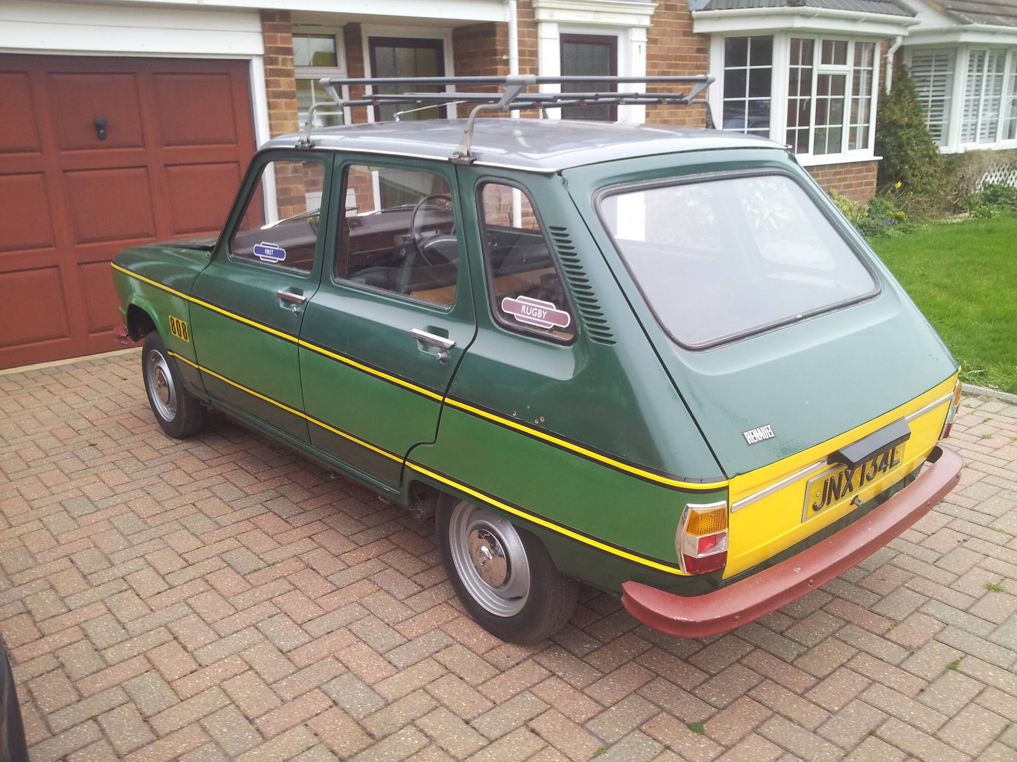

Bob is now reluctantly up for sale.
No ifs, buts or maybes.
He's got to go.
I have gone as far as I can with him and now he needs to go to someone who will save him.
Re-read this thread for all the gory details, but current state is:
New brake master cylinder, 4 wheel cylinders, flexible hoses and some metal pipes fitted, so footbrake and handbrake now work.
Engine and gearbox removed. Engine dismantled. 2 pistons seized into their liners. The rest of the engine (pistons, bores, big end and main bearing shells and crankshaft thrust washers all look still serviceable.
All other parts needed are either still on it or in it (I hope).
If the 2 pistons can be successfully freed from their liners without damage I think the engine could probably be rebuilt with just new seals and gaskets.
Otherwise it would need a new set of pistons and liners.
Or another second-hand engine could be sourced. These are the same as fitted to the Renault 4 (845cc) so are reasonably plentiful. Later versions were fitted with an 1117cc engine which is not a direct replacement. Apparently they rotate in the opposite direction for a start, which would give four reverse gears and one forward gear!
Comes with period roof rack and a box of new spares (Gasket sets, clutches, bearings, etc.).
I am not looking for a profit on this sale, I am more interested in it going to someone who will save it and put it back on the road, as it is quite a rare beast.
According to How Many Left there are only 25 R6s of all types (R6, R6L & R6TL) either taxed or on SORN. But of these only 4 are the early R6 model like this one and only 3 are taxed. Also the majority of these are left-hand drive models imported from France or Spain. Bob is an original, right-hand drive, UK-supplied model and I only know of one other early right-hand drive one that is currently on the road.
I have a V5 in my name but this is not the SORNed one as apparently, since it has been off the road since before SORN was introduced, I cannot SORN it until it has been taxed, despite  it having now had a change of ownership.
It currently owes me about £500 so I would like to recoup this amount if possible.
Obviously it would need to be moved on a trailer or a flatbed.

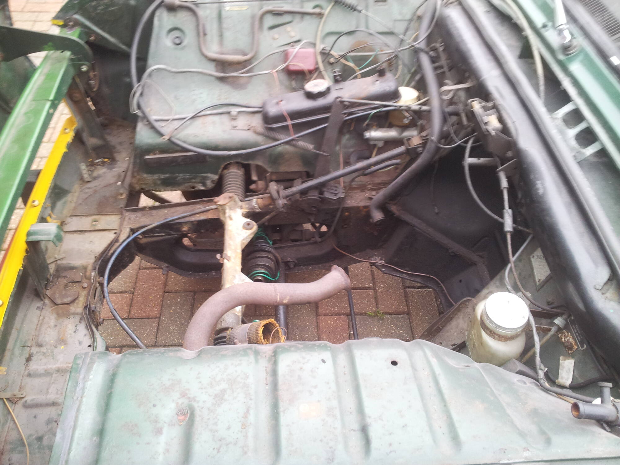

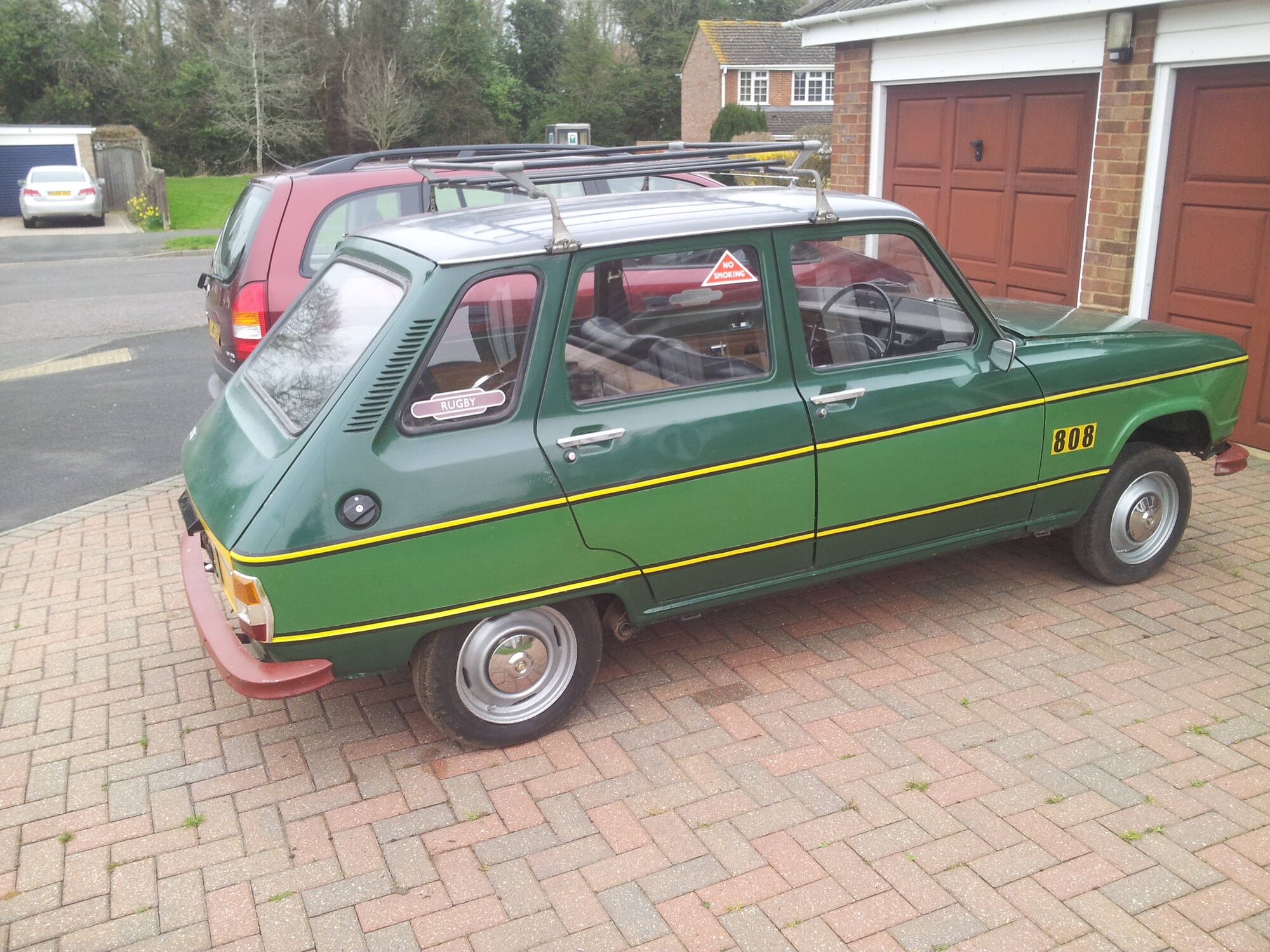

Here are some pictures of it in its present state:
The somewhat nose-up attitude is due to the engine now being in the back instead of the front. As you will see in previous photos on this thread it sits quite nicely when things are in the right place.
Large empty space under here:
But the bits to fill it are all in here.
