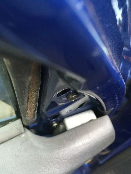

Marm Toastsmith Posted January 8, 2023 Author Share Posted January 8, 2023 On 12/24/2022 at 6:12 PM, 3VOM said: Again IIRC two or three bolts under the "sail" trim panel. Spot on... although accessing the lower screw actually requires removal of the door card. Brilliant* design. I have tightened the top one properly and screwed the lower one home with my fingers and some needle nosed pliers. Of course because it's a VW of this era, the plastic trim, having been removed and now replaced, feels slightly loose, and pieces of crumbling foam have gone everywhere. The way the interior is constructed is probably equally what made these feel "premium" in the first place and what makes them shite now. It's a good little car over all, but it's not nearly as well put together as their image at the time would have suggested. 3VOM and AnnoyingPentium 2 Link to comment Share on other sites More sharing options...
