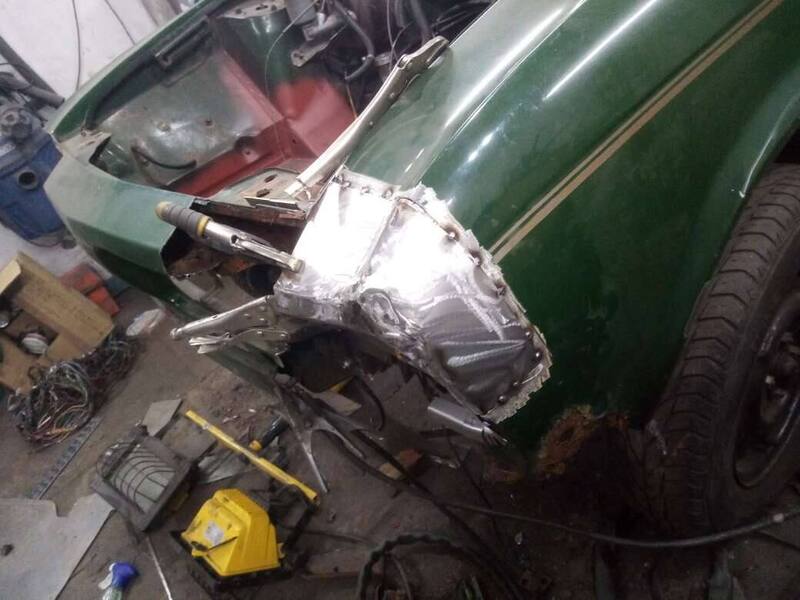

Front wheels forward it's going to be all new metal as there's fuck all to weld to. We've got all the repair panels made for the chassis and main structure of the front end, then it's just the fronts of the wings and the other side of the valance to knock up.

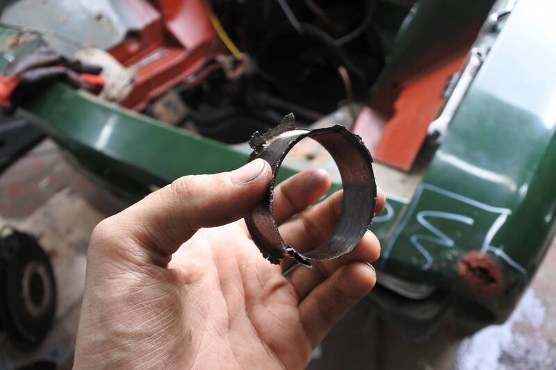

Bearings aren't wrecked, they're just a proper Scots "money's worth".

This is the big end bearing for No.3...

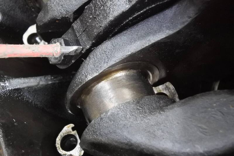

The hardened surface on the crank is entirely gone...

Originally the whole car was made of 1.2mm steel, so a decent thickness, probably a large reason as to why the front of the car is still straight despite losing so much structure! For the repairs the chassis structure is getting 2mm, the structural components (inner front panel etc) that have to support stuff are 1.2mm and the cosmetic panels (wing tips, valances etc) will be 0.8mm. This is simply because 0.8 is so much easier to manipulate, it shaves hours off the fabrication time. It's essentially the standard for modern motor's panel skins, the Japanese were using it in the 1970s - As evidenced by the Acclaim which is mostly 0.8!
The only downside is that I won't be able to do dumb shit like stand on the wings to take photographs, and it might not win the Pebble Beach concours d'elegance if they whip out the calipers... ?
Have another fuzz shot...
1594642171086.JPEG.d34fabf2d678f3ac5578190459ef0319BLUR.thumb.jpg.8dcec5d62424d33e3f14fcbb33ab5569.jpg
(Wonkness of the driver's side panel is because two tacks on one side does not a panel support!)

It's still a work in progress and I've only got 4 hours on it since the weekend and I'm working from pictures to make these panels so quite slow progress I'm afraid. It's all just tacked atm so i can make sure all the body lines meet and lights fit etc
