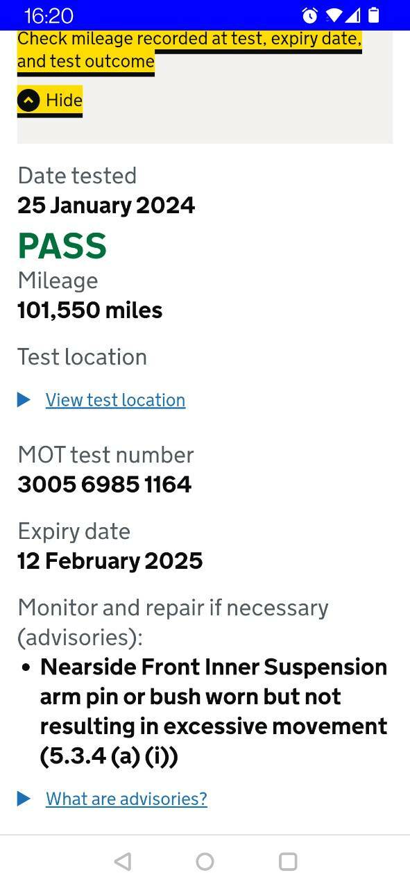

Zut alors, grand succès!
The tester evidently used to work on C15's at a Citroen dealers in the Eighties and was very complimentary of @dean36014's welding - he even asked for first refusal should I ever want to sell her.

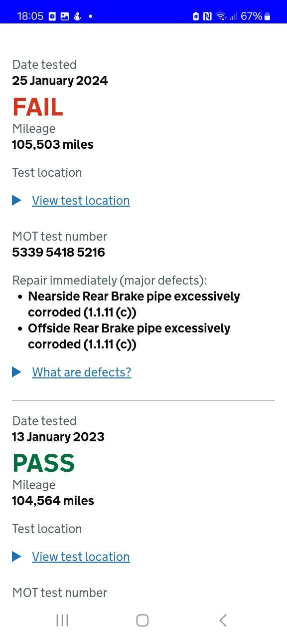

Must be the day for it.  My C15 in for MOT too.  And a result that I consider a pass.
Screenshot_20240125_180557_SamsungInternet.thumb.jpg.46ea3b1d42a9c62e2409d7e180382e59.jpg
That test result is racist against C15s.

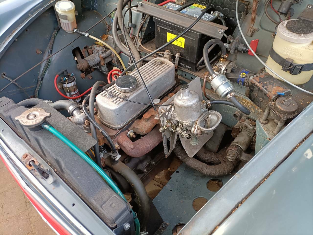

It's been a balmy 12 degrees down in Kent today so I ventured outside to fit my £12 Autojumble find carb to the Minor.
I also bought a can of fuel to top the tank up with something fresher and also to give the little HS4 a damn good wash off and flush out before fitting it. Everything checked out well enough (its got a waxstat main jet that can be troublesome) but once the carb was fitted the engine genuinely jumped into life first attempt (with me holding the choke mechanism over) to a smooth fast idle and equally nice idle with the choke off it even revs cleanly now too.
It's almost like it was already set up for a 1275 midget engine of unknown spec. Tomorrow I will take him out for a run to see if its improved the bogging down problems once I get above 30 mph.

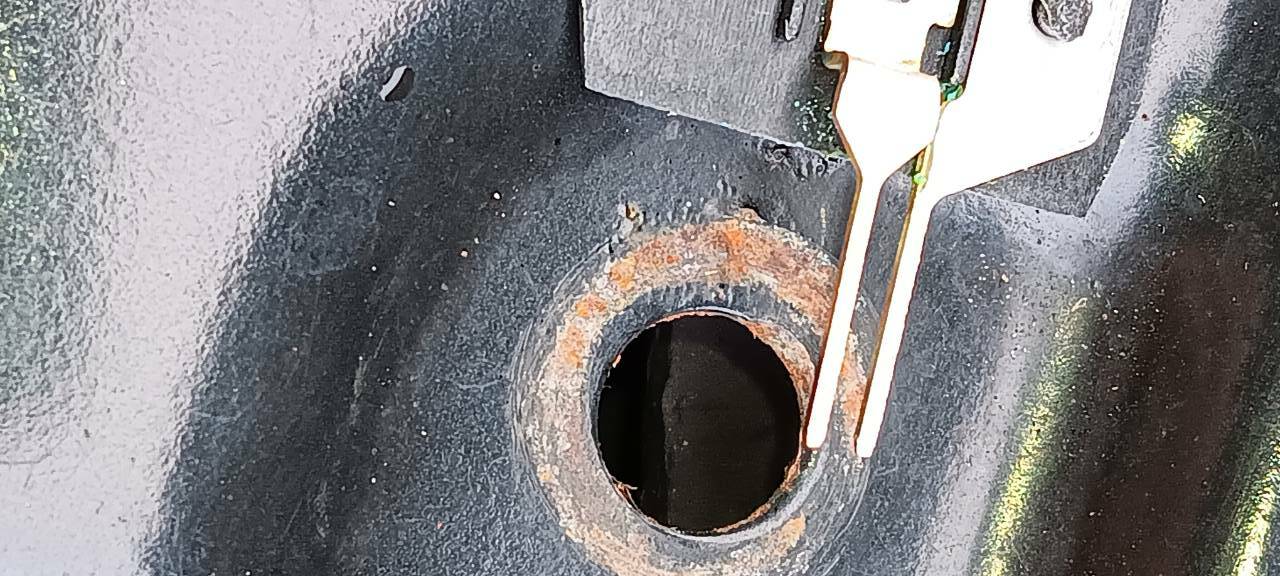

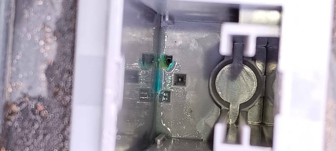

I had a crap morning at work and since fixing things makes me feel happy I thought I'd take a look at the 75s bonnet switch on my lunch break. After the storms it thinks the bonnet is open and as a result the car beeps when it locks and the alarm goes off a short time later.
I took the switch apart:
This bit was wet and corrosion had occurred:
These prongs:
..go in these slots which were completely full of water
I wicked it out with some paper towel, sprayed WD40 and I now have one fully functioning alarm again.
I could have saved £20 and not bought a new one however I don't think this will be fixed forever and replacements are surprisingly scarce. So it will be handy to have down the line.
