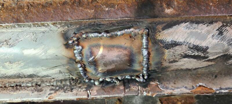

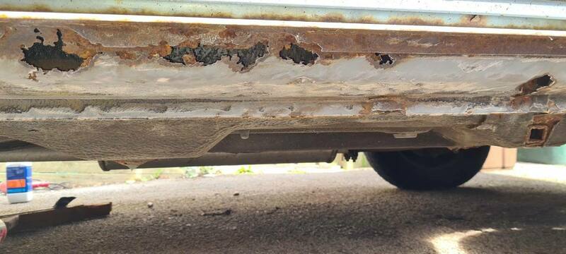

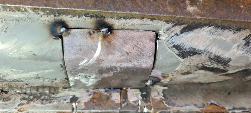

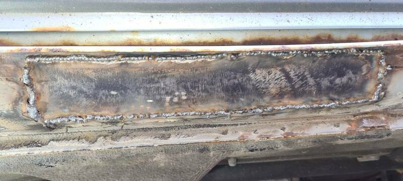

A bit more Saaab weldage, apparently this corner of the boot and inner wing always rots? It had a previous MoT standard patch which had trapped moisture and made things worse, so chop chop
Did the inner wing bit first
20220415_132638.thumb.jpg.c7ceca2527ed027b6e6d3c554c055bac.jpg20220415_135534.thumb.jpg.c15029f12a559d2e216e9baa747f6def.jpg
Then the boot floor to meet it
20220415_161928.thumb.jpg.29d623ed7c7264fe9070519ca4c6cec7.jpg20220415_161953.thumb.jpg.84fd1f7c142faccced04fc919982e280.jpg

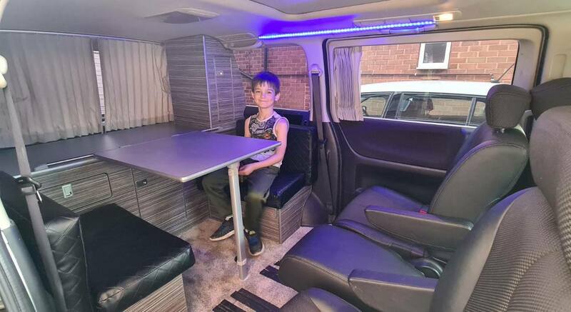

Fitted the units in the back of the Nissan today.
Just need to add everything else now. Hob & sink, electric of some sort, mattress, awning and fuck loads of other cripplingly expensive shit no doubt.

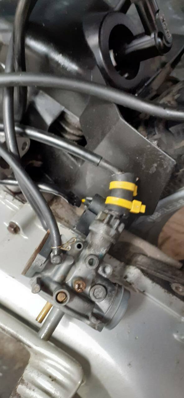

Top quality chinesium fuel pipe delivers for the mighty moped..
And been nd checked on the zephyr..

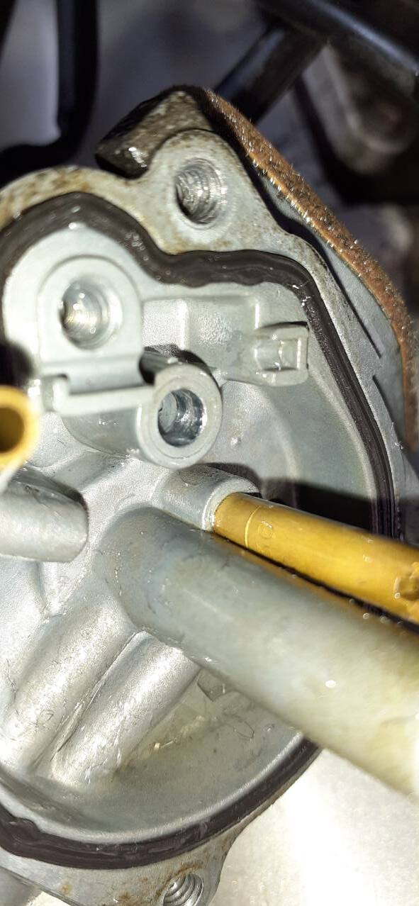

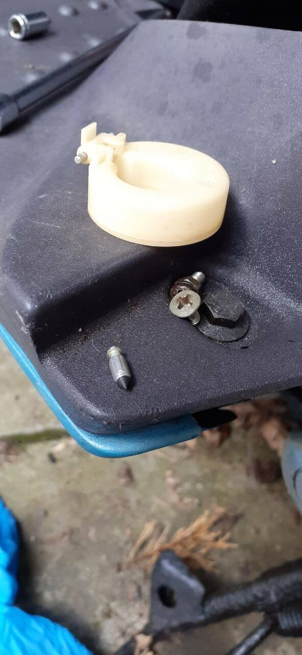

Removed the fuel injectors from the Jeep today and fitted new filter baskets and flushed them through with cleaner, god knows how it ran as the filters were pretty much blocked full of dirt.
put it all back together and the difference is barely noticeable
