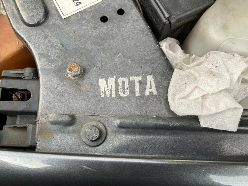

Noel Tidybeard Posted September 21, 2022 Posted September 21, 2022 On 19/09/2022 at 15:06, LightBulbFun said: MOTA = gris magnum davidfowler2000 1

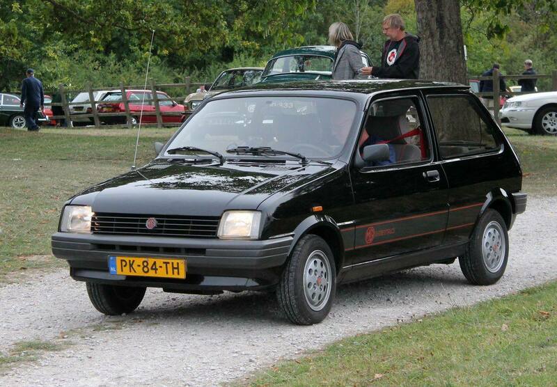

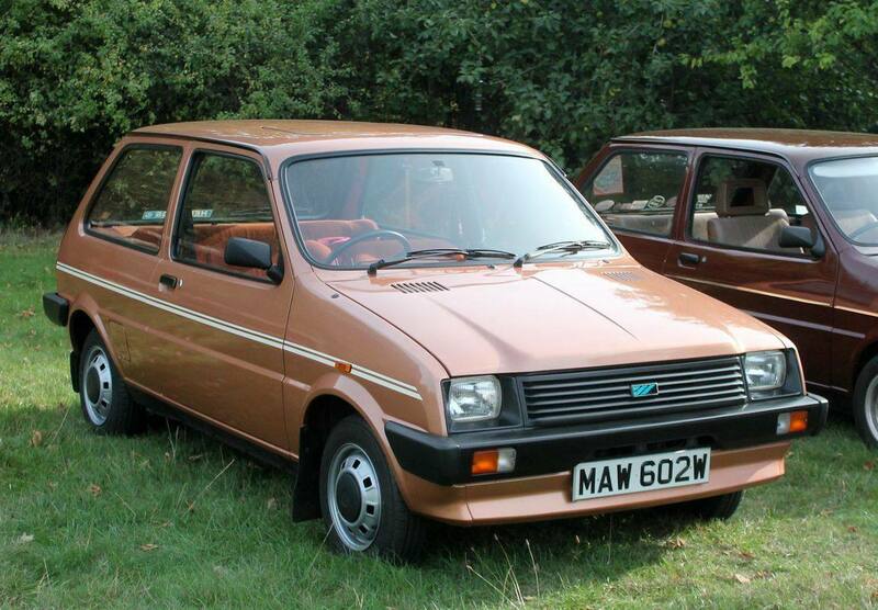

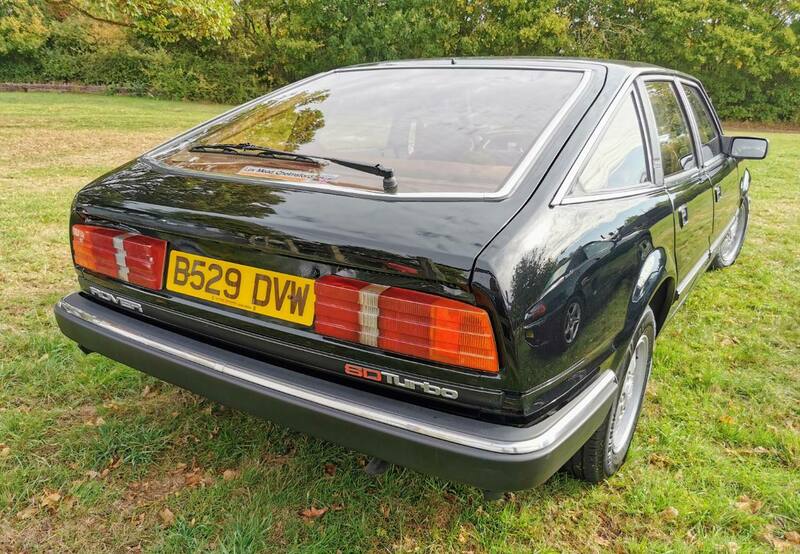

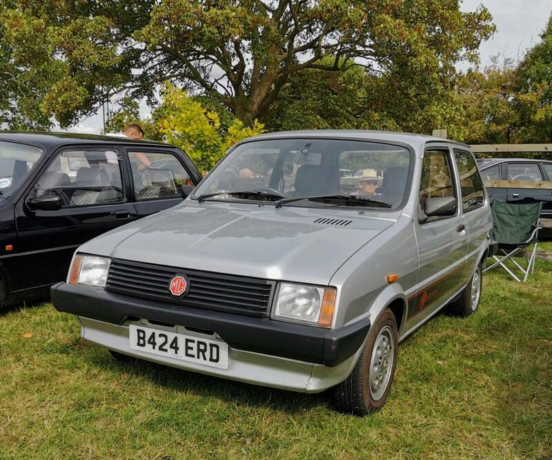

Zelandeth Posted September 25, 2022 Posted September 25, 2022 Most of my photos from the day are on film so will be a little while before we see them. There were a heck of a lot of Metros there today! This one of course being my favourite for obvious reasons... Always a good event though. A lot of single marque shows can be a bit samey I find, but given how diverse BL's portfolio was this is always interesting. I'd honestly forgotten this even existed in convertible form. An SD1 is always worth a photo too, and always looks great. This one is definitely quite a rarity though. Can't be many of those left. Dyslexic Viking, LightBulbFun, chaseracer and 8 others 11

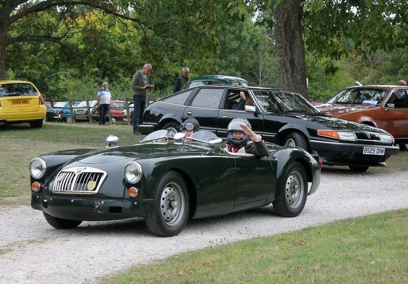

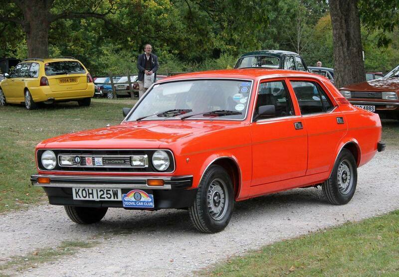

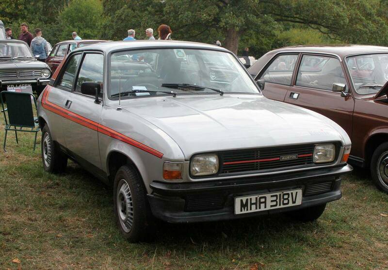

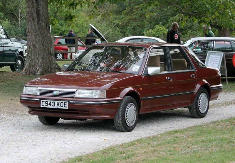

quicksilver Posted September 25, 2022 Posted September 25, 2022 What an excellent day at a show that seems to get bigger and better every year. I photographed pretty much everything so I'll just share a few highlights. Mmm, purple Wolseley wedge Police pursuit* vehicle Camp in style* with a beige Maestro Allegro Equipe with Serck plates. Oooof! MGA was the oldest and most exotic car there. Turbo diesel SD1 in hot* pursuit. Oldest Marina in the world, registered two days after launch. Note right-way-round wipers. Another Marina with right-way-round wipers. Weird one this as it was LHD and converted to RHD quite recently. Have the words "beautiful brown Montego" ever been used in the same sentence before? That's how this prizewinner was described. Postman Pat, Postman Pat and his Maestro van Intrepid traveller came from the Netherlands. In a Metro. Beige Ital, cor indeed! Never seen a Vermilion ADO16 before but the colour suits it This has allegedly done over a million miles on the original engine Only known surviving Metro in this weird colour called 'Sombrero' Definitely not BL, this enormous barge was lurking in the car park, on the grass as it's far too big to fit in a space Also got to meet Sarah Crabtree from Bangers and Cash, who was doing the prizegiving. She seems a lovely lass and reet northern. RobT, Skizzer, vulgalour and 12 others 15
