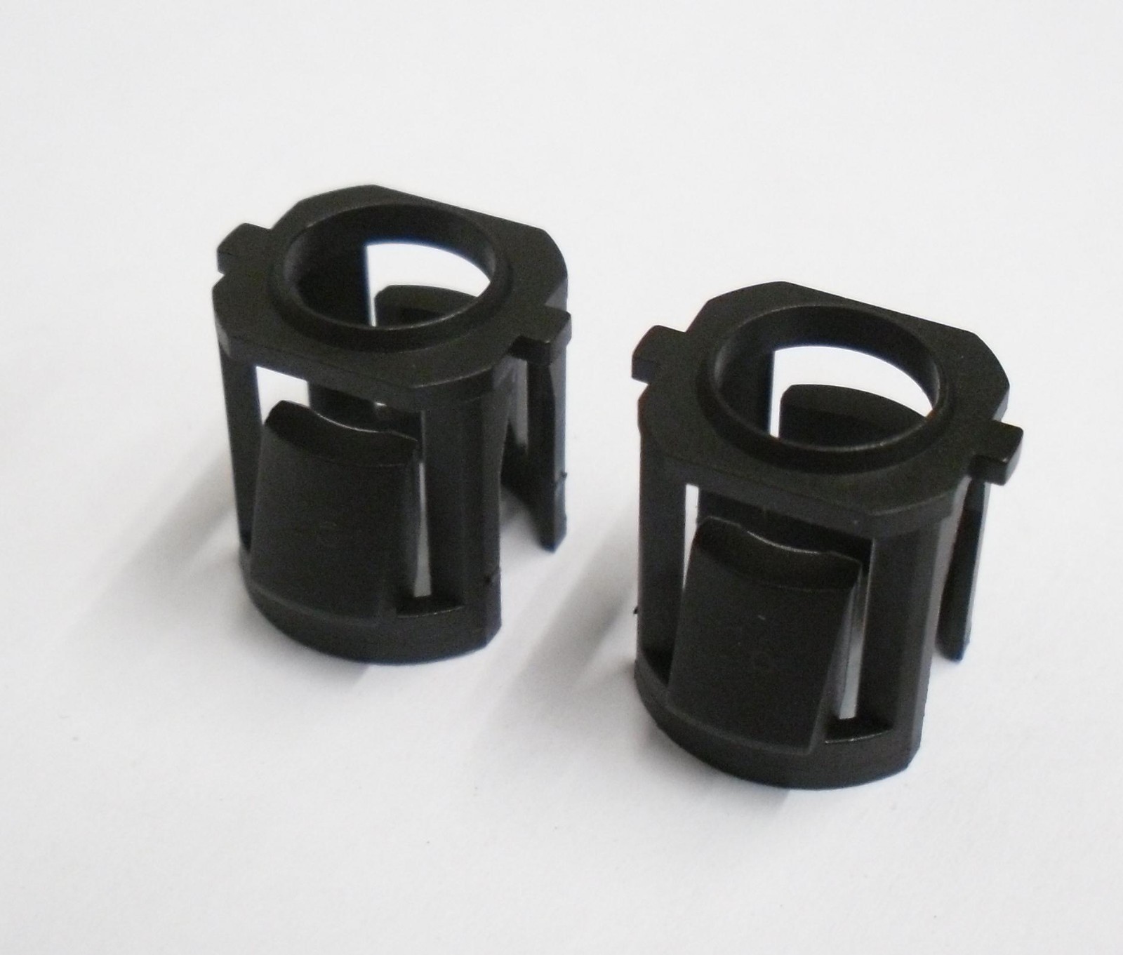

I think you just push down through the slot and slide off.
This sort of idea:
[Video]
[/Video]
Cheers, but it was different to that one.
I ended up having a rajjy at it and destroying it.
I nearly did the same to that one, but once I'd fathomed out the release mechanism, I managed to get it out in one piece.
Now I've had time, (horse bolted, but for reference like) your one looked like Huron like pinch type like this. You need to pinch it from both sides I think:
1m30s into this YouTube video:
The old version I think looked like this:
and was superseded by this:
https://www.youtube.com/watch?v=zfuYTjftkDo
Cheers for that. It was the heron type, but even after I hacked it off, the metal pipe had corroded itself into the clip and wasn't for shifting. It was leaking at the clip and I ended up dropping the tank and putting a new section of pipe on.
