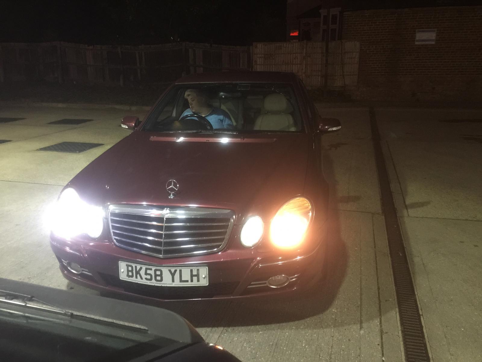

NorfolkNWeigh Posted August 20, 2016 Posted August 20, 2016 What's causing my near side headlamp to be a different colour to the others?Only noticed when my daughter was following me when I picked the Audi 100 up, it goes from yellow to pink.Presume just a bulb, but as Europarts list them at £94 I don't want to get one if it's likely to be something else.The cars done 220,000 and I think the grille and offside headlamp have been replaced at sometime so that bulb is probably newer hence not both going pink.What do we think?

Kiltox Posted August 20, 2016 Posted August 20, 2016 I assume it's HID at that money - they do go pink as the bulbs fail NorfolkNWeigh 1

Asimo Posted August 20, 2016 Posted August 20, 2016 HID lamps colour shift with age: some makes get bluer, others pinker, actual colour something to do with the exact make up of the electrodes. NorfolkNWeigh 1
