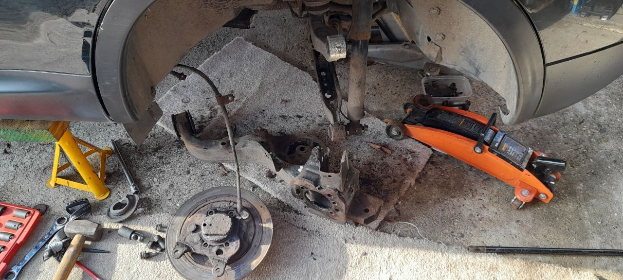

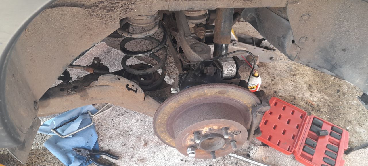

I've been to war recently, on a rusty Qashqai radius arm:
The MOT man poked a hole in it (and the spring was broken), garage wasn't much interested in taking it on so I decided to do it myself...
It's not been too bad so far.  All the nuts and bolts came out without a great deal of fight, thanks to repeated pre-soaking with PB Blaster, and patient tightening/untightening to slowly work them out.  Only casualty has been the caliper carrier, one of the pins sheared off inside it - that was unexpected.  It has taken me about 10 days to get to this point though - I'm a lazy bastard and walk away when it stops being fun.
Last weekend I sold my 607 to @bramz7, was great to meet him.  While he was hooning it around on a test drive and frightening the locals, I did question why I was selling a fully functioning car, but I've made my bed - "We do this not because it is easy, but because we think it's easy", right?
Nice job! I've looked at mine before and it looked a fucking horrible job, good to see your on stands rolling around in the shite doing it 👌
I think/hope mine weren't too bad and now I've encapsulated them in rust converter and hammerite they'll stay being fine enough years yet!

14 hours ago, Fat_Pirate said:
Rusty Qashqai stuff
Eek!  Sorry about that - I was under the back about three months back and never noticed the spring or the arm…
