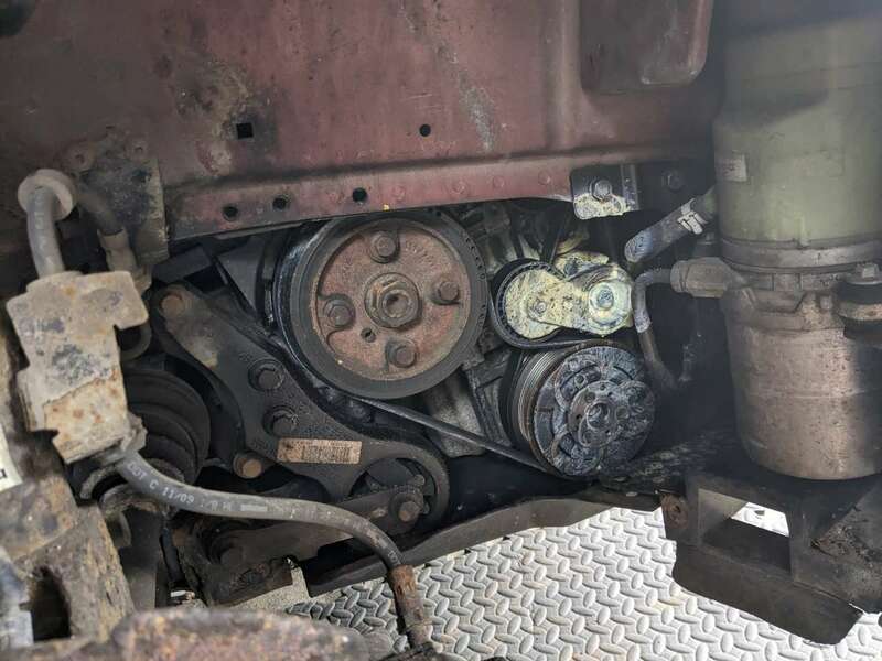

Miss Hedgehog has this, it's a 2010 Volvo C30 D5 Auto. It's the 2.4 litre 5 cylinder diesel. It makes a nice racket in that clattery 5 cylinder diesel way, or it would if you could have heard it over an absolutely horrific noise from the auxiliary belt area.
I like to take as little to do with the arsehole as possible (car for avoidance of doubt), but it really sounded awful and had visions of it letting go and wrapping itself in the crank pulley and fragging the thing.
I think someone has been here before... Not sure what they thought coating the fucker in grease would achieve;
It has a strange setup with two auxiliary belts and two tensioners. One is driven off the crank pulley and drives the AC compressor, the other is in turn driven off the AC compressor and drives the alternator. I was thinking because big engine and smol car that access would be shit but it was actually OK. The upper/rear one was a bit foutery but not too bad.
The bearing on the non greased one sounds absolutely fucked, so hopefully that was our culprit. Just waiting on replacements arriving.
It also had a warning on the dash for "engine service required" and a stored code to do with swirl flaps. They are actuated by a stepper motor which is linked to the swirl flap mechanism with a plastic rod/arm doo-dah made of the same plastic used in Volvo instrument binnacles presumably. The joint on the swirl flap end wears and the arm pops off, seemingly a common issue. I effected an ingenious* and factory standard* engineering solution by sanding the arm down thin, then drilling a hole in the plastic ball part and securing the arm with a tiny cable tie.
