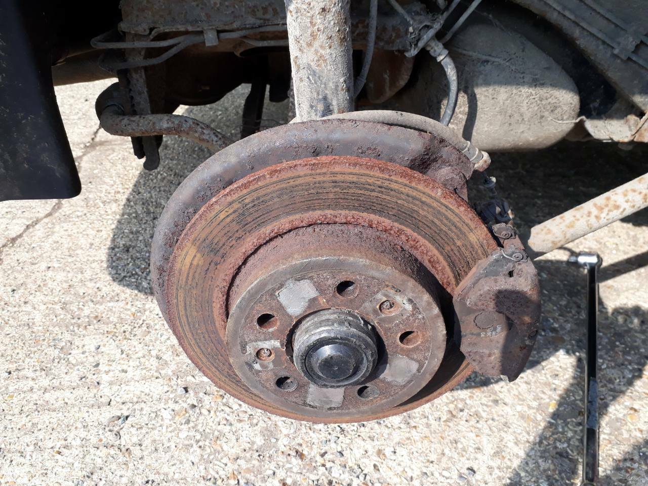

With the lovely sun out and still no petrol to hand (im not waiting and causing traffic jams over 5ltrs of fuel.) I opted to have a nosey at the brakes. The suns shining bright so why not eh?
Skanky wheel off
Skanky brakes
This caliper seems okay i can operater the handbrake ratchet with me hand. The pads and discs are shot. I cleaned them up so that they can function and chucked them on. No money will be spent on brake parts untill the misfire and PAS leak is fixed.
Cleaned up a bit and a splash of lube sprayed on
That wheel tho . . .
