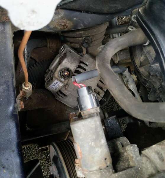

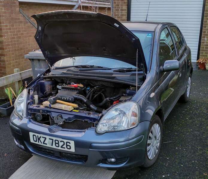

Trying to swap out the seized alternator in MrsDC's Yaris on a rare afternoon without sleet and/or freezing fog.
The fasteners came off easily enough, and the old spark-factory came away from the block bracket with only the mildest of encouragement needed from the Friendly Persuader.
So now the old unit is down the back of the block, nestling on the subframe - and there is NO way to get it out.
The HBOL blithely assures me that unhooking the exhaust rubbers and moving the pipe aside a little will allow the withdrawal of the alternator from below, but this is plainly bollocks as there's all driveshafts and steering rack in the way. Not even close.
So it looks like I'll have to pull the air box, throttle body and inlet manifold in order to get the units swapped, which of course will require new gaskets.
And the motor factor advises me that the throttle body and inlet manifold gaskets are NLA individually - though they can sell me a full gasket set for £100.
So eBay it is, then...but I'm a bit sceptical of their delivery time optimism.

Highly doubt this car will be back on the road this year.
Bugger.

I have the same engine in my Daihatsu Sirion, the alternator will come out the bottom but is a total shitshow of lowered subframe and no access. Going in the top is massively easier because one the intake manifold is out you have LOADS of access.
It took me about 40 minutes to extract the alternator this way, start to finish. I would suggest there is little harm to be done by mingebagging it and reusing the intake manifold gasket in the very short term, you can replace it easily when the new one arrives (in about June)
I thought I'd documented this with pics, but haven't somehow? Anyway, its way easier taking it out the top
If you hate yourself, then @Tubbo gave instructions on how to get the alternator out the bottom if you go back a page in my thread.
Hey, thanks so much for that! Good reading in there...
I think that settles it then - will get the inlet manifold off tomorrow, weather permitting; swap the alternators over and and just put it all back together using the original gasket if possible.
Like yourself, I thought there might be room to manoeuvre the alternator over toward the much less cluttered gearbox end for withdrawal - but the clutch cable and sundry other bits in the way thwarted this approach.
Removal from the bottom end looks like a right old fuckabout, but it's useful to have photos of both processes!
I'm not even sure it's possible to do exactly the same on this particular car, as it's a run-out model with electric power steering (not even mentioned in the HBOL) so has additional motors and gearing lurking above the o/s driveshaft which would also need removal - and I've no idea how I'd even start on that.
So - watch this space, I guess, and find out whether someone with the mechanical ability of a mince pie manages to pull this one off...

Undo engine mount,pull engine forward a tad and you should have enough room.
Have you tried to get it out over the top of the gearbox,I had to do it that way once,but I can't remember on what🤪

This: I'd reuse the gaskets. If there's no sign of air leaks, then great. Continue. If any problems, order the gaskets and change them when they arrive
Last time I did this was to change the spark plugs on my Jaguar S Type (on the V6s you can't access the plugs on one bank with the manifold in place). Put the manifold back on, never had an issue. Car is gone now so I still have the gaskets that turned up later (quite expensive - I should dig them out to offer on ebay)
