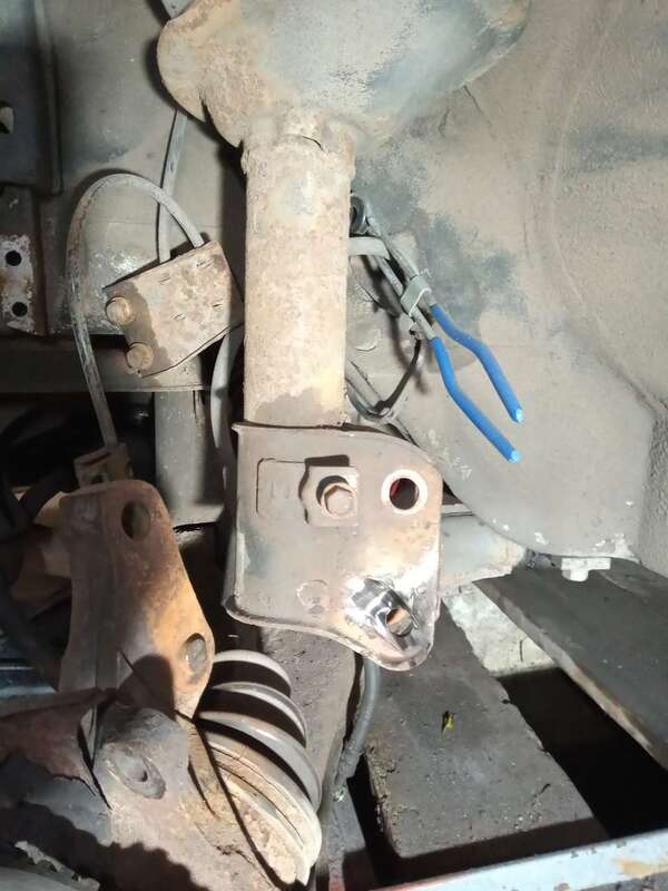

Marina door handles Posted November 1, 2024 Author Posted November 1, 2024 Earlier this month it was MOT time again for the jacked up estate from Fuji Heavy industries....... It managed to fail on a rust hole in the floor pan by the driver's sill. I felt a tad daft that I hadn't spotted it but to be fair I think it was a recent happening and I hadn't been able to get the car over my pit for a quick pre Mot Inspection (mostly because the pit is more of a water feature at the mo and had a Rover stuck on top of it!). Anyway I welded it up in a rush and managed to get a free re test and a pass but not after a brief wind up.... Tester "err your repair has under seal on it - so that's a fail!" Me ...Okay I will scrape it off then... Tester "What kind of weld is it?" Me.... Err MIG and its a continuous run all around the repair panel.... Tester... "Ok you shouldn't have sealed it but I was only kidding, its a pass!" Queue much laughter from the workshop..... Bastards! That will teach me to get it MOT'ed at work! Sadly (or possibly not if you don't like weldy body worky pics) no pictures were taken because of the rush. To celebrate scrapping a pass, I thought I would tackle some issues and give myself another chance to seize defeat from the jaws of victory...... Firstly the front shocks are really knackered (but not an MOT issue apparently) and on one side I new one of the bolts holding the steering knuckle to the shock was a bit seized stopping you do any camber adjustment. So I figured I would start on that side. Bloody hell it is now properly seized and has take some utter brutality to remove! I ended up having to remove the knuckle after chopping and grinding both ends of the bolt away to free the old shocker.. Then I used my ball joint remover to force the remains out... Useful bit of of kit that, especially as I don't have a press. Tada! I think part of the reason this car suffers so much with corroded suspension parts is one Subaru suspension parts quality, pretty sure they come pre rusted and the fact I do use it as a swimming machine! Well it has a 50 cm wading depth and in my neck of the woods that is really useful! Thanks to lack of drainage maintenance by the brassic local council and the current climate we keep getting flooded sections of roads and I do take advantage of its abilities..... Whilst I was on a roll I replaced the ball joint, I had ruined the rubber gaitor removing it and I cannot remember when it was last changed so a new one was duly fitted. I did have to clean up the threads as the bolt really did not want to go back in... Then onto the shocks, I know this is technically the dangerous bit but I laugh in the face of danger! Although that might just be nerves..... Nearly there just got to re fit and torque up all the relevant bits and bleed the brakes (you have to undo the brake lines to free the shocks because Subaru?). I would do this tomorrow but we are off to Oulton park for some Rallying so it will have to wait.... GeorgeB, Scruffy Bodger, Dyslexic Viking and 3 others 6

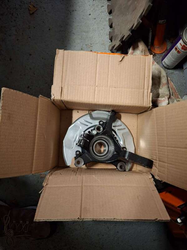

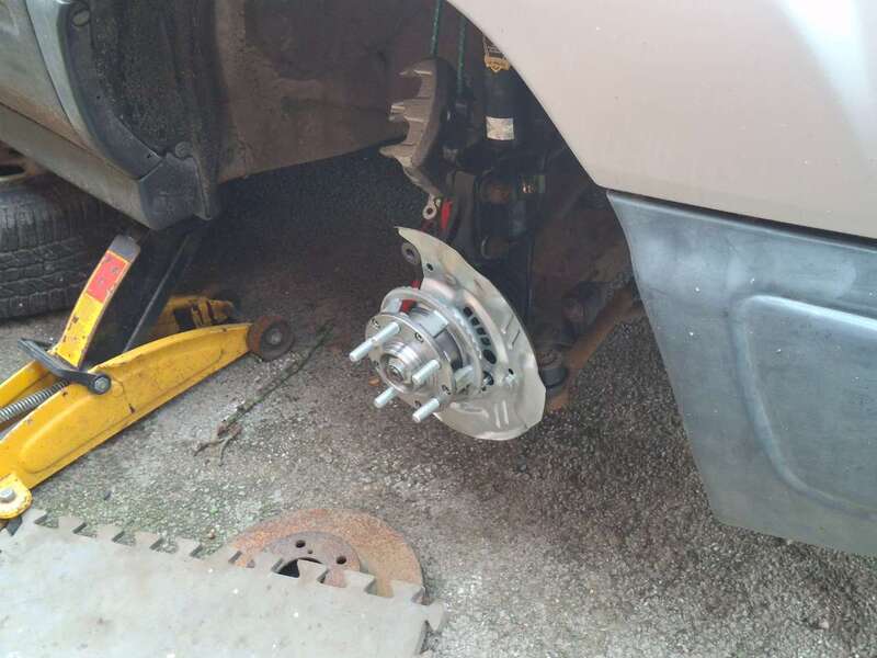

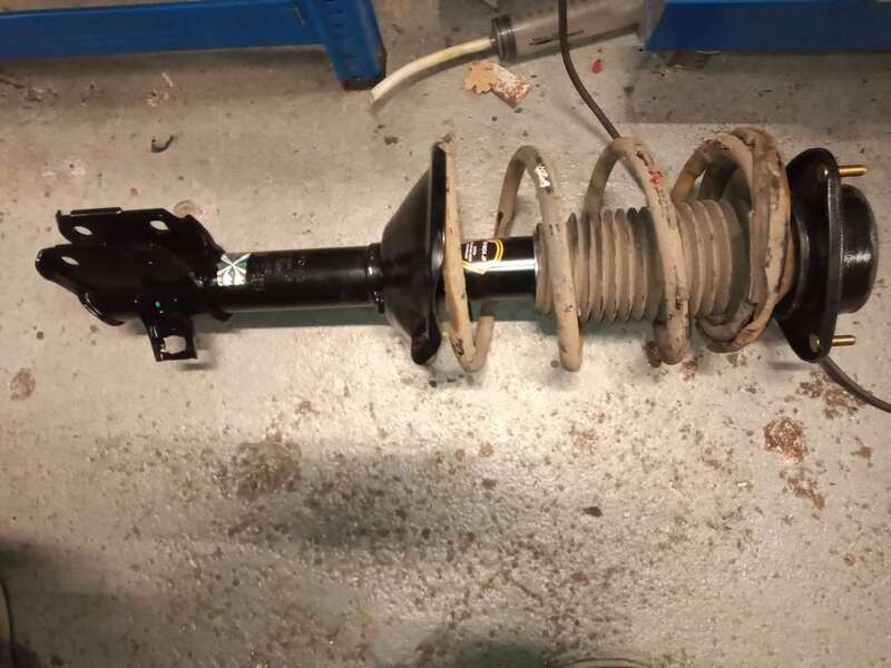

Marina door handles Posted February 1, 2025 Author Posted February 1, 2025 Subaru update, after putting everything back together I found that I wasn't really happy with the old bucket. The tracking felt a bit out, possibly because the rear end in sitting a bit higher had changed the angle of the dangle relative to the front suspension and the new shocks on the front may well have had an effect too. Worse than that though, the ABS had suddenly become really intrusive, triggering every time I touched the pedal as if I was always braking on a diesel spill! The tracking is just a matter of booking it in at a suitably equipped garage as I don't have any lasers or strings.... The ABS issue was a head scratcher, no warning on the dash, so maybe it was a mechanical issue? Well after a bit of rummaging I found the driver's front speed wheel was the original part and funnily enough was a lot more corroded than the rest. So much so it was virtually flat in places. Could this be the issue? So back in early December I removed the steering knuckle and split the hub, here we go again........ The old knuckle actually cracked during the process, so a new after market one was ordered and a new ABS ring. Compare and contrast... I was going to re use the original hub but I got a bit careless with the grinder getting the remains of the old bearing off and took a chunk out of the hub, I was quite annoyed with my self. The new steering knuckle arrived in good time but the hub I ordered a day later didn't show up when expected. The bearing was pressed into place in preparation for the new hub... In mid January the hub finally turned up but by this time I was a bit distracted by a new Freelander shaped purchase. Finally whilst bored on Thursday night I pulled my finger out and got back in the garage... Hub pressed in. Damn it looks good, such a shame its going to be hidden away under the car. Today, all back together on the car. Test drive went well, the ABS fault is gone, just need to sort the tracking and maybe get it a new clutch...... I now have two 4wd daily drivers to swap between until one of them breaks again! Rightnider, delux, Marshall2810 and 4 others 7

Marina door handles Posted February 2, 2025 Author Posted February 2, 2025 7 hours ago, Metal Guru said: I’m not sure how it works but the speed sensor for the ABS seems to be affected by knackered wheel bearings. I had a similar thing with my Impreza. If its the later type, the speed wheel is a magnetic ring in the bearing it self rather than trad separate part. Metal Guru 1
