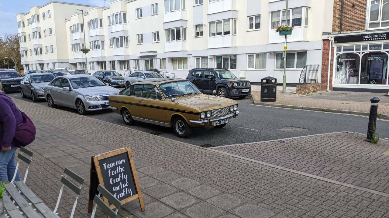

I was pretty pleased to have spotted this in the 1970s/Lee-on-Solent earlier. The 'fastback' makes what would be a purposeful 3-box saloon look incredibly gawky IMHO. It looked great from ten feet but was a bit rust scabby up close. Still, it's been about a decade since I last saw one, so glad it's out and about and being used.
