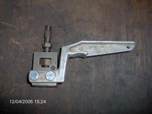

Anyone got a recommendation for a brake pipe flaring tool that isn't shit?
One of these
This is an old Moprod one.........fantastic bit of kit for making neat pipes on the car.
I think you can get modern versions on ebay but not sure how good they are.
Aye, there are a lot of things that look the part on eBay but are utter shit when you get them, even if you don't buy the cheapest.

One of these
Guess I need to find a more modern equivalent that is still half decent, not sure where to look though!

I have one of those Moprod flaring tools and it is excellent! I have used it underneath the car to flare one of the old steel pipes so I could join it to a new kunifer one - not supposed to be able to do that!
