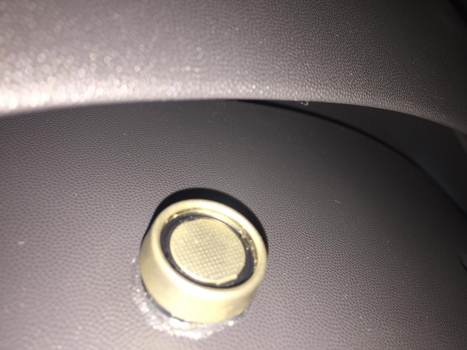

Its a thing for an immobiliser that's probably been bypassed. Takes a thing that looks like a coin cell battery on a keyring.
Some trackers also use them, each individual driver of the vehicle will "log in" with their own key thing.
Looks like a immobiliser type thing - you get a circular keyfob thing that presses onto it.
Like said above, could just be used to identify a particular driver along with some vehicle logging equipment. Some people would use it to bollock the driver that's been hooning like a bellend.
Could be a tracker, but it wouldn't be the first time someone pays good money for an aftermarket immobiliser on a car that already has one.
My mate bought a Saxo VTR with a bill in the history for a £1400 immobiliser/alarm. It took 5 minutes to bypass.
Same goes for all the old giffers parked in Morrisons fitting diskloks to new Corsas etc.
Could be - it's just an ID tag and reader, we used to sell them in Maplin. Used in the days before RFID cards and stuff for access control.
