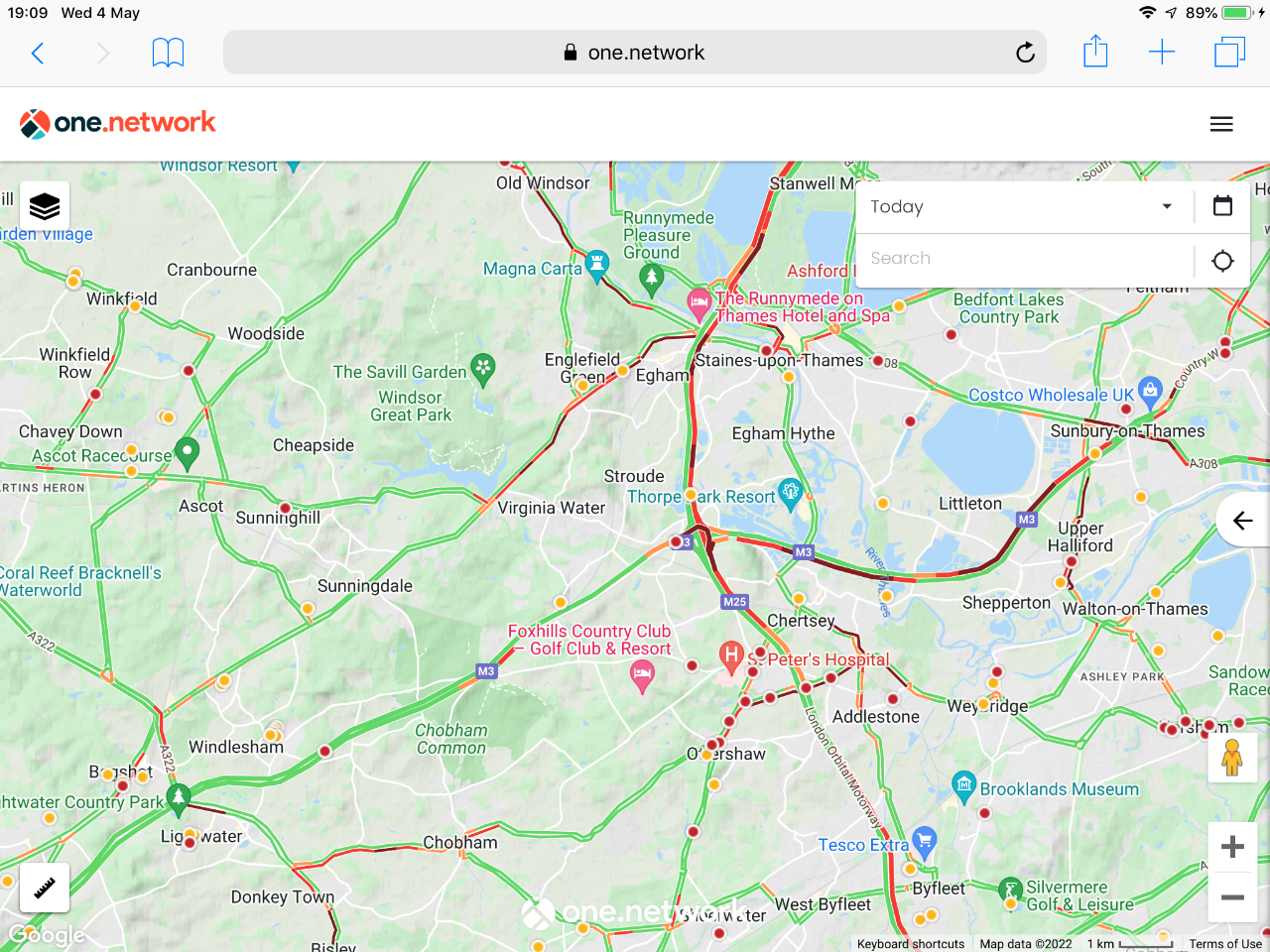

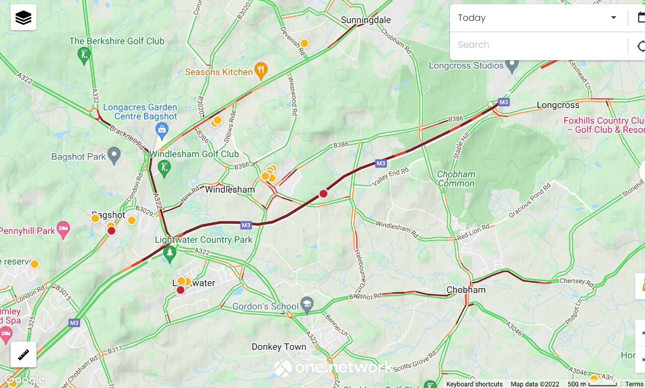

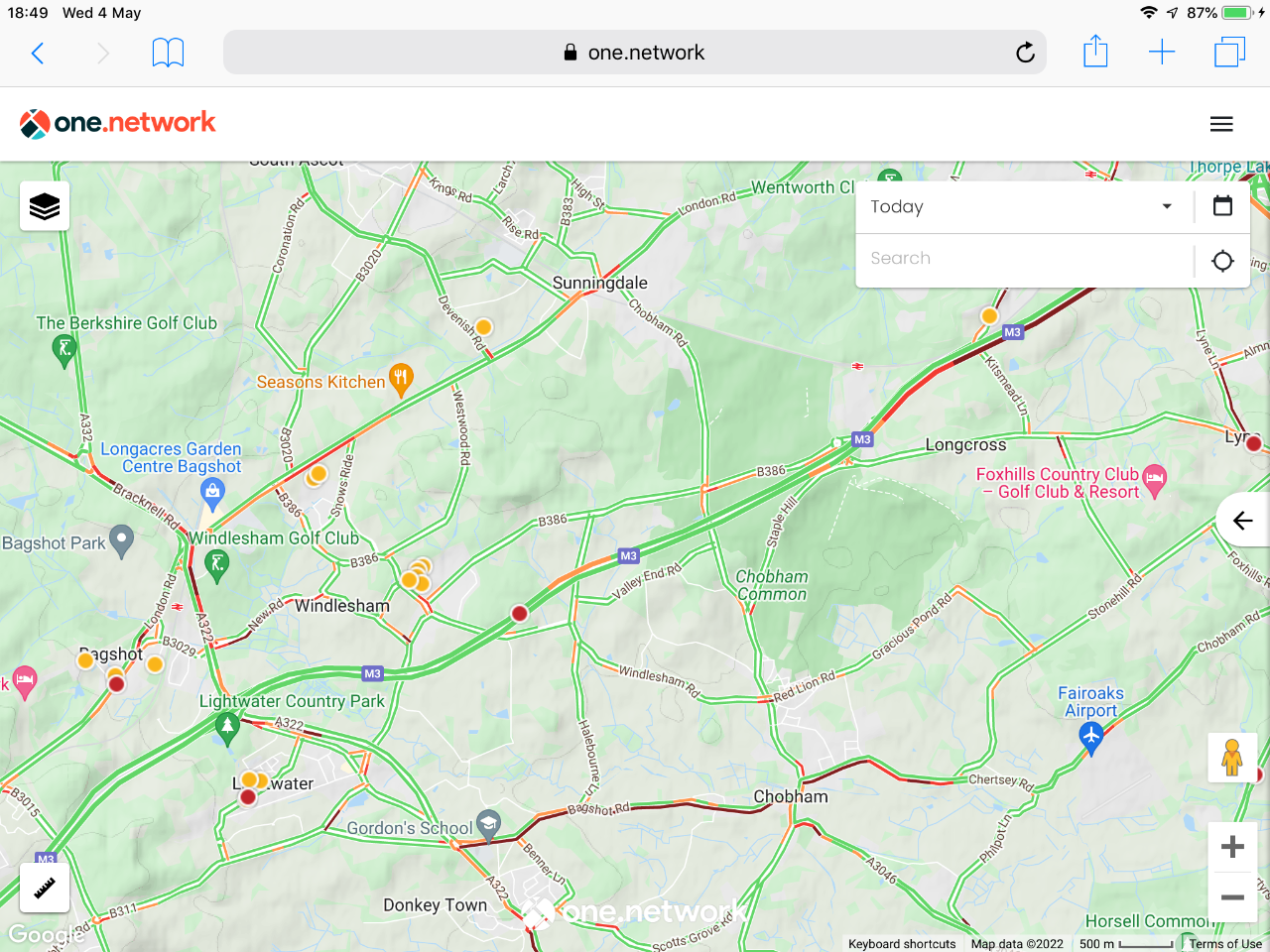

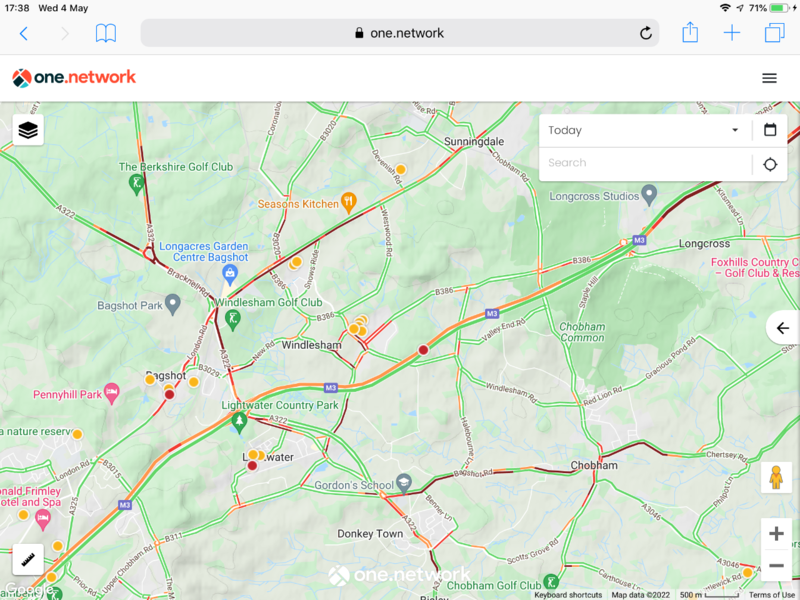

Serious crash on the m3 this afternoon . Motorway closed in both directions for an hour or two. Usual traffic chaos.

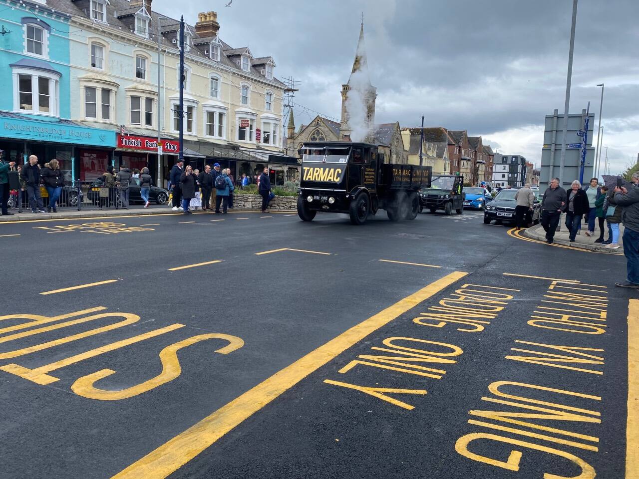

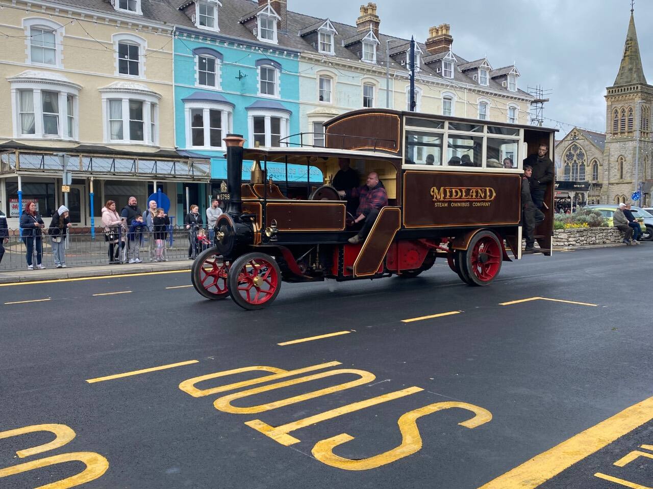

Bugger me! I was standing at a roundabout a couple of hundred yards from you. We also knew nothing about this until we stopped 3 cars back from said roundabout, we abanded the car where it was and watched them go past, one of my daughter’s commented on how many were being steered by women . The pair of little lorries looked as if they should have been driven by children.
Drove the wrong way down a one way street trying to get to The Great Orme road, hopefully no cameras.
An excellent spectacle it was too!

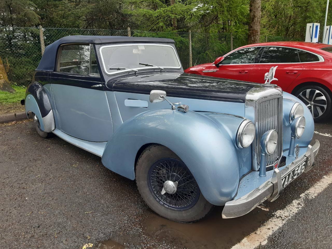

Spotted at the services on the M8.
279647480_522376846211035_4601458268207585962_n.thumb.jpg.bc8277100cf97b180297777e9ef2d97d.jpg
279677017_385355879990683_1228934384656928969_n.thumb.jpg.09fb399cefea9086ad8c01b1ebb34dc0.jpg
Certainly one way to tackle a rainy motorway. I saw a Riley RM earlier as well. Must be the season for early 50s saloons...
