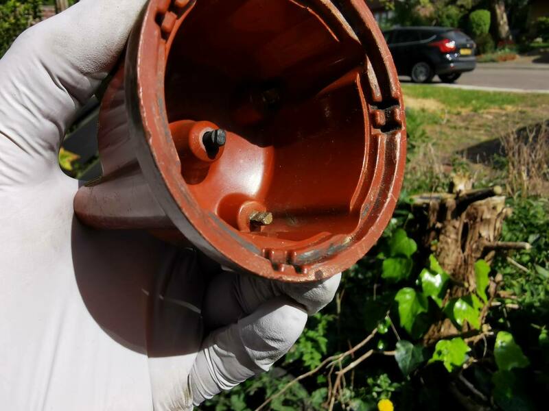

Last time I had TPA out she wasn't behaving quite right just as I got back to the house.  I also thought she was wandering around the road more than usual initially, right up until the point where I got out of the car at my first destination and realised it was a lot more breezy than I thought it was when I left the house!
It felt like I had an intermittent miss, which on closer examination seems to be a clogged accelerator jet I reckon.  As cracking the throttle open there's a brief pause before the engine picks up.
Did give me a good reason to have a nose around the engine bay though, as to be honest I don't look closely at things anywhere near as often as I probably should.
I've done away with the screen type fuel filter, as it just doesn't seem to be doing anything and I've had several people tell me that it will unscrew itself and I'll die in an inferno at the side of the A5.  Despite the fact that how I had it fitted all of the components where fixed in position so couldn't rotate.  Not like it was dangling by a fuel line.
Nevertheless, these undeniably do a better job of filtration.
Have tried from yet another stockist for these filters, let's see if these ones don't fall apart internally like the last lot did.  Place your bets...
Ran out of time this weekend but I'll take a closer look shortly.  Most likely I just disturbed a bit of crud when I swapped the gaskets out recently.

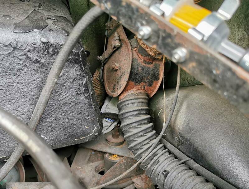

I did spot something after the test run today though which had the potential to be really "exciting" if I hadn't noticed it.
See anything amiss there?  See the line between the driveshaft and the back of the hub?  That's a gap.  That should not be there.  All four bolts on one side and three on the other were several turns less than finger tight.  Now I admit to probably have forgotten to properly tighten the carb top cover screws last week, but making sure the driveshaft couplings were torqued up properly was *definitely* done when I installed the engine.  So they have loosened themselves over time.
Given the vibration and shock loading that coupler will be subject to running 10" wheels with the state of the roads around here that's not necessarily a massive surprise, but the potential for Bad Things to Happen if a driveshaft came adrift means it's a checklist item that has definitely been added to the regular service regime.  I think I will look to add some locking tabs to there too (there are already spring washers under the heads).  Just glad I spotted this as the nearside is pretty much entirely hidden from view unless you're under the car as the battery tray and heater ducting obscure your view.
One you might well want to take a look at on TWC when you get a chance @dollywobbler given you've had the engine out there too so the couplings have been apart in recorded human history.
Think I basically need to just spend a day going over every single nut, bolt, screw, clip or other fastener on this car and make sure it's not managed to shake itself loose based on my experiences over the last week!

I think a lot of this is just standard on cars of this sort of age, it's why you need to keep your eyes open whenever you're doing anything on the car.
In these days of locking fasteners, thread lock and things being torqued up to 7000000 foot pounds it's just not so much of the sort of thing that happens on moderns.
The carb top couldn't actually have gone anywhere, the driveshaft however absolutely could.
The air cleaner I really should have spotted before it exited the vehicle.
If we had actually lost a bolt I'd hopefully have been notified by a vibration as it would have knocked the driveshaft quite a bit out of balance.  If not however and we'd lost three, the coupler then would have been able to shift.  This would likely have let it move sufficiently to contact the surrounding suspension arm.
Best case?  It makes an absolutely godawful racket and vibration, I do an emergency stop wherever I am and end up getting recovered.
Likely alternative?  It jams itself against the suspension arm, locking it up.  I suddenly find myself with a single locked up rear wheel.  The result of that is almost definitely an interface with the scenery or other traffic.
Or the driveshaft exiting the vehicle entirely, quite possibly through bodywork and ending up going through someone else's windscreen.
I have been in a RWD car (not driving, not my car) where the propshaft came unbolted from the diff without any real warning, so this sort of thing can happen.
You can see why I've decided that a locking tab is a good idea for these bolts.  In the meantime I'm putting a paint marker stripe on them so I can at least easily visually confirm they haven't moved.
To be fair, a lot of this is the sort of things I'd expect on a car of this sort of age, especially given the horrendous state of the roads around here.

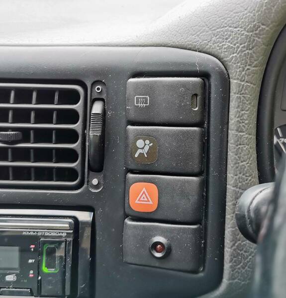

Disconnect the battery and wait five minutes before touching anything to ensure there's absolutely no way I could piss off the airbag.  I disconnected both terminals just to further reduce the odds of something managing to drop back into place.  The roll of tape is wedged in between the positive terminal and battery post.
This serves a double purpose here...one I obviously don't want the airbag to deploy in my face, though the odds of that happening are really small in reality.  The second is that I really don't want to trigger a fault in the system as there's no way to reset the warning light without VAGCOM apparently.

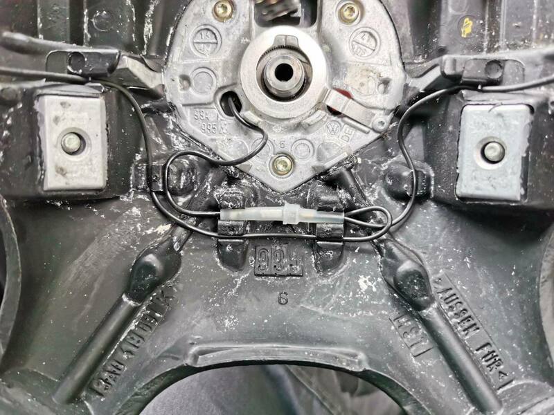

Before the three small Torx screws holding the clock spring housing to the back of the wheel are unscrewed.  Then the main steering wheel retaining nut (24mm) can be undone.  In theory.
Turns out it was biblically tight.  Not necessarily a bad thing given the application, but a problem nevertheless.  Helpfully I do own exactly the tool for this job.
Which proceeded to spin the nut off as though it was less than finger tight.  Impact guns are bloody useful tools.  This one is heavily and unwieldy in tight spaces, but it's one of the most useful bits of kit I've ever bought.  When you need one you really need one.
The wheel is then ready to be removed.  What you want to do here however is to thread that nut back on a few turns so you can remove the wheel in a controlled way.  Give it a firm tug towards you and it should slip off the splines.  If you didn't have the nut there you'd probably smack yourself in the face with the wheel and tear the airbag clock spring assembly to bits.
With the wheel loose the airbag and horn wiring can be carefully threaded out through the old wheel as it's removed.
Reassembly as the manuals love to say is simply the reverse of disassembly.  Though unlike VW originally I did take the time to fit the horn wiring into the grooves clearly intended to keep it tidily out of the way.
Correct, or at least it's the case on the later A04 platformed cars and given the presence of an airbag in yours I'd assume so too, even if it's on the older platform.

This afternoon the new rotor arm, and more importantly distributor cap were dropped off for the Trevi.
Let me try to visually show you how worn the old cap was.
Those contact post surfaces should be flat.
That's the best part of a millimetre of material that has been worn away.  It's no surprise the car wasn't running well.
New cap and rotor on vastly improved things.
...For about 1/2 a mile of the test drive, at which point I spluttered to a halt at the side of the road.
Managed to get going again...for about another quarter of a mile.  Wound up having to push the car out of the way and eventually roll into somewhere out of the way where I could fault find.
Still had a plenty strong spark from the coil.  So initially I wondered if we'd got a fuelling issue.  Closer look though showed no spark coming out the distributor cap.
Well that went well.
No idea if it's a case of the part being wrong or just poor plastic that started breaking down in ten seconds flat.
Old rotor arm back on, we were back to running pretty well.  I got back home under my own power then and set about doing a bit more fine tuning.
