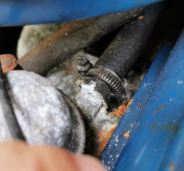

Quick job today was to bridge the broken bit of the vent line from the fuel tank.  Oddly just one bit had gone crispy and shattered, the rest of the tube is perfectly pliable.
Apparently this worked as the boot (and by extension the entire interior) no longer stink of fuel.

I've confirmed that it does action supply hot or cool air properly depending on the position as well rather than just the lever moving and doing nothing.
I think a new set of heater hoses should probably be on my shopping list.
Mmm...crusty.  Though after 44 years I think we can forgive that and say they've done their time.
Think in the interests of reliability I'll be looking to change all of the coolant lines.  I need to pop the aux belt off and check to see how the bearings in the water pump sound, as something is making a bit of noise, most noticeable when the engine stops.  Reckon it's either the water pump or the alternator.
