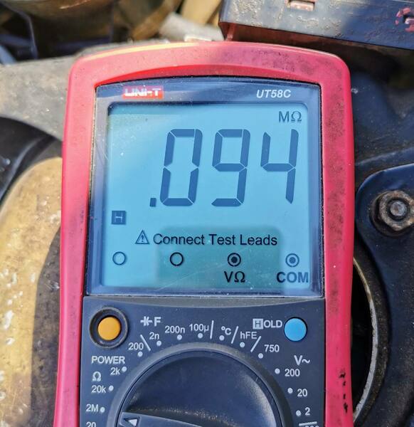

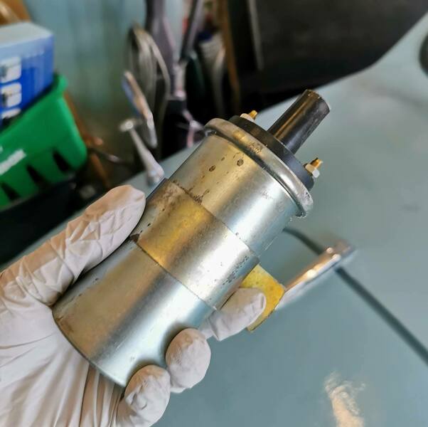

The primary side of an ignition coil should be pretty low resistance.  It varies from coil to coil, whether there's meant to be a ballast resistor, etc...but it's always going to be in the region of 0.5 to a couple of ohms.
Not 95K ohms.  Yep...that would explain why we had no spark.
Now I had a vague memory of having a spare coil floating around in the back of the garage from when I did the injection conversion on the Lada (doesn't everyone?).  That was several years ago now though...odds on it still being where I thought it was?
Hey, look what I found!
No idea how it would compare to the original spec wise, but they used a similar transistorised it ignition setup so should absolutely be good enough for testing purposes.
I confirmed that this absolutely does have output when tested off the car.  It completely ignored my intended ground point and gave me an almighty belt instead.
Cue finding a convenient bolt hole to temporarily attach it to.
This is important as the coil secondary winding grounds through the case.
This has restored spark.  It however isn't the best spark, it was a step in the right direction.

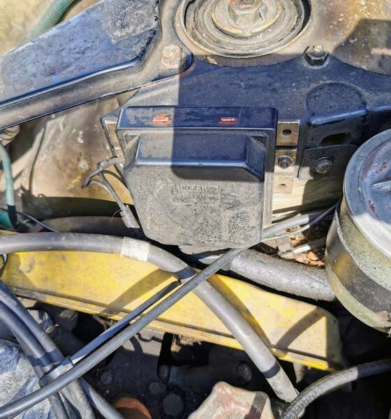

I did find a couple of possible issues on initial inspection.

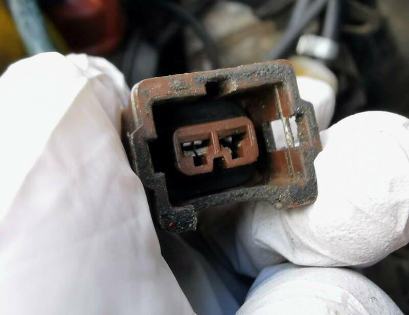

Firstly this is the connection between the pickup in the distributor and the ignition amplifier.  One of the spring contacts has clearly been damaged.
The connector also doesn't clip together in anything like a secure manner.  If I can find a weatherproof two pin connector this will get replaced as it's exactly the sort of thing that's liable to cause random issues down the road.

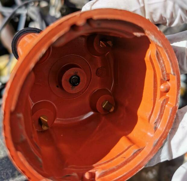

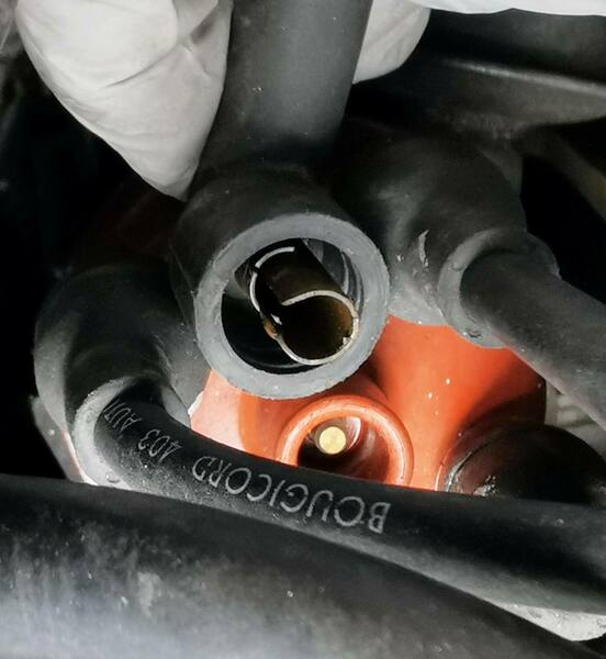

Another spot was that the distributor cap and the leads don't seem to match...the cap has pin type contacts in rather than the circular slot in type the leads are designed for...
So there's about a 1/16" gap between the contact and HT lead on the king terminal at least...that won't be helping anything.  I didn't get as far as checking the other terminals, as I have seen some caps where the centre post is different.
The old HT leads (they were replaced in an effort to resolve the running issues back in November when it was refusing to start) were helpfully in the boot, so I made up an "adapted" king lead by squishing the contact in one of the old ones.
No change.

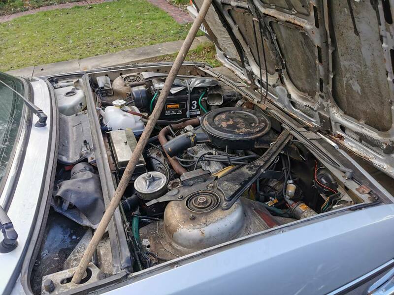

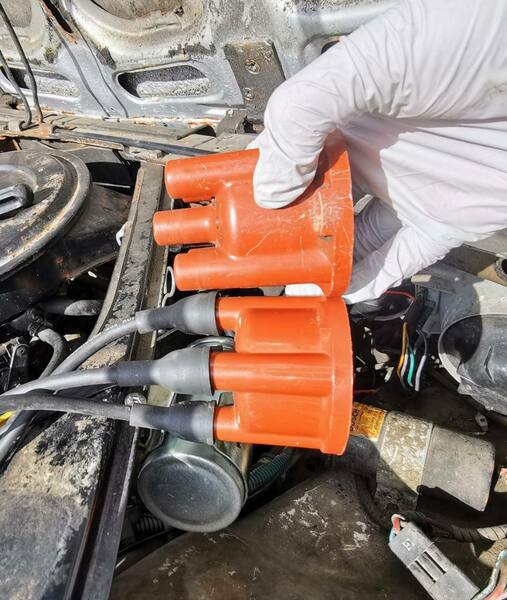

Okay, little bit more tinkering.

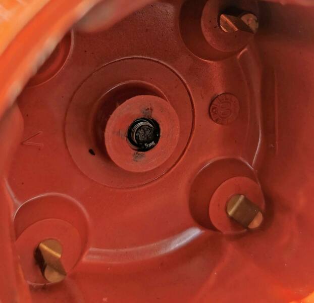

First thing's first...thou shall not overlook the obvious.
We had a more-or-less mostly present albeit nowhere near as strong as I'd like spark at the coil, but very intermittent at the plugs.  Let's check the cap.
Uuuuh...
Well that's not going to have been helping anything.
Comparing the old distributor cap (it was in the boot) to the one on the car shows the new one to be a good bit shorter.
Obviously the internal height isn't necessarily exactly relative to the outer moulding as I don't know how thick it is...but I'd not expect to see this big a difference.
The old one also has the correct socket type for the HT leads on the car.
The old rotor arm was also shorter than the one on the car.  So I swapped both of these out for the original parts.
Result being the car running a lot better than it was.  It's still not right though as the spark isn't great and is intermittent especially at lower engine speeds.  I think it's running better than it was when I last worked on it, but it still isn't right.
Wiggling that suspect looking connector doesn't seem to have any effect on anything so it's likely innocent, though I'd still rather see it changed for long term reliability.
Suspicion at this point lays evenly between the ignition amplifier module and the pickup in the distributor...not sure really where to go from here.  I seem to get a fairly steady spark at cranking speeds and just don't have the equipment to test to see if there's a clean pulse being delivered from the pickup with the engine running.
Have to admit I'm more at home with points and condenser setups where ignition systems are concerned!  I've never really had to do much with the likes of this system.
Thoughts?  Ideas?

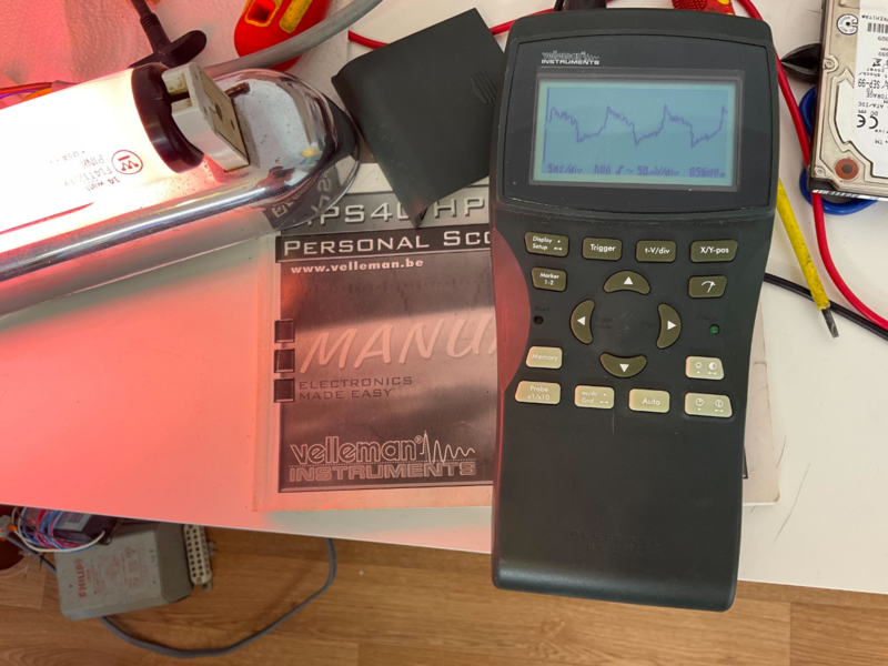

what sort of test gear would you need to check that, my obvious thought is the awesome Sun Microcomputer II Motortester
but I dont know if that has what you need here,
if its a portable scope you need then I have one that @catsinthewelder kindly gave me
it seems that the probe that came with it is bad, as I was never able to get a trace on it, I always thought it was a Layer 8 issue, so I put it aside, however borrowing one of the probes from my Rigol scope which I upgraded to recently,  has it displaying a trace without issue
so your more than welcome to have it :) if its what you need in this case? (or if you want in general!), its a Velleman HPS10, and I have its manual, and somewhere its PSU (although it runs off and  includes 5 AA's)
EDIT: heres a photo of it showing the voltage waveform of an F14T12 (through a High voltage diff probe hence why the voltage measurement is off)

Has the ignition amp been replaced at all? Also check the HT lead boots and insulation just to be on the safe side. Considering the issue I'd also be looking at the ignition amp wiring and the king lead. It sounds to me like either the sensor in the dizzy or the amplifier is cooked, or there's deteriorated wiring.
Leads are all pretty new and in fine shape.  The wiring between the distributor and ignition amp is only accessible at the ends as it's routed in along with the rest of the engine bay loom, though aside from the one connector mentioned above *looks* to be in fine shape.
No signs of the ignition amp having been changed, sadly one of very few spares that aren't in the boot.  I do have a couple floating around from the Saab and Lada days, but they're totally different types so no use in this case.
Assuming one can be found at least it's a simple enough thing to change.  I'd definitely be trying that first I think as the distributor is an absolute pig to get to.

That would be a useful thing to have for jobs like this.  I've got a bench scope (albeit in the loft at present as I've not been doing much electronic work lately) but nothing portable.  You'd not be wanting to use anything like that for precision measurements, but for things like this where you're just looking to see what sort of waveform you've got and a ballpark idea of amplitude it should be fine.
The Sun 1215 could definitely have been used here - though it's still in the conservatory...and it's a two man (minimum!) job to move!
Yeah as mentioned your more than welcome to it :) as its surplus to requirements here, just need to figure out if I can get it to you before the Trevi needs to go back!
as im not sure when anyone here is going past the post office! (the only thing I dont have for it is a probe, Ill include the one it came with, but im not sure how well it works!)

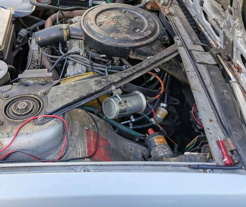

Wouldn't worry about it too much for this instance.  It's probably going to be a matter of testing the ignition amplifier by substitution and seeing where that gets us.
If that doesn't sort it then the distributor will need to be looked at.
Which will be horrible as access is horrendous.
I guess if you pull that brace that runs between the front panel and the strut top plus the alternator top bracket off it wouldn't be too bad...
It doesn't look too bad there, but actually getting a hand in to it is bloody awkward.  Especially when the engine is hot!

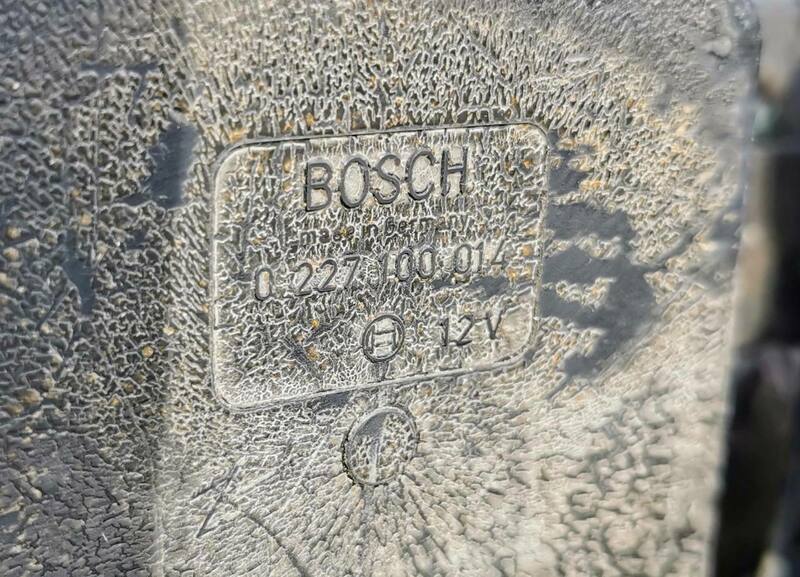

I think we're going to try to track down a replacement ignition module and give that a try.  Not a bad thing to have a spare of on hand anyway even if it doesn't turn out to be the specific issue here.
Looks to be a Bosch 0 227 100 014 if I'm reading it right from the photo.  Will have a look in better light tomorrow.

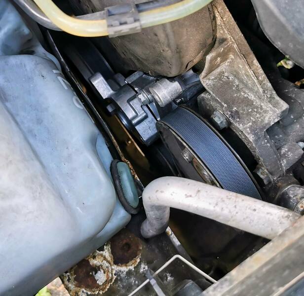

In other news the Caddy has been picked up and now has a shiny new aux belt tensioner, idler pulley and belt.
Totally forgot to pick up the box with the originals in to see how knackered they were or weren't.  It's definitely a lot quieter now than it was so something was definitely unhappy.  Will retrieve that from behind the passenger seat tomorrow for a closer look.

Edit: Corrected part no for ignition module now I've cleaned it up so I can read it!

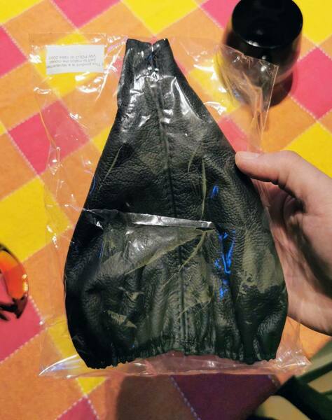

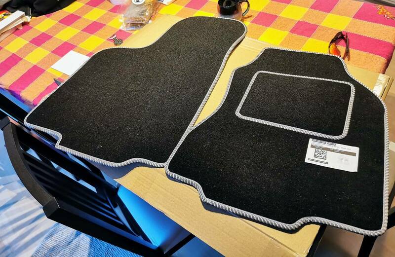

Nothing car related done today as I've been otherwise engaged, though a couple of things for the Caddy did arrive.
Replacement for the tatty gear lever gaiter.  I have significant doubts about whether this will fit...but for the price it was worth a punt.
If not I'll just make one.  I'm sure we've got enough scraps of suitable material floating around somewhere.
Other thing to turn up was a set of proper floor mats.  The ones currently in there insist on fucking up behind the accelerator pedal.  Which is irritating the first couple of times - after the three hundred and seventy-fifth time it's downright maddening.  Hopefully these will fit better and put a stop to that.
Went for grey trim as it seemed that understated would look the least out of place in the cabin.

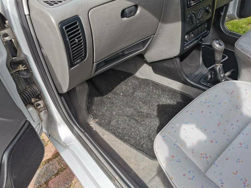

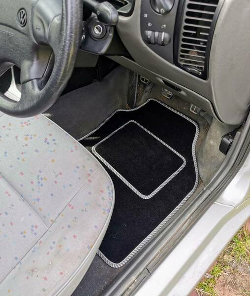

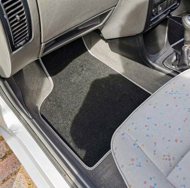

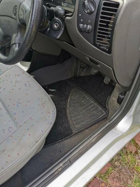

Another busy day so nothing much done on the cars aside from a couple of real quickies.
New floor mats went into the Caddy.
Before:
After:
Much better.
Really good service from www.simplycarmats.co.uk - they went out of their way to make sure I had exactly the right parts, down to the type of fixings (apparently it's quite unusual for a Caddy not to have mat retainers on the floor).
Also before:
After:
Much better, though it's only *just* big enough.  So I suspect it will wind up pulling itself off again...it was £5 though so was worth a punt.

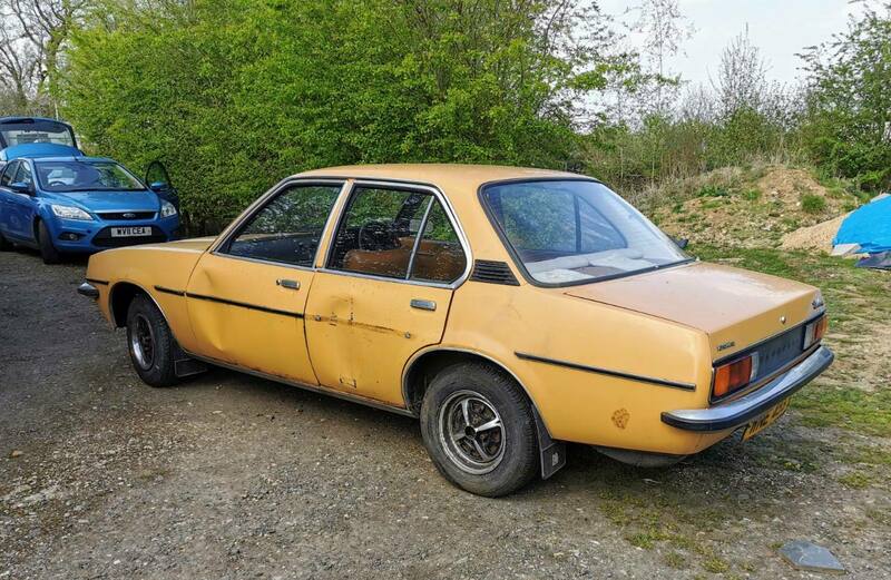

Had the opportunity to get a few things ticked off on the Cavalier today to bring it into a more user friendly state for transportation.
[] Replace the very flat nearside front wheel with the spare.
Old one off...
Good spare on.  Job done.
Not including the walking the whole way back to the far end of the field and back because I forgot to pick the key up before walking up to the car, just over six minutes work.

[] Non Running State.  Last time I was at the car it seemed to be running quite well, right up to when I blipped the throttle at one point when it died.  A quick bit of diagnosis revealed that we had no spark, and that the points were staying resolutely open circuit.  However we were short on time and didn't have the screwdriver needed to get the distributor cap off, so just left it be.
I was initially quite worried as the screws on the distributor cap appeared to have been tightened up by the Incredible Hulk and one was threatening to round out on me.  After no small amount of very careful perseverance I did get the cap off.  Bit of a scrub of the points with some Emery cloth seemed to sort things out.  Flicking the points to see if we got any sparkage proved two things.  One, we did have spark.  Two, that screwdriver was far less well insulated than I thought it was.  That's the third time I've been belted by a HT system in the last 48 hours.  The Trevi has got me twice so far!
That sorted she started first touch.  Meant I was finally able to move the car (albeit very carefully as the only brakes I have are provided by a very poor handbrake on one wheel it seems).  This has also highlighted that the clutch release bearing sounds distinctly unhappy.  Guess I'll be doing or getting a clutch done in the not too distant future then.
This is assuming it's a sealed bearing and doesn't need to be periodically lubricated as per the old Skoda ones.  Can't really see how you would access it for that though.
First time I've had a look at it not tucked into a corner.
That's very much the good side.
Standing back from the car it's more obvious that the damage to the doors is from the fork lift/loader that was used to move the car around when the previous storage location was being cleared.  A shame as it is damage that could easily have been avoided, but on the flip side it's nothing too hard to fix.  I'm just grateful it wasn't plucked out by a strap under the roof.

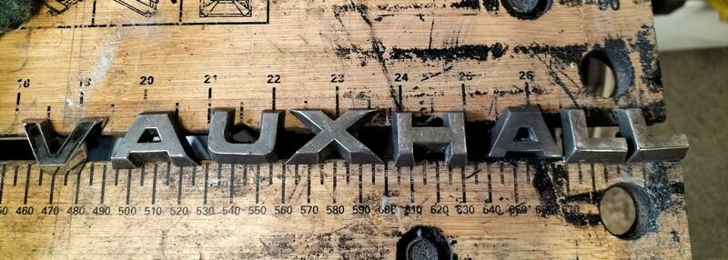

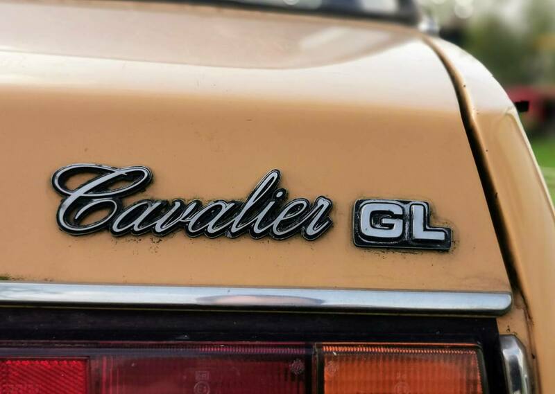

I also seem to be missing the "Vauxhall" text which should be between the tail lights.  Hopefully that won't be too hard to track down.  I imagine it should be easier than the more model-specific bits at least.
I let her run for a while to get up to temperature...top radiator hose started to get warm after a while...
Ah...no temperature gauge.  Now there are plenty of things I will happily do without in a car, but a working temperature gauge is not one of them.  Thankfully 90 seconds of detective work under the bonnet found a stray wire and a post for it to attach to on the thermostat housing.  Result?
Much better!

[] Rear silencer.
[] NSR door rubbing strip.
[] 3 X Chrome wheel rings.
[] 4 X Wheel centre caps.
[] Vauxhall badging from rear panel.

I just hope I don't end up having to graft large percentages of the bodywork back together!  I am slightly nervous of what those shiny chrome will covers may be hiding!
I really did try not to buy this car...I specifically avoided even going near it the first time I was at the FoD after it arrived there.  I knew I'd wind up asking "how much?" If I did look at it.
Then five minutes later it was put up for sale...and I went and looked at it.  Yep, the result was inevitable really!
Seems like it should be a good usable classic once sorted out.

I think I have a Vauxhall script in the garage, I was tidying up the other day so I know where it is! Will go and check
Edit: yes I have! I think it was off a Chevette about 25 years ago! Let me know if you want it bud
3 hours ago, dave j said:
Looks like a great project. I really like the shape of the mk1 Cavalier.
That would be most appreciated!  Imagine that's the sort of thing that getting reinstated will immediately make the car look like far less of a "project" and far more like a complete car.
Trevi - my Panda had absolutely infuriating running issues.
Turned out to be the wiring on the dizzy body for the hall sensor being eroded and slightly shorting.
Not that it was obvious, and I only found it after grabbing the dizzy cap after fording a stream, while the engine was running...
Wouldn't necessarily surprise me if it were something like that.  Really hoping not as getting the distributor out of this thing will be an utter pain.
Fitting the new ignition module has definitely helped, though it's still not quite right.  Having said that the distributor cap is incredibly badly worn (the contact area on the posts have literally worn out to be C shaped rather than flat) so it's never going to run right with that.  A new cap and rotor arm are on the way...so we'll see what the state of play is then.  At that point the distributor itself is basically the only thing left in the equation, so it would have to come out for inspection.
