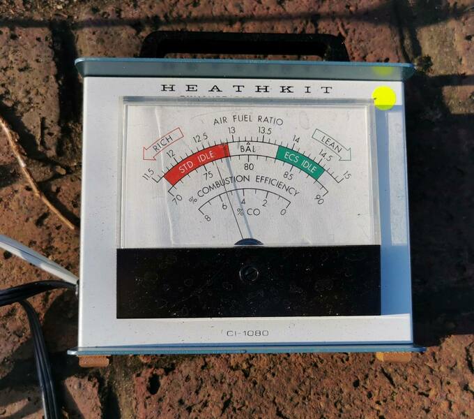

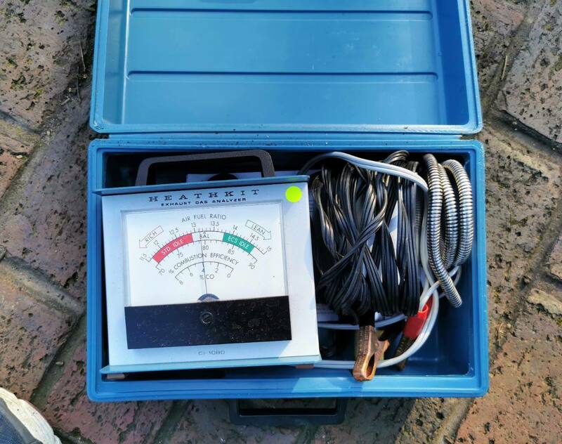

I decided this was a good time to bust out this bit of kit and to see if I could get the idle mixture set a bit more accurately.
Imagine this can only be slightly newer than the car.
I've found this is a tricky one to set up by ear.  There are two reasons for this: One is that there's about half a turn on the idle air screw between stinking rich and so lean it falls on its face and stalls if you so much as breathe on the throttle.  Secondly is that because of the length of the intake path for such a small engine (I'm sure the hard 90 degree bend right after the carb does wonders for gas flow...) means that there's quite a substantial delay between you making an adjustment and the engine reacting.  I also found that the idle tended to wander enough on its own to make it hard to judge.  So "good enough" was where I left it before.
The hope was that this would allow me to see better what I was actually doing.
Turns out that at idle she was waaaaaaaaay lean, at about 2% CO.  Which for an injected car wouldn't be far off, but for an old school engine like this is way off.
A bit of experimentation revealed that she seemed happiest with it set to around 5.5% - which if memory serves is about where my old Metros were happiest too (hence the ritual of having to back the mixture off a couple of turns before the MOT every year).
The emissions test for an engine of this age is simply a visual smoke check, the 4.5% limit not applying until a few years later.  Though I will need to check after a couple of hundred miles to make sure we're not risking fouling plugs.

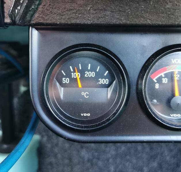

One thing that is visible is that trundling around town she is definitely running a touch cooler, which ties in with the indication from the exhaust gas analyser that the engine was running lean.
Reckon we've knocked maybe 20C or so off, haven't been out on a longer high speed run to see if that's carried over to that sort of situation too - though expecting less change there.

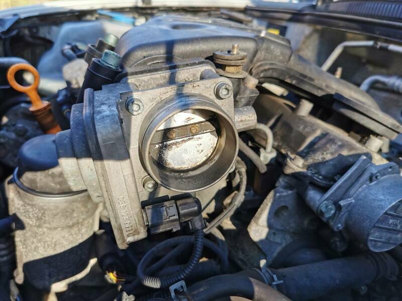

That's a throttle valve which sits between the intake manifold and airbox on the Caddy - presumably something to do with the EGR as I've no idea otherwise why you'd have a throttle on the air intake side on a diesel...unless someone knows more about the theory of operation of things on the SDI engine in which case I'm all ears.  No, seriously... I'm honestly curious about how this lot works.
Intake itself looks pretty grim too... though kinda hard to tell how bad it is given it's made of matt finish black plastic.
At some point I probably will pull it off for a thorough clean - not least because I'd like to clean the top of the engine properly and the intake is kinda in the way.
I wanted to clean this valve up a bit as a test.  We have one persistent fault code stored:
01283 - Motor for intake manifold flap (V157) - Sporadic - Open/short circuit to ground.
Also P1441 - EGR Valve (N18) Open circuit or short to ground...but that's because I have unplugged it as the system is plainly misbehaving at the moment.  So that code is expected.
Not expecting miracles, especially as there's something conspicuously rattling around in the actuator housing...but let's give it a bit of a scrub anyway.
Not going to call it clean but it's a lot better.
Unsurprisingly absolutely no different.  The once-per-second engine speed "twitch" is back, a d huge clouds of unburned diesel out the back on light throttle.
Until I unplug the EGR solenoid, at which point it goes into whatever fallback mode it has, just leaves that intake throttle open and idles smoothly and stops smoking.
Given that we have a definite fault code stored for this assembly I think it's the first thing we need to try to sort.  One other reason I pulled it out was to find a part number, helpfully stamped on the front...but I completely missed and thought it was underneath.

A suggestion was made on another forum that the issue I was having with the Caddy could be down to that throttle unit having lost track of its home position so was closing too far, choking off too much of the air supply.  That fit pretty well with the symptoms I was seeing.  The tinge of blue to the smoke as well, as it's basically resulting in a shedload of vacuum being applied to both the EGR and PCV systems.
The suggestion to try in that case was to physically remove the throttle plate from the assembly...figured I'd nothing to lose really as it will be getting replaced anyway.
What do you know?  It only bloody worked.  We now have a non-surging, non-smoking engine even with this connected back up.

As the weather was nice today I had TPA out again.  Probably the most unusual thing to pop up on the ANPR camera used for charging in the Brunel Centre car park today.
It really does seem that having tweaked the mixture more towards the rich side of things has got rid of the occasional tendency for the car to spit back through the carb.  That's two afternoons of use now without it happening once, and I'd usually have expected it to have done it at least once or twice in that time.  Throttle response under very light load feels far more predictable too (though the CVT always makes it feel a bit "strange" compared to a car with a conventional drive setup).  So I'm tentatively calling that a win I think.
very pleased to hear the carb tuning is having a positive effect on things! hopefully the spark plugs behave themselves still with the richer mixture :)

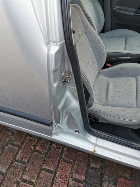

Had a very brief look at the Cavalier today.
The bulge in the nearside front tyre has evidently gone "pop" at some point over the winter so that wasn't holding air.  Other three seem fine.
We dug the spare out and it seems to be holding air just fine, so will get that swapped over shortly.
In retrieving it I had to retract my comment about the interior having stayed surprisingly dry as the boot was a different story!

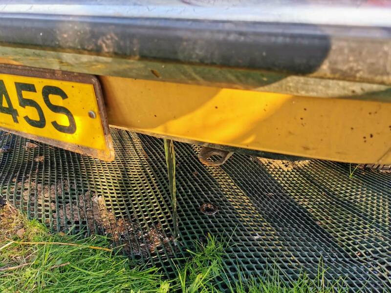

Well at least we know there aren't holes in the boot floor!  It had been draining via the bung for the fuel line.
With bungs pushed out on both sides the water was removed.
Took an impressively long time to drain through two 1" holes.

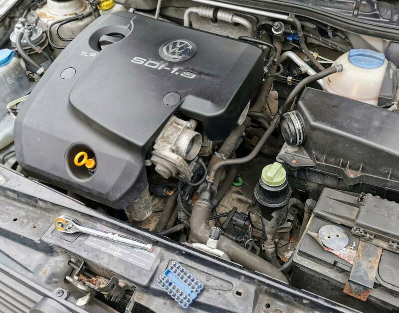

Got the new intake throttle body installed on the Caddy today.
This is behaving very differently to the one I took off, so there was definitely something amiss with it.  This sharply flips open/closed precisely in time with the EGR solenoid cycling - though you can only tell it's doing this if the intake hose is off.  So the old one was definitely acting up.  It used to close fully and then just twitch open very slightly (which was the surging you could hear).  That's why it was smoking, as the air intake was basically cut off!
With everything assembled as the factory intended we had a smooth idle and no smoke.
For reference, this part number looks to be used on a plethora of models in 1.9SDI, 1.9TDi and 2.0TDi versions.
Everything was then put back together properly and we went out for a longer test drive.
I did manage to launch the intake hose clip for the air filter end a good twenty or thirty feet straight up in the air while trying to compress it.  I still hate those bloody spring clips.  Thankfully this one just went vertically up so I caught it.  I did have a moment of panic where I thought it was going to land on the company car parked next to me.
That throttle plate sitting on the battery is definitely from the old throttle body.
Be interesting to see with it running the correct timing map without logging sporadic error codes etc if the economy changes at all, though it's managing mid 40s already which around here I consider to be pretty good anyway.

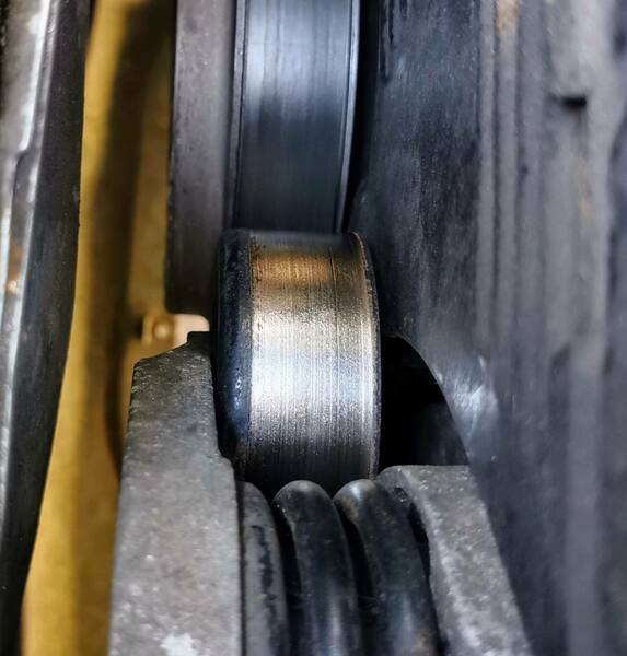

I do, but one of the pulleys is definitely noisy, especially when cold.  The surface of the tensioner pulley is badly rust pitted throughout so is the main suspect.
The belt has worn a groove in the surface that's the best part of a millimetre deep, which just doesn't seem right to me.

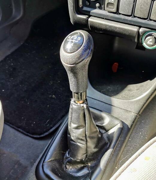

Finally getting around to addressing one of the things which has been bugging the hell out of me in the Caddy since day 1.
The gear lever gaiter has had it.  It's shrunk so there's no way to get it to stay on the clip at the top and there are two holes in it anyway.  It's just past it.
Used ones are generally all just as bad, yet eBay sellers still want £30-50 for for some reason.
So we've gone for a third party one priced at a more reasonable £15.  We'll see how crap it is or isn't when it gets here.  If it's hopeless we'll probably just end up making a new one, it's hardly a complicated bit of construction.  Basically just four triangular pieces of fake leather stitched together.
