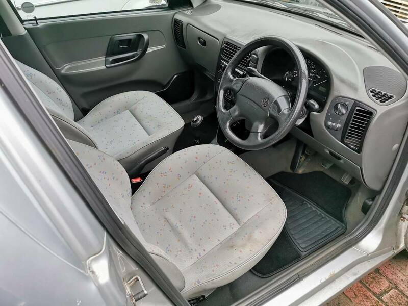

Cleaning time!  Interior only as I'm currently without a pressure washer - and they've literally just driven past our house and dumped about five tonnes of salt on each of the roads in our neighborhood so it would be pretty pointless.
Looking forward to dealing with the likes of this though...
Plus there's about three quarters of a forest worth of leaves in the windscreen scuttle.
Interior looks a bit better for a bit of a scrub though.

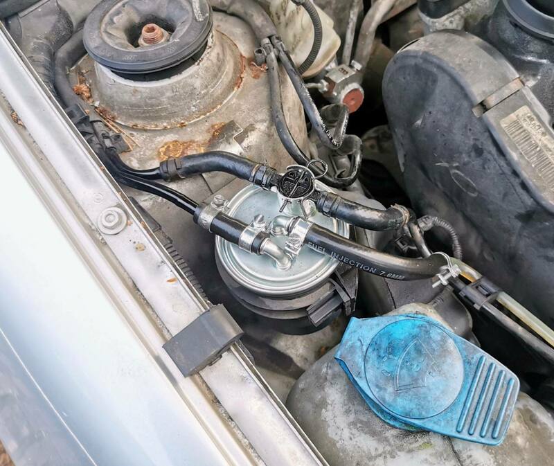

Only other item of note done today was getting the fuel filter and the feed lines attached to it replaced.
Think I'm going to go back and do the ones on the return too, just didn't have enough hose clamps to go round today (I despise those spring type ones with a passion - especially the ones VW use as they have really tiny tabs on so are nigh on impossible to get hold of if you don't have the proper tool).  Given I was able to pull the one on the feed side straight off, the hose had obviously been squashed enough under the hose clip that it was no longer doing anything.
One of the O-rings on the return line stub was cracked, so definitely think this was due changing.
Hopefully this will put a stop to air being pulled into the fuel system.  Time will tell I guess.

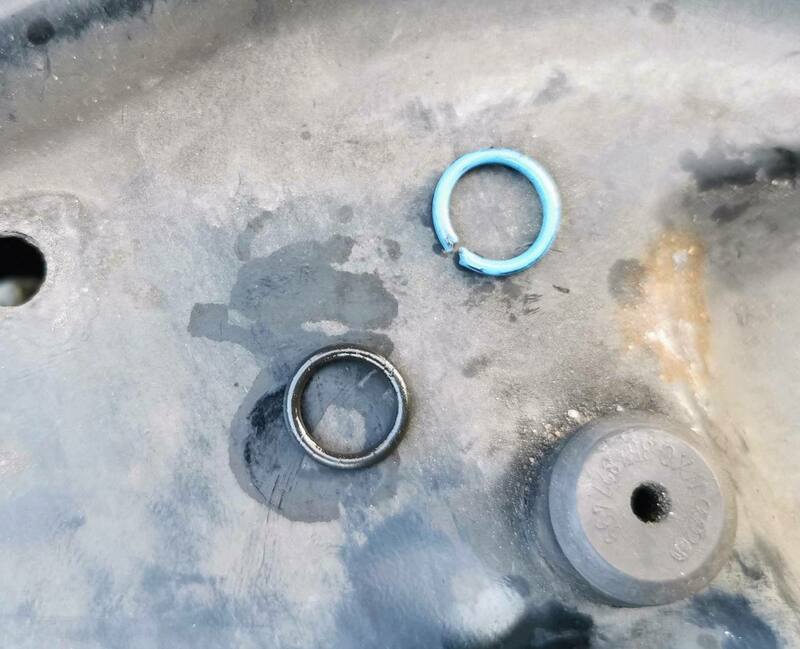

Having run out of daylight yesterday today's quick task was oil & filter change.
Set the oil draining, then realised something...the Caddy is modern enough to have one of these strange plastic caps over the oil filter.
...Which I've never had to deal with before.  After wasting half an hour trying to get it unscrewed without the right tools I gave up and went round to Halfords and grabbed one of these.
Holy hell that was tight.  I wound up basically hanging my bodyweight off the thing before it eventually started to very slowly come loose.
I then made a horrible mess and spilled oil everywhere when lifting the old filter out.
New one in - which helpfully has the top marked as I didn't realise they weren't symmetrical until after I'd put the old one down and lost track of the rotation.
New filter also comes with new O-rings for both the cap itself and the feed tube assembly which drops down through the middle of the filter.  I made a definite point of lubricating the outer seal with fresh engine oil before reassembling.  Tightening it precisely as much as necessary to snug the seal up and a smidge more.  Hopefully I won't have such a fight to get the cap off next time round.
The old oil smelled quite strongly of diesel and seemed quite watery (it is 5W40 though so not all that thick anyway), which isn't a huge surprise given the van was chucking clouds of unburned fuel out the back on the overrun because of that vacuum leak I found a couple of days back.  By no means the worst I've seen, but it was definitely ready for a change.

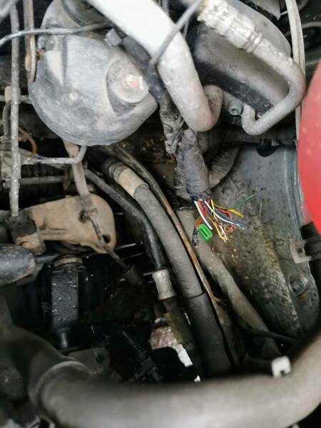

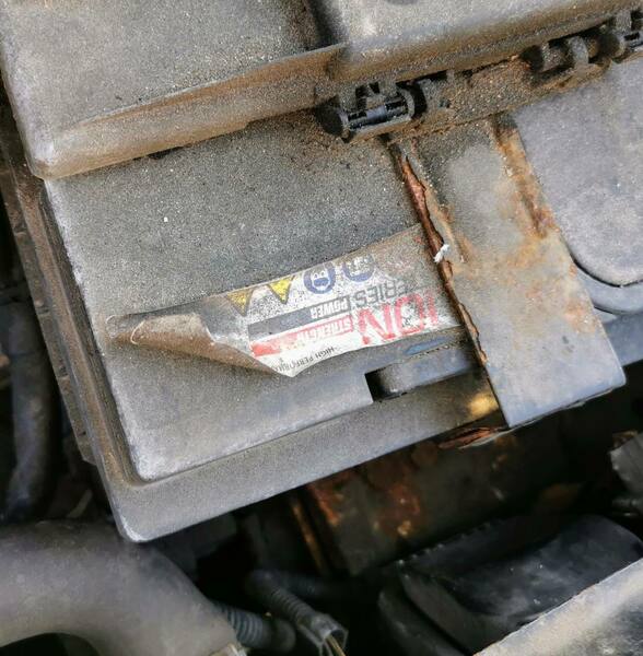

Though I did notice this mess in the engine bay when doing a check for oil leaks following the change yesterday...
Which is moderately concerning.  I know this van did at one point have an aftermarket alarm (which doesn't appear to function), so I wonder if this was a result of a refusal to shut up one time to often - the loom tape does make it look different to the main vehicle loom, which is why my first thought was alarm.  I will definitely be checking to ensure there's not power there shortly.
  • Zelandeth changed the title to Zel's Motoring Adventures...Citroen, Mercs, VW, AC Model 70 & A Sinclair C5 - 11/01 - Fixing Stuff...
A closer look at that wiring mess reveals the tail is attached to the aftermarket alarm sounder...so that's definitely thoroughly dead then.  Good thing I erred on the side of "I don't think so" when asked by the insurance company if it had an alarm.  I'll pull that out then and see if I can find the other end of this to at least confirm that there's no power going to it.

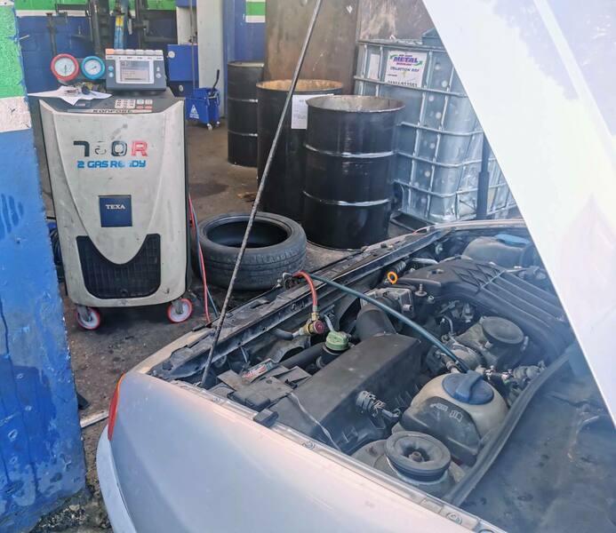

On the running theme of seeing if I can get vehicle systems back up and running I made a run over to Formula 1 in Newport Pagnell so this could happen.
While the AC system was totally flat when I got the van, I had noted that both service caps were loose, plus the condenser looks way newer than 20 years and 100K miles...have to wonder if a new one was fitted at some point and they just never bothered gassing it up?  I still have a bottle with some dregs of dry nitrogen from goodness only knows how many years ago, which in its last gasp shoved around 40psi into this system a few days ago.  Checking this morning showed the pressure hadn't visibly dropped.  Having something in there had also allowed me to check that the compressor clutch worked and the compressor ran - albeit only for a couple of seconds as I had no idea if there was any oil left in the system.
It was a tense 30 minutes while the system ran the vacuum decay test (which basically is a leak check to see whether any air leaks back into it) was carried out - zero decay reported.  Which says the system should hopefully be gas tight.  It also shows it's reasonably dry (as water boiling off from the drier core etc would result in a *small* bit of vacuum decay).
Machine was happy with all of the tests and charged properly.  Real test was going to be starting up, pushing the button and seeing what happened.
I should really have had a camera pointing at the service gauges to video it, but suffice to say they behaved exactly as expected.  It's a bit hard to tell you'd think when it's all of 6C outside, but the system was definitely working.  Suction line definitely got cold and there was heat quickly apparent on the liquid line.  Definitely colder than ambient air coming out the vents too... exactly what we were after.  No nasty noises from the compressor (that I can hear over the rattle of an SDi idling next to it anyway... though I'd by lying if I didn't admit it's a lot more refined than an XUD).
Having working AC should really help me deal with the bit of damp in the cabin.  Basically we'll run the heater at "as warm as I can deal with" on recirc with the AC on for a while and see if that helps.  As the air con dehumidifies the air passing through it, that will help actively pull water out of the cabin.

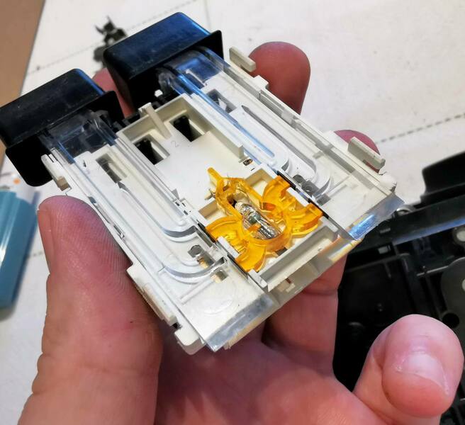

Today I fixed...

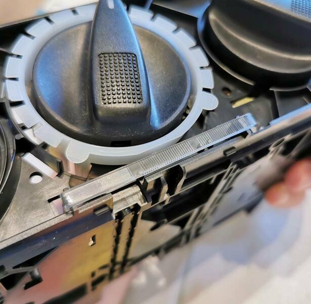

The backlighting for the heater controls on the Caddy.  Mainly because it was bugging the hell out of my OCD.  Just the one lamp for all that lot and a bunch of light pipes.
(Some of which are on the faceplate).

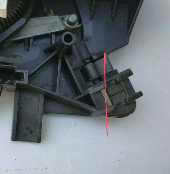

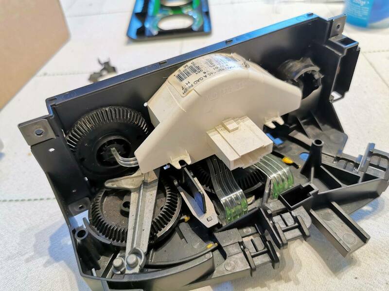

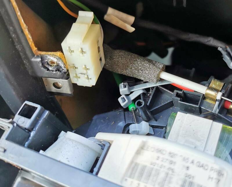

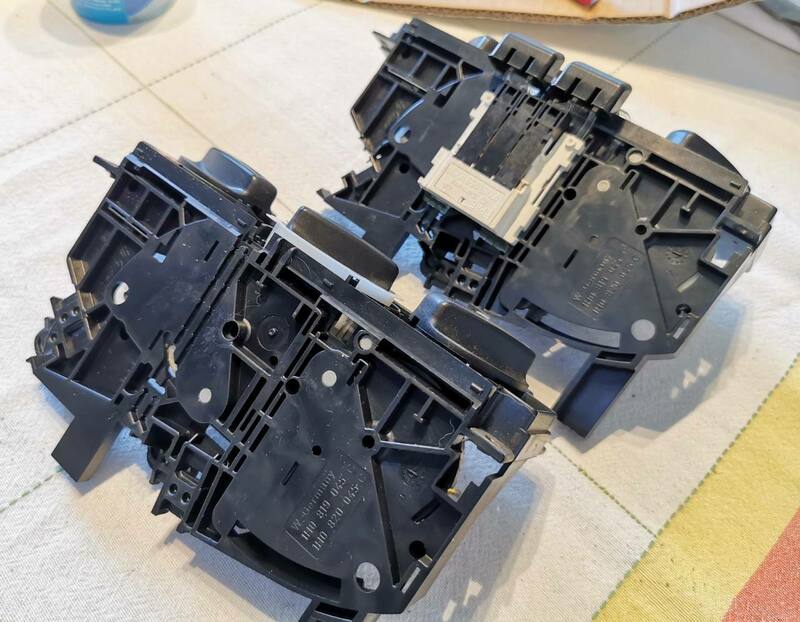

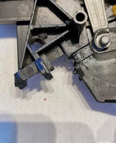

This also allowed me to get a look at what's broken regarding the temperature control cable.
Pretty simple actually.
There should be a metal clip where I've circled to grip the cable sheath (like on the red and white cables around 4 o'clock in the above photo), however the bit of plastic the clip should attach to has cracked.
Basically everything to the right of the red line in this photo has broken off.
1100505107_Screenshot_20220114_1752402.thumb.jpg.41c27554ba708a5522dc270b4fe727be.jpg
This is apparently a well known weak point in this setup.  A quick scan around online shows replacement units pretty readily available for less than £50, so I'm not going to invest too much time into trying to repair this one, especially as the tabs which are meant to secure it to the dash are also broken on 3/4 corners.  The question will be whether I go for a used OEM one (which we know has a design weakness) or an aftermarket one which may be made of cheese.
My instinct is to get an original one which isn't yet broken and to add a bit of reinforcement to the bit that always breaks off.

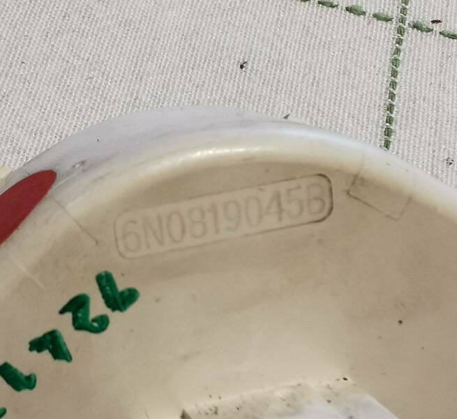

The *tricky* bit is going to be figuring out whether I can transfer the AC specific bits to a non-AC baseplate (the facia just clips on/off so that's not a problem) as the vast majority of them are from non-AC cars.  Hmm...some more research may be needed.

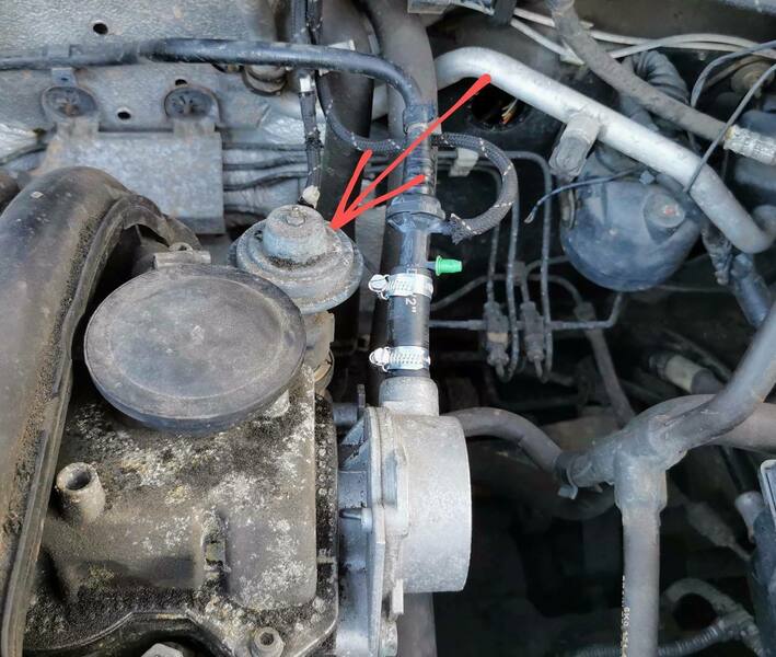

Moving onto the Caddy it was time to have a look at the EGR valve to get an idea of how funked up the system was.
My the standards of most modern cars it's thankfully pretty easy to get to.
Wasn't actually nearly as bad as I expected to be honest.  Yes it's pretty disgusting, but I'm not unused to seeing these choked solid.
Probably about 0.5mm worth of caked on gunk the whole way round.
The other side of the valve is more disgusting as it's sticky, tarry crap as the PCV system feeds into the EGR circuit right next to the valve.  I did dig an appreciable amount of gunge out of the valve body, but it definitely wasn't totally choked nor seemed to be sticky.
Reassembled everything...and absolutely no difference.  Very slightly surging engine speed still there (it does exactly the same at any engine speed I found, regularly once a second), along with excessive smoke on light throttle.
Definitely have vacuum at the EGR valve, and you can hear it physically snap shut if you pull the vacuum line off.  It however doesn't have any noticeable effect on the running of the engine either way.
Something I did notice is that when this behaviour is present, the rev counter also behaves slightly erratically, randomly twitching upwards from the actual engine speed - and it seems to do it more when on the throttle than off.
Then out of nowhere, the engine completely smooths out.  The note deepens (because the flap on the intake, which I assume works in partnership with the EGR valve is now fully open), and the diesel clatter becomes a little sharper, so something has obviously changed - I'm guessing with the injection timing.  Checking the EGR at that point shows there's no vacuum present, so the ECU isn't calling for the EGR system to be in operation.  It's also noteworthy that after this point when things decide to behave that the rev counter twitching also stops.
So I don't think the EGR valve is the cause of this issue...bit it's definitely *involved* in it.  Think the next step really will be to find someone locally with VCDS and get a look at some real-time data.  Everything being fly-by-wire here makes guessing pretty pointless... imagine on a newer car we'd have a check engine light illuminated - but this car doesn't have one!

Physically disabling the EGR valve by removing and plugging the vacuum line to the actuator has no effect.  I know the valve is moving as you can clearly hear it snap open or closed - and it sealed well enough that carb cleaner wasn't even seeping through the orifice while I was cleaning it yesterday.  So I think the valve itself is innocent.
However if I unplug the electrical connection to the solenoid valve which controls said valve, the problem completely goes away.  Idle immediately smooths out perfectly (it sounds to me like the injection timing or duration also changes as the engine note itself does change too), you hear the throttle valve in the intake snap fully open, and the throttle response becomes perfectly smooth through the whole rev range - and we see absolutely zero smoke aside from the expected tiny bit of black if you absolutely boot it, and that's not enough to be visible in the headlights of a following car.   Also notable that any noticeable smell completely vanishes too...
Now I'm sure unplugging that would trigger an engine management light if I had one and I'm sure will have logged a fault code, and disabling an emission control device like this is illegal, so it's not a permanent fix...however it provides me with useful data to add to my diagnostic process and *definitely* puts the van in a less polluting state while I get to the bottom of the root cause.  You've see the cloud if you've watched the video above!
I need to make my evening reading today working out exactly what the sequence of operation is for the various bits of the emission control system on this engine and how the various parts interact with each other.  I get the impression that understanding how that lot works will shed some light on what might be happening.

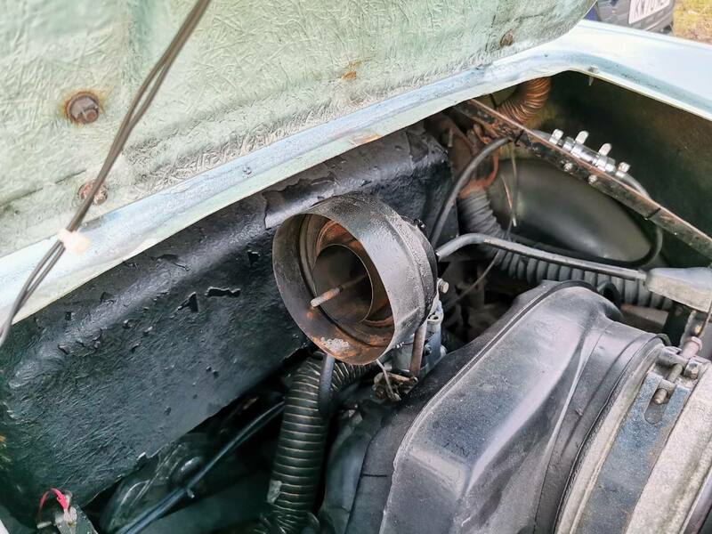

Which went absolutely fine until I heard a suspicious "ding" at one point and saw something disappearing into oblivion behind me.
Ah.  That's sub optimal.  The air filter element was still present, wedged between the chassis and suspension arm thankfully (as they're surprisingly expensive), however the cover plate and wing nut are long gone.  Even if I could spot it, as with so much of MK there's nowhere safe to pull over to retrieve it safely as it's on a 70mph dual carriageway with no pedestrian provision even vaguely nearby.  So I'll need to find a replacement.  Thankfully it's a bit of standard Steyr-Puch engine rather than a bespoke bit of Invacar so shouldn't be difficult to track one down, even if it may mean getting a whole new air cleaner assembly.
Guess we need to add "check air filter element retaining wing nut is tight" to the weekly checklist!

nice to see TPA out and about :)
its a shame bout the air filter assembly disassembling itself!
that air filter housing/assembly still a curiosity for me, as you probably notice yours is much shorter then any other, I do wonder did someone cut an existing one down for some reason or did it come from the factory like that and if so whats the deal with it being so short? is it a later replacement part? I wonder
but I have never seen one like yours, every other Steyr puch engined vehicle I have seen has had a full length one like on REV :)
My first thought when watching the video was "is that going to stop?", which brought me on to my second thought, which was that if the jumps in revs weren't so definitively stepped, I'd be wondering if my diesel van was suddenly drinking all the oil in my sump and about to embark on a death-spiral of runaway. And then I saw how blue the smoke looked in the video.
So are you sure it's not eating oil?
Obviously that does nothing to explain the stepping behaviour, which definitely sounds electrically controlled, but in case that's food for thought.
Doesn't seem to be, level certainly hasn't moved visibly since I changed it, which is admittedly only a few hundred miles ago.  Thing is when it's not doing that there's absolutely zip in the way of smoke, irrespective of engine speed.  Also it smells much more of fuel than burned engine oil.

Today's automotive task:
Get rid of this bodgery.
This is a close up of the broken bit of plastic on the back of the heater control assembly.
Which SHOULD look like this.
Thankfully as I expected the base units are identical, just mine has a few extra bits on being from an AC equipped car.
Mine:
New (used) one:
Underneath:
These (plus the white plastic lamp cover I later realised) are what need to be transferred over - and the faceplate obviously.
The greenish plastic thing in the middle is the light pipe which illuminates the indicators in the AC/Recirc buttons green when the headlights are on and the controls are off.
It needs to sit in front of the main light pipe assembly, but thankfully that unclips easily enough.
The one on the right illuminates the legends on the aforementioned buttons...and getting that sucker into position here is a royal faff, especially as you're acutely aware of what a tiny, fragile bit of plastic it is.
Really glad I had the sense to photograph the order these sat in before pulling anything apart.
This is what the top of the switch assembly looks like.
Whole new unit back together now with my AC specific bits added.
I initially didn't realise that the white lamp housing is slightly different, as the AC specific one is slightly shorter to allow it to fit over the additional light pipes.
The part numbers are different, confirming I wasn't just being daft.
AC one:
Non-AC one:
Though if you're doing this job you've likely got a complete but broken assembly in front of you anyway, so really not an issue. If robbing bits for an AC conversion though worth knowing you do need it.
After a small amount of swearing at cables (they are *precisely* as long as they *need* to be).  I wouldn't be at all surprised if that's a large part of how that bit got snapped in the first place.  Wouldn't be hard to put a load of strain on there when installing a stereo or routing any wiring behind the dash.

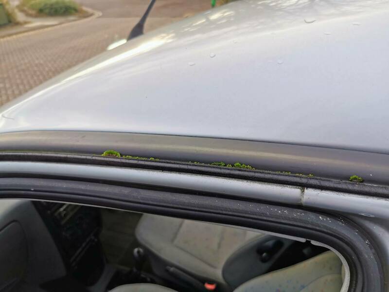

Quite a bit of it out there just now.  This roof corner was silver this morning!

curiously AC did change about the positioning of the air filter with regards to the standard steyr puch engine layout
Prototype Model 70's and every other Steyr puch engined vehicle out there has the air filter pointing to the right, as seen here on AC Model 70 Prototype number 9
but all production Model 70's I have seen have the air filter pointing to the left, I have not seen any other Steyr puch engined vehicle that is configured like that AFAIK
have to wonder why they did it, was there a technical reason behind it, or was it just done to make accessing the air filter element a bit easier?
BTW excuse me if I have missed if you have mentioned it already, but is the Merc staying in the fold or is it onto pastures new like the jag? :)
Carb choice possibly?  The mounting point for the throttle return spring pretty much needs the housing to be this way round.  Wonder if other carbs were used in other applications, or if the long throttle cable run necessitated a helper spring on the Invacar, so they just flipped it round as it was a convenient mounting point for it.
Do other Steyr-Puch air cleaners have the spring mounting tab?
Other thought - I'm assuming when they were built that the completed engine assembly was plonked in as one assembly.  Given it's already shifted slightly towards the offside because of the layout, wonder if flipping that around through 180 degrees would help make it a slightly more compact and easily managed unit.
I dont think its a carb choice thing, the earlier Model 70's used the Weber 32ICS3 carb same as other 493cc Steyr puch vehicles of the time (later Model 70's had the Model 70 specific Weber 32ICS10T, but that used the same physical body as the 32ICS3)
other Steyr puch vehicles indeed had a return spring same as the Model 70 does, so I dont think thats the reason for the flipped assembly
Steyr Puch 500 1957 blue engine
I do wonder if it was for clearance reasons as you say, as you say the engine is mounted with a right side bias so getting to the air filter would of been pretty tricky  (but flipping the air filter assemble around will have also entailed adding on a bolt to the other side of the manifold as well I think for the little support bar that runs down from the air filter chamber)
im also wondering it could be that perhaps by 1971 when Model 70 Production got under way that Steyr puch had flipped the assembly themselves for some reason, and I have just not found a 1971+ Steyr puch vehicle thats not been messed with!
its quite hard to find pictures of 1970+ Steyr Puch 493cc engines, all the ones i have been able are either Model 70 engines and or have been extensively tuned and modified like most Steyr puch 500's are!
I mean you put Steyr puch engine into google and most have after market lamp shade air filters like TPA has now LOL :)
(PS I put 2 and 2 together and I think I just figured out who is getting the Merc :)
Hmm, intriguing.  There must be a reason for it.
Your mentioning different carb types has reminded me that I really do need to have another bash at finding a service kit, or one that's at least close enough for mine.  While it works fine it weeps from several seals, which I'd really rather put a stop to.  Even just a genuine top cover gasket that's actually in decent shape would probably help.
Regarding the stubby filter on TPA - I've no idea.  Remembering how hacked about KPL was, anything is possible...and to be honest it's a bit of a surprise she even *had* an air filter.  No idea if it's an original one that was just cut down, though if they've done that they have also shortened the threaded rod things screw onto, which I'm assuming wasn't threaded all the way into the housing, so would have had to be replaced, so wasn't a ten second job.
Pretty sure the reason for the larger filter body is to reduce noise.  The induction roar at higher speeds in TPA is really quite noticeable, which I reckon having a bit more volume in the filter housing may help muffle a bit.  Or given Steyr-Puch seem to know what they're doing it could even be tuned to help improve breathing using resonance effects to their advantage... it's all guesswork and speculation though.  Plus I've no idea why my filter is smaller!
