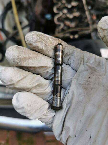

Oh, the camshaft bearing journals are scored to hell, exactly as expected.

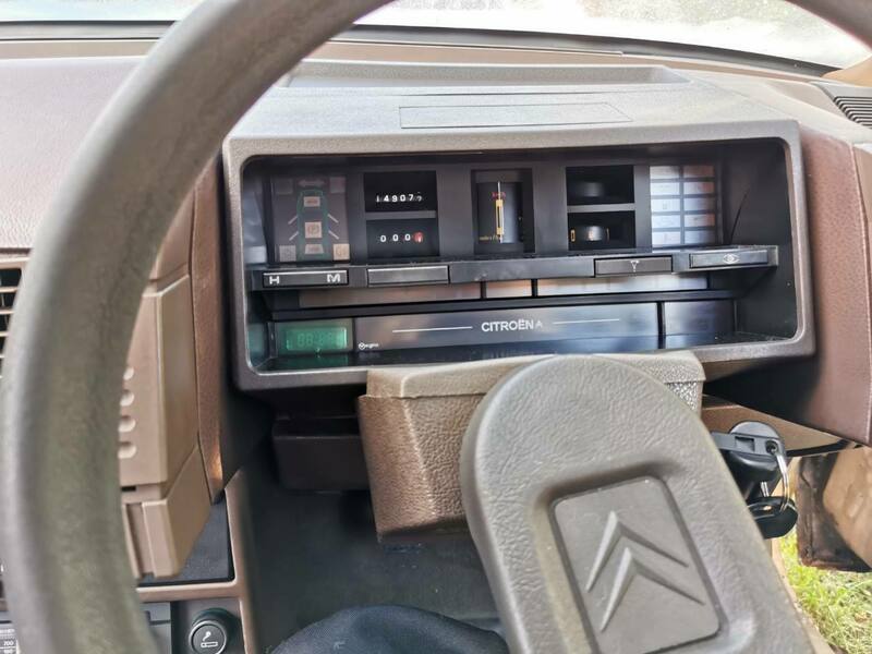

The transparency film I'd been waiting for to sort the dash on the BX arrived.
Thankfully because I was working on a scan I had taken I knew the dimensions would be right when I printed it.  Didn't look too bad at first glance.
Though precisely as I expected opacity was clearly going to be a problem.
I had expected this, so the solution was to print two layers which were just the colour filters, one that's just the frame mask and a final one with the legends and again the frame on it.
As shown by the initial print from the other side that worked much better.
Just holding them together by hand there, hence the registration errors.
With everything back into the panel it looks far better than the blotchy, faded original ones.
It's really hard to get an accurate photo of how it looks, but this is vaguely close.
Colours are far more saturated in person.  There is more of a hot spot than with the original filters but it's perfectly reasonable.
The fact that I've got enough opacity is shown by the lack of bleed through on the left hand lamp unit.  This is vastly overexposed because I was looking for evidence of light shining through where it shouldn't be.
In reality this looks more like this.
Might get that dropped back in tomorrow.  LED illumination hasn't been done yet, but I've enough projects going on right now so could do with it back in the car!

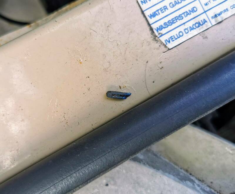

Well I've found the break in the BX speedometer drive.
That little bit of plastic should be attached to the end of the lower cable.  So unless I can come up with a bodge I'll be needing a new lower cable.

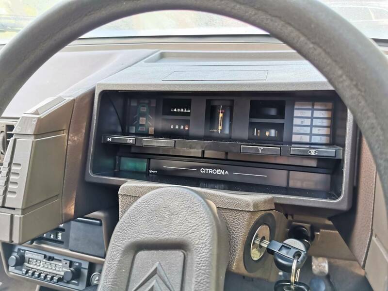

The dash is back together now though.  Looks far less scruffy.
Before:
After:
All seems to be behaving itself.
I really had not appreciated quite how big a visual impact just repainting the pointer on the speedometer would make.

Edit: Updated BX dash photos now it's dark.
Far better.  No more blotchy mess around here.
The slight bleed through on the right is actually just due to the frosted surface on the plastic light guide rather than light getting through the backing.
Before photo for reference.
I've not been able to sort the clock yet so have just disabled it... having it show 0:00 every time the ignition was on was more annoying than it just not working.  I'll get to that at some point in the future.

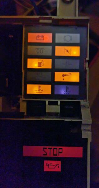

Still find it interesting that the handbrake light on this dash is amber rather than red.  Leyland Atlantean and Olympians are the only other vehicles I've driven where that's the case.
Photos below...yes I find instrument panel design fascinating so notice things like that.

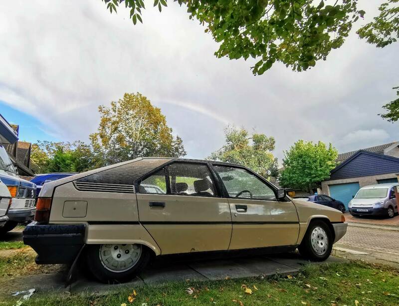

The BX is a little bit of an unknown as I've yet to drive it more than fifty feet.  However it is such a comfy thing that I can see myself very much liking it.  We should be *relatively* close to at least being able to throw it in for an MOT and see how long a fail list we end up with.  A lot of people on here have put a lot of work into saving this car so I would really like to justify those efforts by getting it back actually onto the road.

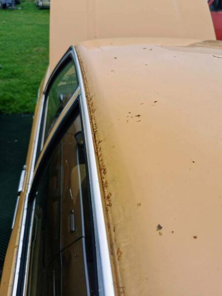

There are a couple of bits of rust though, would be incredible if there weren't.
The first I found was the inner sill just ahead of the offside rear wheel.
Sorry, not the best photo as I was taking it blind.
Oddly the *nearside* which is the side I usually expect to be rustier is solid there.
That'll be fun to weld up from underneath the car with spatter going in my ear.
The other bit I immediately spotted was on the nearside front chassis leg.  There was a repair  done there for the last MOT the car had, but being 10 years ago it's really in need of cutting out and doing properly as it looks like the rust has got into the seam.
On the plus side, the whole area feels solid and for a change access looks to be fine.  Only thing that needs to be moved out the way is the wheel and one plastic fuel line.
I was kind of braced for the whole area going "scrunch" when I poked it but it didn't.
The other one is a bit of a potential can of worms - sill covers can hide all sort of sins.
This one looks to have separated a little at the rear.
However the sill wasn't crunchy behind it, so hoping a localised repair will be all that's needed.  It's likely a vain hope...but I'm going to hold on to it for now!
No horrors hiding in the door shuts.

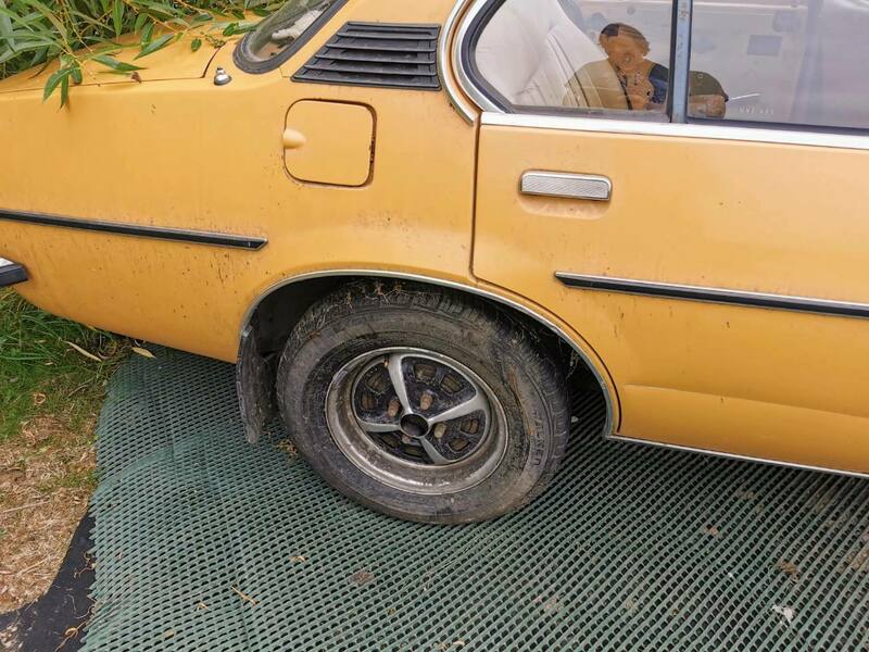

Apparently I totally forgot to take a wider angle photo of the nearside rear.
The nearside rear is probably the worst of the arches.  Might need some TLC on the leading edge at the bottom.
Rest are all in good shape.

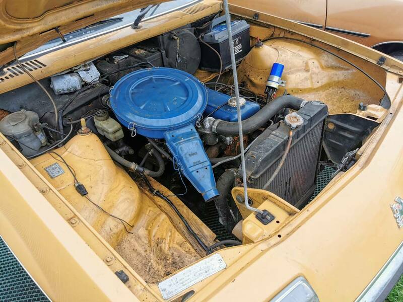

Inner wings are in really good shape under the bonnet.
The battery tray has a couple of tiny pin holes in, but that's something even I should be able to patch up.
Unlike a lot of cars I won't need to dismantle the entire interior to sort that.
The bonnet needs drowning in Vactan and Dinitrol to catch it but it's not rusted through anywhere.

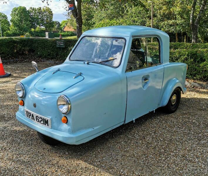

Today's errands were conducted by TPA on account of the availability (or rather the lack thereof) of fuel.  I had a gallon in the shed originally for the mower, which of course amounts to nearly a quarter of a tank in that car.
Been a while since I got any new photos of her, so grabbed a few while we were out.
Guessing she will be out and about quite a bit this week.

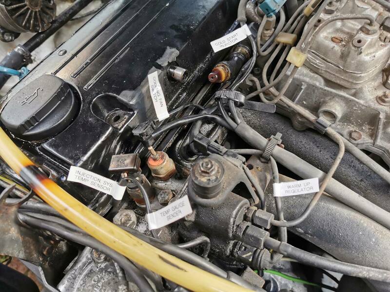

Back at it this afternoon.
Step 1 I decided was to label the handful of wiring connectors which would need to be removed.  Have to admit this is one of the reasons I love K-Jet injection systems...so simple electronically.

I've just wasted the best part of two hours trying to get the pin that holds the timing chain guide out.
This pin, which is helpfully drilled and tapped with an M6 thread.
Should in theory just pull out, using a nut and bolt as an improvised puller seems to be a popular method.
Yeah...even using the best quality M6 nut and bolt I could find (the ones in the photo were purely to show how things fit together) just ended up mangling the threads on the bolt in one case and shearing off in another.
Basically I need to resort to a slide hammer.  Unsurprisingly given this engine's history it's well glued in place.  Unfortunately there's not enough space to get in with one.

Having left the timing chain guide pins stewing in Plusgas for a few days I went back for another shot today. Armed with a few high tensile bolts and an assortment of spacers I figured this was the last chance saloon before I get more tools involved and strip things down further.  After far more torque than I would have liked was applied, the pin started to move with a terrifyingly loud crack.
It was tight all the way out (as expected given it's purely a friction fit), but didn't require stupid amounts of force once it was moving. One removed pin.
At this point I figured I would be able to withdraw the chain tensioner. Err... apparently not.  A quick consultation with the spare head showed there were actually TWO of these pins. I'd missed this one entirely.
Partly because I'd just unbolted the thermostat housing from the head and left it otherwise in situ, partly because...well...would you have spotted it under all that slime?
About 3/4 of a can of carb cleaner and some scrubbing later...hey look, there it is!
Same process as before...another pin out.
Which *finally* allowed me to get the chain guide out.  It defied all attempts to usefully photograph it, but there's hardly any visible wear on this, I'd not be surprised if it's been replaced at some point.
