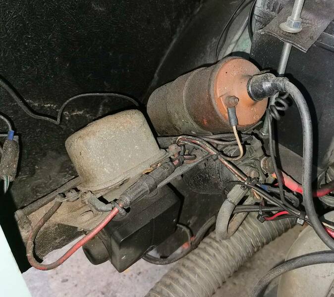

@LightBulbFunThere is a large relay somewhere to operate the starter side of the Dynastart. It could be the contacts in that. I did notice a voltage regulator in REV positioned on the chassis near the rear offside light. It looks like the Bosch one on the Daf. That has a conventional starter and dynamo, so they are probably different types, but in the same box.  Those are places to look for REVs charging problems.  @Zelandeth Has TPA got something similar?  It will have something like white paint as a sealer on top over the cover screw, covering the points. Before trying to adjust it, try cleaning the points and see if the voltage on load improves. It will have the Bosch type number on the cover. I had an awful job with the Dafs regulator but got it right in the end.
All of the engine electrical kit in TPA lives down in this corner.  Single solenoid and a Bosch voltage regulator.  I can't remember if there are really any external extras for the Dynastart beyond what you'd have for a conventional generator and starter or if there are separate connections on the device itself you would hook up the same as though they were separate units.
The black box under the regulator simply contains the ignition condenser and a remote engine start control.
4 hours ago, LightBulbFun said:
ah the starter solenoid on REV is fine thankfully :) just her battery does not have enough charge to turn over the dynastart/engine hence the Clunk is all you get without a jump pack! since the solenoid engages but the voltage just drops off a cliff,
although I will say on a separate note id like to check her Dynastart brushes just for peace of mind since they have never been checked in my ownership I dont think
indeed its a Bosch 20A voltage regulator, you can still get em new even :) https://prokschi.at/bosch-regler-20a-14v.html
not cheap mind! one of the interesting things on that web page is it says its a solid state unit made to look like the old mechanical units, but question I wonder is how do you adjust it?
or is it being a solid state unit, able to provide charging/14V over a wider engine rev range without needing to adjust anything?
I wouldn't expect to see any adjustment options on a solid state regulator.  The only reason the mechanical ones have it is to compensate for physical variations from the manufacturing process and to adjust for physical wear.  With fully closed loop electronic control that just becomes unnecessary.
You really want to get that battery charged as soon as possible.  There's absolutely nothing worse for a lead acid battery than sitting in a discharged state.  I know it's not exactly a pleasant prospect hauling it up the stairs to the flat, but it's going to need to be done sooner or later.
Without a diagram in front of me it's a bit tricky to make any judgement on what's going on.  That said, while step 1 is always to check for any obvious loose or damaged wires/connectors, step 2 on anything with points is always to clean them...so I'd do that and see where we are before delving too much deeper.
from what I can tell on the electrical side of things, to me it looks like the Starter and Dynamo functions of the Dynastart are treated as if they where separate units, the Bosch regulator is just there for Dynamo functions, and then theres a separate starter solenoid as on any other car with a starter motor, for engaging the starter motor functions of the dynastart (in-fact I believe the Dynastart itself has separate windings for starting vs charging)
heres a general wiring digram for those curious
and theres detailed info on the regulator in the workshop manual :)

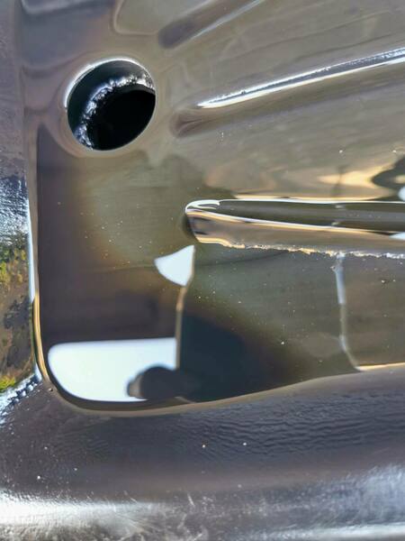

Time for another oil & filter change for the S123.
Had aimed for 500 miles but missed by a bit.
Still got some glitter in the drain pan sadly.
Will continue to monitor, it'll take quite a while to flush it all out in its entirety after all and there definitely doesn't seem to be anywhere near as much as last time round.

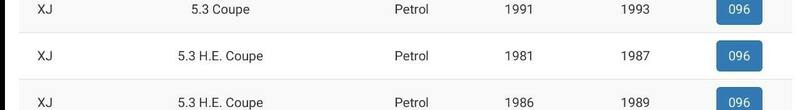

The first few web searches I found - and the checker on Tanya Batteries website all suggested that a type 096 battery is correct for the XJ-S.
So that is what I went and picked up.
Was no point comparing to the one in the car as I knew it was well under sized - hence my "creative" solution to getting enough travel in the tie down frame to actually make it fit.

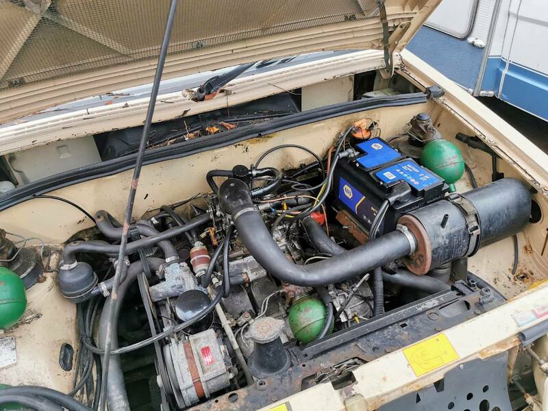

Turns out they're speaking nonsense.  No way will a 096 fit in here, it's the best part of an inch wider than the battery tray.  D'oh!
Cue a bit of head scratching...before I nicked the battery I stuck in the BX about 8 months ago.  That's a 027 which while still a little smaller than what I imagine Jag intended (which I'm thinking now is probably a 075), is a far better fit.  It sits snugly in the tray and the tie down fits properly without needing to faff about with spacers.  Means I can actually get the lid fitted properly for the first time since I've had the car.
The battery tray in the BX is huge on account of the diesel variants so the 096 dropped in there just fine and looks like it was meant to be there - even if it's grossly overrated for a humble 1.4 petrol, but we're not going to complain.  Especially with the car not being used regularly.
I've put it on charge overnight on account of the BX sitting unused a lot, but even beforehand it span the engine over far faster than the one previously in the car ever did.  Also while out for a run the voltmeter stayed pretty much smack in the middle the whole time without sagging anywhere near as much at idle...so I think that was half our problem.  Dying battery took out a weak alternator regulator?  Or dying alternator killed the battery?  We will probably never know.
The battery that's come out definitely has a shorted cell.  Sitting rock steady on 10.8V off charge but using the calibrated battery testing spanner is still sourcing a decent chunk of current - which suggests it can also still sink a decent charge rate, which given that with a lot of kit running I can easily account for about 80% of our old 55A alternator's output in vehicle systems alone isn't going to help anything.
First thing I noticed driving out of our neighborhood...the heater was actually behaving in a sane manner.  It continued to do so for the remaining 25 mins or so I was out...and the cruise control worked first try.  Have we been fighting off odd gremlins because of a sickly battery for a while?  I know that's more of a modern car thing...but let's face it, the XJ-S in a lot of ways *is* a lot more modern than its year of production would suggest.
Need to find a thinner bit of tubing to hook up the battery vent tube (the vent on the new battery is slightly narrower than on the old one so my existing pipe doesn't fit), but should be able to call this job done tomorrow.
Edit: Just noticed the one I took out the Jag looks to be labelled as a 027 as well... definitely isn't the same size as the one from the BX, which is at least an inch or so taller.  Hmm.

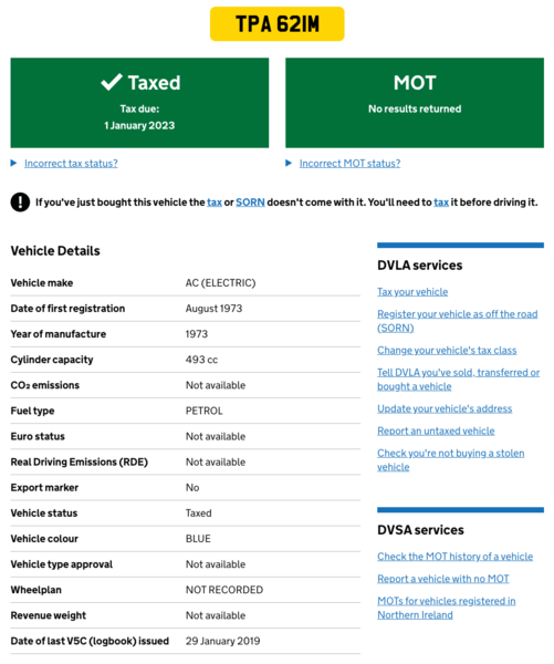

I also noticed a few days ago you had renewed her tax for another year, the first Invacar taxed till 2023! :)
screencapture-vehicleenquiry-service-gov-uk-VehicleFound-2021-12-16-01_19_44.thumb.png.988c12de3a4c8a4bf2d4c56723a983d2.png
