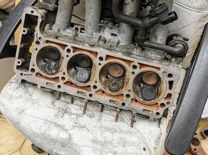

Didn't have much cleaning really to do on the underside of the new head, reckon someone had already done at least a first pass.  This is how it looked before I touched it.
Likewise the block actually wasn't bad at all.  Didn't take long at all to get it all cleaned up - though I failed to take a photograph of that stage.

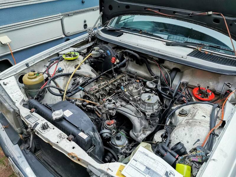

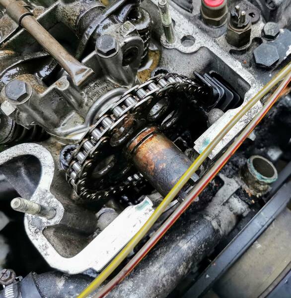

Before I could start building things back up I needed to reset that blasted ratcheting timing chain tensioner.
First step of that is to remove this huge great bolt-like thing, which requires you to remove all but one of the alternator bolts so it can be swung out of the way.
I had assumed this would bring the whole tensioner out...no, it retains the spring and forms the outer oil seal...but the core of the tensioner (and the bit I needed to remove) was completely separate.
...And required a 17mm hex bit to remove.  Which I didn't have.  Biggest I could find in the garage was 12mm.  Biggest I could find separately was 12mm...so ended up having to spend £20 on a set of 10 sizes just for the 17mm one which was annoying.
It was also biblically tight.  Though after hanging off the end of a breaker bar - which was bending worryingly - it came free and could be unscrewed from the block.
One tensioner.  All that faff so I could do this.
I should really have taken an intermediate photo to show how this works...but basically that bigger outer body is hollow.  The way it works is that the plunger can move freely from frame right to left, but cannot move the other way.  So the only way to back it off is to pull the plunger all the way out and insert it back into the other end of the body.  When you screw the outer cap back on with the spring under it, that then applies the correct amount of tension to the chain.  In addition to the spring tensioner, there's also a hydraulic circuit built in to push the plunger out...so basically there's a layer of redundancy there in case either the spring or hydraulic system were to fail.
If it didn't involve having to remove the alternator to get at it and require tools beyond what the average DIY mechanic are likely to have to hand I'd call it clever.

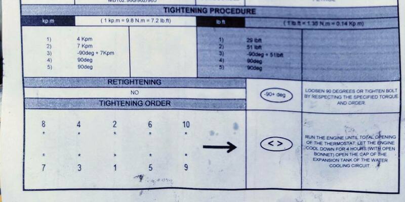

The head bolt torque specs and the bolt tightening sequence were helpfully included with the gasket.

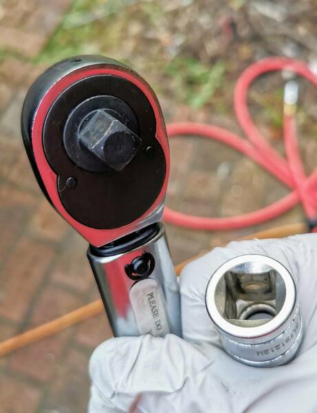

However as soon as I dug out the torque wrench I realised I had an additional problem.
Yep...the Torx bit had a larger drive fitting than my torque wrench.  Back to bloody Halfords again to get an adaptor.
Eventually...
I tell you now though, that last 90 degrees nearly killed me.  I was literally *hanging* off the end of the thing to get there.  I will definitely be feeling that from my back in the morning.
Head is torqued up, timing chain sprocket, guides are fitted and the tensioner has been refitted.
I've rotated the engine by hand several times now and it rotates freely without making any horrible noises...so I've at least got the cam and crank vaguely timed right it looks like!  Everything looks to be moving perfectly too.

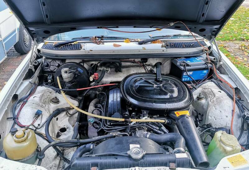

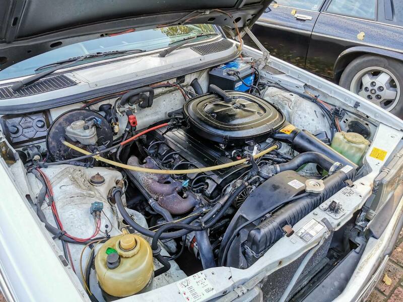

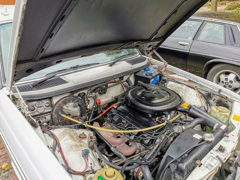

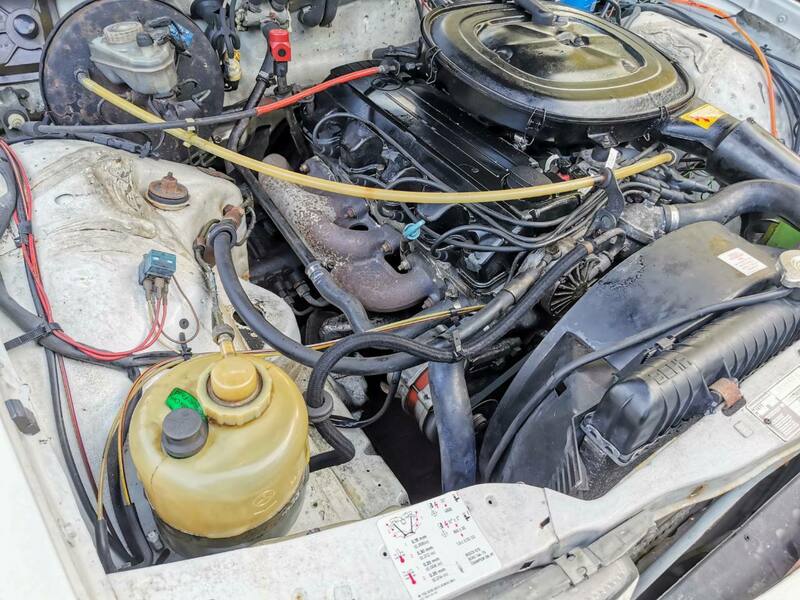

The end result of about six hours straight work today:
Had to fiddle about a bit with the timing initially but aside from a few things being bloody fiddly everything went back together fairly smoothly.
Only real foul up was me putting the bracket for the brake servo vacuum line on backwards.

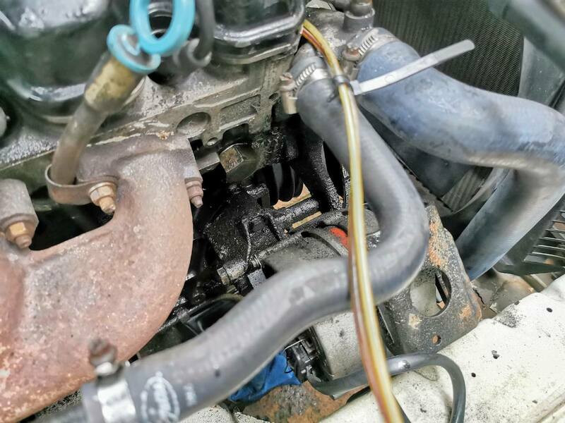

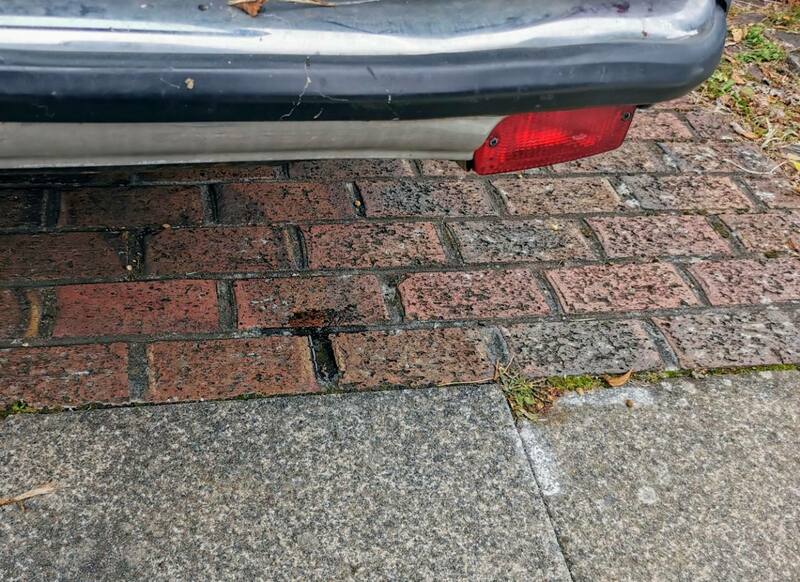

We've got a pretty major oil leak from the timing chain tensioner (guessing the big washer was intended to be single use) and water is pissing out of the thermostat housing.  Not surprised there as I only used instant gasket because the one I was sent by a supposed specialist was the wrong shape.  Fresh out of gasket paper just now but may well see about making one out of some card just to see if it works.

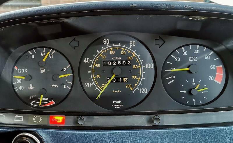

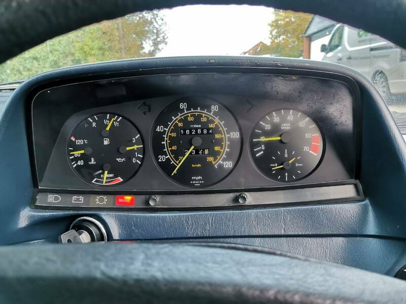

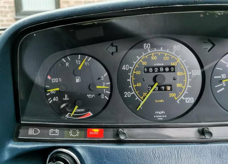

Has it improved the oil pressure situation?  Not massively.  Seem to be showing about 1.5 bar at a hot idle in gear.
Though that's just at thermostat opening temperature...if it were right at the point the fan was cycling it may well drop a bit further.
Plus without the horrendous thrashy racket from the camshaft grinding itself into oblivion the engine generally sounds a bit rattly to me when the revs are picked up.
I'll see how she behaves after an actual test run (those leaks need sorting first), but I'm tending to think we're going to be back right where we started really.
No huge loss though...I still think this was a worthwhile thing to try.  Definitely no more work than removing the engine, and that's a job which just needs both space and equipment I don't have to hand.

Thermostat housing gasket and timing chain tensioner seal have both now been ordered from the dealer and should be here Monday or Tuesday.
Think I may have confused the folks at the Mercedes dealer slightly when I parked an Invacar in their car park...
Hopefully should be able to give the Merc a proper test run once they're fitted.
Annoyingly I'll need to unthread the belt and half detach the alternator again to fit the seal for the chain tensioner...for all it's a 30 second job in itself!

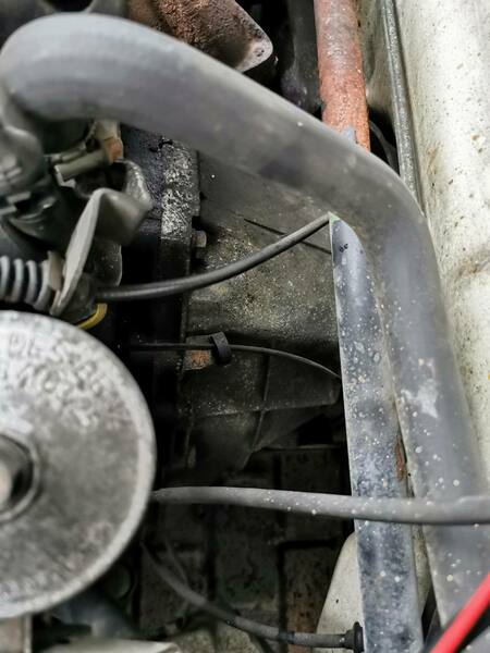

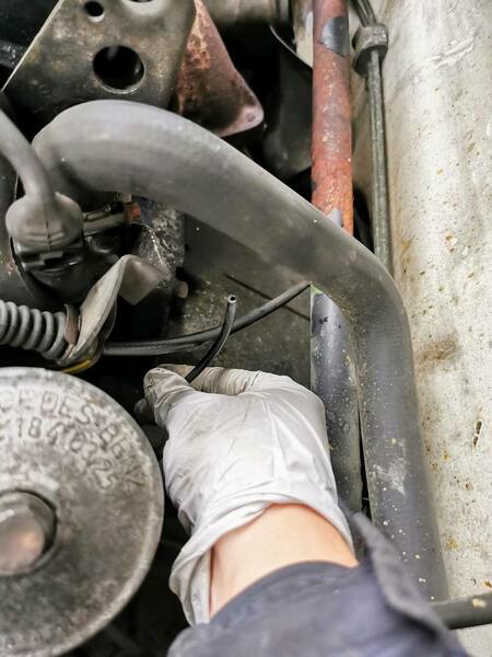

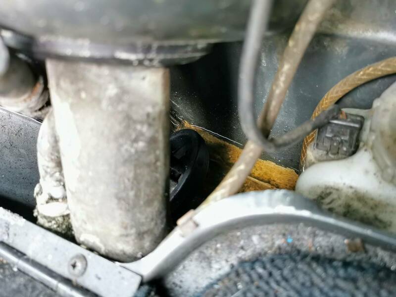

Main reason I had been putting it off was that getting to the level plug for the diff is an absolute swine.  It's not quite so bad now I've done it a few times as I know where it is (you can see it or touch it, but not both at the same time), but is still bloody awkward.  I'm sure the intended way of changing the oil was to have the car on a lift in which case it would be dead easy.  Having the original seat would make it easier too actually as the backrest can be easily removed from that, not possible on mine so you're working around it.
I've found that cracking the level plug off from in the engine bay but then unscrewing and removing/refitting it from in the cabin and then doing the final tightening from the engine side seems to be the easiest solution.

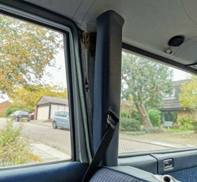

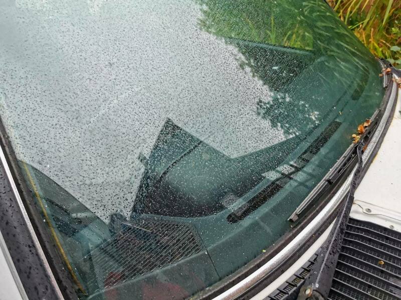

The "light scattered showers" the weather forecast predicted this afternoon proved to be anything but.  "Persistent and mostly heavy" was a better description.  So we got a few more typical photos of her out and about rather than just when it's nice and sunny for a change.
My weatherproofing improvements have definitely helped, though I do still have a little water getting in around the offside of the windscreen occasionally.
The demister actually does just fine when you're on the open road so long as you keep a window cracked slightly - problem is that as soon as you drop below about 50 it basically ceases to have any effect whatsoever - and the cabin being so small means that it fogs up very quickly.  Obviously there's no way to direct air to the side windows either so you really do need a demisting cloth to live in the car.
Windscreen wiper does a better job of clearing the screen than you'd think with how tiny it is, though an intermittent wipe function would be nice...you really want two hands on the handlebars whenever possible so having to keep turning the wiper on/off gets a bit tiresome after a while.
Not that I generally plan to use the car regularly in monsoon conditions, but if I get caught on a longer run in poor weather it's nice to know that it's not a huge problem.

I guess that's an advantage I have in these parts - higher average speeds, so demisting isn't generally an issue. Which is good given mine isn't even connected up! One issue with aircooled engines is that at lower engine speeds, there's less blow. On the 2CV, you can at least dip the clutch or knock her into neutral for a quick blast of revs. That does tend to confuse other road users mind you...
Yeah, it's definitely something I need to address as anywhere in town driving it's a nightmare.
Still have plans to add an electric blower for such eventualities once I find one that's well suited.  Would mean I could pull the air from somewhere more sensible too.  Drawing the air to demist the screen with straight out of the middle of the spray plume behind the car can't help it's efficacy!

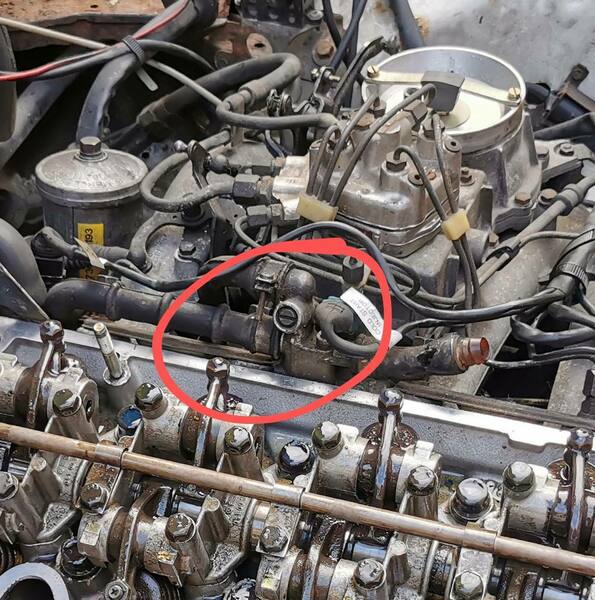

Today has been frustrating.
Started out well enough, with these picked up from the Mercedes dealership.
Replacing the gasket for the thermostat housing was precisely as awkward as I remembered (because I didn't want to remove the stubby hose between the block and the stat housing as it's a pig to refit), but uneventful.
However rapidly went downhill from there.  Firstly it turns out that Hermes have apparently lost a parcel which contains the replacement alternator for the Jaguar.  Wonderful.  Their system shows it as having been delivered...whereas it definitely hasn't been.  Not to us, any house on our (short) street, or the same number on any of the surrounding roads.  Great.
We're kind of on the clock on that now too - my friend up north should be in their new house first week of next month, so I'd really like to get it ready to head onwards as near to then as possible...so we can get the Cavalier dragged out of the field before it winds up underwater through the winter.

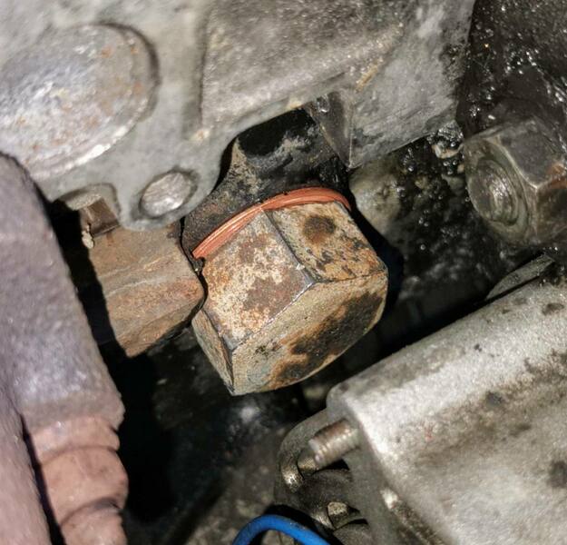

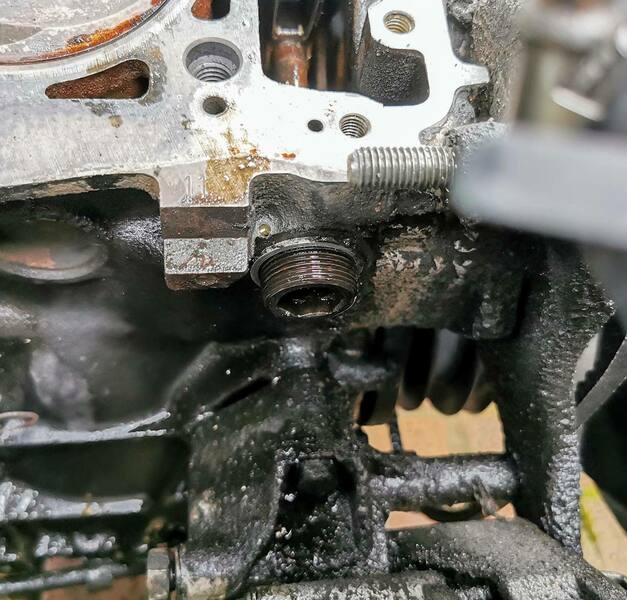

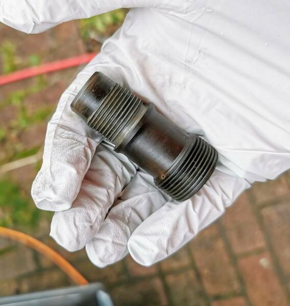

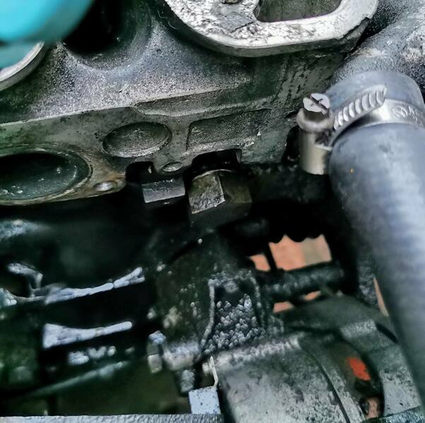

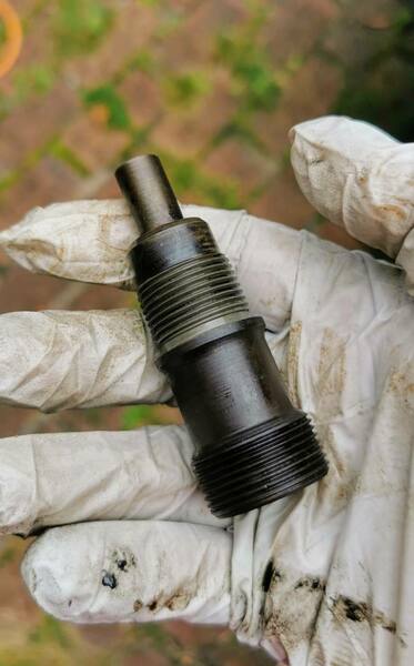

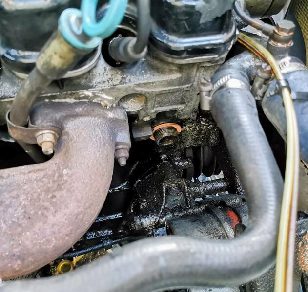

Set about pulling things apart again so I could replace the outer oil seal on the timing chain tensioner.

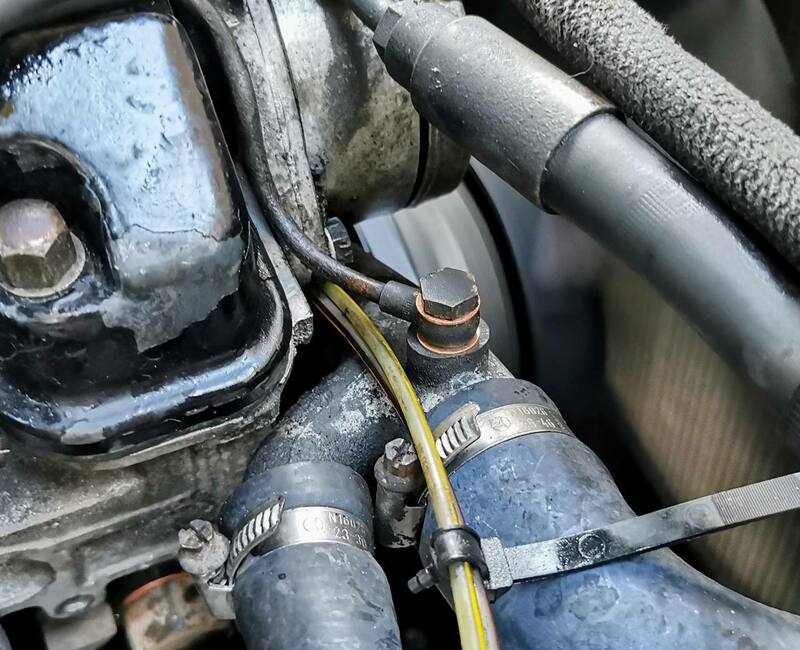

It's the thing which looks like a huge bolt head in the photo below.
Yeah...slight problem appeared at this point.

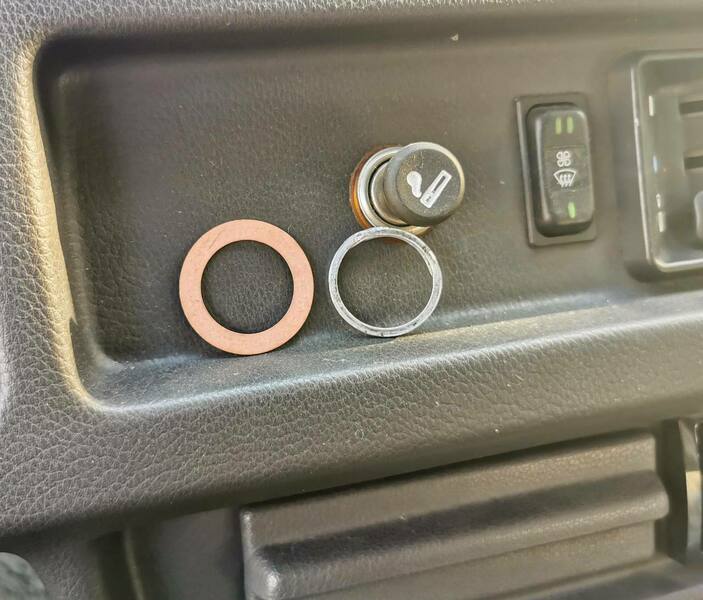

Old one is on the left.  New one is a good few millimetres smaller, enough so it won't fit over the body of the tensioner.
Checking in with the dealer it turns out that this washer isn't shown at all on their parts system, so they have no idea where the original one came from...nor what the part number should be.  Having spent a couple of hours driving around everywhere I could think of I couldn't find another washer this size.
Typing "Mercedes M102 timing chain tensioner oil seal" into Google revealed that it was paying attention to the words "Mercedes" and "timing chain" and completely ignoring everything else.  I'll do battle with that when I'm sitting at an actual computer...I just don't have the patience for that nonsense when I'm using my phone.
I'd really hoped this would be ticked off today but it looks like I'll be having to order a stupid washer and wait for that to arrive before I can make any progress.
I have a feeling someone mangled this washer somewhere in the distant past as it was absolutely slathered in instant gasket when I removed it...and I find myself almost wondering if that may be responsible for the historic oil flow issues we've clearly had to the head.  Coincidence or causality?  Either way, I'm fixing the problem rather than bodging it.

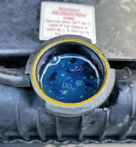

Having been a few hours since I fitted the thermostat housing I went to fill the cooling system...and went and made myself more work.  Apparently when I threw everything back into the garage a few days back I threw the wrong cap on a couple of bottles...and the one with the cap which said A/F Blue was in fact not blue antifreeze...it was 20W 50 oil.  So a good slosh of oil went in the radiator before I spotted it.  This is the curse of Motorserv having NAPA everything now...all the bottles are identical!  System was going to need flushing anyway as there was some oil contamination from when the head came off...but there's more in there now!  I did manage to skim *most* of it off as it hadn't mixed, but I'm sure there will be more slime to come out.
Moral of the story: When you're shutting up shop, no matter how knackered you are, don't cut corners.  You'll end up making yourself more work in the long run.  Probably in a way which will make you feel like an absolute IDIOT as well.

I'm not saying it's right, but for now can you not put a few wraps of PTFE around the tensioner and re-use the old copper washer ? (As a temporary fix)
Or measure the O.D of the tensioner and get a good quality dowty washer / seal ordered (might even have one if you throw me the size)

Sadly not, the seal is on the washer face rather than the thread.  Someone has obviously trapped it in the thread at some point and has totally folded over the one side.  It's toast.  It was quite likely leaking before too to some extent, just with how much oil had been leaking from the timing cover though you'd never have seen it.
Hard to tell from the photos, but the original is a really soft aluminium (or aluminium alloy).
Will try Pirtek tomorrow, being a hydraulics specialist hoping it's the sort of thing they might have something closer that might do the trick.
You need to keep it all held in place while you tighten it up too...which is a real pig as you're fighting against the spring while putting the thing together... working one handed and blind.
Found two local independent hydraulics specialists...first one barked "we don't do car shit!" at me, second didn't even look up from their phone for more than half a second before muttering that they didn't do stuff like single washers any more.
Step forward Pirtek.  Who immediately said "That's an odd one..." and went rummaging.
Couple of minutes later:
The outer diameter isn't that important as there's plenty of room around it, the inner diameter was the important one and that's spot on.  They wouldn't even take anything for it.
Did it fit?
The term "like a glove" springs to mind.
Problem solved it looks like.
After a good half hour of running...no leak present.
Not by any means the first time that Pirtek have saved my tail either.

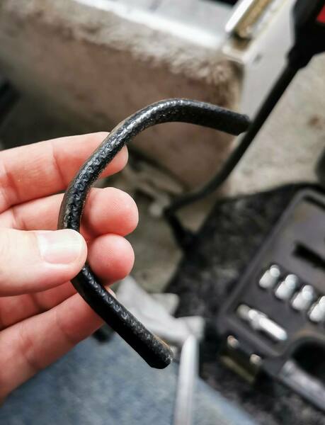

I did completely fail to remember to pick up the hydraulic hose for the suction line to the SLS pump though...will need to go back tomorrow for that.

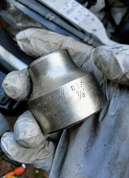

I'm sure the hex head is actually a metric size, though I don't have a clue what size it is...none of my metric sockets are big enough...this worked fine though!

The vast majority of the bottles are labelled both on the lid and bottles, like so...
The one that caught me out was very much an outlier!  Definitely won't make that mistake again though.
Before I set about running tests I sorted out the other coolant leak I'd noticed, one of the washers was missing from this coolant balance pipe.

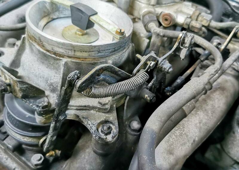

I'm not proud of the bodged throttle return spring... I'll be getting a proper replacement for this if the engine is staying with us, but it does work.
Aside from a few plastic covers for the HT leads everything is now back in the engine bay.
Finally meant I could let the car warm up properly until the fan was cycling (which it was also nice to see was working as the switch came with the new head so was untested until now).
So how's our oil pressure looking?
In gear right at the point when the fan is cycling, about like this.
Though the idle is definitely a bit low which won't be helping - at 1000rpm it seems reasonable.
Deliberately checking for it at a set engine speed as that will make it far easier to tell if it's getting worse over time.
Here's a quick look at how it tracks with engine speed.

I think the vast majority of the oil came from the initial leak we had from the timing chain tensioner.  Slightly puzzled as to where the exhaust manifold gasket came from as I'm reasonably confident that two went back on each of the runners...

Something which definitely is not smooth however is the gearchange.  It feels like gears are being changed with a goddamned sledgehammer.  The box has always been a bit clunky, especially 2nd-3rd and when cold, but every change at the moment is totally devoid of any slip.  To the extent it's honestly painful.  Definitely can't be doing anything any favours.
There's no adjustment I'm aware of on the kickdown cable I removed, but I'll definitely double check that tomorrow and make sure I've not routed it wrong so it's binding or anything.

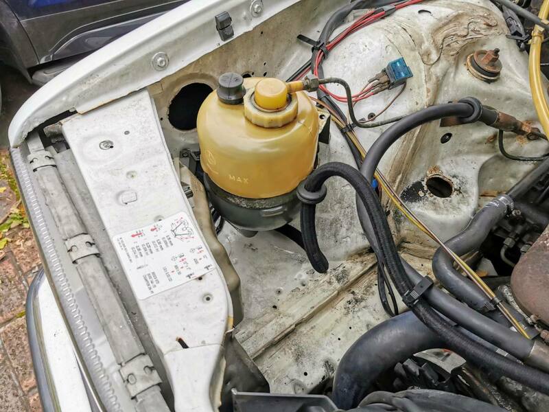

I did note the fluid level was quite low, so topped it up.  Well...aside from the half pint or so I felt it necessary to dump over the exhaust manifold.
Cleaned as much of it up as I could, but it still stank for ages...guess at least it wasn't EP90!
Pirtek unsurprisingly had no problem picking out a suitable hose to replace the leaky suction line for the SLS pump.  This has been sweating for ages and I think was responsible for a lot of the oil over the front of the engine.
Definitely looks a bit tidier...plus will be nice to not get covered in hydraulic oil every time I accidentally brush against it.  Was a bit of a faff to change it without draining the reservoir but I managed it.  I didn't have any of the correct oil in stock so didn't want to drain it if I could avoid it.

Can anyone see the problem here?
How about now?
Yeah...that is going to be doing any good just flopping around underneath the inlet manifold.  It's the line which goes to the shift modulator on the gearbox - and a lack of vacuum there would indeed explain why it's been changing gear so harshly.
The issue is though that I couldn't connect it without displacing something else...which tells me that something is hooked up wrong.  There is a solenoid controlled valve which looks like it should have something hooked up to something on the second port, but it's not been connected since before I got the car... I'd assumed up till now it was a vent.
I made a best guess for what I think went where to give everything a home, but I really need to find a proper diagram to show were the lines are actually meant to go.  There are just too many of them on this car to sort out by intuition alone.
This *has* mostly sorted out the gearchange though.  Second to third is still a bit of a thump and she still doesn't want to use first gear unless you absolutely boot it from a standing start (not sure if that may be by design?) but it's a thousand times better.

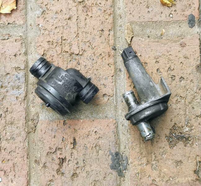

With a bit of poking around I ascertained that the IAC valve was doing nothing.
Pulling it off the car for inspection revealed it to be completely jammed up.  I did free it off after a bit of effort and cleaning, but for now have put the one off the old head on.  It turned out that an adjacent vacuum controlled valve which is something to do with the PCV/idle circuit was also stuffed, both being physically stuck closed and with a blown diaphragm.
Again, swapped this out with the one from my original head.  Still doesn't seem like the IAC is doing much of anything... though see my earlier comments about vacuum lines possibly being hooked up wrong.  This evening's task is going to be finding a proper diagram of the vacuum line routing.

Edit: I'm an idiot.  That's not an IAC (Idle Air Control) valve I've been looking today... it's the Auxiliary Air Valve...which is used only during warmup from a cold start (it's the device which holds the idle up initially and gradually ramps it down over a couple of minutes).  I should have remembered that given it's the same injection system as used on the Saab 900s which I've had three of and have been messing about with since I was about 12.  It's amazing what you forget after a couple of years!  Thanks to the person who pointed that out, I really appreciate it.

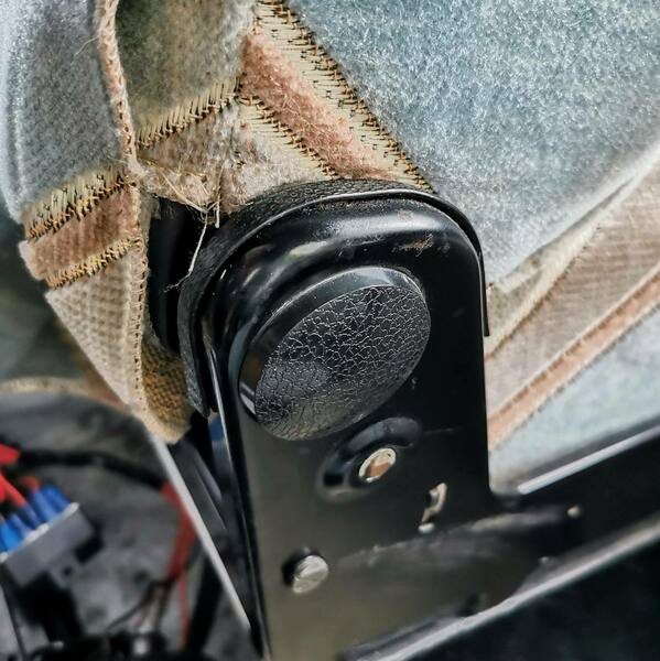

Oh, and reattached this bit of trim that was shaken loose by the brutal gearchanges during the earlier test runs.
I wasn't kidding about how harsh the jolts were!

Cleaned up the area immediately around the SLS hydraulic reservoir, hopefully now the hose isn't sweating it will stay dry now.
Somewhere that wasn't dry I spotted while walking past the car when taking the dog out for a walk earlier was the offside rear corner.
I was initially slightly concerned that might be fuel (I know the tank does leak when absolutely full), but it turned out to be water.
Looking down into the area where the jack etc is stowed showed the source.
There was about 4" of standing water down there.  Not screenwash either, so the rear washer bottle isn't to blame.
A bit of flailing around blindly I found what felt like a drain hole, and after fishing out some pond scum several pints (I'm not kidding, there was quite a lot) of water came pouring out.
Not entirely sure where that water had come from, but I'll definitely keep an eye on that.  There's enough rust on this car as it is without it actively trying to dissolve from the inside out.

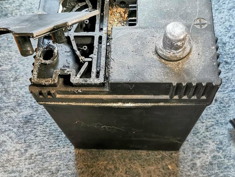

The van was the other recipient of some attention.  The leisure battery has been showing signs of having died a sudden death recently.  Dropping like a stone to around 10V pretty much as soon as any load is applied.
Before consigning it to the recycling bin I figured it made sense to at least check the electrolyte level, as a visual inspection can often reveal signs of damage too.
The label helpfully said to remove the sticker for maintenance...so I honestly expected to find cell plugs under it.
Yeah...about that.
Strikes me as an odd decision to render this sort of battery unserviceable given by its very nature as a leisure battery it's likely to spend a lot of time on float charge when the vehicle is in use or in standby ready for use.
In this case all it told me was that yes it's toast.  The electrolyte in all but one cell is the colour or strong black coffee and on closer inspection the one end of the battery has bulged out by about 1/4".
That lip below the lid is recessed on the opposite end.  Something has gone quite badly awry in this battery.
New one is about £100, not the end of the world but a cost I could have done without.
For anyone seeking to do the same thing and discovering a lack of a large hex key in their toolbox on a Sunday/while in Outer Mongolia, if you have a nut and bolt with the right size head they can be welded together or onto a steel bar to make a passable facsimile provided the torque needed isn't too huge.
Or a bolt as @somewhatfoolish suggests, but with two nuts on the thread, done up tight against each other with a spring washer between them.  Better for someone like me, with no welding facilities.

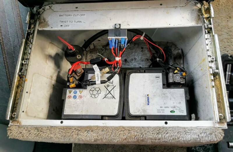

This afternoon I got slightly sidetracked by the van.  Having temporarily removed the leisure battery while I await arrival of the replacement I figured it would be prudent to remove the fuse from the split charging system.  I've isolated the leads anyway, but better safe than sorry.

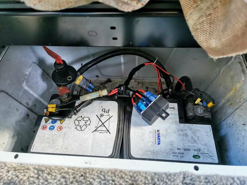

The main vehicle battery box is something I've barely touched since I got the van.

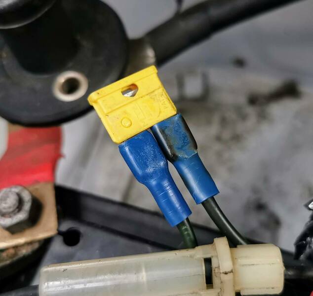

The white in line fuse holder is the one for the split charging circuit.  When reaching for it I couldn't help but notice the random blade fuse taped to a pair of spade terminals next to it was hot.  Like REALLY hot.  "I'm surprised it's not actively smoking" levels of hot.
A little bit of investigation revealed this to be the DC feed to the fridge, which apparently I'd accidently switched onto DC mode at some point.  Being designed purely for use when in transit to/from places that's set up so it will only be powered then the vehicle charging system is active.
While the fuse hadn't blown, this clearly isn't up to the job!

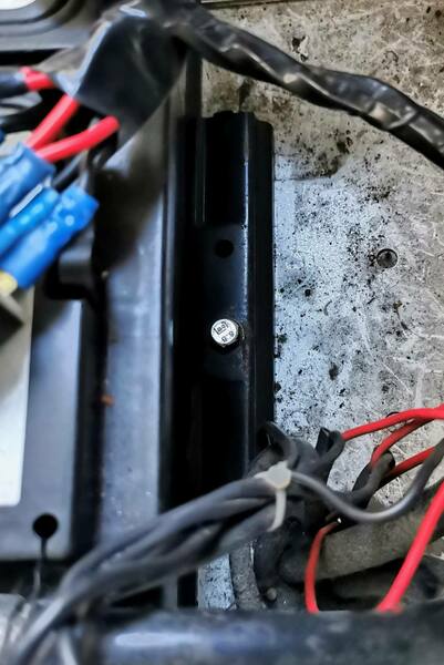

It was about this point that I discovered that the battery wasn't bolted down either.  That was fixed first.
While rummaging around down there I found this bit of plastic.
It looked familiar but took a good couple of tens of seconds to figure out what it actually was.  It's edging fitted to the front seat frames, like this.
The outer one on the passenger side has been missing since I got the van...now I know where it ended up, and have refitted it.
I ended up replacing the weedy bit of wire with a maxi fuse holder I had in stock.  It's overkill for the application, but is still fused at 20A...and I'd rather have low voltage DC wiring over-engineered than the alternative.
It's hard to see in the photos but all of the other lines going into the split charge relay are beefier than this one was.
I wound up doing a bit of general tidying up and housekeeping...not least actually bolting down the relay rather than leaving it flapping in the breeze as I assume it has been for the last 31 years.
Not as though you'll ever see any of this as it's hidden under the passenger seat!IMG_20211025_165624.thumb.jpg.11140309b79e7aa6483d33b2dc5154a6.jpg
Nevertheless, after running it for half an hour I confirmed that the terminals of the new connection were just barely warmer than ambient...a large improvement from the starting point!  So I'm happy it's been sorted even if nobody will ever know.
