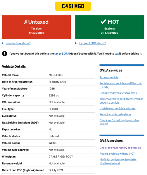

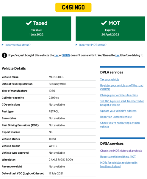

I see the keeper change has gone ahead :)
427411412_Screenshot2021-07-18at14_10_35.thumb.png.2690c6eddc8efe9815e3f022b315a747.png
hope you have nice and uneventful trip back home! :)
Should show as taxed, bloody system.  It was put through about 30 seconds after the keeper change.

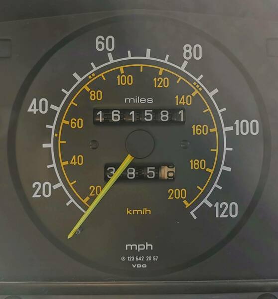

385.9 miles covered till just before I turned into the estate when I fuelled back up (with nice ethanol free Supreme 99).  30.16mpg, which isn't too bad at all I reckon given we weren't hanging around for a fair bit of the run.

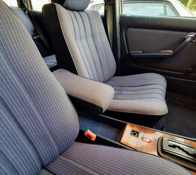

For all she looks a little care worn cosmetically in a few areas she actually drives incredibly well.  The waft is strong with this one.  She does have a decent turn of pace though when asked.
It took me until departing the toll booth on the M6 Toll to discover the front seat arm rest...and about another ten minutes to figure out how to deploy it.
That huge, carpet lined cubby where most cars would have the handbrake is absolutely brilliant.  I am going to miss that in everything going forward!
Why don't more cars have sunroofs this big?
Cabin is generally a nice place to be...resecuring a couple of bits of trim, sorting the front and rear trim panel headlining and a really good clean will transform it.
Really good rear legroom.

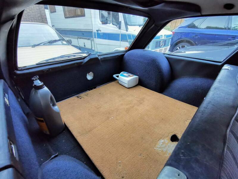

Boot space is absolutely massive...this must be twice the size of the boot in the Lada which is the only other estate I've owned to date.

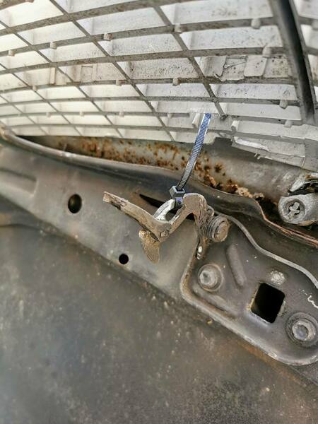

Little very mild tinkering before I went out to run some errands this afternoon.

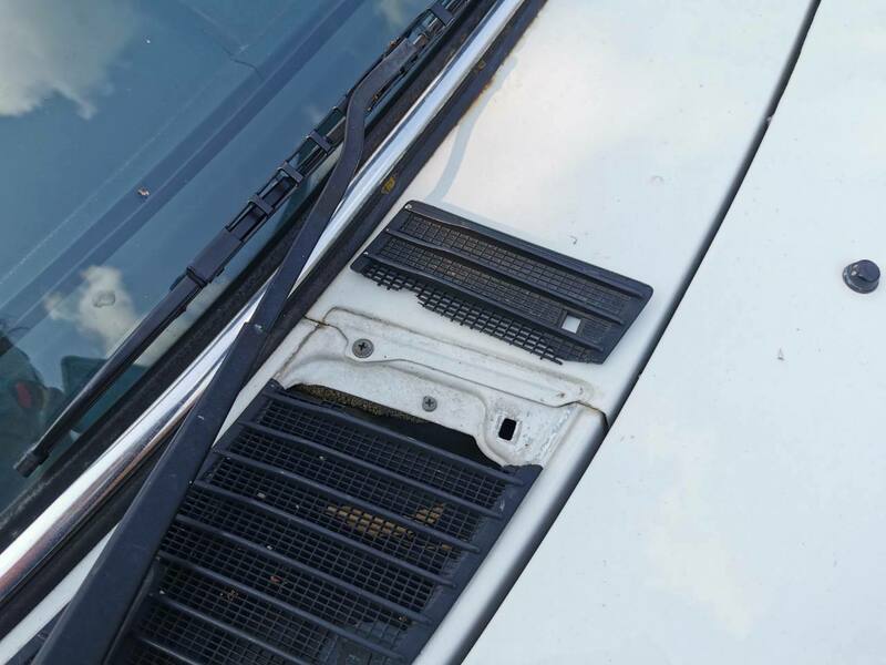

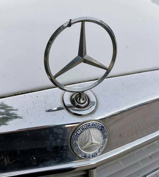

Step 1 was to implement a slightly more robust solution to the broken secondary bonnet catch pull than the bit of bent wire on it.
Cable tie to the rescue.
Which I can tuck back into the grill to make it slightly less conspicuous when not in use.  Of course I remembered about 30 seconds after this that I have some grey ones in the garage.  Meh, it will do for now, the broken bit will be getting replaced eventually anyway.

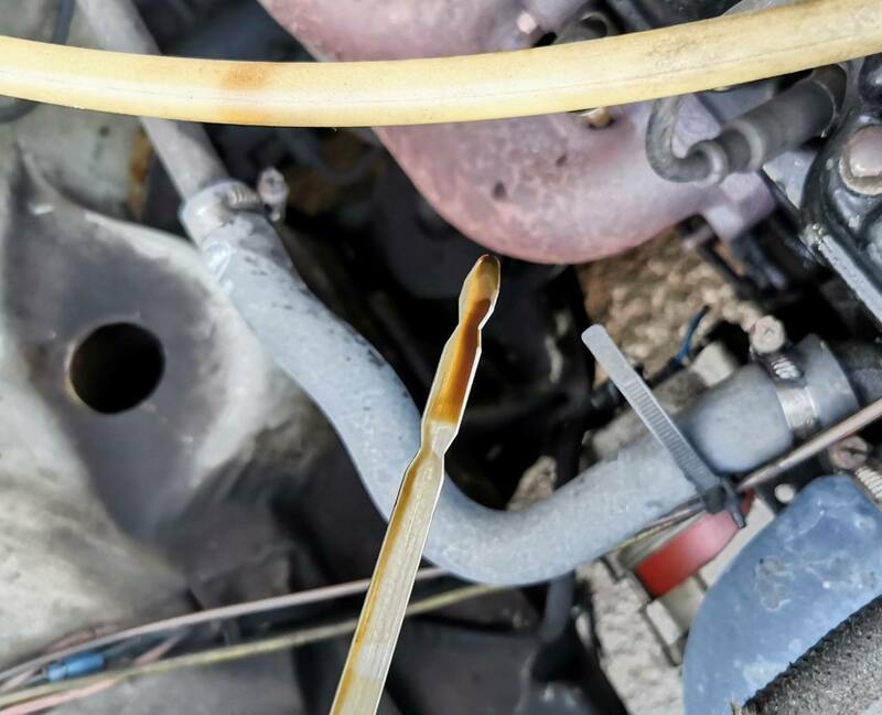

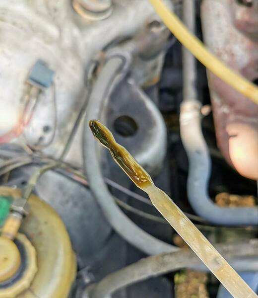

While I was under the bonnet there were some checks to make.  First up, how much oil did we use during the run down yesterday?
An unmeasurably small amount it appears.  Nice to know.  Coolant hasn't moved either.

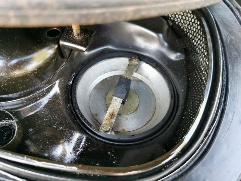

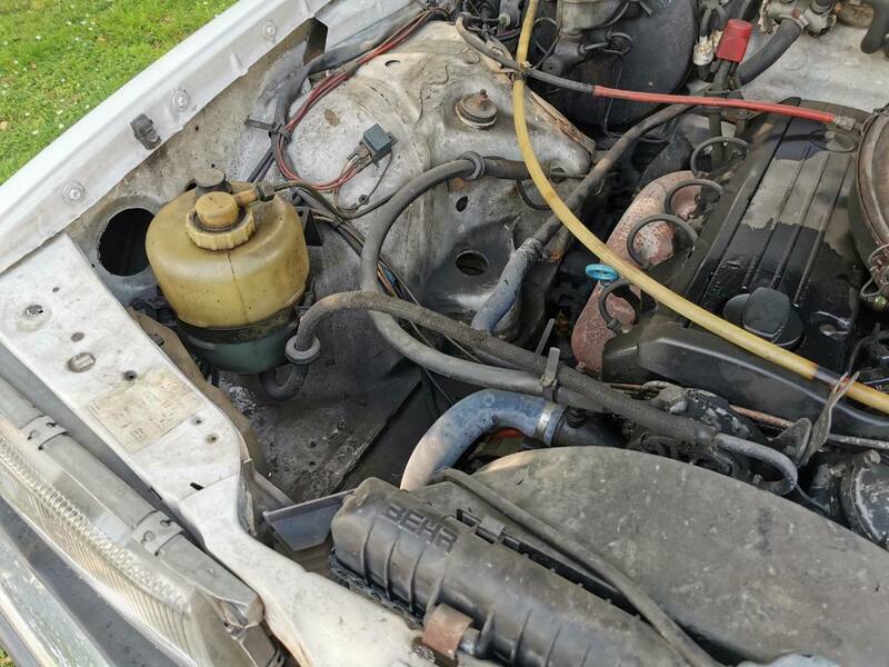

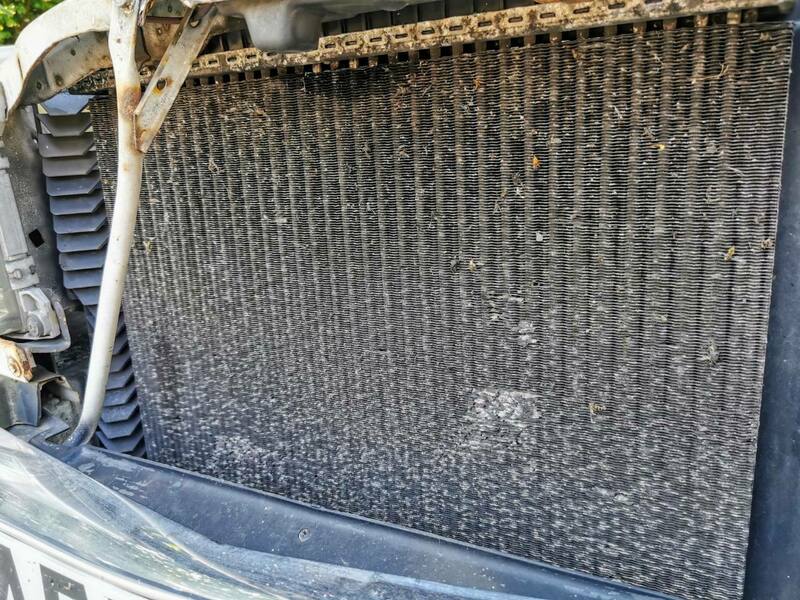

On the subject of coolant the radiator isn't in the best of condition.  It's serviceable (if she held temperature yesterday she should do under any situation) but I'm going to keep my eyes peeled for a replacement.

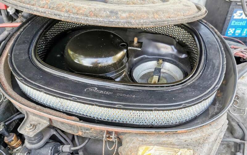

Air cleaner looks to have been replaced recently so that will be left alone.
The spring clips on the airbox are wicked strong so I quickly learned to keep your knuckles out of the way when releasing them...ow.
Fuel metering plate could do with a clean though.  This ideally wants to be cleaner than a hospital operating table after it's prepped for surgery.

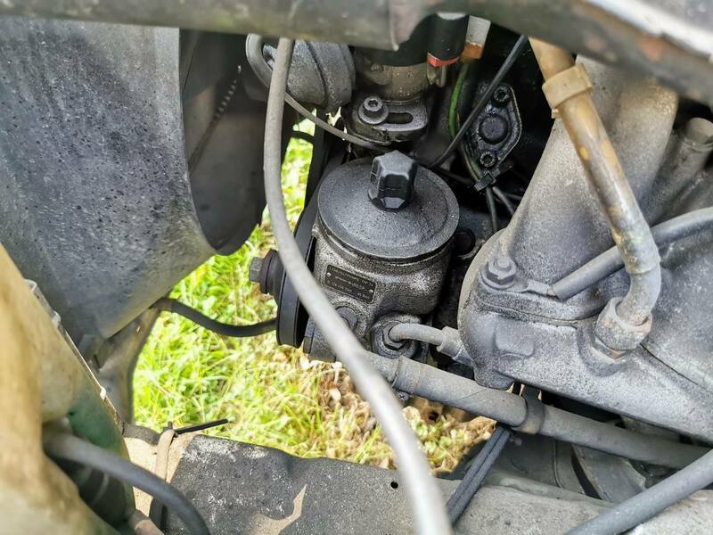

Just having a general poke around the engine bay I discovered that the power steering pump has an integrated reservoir.
Which was a slight surprise as I'd assumed that was what the bottle on the offside wing was - albeit seeming vastly oversized for such an application.
Need to investigate that further at some point...know I've read somewhere that some of these cars had a self leveling system on the rear suspension...so if this had that fitted this could be the reservoir for that.  It's definitely *something* hydraulic, and the pipes disappear downwards under the brake master cylinder.

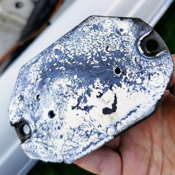

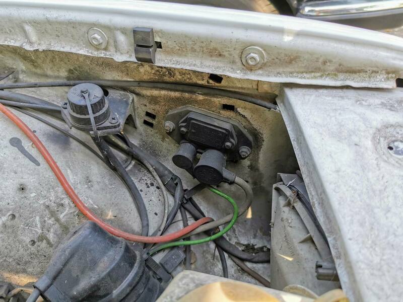

Ignition amplifier was easily found on the nearside inner wing.
The heatsink compound under it wasn't horrible but was clearly just starting to break down and go chalky in a couple of places.
This was cleaned off and replaced with new good quality stuff.  I do note that the O-rings on the wiring connectors are badly perished so will need to change those - especially as a date with the degreaser is definitely in the future of this engine bay.

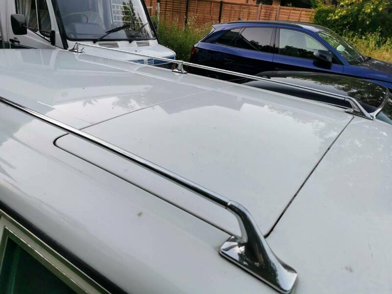

The thing I learned this afternoon:
If you brake firmly at speed, the sunroof slides closed and scares the living daylights out of you.
Didn't occur to me to check if it latches into place in the open position...will look next time I'm out.
On 18/07/2021 at 20:03, LightBulbFun said:
ah I wont worry about it, that always takes a little while longer to update! ill keep an eye on it and let you know when its status updates :)
(its only fairly recently they implemented instantaneous keeper changes even! back when I got REV if you may recall even tho I did the keeper change online it still took about 14 days to process the actual keeper change!)
 you will be pleased to hear its showing as Taxed now :)
437095675_Screenshot2021-07-20at13_02_36.thumb.png.880cdf05276ffec658c6d2137169c149.png
and so is the Xantia now for whoever has it now! :)
1213260395_Screenshot2021-07-20at13_03_03.thumb.png.8105417c7361d75565bcf5225c25a5c6.png

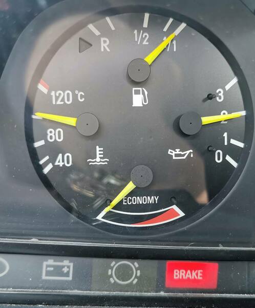

Just as a bit of background to the "thermal incident" during the trip home, this is the highest the temperature gauge ever seems to get to, in stop/start town traffic today with 30C ambient temperatures.
It gets that far, then drops back down to just below that mark on the gauge over the course of a minute or two, then just repeats that cycle.  Presumably as the (electromagnetic) clutch on the fan cuts in/out.  Temperature when actually driving seems to sit at a fairly solid 85-95C.  So I don't think she's overheating, rather something just took exception to being hot.
Checked today and the sunroof does indeed latch open.
Noted for future reference, hopefully will scare myself to death with it less in future.

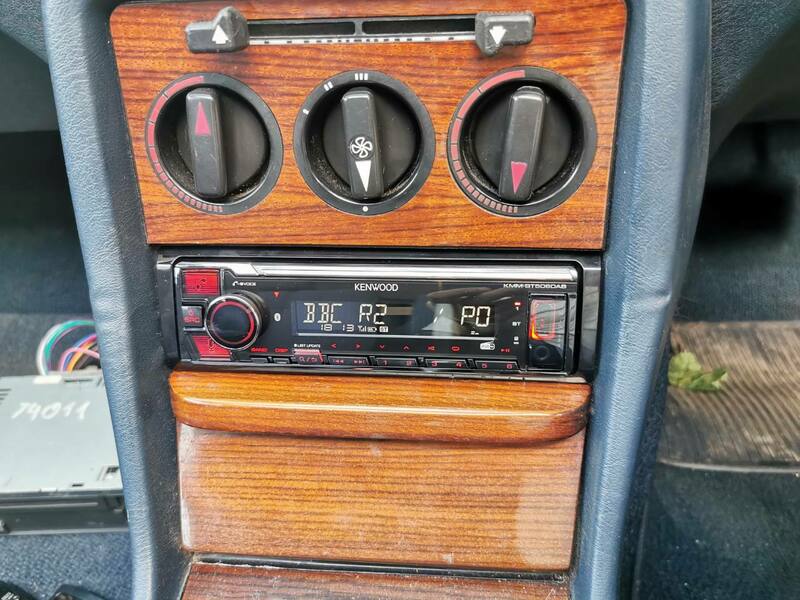

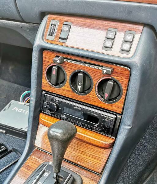

While the stereo fitted was relatively recent it lacked Bluetooth connectivity.  Given that this is a car I plan to use regularly this was a must have.
Pulling the old one out revealed that the cage wasn't actually anchored to the dash at all and typically 80s stereo wiring.
The "I wonder if I can leave it be..." Lasted about two seconds after I turned it on and I found I could make channels come and go by wiggling the wires...so an actual connector was added before the new head unit was slotted in.
By the standards of modern stereos it's not massively blingy at least.
Having fully customisable display colours is a bonus, I went with red for the controls and warm white for the display - matching the heater controls directly above it.
Have discovered that the whole centre console doesn't seem to be attached to the rest of the dash though, so that will need to go on the to do list.
Would have preferred to stick with JVC but none of those available locally had the option to change the display colours and I wasn't having a garish blue LED monstrosity sitting in there...that was one reason I wanted to change it in the first place!
Haven't fitted the hands free mic or DAB antenna yet, will come back to that when I have more time and it's less than 29C in the shade.  In fact I've not even turned the volume up to see how good or otherwise the speakers are, as they may well be the next thing to see attention if they're poor.  Even sticking with the stock sizes there can be huge improvements to be had, speaker tech has come a long way in recent years.  Don't worry, no holes are getting cut, everything will be kept behind the factory grills.

Had a proper nose around in the engine bay today for the first time since I picked the Merc up, when a very basic check of "does it have oil and water in?" was done.
Immediate thing which just leaps out at me is how much room there is around the engine on all sides.
Even behind the engine there's about a 6" gap.
Anyone spot something missing there?
Yep, missing a manifold nut.  Looks like the threads are a bit chewed up so we may wind up with a few washers involved.  I'm inclined to just leave the stud alone rather than breaking it trying to remove it for replacement.  I *have* a spare head and manifold here but I'd rather not have to mess around swapping parts over between them if I can avoid it.
Looks like radiator replacement will need to be moved up the list a bit.  Not lost any measurable amount of coolant, but the top tank to core seal is definitely weeping.
Will have a dig around and see what I can find.  If there's a drop in all-metal replacement I'd rather go that way as I'm really not a fan of plastic tanked radiators.  Having said that I'm kind of curious to see if I can find any date codes on it to see how old this one actually is.
First mechanical job though is definitely going to be setting the valve clearances in the hope the rattle is slightly reduced.
As soon as the new rocker cover gasket arrives (a whole £18 from the dealer - going rate on eBay looked to be £20-25) I'll get that done.  Then drown the whole engine bay in degreaser and blast the worst of the crud off, as it's honestly disgusting.  Every time you touch anything you get covered in oil.
Did notice one nice detail in the engine bay that I'll need to try to remake...you know all that technical info for servicing you're likely to need?  Spark plug type and gap, timing details, valve clearances...all right here on the slam panel.
Nice little detail to find.  Just a shame it's so faded...wonder if someone sells reproduction engine bay sticker sets for the W123...

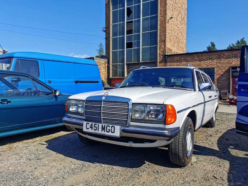

Feeling quite positive today.  There was a certain degree of "what have I got myself into" creeping in with regards to some areas, but I'm getting more convinced that there is actually a good car here, she just needs a bit of TLC.

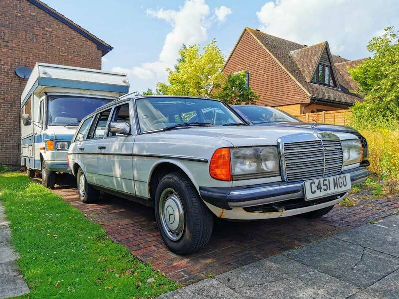

Finally got around to getting a couple of photos of her and the van together.  These do a good job of showing how much wider than a car the van is too.
I think a couple of paint touch ups, a damned good polish, some nice fresh tyres and a new set of plates will make her look quite different.

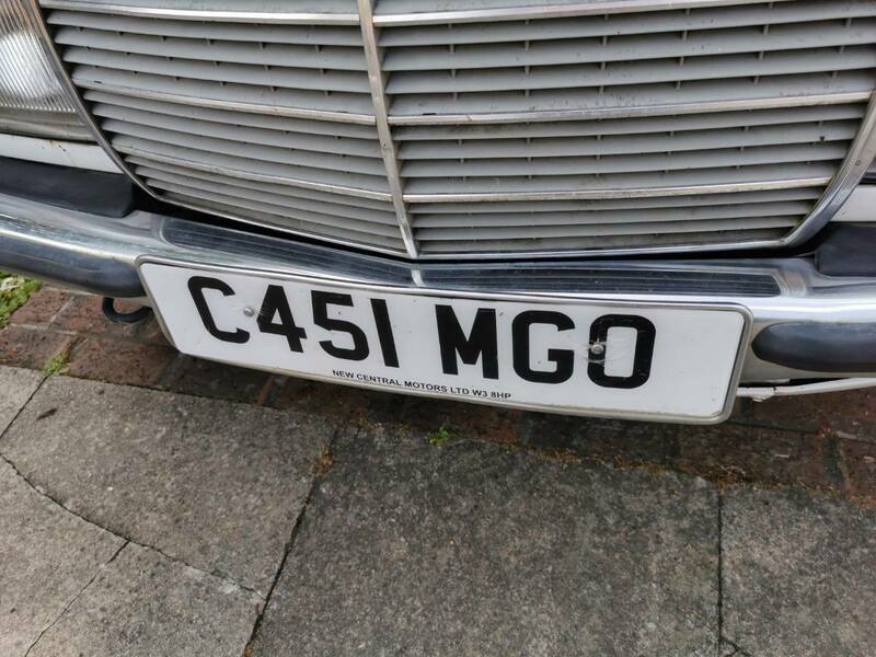

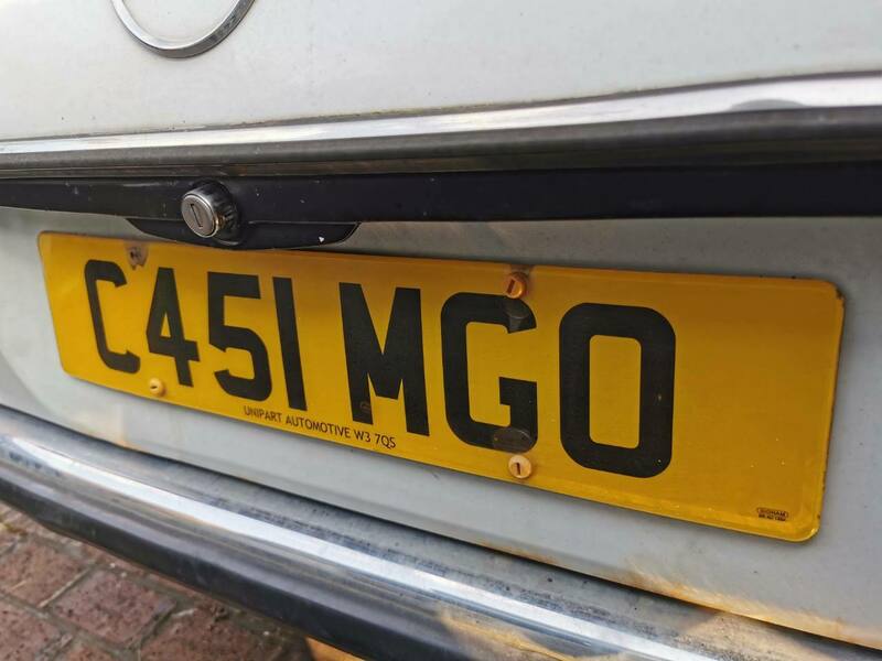

The number plates are both knackered.
What do folks think for plates?  Will be getting them made up in the correct typeface obviously (she wouldn't suit Serck), thinking given the age just standard acrylic plates make the most sense.  Think pressed metal would look like we were trying to pretend to imitate the German ones a bit too hard, which is why they bug me on Golfs etc so much.
Question is whether is just go for a plain plate though or if I try to recreate a dealer plate?  Not sure where this was originally sold.
