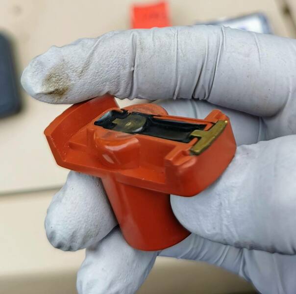

Have been doing a bit more of a detailed look at the rotor arm on the Trevi because it seems like there's some incorrect data out there in the catalogues.
Here are the three rotor arms we currently have.
The top one is what we believe to be the correct one.  The lower two are more recent replacements.  Part numbers below.
The black one appears to match the current Intermotor listing at least visually.
The difference in contact profile is quite visible.
That started to break down to the point that we completely lost spark within ten minutes of installation.
The Vemo one lasted better, and it's hard to see in the photos but it's burning around the tip too.
The one which is resulting in the best running is the ancient and probably badly worn Bosch one.
Here appears to be why.
That's from the centre of the mark made by the centre contact post to the outer edge of the contact tip.  Wouldn't surprise me if that was a round 1" when made.
If this is as old as the distributor cap which came off, it's probably very worn.
The others however are noticeably shorter.
So we need to try to track down one that fits properly!

The hunt for the proper rotor arm for the Trevi continues.  We've got another one here now which was advertised as a genuine Bosch one...which blatantly obviously isn't.  It's a "compatible" one, which is precisely as compatible as the other three we have sitting in the boot.  Which means really not at all.
