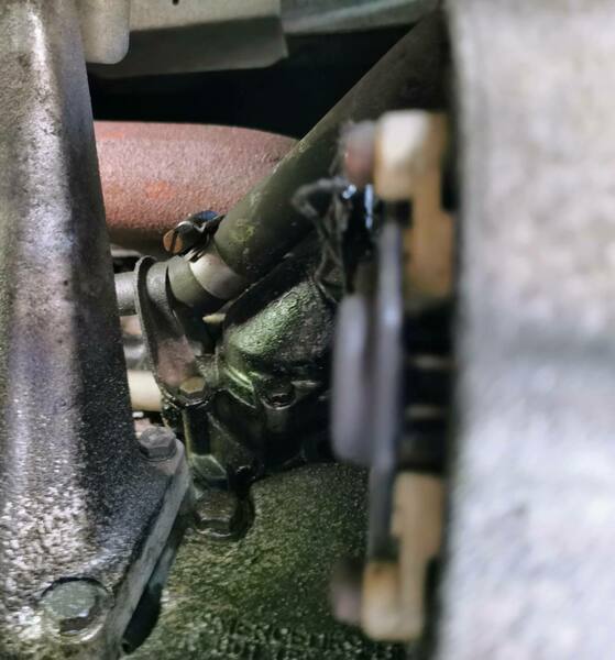

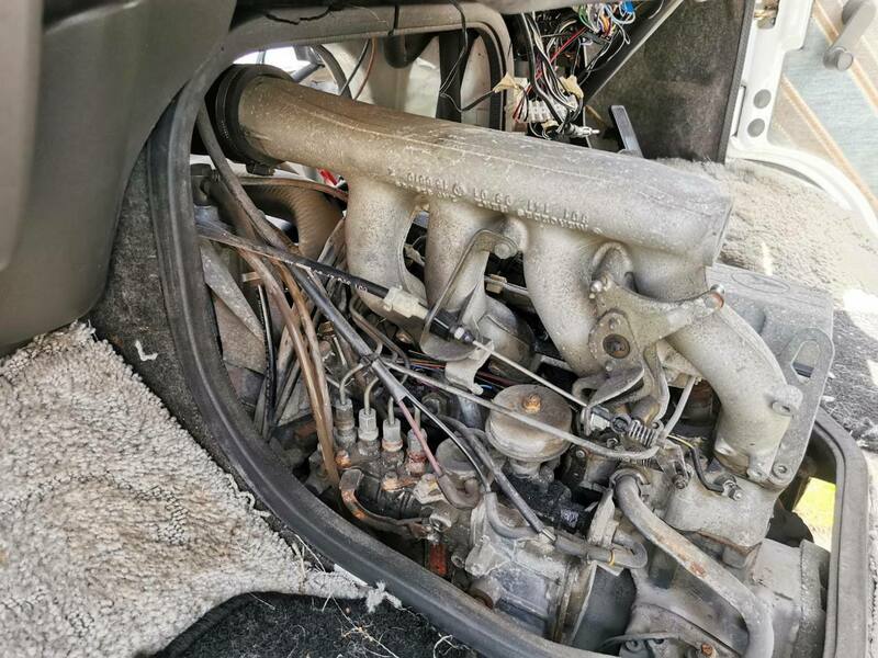

Our mission today was to change the thermostat.  I'm pretty sure the one fitted has been stuck open as long as I've had the van.  Heater gets to furnace levels in the winter so it's not running cold, cold but the gauge never really moves more than 1/16" from the bottom other than on hills.
Passenger seat out, dog house off and we have - just about buried under the fuel system - visual contact with the head.
The casting the top hose goes into though doesn't look even close to big enough to hold the thermostat - which is a moderately sizeable one.

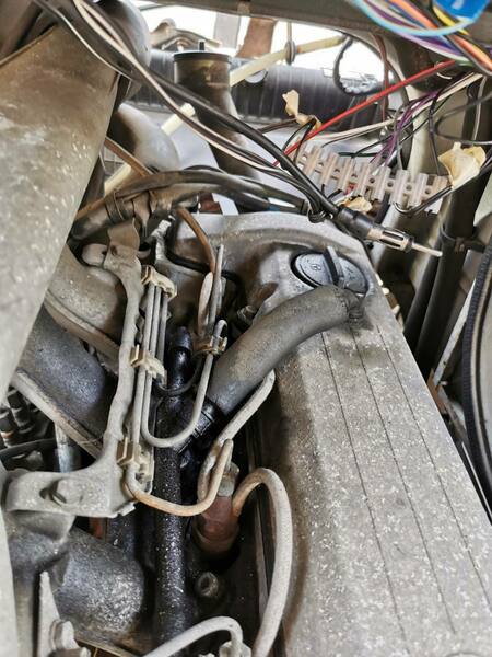

A bit of head scratching and standing on my head appears to have located it, rather oddly kit seems to be at the engine end of the *bottom* radiator hose.
Odd setup...and not exactly easy to get to.  It's sandwiched between the exhaust manifold and offside engine mount, tucked behind the alternator which precludes any thoughts of access from the front.
Near as dammit the lowest point in the system too so definitely be a coolant drain as step one... inevitably I'm going to end up with several litres of coolant in the face doing this job though!
May end up being a case of "screw this, a garage can do it!" depending on how awkward access ends up really being when I try to get tools onto it.

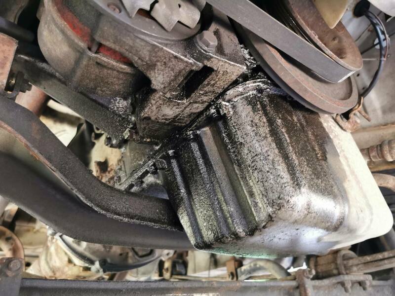

Need to clean the whole area up too as the timing cover gasket appears to be leaking to no small amount again.
Will probably blast this area down with degreaser then hit it with the pressure washer first though as I'd like to confirm if this is coming from the timing cover or oil filler neck extension (bolted to the timing chain cover as in the van application the normal filler is inaccessible) before I go blowing £30 on another gasket for the timing cover.

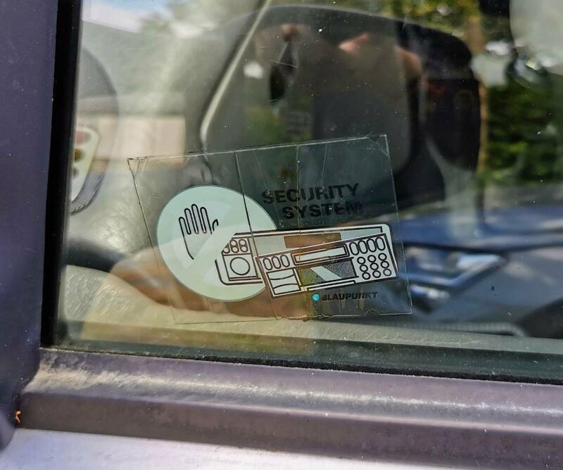

Tiny job done this afternoon...getting rid of these sun-baked and flaking off stickers on the Caddy's front windows.
The passenger side one was horribly wonky too which was bugging me.
It was also peeling away and causing the window to bind up.
Got rid of these ones at the same time.
I really hate stuff like this so surprised it took me this long.
Much better.

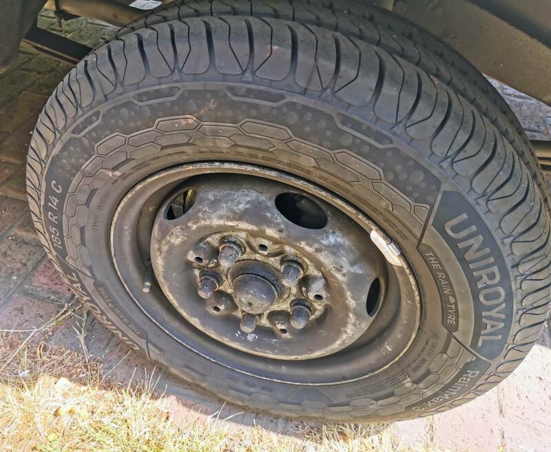

Caddy is now ready to be collected.  They had a good poke and prod around underneath and aside from a tiny bit of play I'd already identified in the universal joint on the steering column itself found nothing amiss or showing any noticeable play/wear.
The tracking however was a different matter.  It was showing 4mm of toe in, rather than 1mm of toe out that's required.  Yep, that would explain why it had always felt a bit fidgety on the road and would match the tyre wear.  So basically the place that adjusted it for me before fouled it up.  It was definitely improved when they did it, but clearly still wasn't right.  Be curious to see if it feels noticeably different when I pick it up later.
Edit: Collected!  Steering definitely self centres better now.  Hard to properly judge whether stability has improved given the trip home was entirely done during a torrential downpour with crap tyres.  I *think* it's a bit better though.  Feels less wayward under braking definitely.
Will definitely be getting a new set of tyres ordered shortly as I've got four now which are badly worn on the outer shoulders.

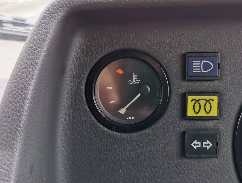

Been running around in the van today while the Caddy was in the garage...still waiting for a point where driving that old crate stops putting a big grin on my face.  It's slow, bloody noisy, has silly heavy steering and doesn't fit in a lot of car parks.  However it just feels right to me from the driver's seat.
I really do need to sort the thermostat though...
That's where the gauge generally sits.  If the heater is on it'll sit about a needle's width lower still.
That's definitely going to be a job for the coming week I think.

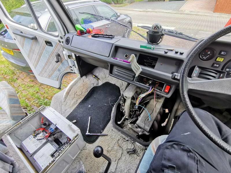

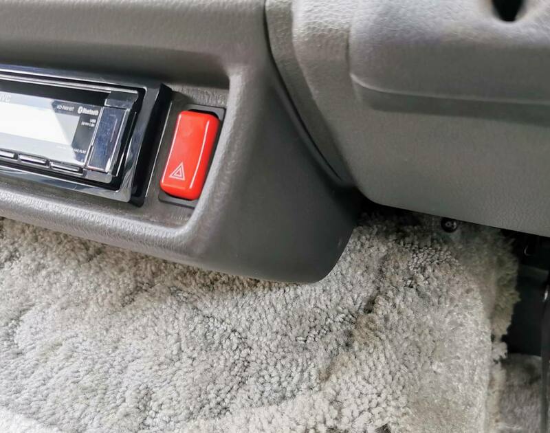

Out in the van today noted that I had lost the nearside front speaker.
This was almost certainly going to be down to the spaghetti associated with the stereo getting caught when reinstalling the engine cover as despite a couple of strategically positioned cable ties it still managed to get utterly in the way.
This was one of those classic jobs which took at least 475% longer than it looked like it had any right to.  However after a significant portion of my afternoon had vanished I eventually got to this.  So much for my "This will take half an hour to zip tie out the way."
Calling it tidy would be an overstatement, and I now need to remember to unplug the head unit from the back before pulling it out the dash - but if that's the price of being able to get the engine cover in/out without ten minutes of faffing around with the wiring I'll call that a win.
Terminal strip was removed and replaced with a bunch of Wago terminals.
I know some people don't like them but I've personally never had any problems.  I'd expect them to be more reliable here than a crusty old screw terminal block anyway.
I may be back in here one day to reroute the power feed (I'd ideally like it to be fed from the leisure battery/ground power system rather than the vehicle battery) and if I ever get around to that I'll probably call work on that system "done" and properly butt solder and heat shrink all the wiring splices.
Yes, there is one black wire joined to a red wire there (orange actually).  That's an illumination line, and is 6" of wire I couldn't bring myself to unfolding from where I was working to go and retrieve another reel from upstairs.  See the above comment...if I'm back in here it'll be replaced - it did get labelled "Dash illum +" before I buttoned things up at least.
Aside from just tidying things up there was one pretty obvious issue I resolved as well.  That was that whoever originally installed the ISO harness never bothered to connect the ground wire to anything.  The head unit was grounding entirely via the antenna sheild and/or through the fixing cage itself (the dash moulding is actually metal under the vinyl finish).  This was attached to a ring terminal I fitted under one of the dash support bolts.  It's always fun seeing what you find when you start digging into electrical work!
Of course this was one of those jobs which looked like I'd decided to completely dismantle the entire vehicle while in progress.
To be fair that is because I took the opportunity to sort a couple of other things while I was in there.  Most notably being that there was no connection to the illumination circuit on the head unit, which was waaaaaay too bloody bright when driving at night and lit the whole cab up.  While I was breaking into the dash lighting circuit I figured I may as well also actually connect up the lighting for the pointless compass that lives on the dash and also see if I could get the illumination for the cigarette lighter to work.

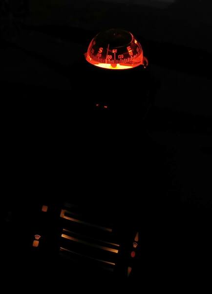

I got the compass illumination sorted simply enough.
Camera unsurprisingly makes it look way brighter, as digital cameras always seem to when dealing with LEDs, it is brighter than the heater controls but being a deep red won't bother me when driving.
Haven't been able to sort the lighting on the cigarette lighter though. Pretty sure it's just a blown bulb, but there's no way to get to the back of it to replace it.  I can just about touch the housing with the tips of my fingers if I pull the blower switch out - but the illumination bit is on the far side of it so that gains me absolutely nothing.  Reckon it's something I would need to literally pull the whole front dash moulding out to get to.  That will have to happen one day when I get the scuttle replaced...so it can be replaced with an LED then, until then it will just have to continue bugging my OCD after dark!
Is nice to have sorted that messy wiring out though - you could always see it down below the hazard switch before.  Nice to have it all tucked out of view.
You wouldn't know from a glance I'd spent a fair chunk of an afternoon working on this.

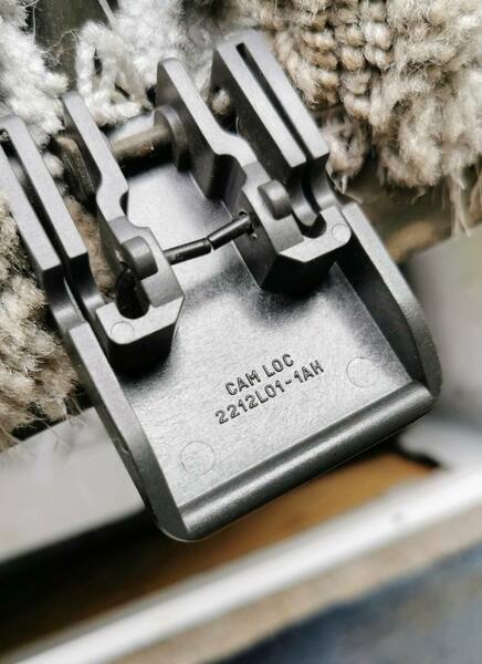

The cover did just slot straight back in though which makes a nice change.  I really do need to try to find a replacement for the nearside clip though as it's split and held together by a cable tie.  It holds just fine but means it's impossible to latch or release it without a screwdriver or similar levering device, which is sub optimal.
That's what they should look like - I suspect the one got broken by someone trying to force it latched when the wiring I just sorted was trapped in the seal.
Judging from the part number on the back this is one of a relatively small number of bits Merc didn't either make in house or buy in stamped with their own part number.
Sure if I do enough digging I'll be able to find a NOS one somewhere.
I have tried to buy a few from breakers over the last couple of years but apparently they're too low value parts to be worth replying to me about.  Well, save for the one guy who wanted £60 plus VAT and postage for one.  That seemed a little steep!  A whole engine cover sans the bloody carpet I'd happily pay that for, but no...I ain't paying that for a bloody clip.

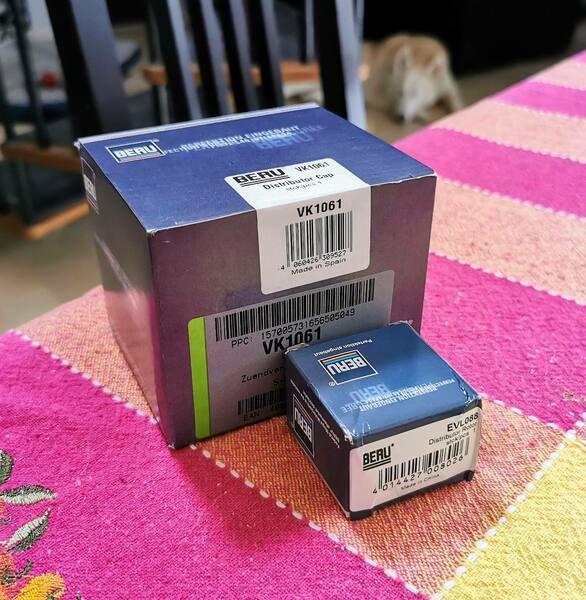

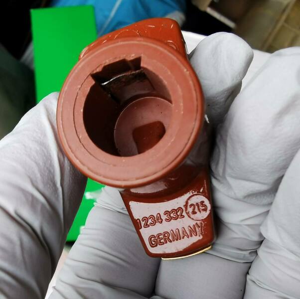

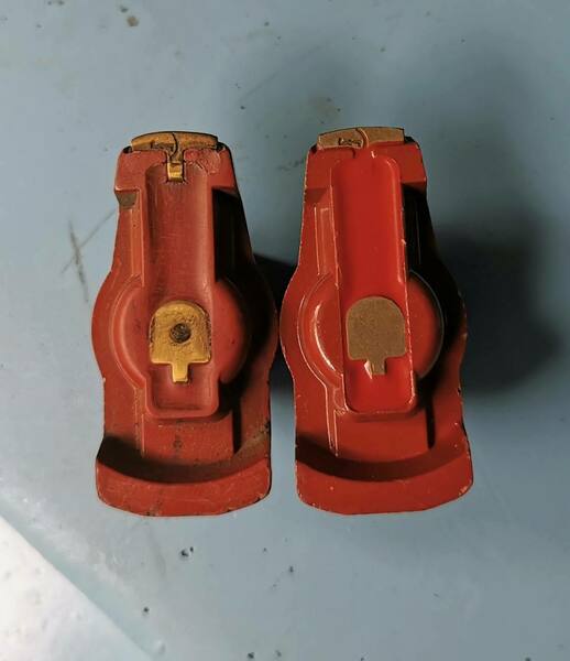

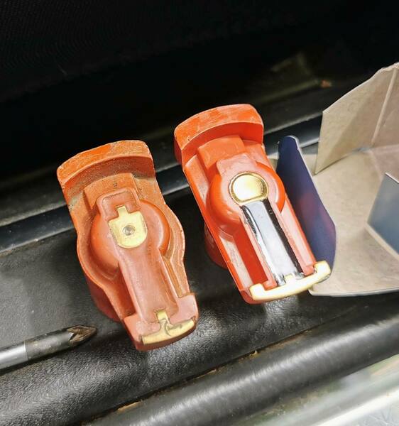

Trevi update.  Saab bits arrived this morning.
The cap is as far as I can tell absolutely identical to the one on there, so that's useful to know for future reference.
I checked all dimensions, position of the rotational registration pegs etc, all matches up spot on.
Rotor arm has a slightly longer duration, but I don't see that causing issues.
Length wise it looks spot on.  Measurement we had for the "good" one was 25.28mm from the centre of the contact point to the tip, all of the other new ones had been significantly shorter.
This one is showing 25.41mm.
I remember saying back then "I'd not be surprised if it was spot on 1" when new."
Oh look...
Unfortunately it's not a match elsewhere!
Though it does at least confirm for us that the supposedly correct rotors we've been finding are too short, having one from another car which uses the same cap in front of me that's the size I expected.
Not sure what to do now short of trying to buy one of every brand that cross references to the Bosch 1234 332 215 rotor arm in the hope that at least *one* company has it right.
Edit: MAY have found one...watch this space and cross as many fingers as you can!

A package arrived this afternoon containing these.

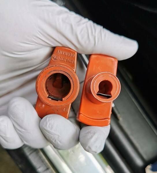

Oh oh...No box, just two rotor arms in plastic bags.  We've been here before.
Or have we?  Upon closer inspection, no they were in fact genuine Bosch parts.
In case people wondered if there really was that much difference between the correct and pattern parts - here's the difference.  The centre post contact point is lined up between these, the pattern parts are really that much shorter.
So you're adding the best part of a full millimetre to the plug gap effectively by using that.
The old one has definitely done its time!
Of course by the time I got a new one fitted to the car it was rush hour so I wasn't able to go for a proper test run.  I did bumble around the block a bunch of times though more than long enough to get the car properly warmed up.
Usually this is when the issues became most apparent, with an erratic miss at idle.
That *seems* a lot better.  It's not perfect, still the odd stumble here and there, but it's entirely passable.  Especially as I'm pretty certain that the carb needs setting up properly and/or at least being treated to a proper service kit.

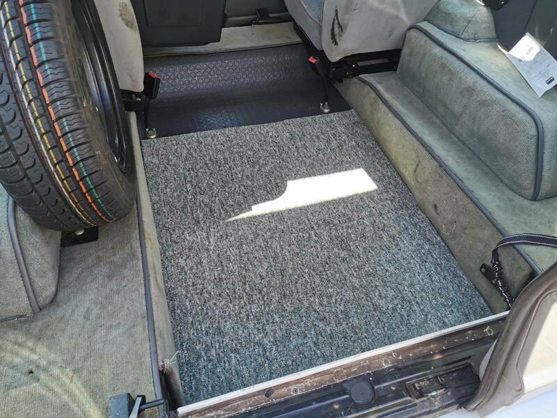

The Caddy has been working very well as dog transport, only real gripe is that the floor in the back is a very hard plasticy material and they slither around a bit.  Star in particular doesn't like that so I've been meaning to put something in which will provide a little more friction.
Progress so far.
Should also help bring noise levels down a little which can't be a bad thing.

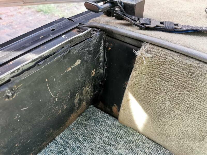

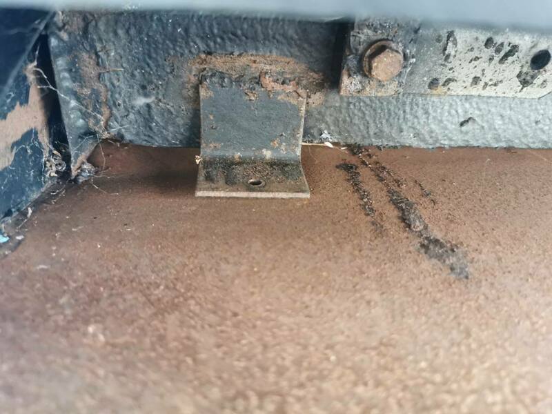

This is the point at which I started looking more closely at the workmanship of the ramp delete...To call it shonky would be something of an understatement.
For a start, this Sikaflex appears to be structural.
Originally that rear section would have been part of a hinged ramp which was attached to a big hinge on the floor.  That took up a bunch of space and would basically delete 70% of your rear visibility (and probably weighed about 100kg), so not surprised it was removed.
It would be nice if they had done a better job of it though!
Apart from the Sikaflex, the only thing that seems to be actually connecting the centre section of the bumper, lower door latches etc to the rest of the vehicle are these *quality* welds.
Think that's bad?  How about the other side?
Yeeeaaahh... quality workmanship.
The inner and outer panels there are "spot welded" together...in so far as someone has thrown some weld vaguely at the panel...however there's about a 1/8" gap between them and I don't think a single one has actually connected the two bits together.
I think the plan will be to pull the outer section off entirely, remove the currently structural Sikaflex, at which point I think the inner ramp delete panel will basically fall out.
I will then clean up and rust proof everything involved (there's no paint on the outside of the ramp delete bits at all).  Then I think I will permanently attach the outer section to the inner off the car.  Then I'll offer the whole assembly up, and bolt the whole lot into place using some hugely overkill 90 degree brackets and high tensile bolts and big washers.  Then we'll seal up the joins with fresh Sikaflex.  That should do a far better job of sealing things up and sort the wobbly bumper issue.

The van will be going in sometime over the next couple of days to get a full set of new tyres on to deal with the horrible perishing going on with the current set.
I'm not inclined to take chances given the amoutof weight on the back axle on this.
There's not as much choice in 14" van tyres any more, but for what it's worth, Toyo Nanoenergy are my favourite all-rounders on the LT and are lasting well at the moment (~50% worn after 20k miles). No problems with grip, although I hardly push the limits. It's hardly an exhaustive test but in 90k miles I've used Hankook Vantra LT (wore out in 20k miles),  Kumho 857s (better wear but perished in less than 4 years), GT Maxmilers (lasted well but easier to spin a wheel in the wet).
It's got the GT ones on at the moment, and aside from the degree to which they have perished the thing I find most off-putting is how ridiculously easy it is with them to lock up the brakes on anything other than a perfectly dry road.
No visible wear at all to speak of (I've not actually measured it), just they have started to perish badly both on the sidewalls and between the tread bands.
It had the GTs on the back when I bought it - I did 20k miles in the first year I owned it and they barely wore down any further! But yes, even double digit horsepower was enough to spin the inside wheel pulling out of a wet junction, so can imagine they may be easy to lock up on the front.
There we go.  Much better.
Funky sidewall pattern.
As for how they age and wear, guess time will tell.
I really didn't expect to feel any difference from the driver's seat but you really can.  Tracks much more stable in a straight line and the steering response is definitely sharper.  Seems quieter too though that's kind of hard to say given how much of a racket the rest of the vehicle makes!
At least I don't feel uneasy driving it over 30mph any more.
