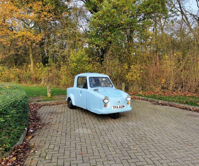

Today though the weather was far too nice not to take TPA out for a run to conduct the day's errands.
Not really expecting her to be out all that much now until the spring, but if we get crisp days like today and I can actually get out of the driveway (we tend to get buried parking wise because we're right next to a school) I'll of course take the opportunity.

So we're on our way.
Should be there in about an hour.  Let's see what we find.
Oops.
Well I've just A - Made a load of work for myself.  B - Ensured my imminent demise. C - Made a load of work for myself.
  • Zelandeth changed the title to Zel's Motoring Adventures...Merc, Vauxhall, VW, AC Model 70 & A Sinclair C5 - 03/12 - I have done something very silly...
