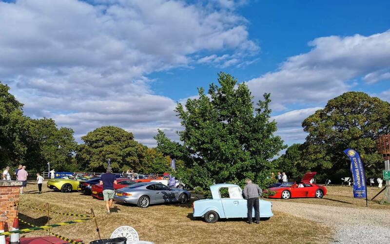

This evening I took TPA out for a wander down the a little gathering over at MK Museum.  There are worse ways to spend a Thursday evening.
I still love this little Micra.  It's so nice to see an utterly unmolested example.
Not sure who brought this thing along...
Was good to see how much attention it got.  Probably one of the most unusual cars there.

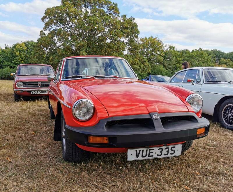

I still do have a real soft spot for the MGB.
I definitely really do need to own one some day.  That colour would do me just fine too - though Snapdragon Yellow would be absolutely be my first choice.

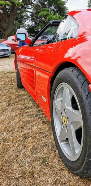

There were a few exotic cars there too, a brace of Astons as usual given they're just up the road, though this was the only one I really deemed worth photographing.
Really exotic stuff generally goes over my head these days, but have to admit this is a car that still for me has epic levels of wow factor.
I do wish they had closed the engine cover at some point - though the engine *is* rather nice to look at.
Would have been nice to get some shots with the cover closed though.  That's why I always try to alternate that periodically if at a show so folks can get photos of the car without it in the way but those curious can also still have a look at the engine.
The interior is a rather nice place to be.
Absolutely zero interest in any modern Ferrari, but yeah this would definitely make me turn and look.

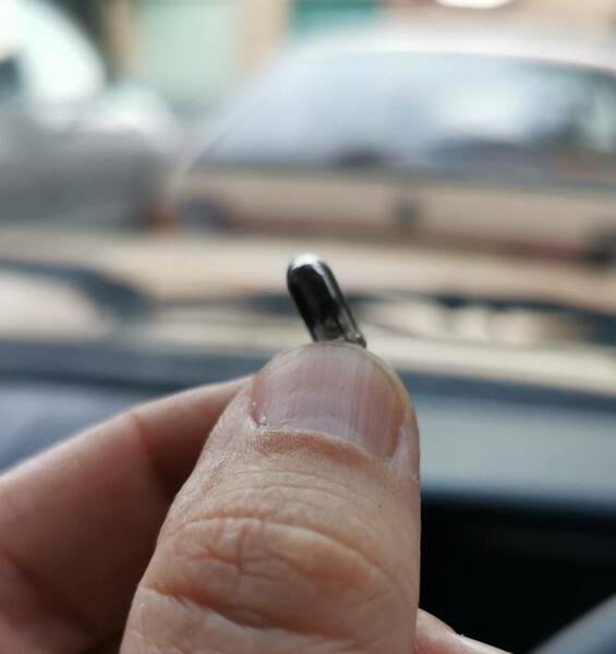

This evening I was determined to get a half hour to actually do something I wanted to, so went after some of the none working dash lights in the Cavalier.
Once I figured out how to get the rear window demister switch out (there's a recess to hook something behind above the symbol, then it just pulls straight out) it was pretty obvious why that light wasn't working.
New lamp in and we were up and running.
Photo makes it look far brighter than it really is.
Didn't expect to see the symbol change colour to show when the switch is on on a car of this age.  Nice touch.  The camera hasn't really caught the colour right, but it's a kind of magentaish colour rather than red or amber, matching the marker on the switch.

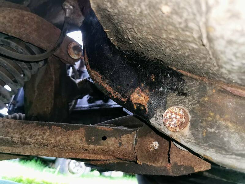

Did notice something less than ideal when crawling around for the drain plug (which is quite awkward to get to because it's towards the rear of the sump and the engine is a long way back already).
While I'd poked several bits of surface rust in the vicinity of this bit, apparently I totally missed this crispy but of chassis rail.  It's absolutely not the end of the world, it's a simple rectangular box section so pretty easy to reconstruct, could have done without it though and I'm irked with myself for not spotting it before.

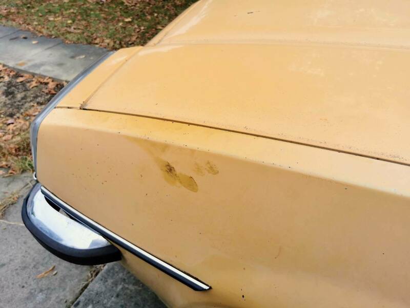

I did wonder if it was historic damage from jacking improperly or something, before I realised the cause.
That damage lines up absolutely perfectly with the centre of the dent in the nearside door and the slight kink in the exhaust.  Was clearly caused by the telehandler fork when the car was picked up (though it's obvious the area was weak before so would have needed work sooner than later anyway).
It's just never nice when you find structural bits that have turned crunchy.

Hmm...do I need to look at replacing this wishbone or is that gap by the upper ball joint normal?
Shock absorber bushes are well past it - but the shocks themselves look pretty rough so I'll probably replace them as a set in the not too distant future.  That's not an immediate concern though.
Getting this sorted however is.
Especially given the proximity of the subframe mounting bolt.
