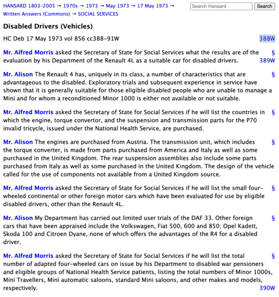

LightBulbFun Posted January 15, 2024 Posted January 15, 2024 On 14/01/2024 at 19:40, Mrs6C said: I was wondering where the 'hers' R4 was hiding... have you checked next to Dolly? I say that because Renault 4's where supplied by the Ministry on the Invalid Vehicle scheme to Invacar users who needed a vehicle with more then a single seat, Ie if they where married or had other dependents like children to cater for (contrary to popular belief you where not just lumped with a Model 70 even if you where mother of 5 or such!) The Renault 4 was issued as it was found to be especially/uniquely adaptable to the disabled where other cars where not and was the only foreign car the ministry ever issued I believe https://api.parliament.uk/historic-hansard/written-answers/1973/may/17/disabled-drivers-vehicles @Datsuncog gives us a bit of insight into what sort of disability might get you a Renault 4 On 21/06/2022 at 16:02, Datsuncog said: On 21/06/2022 at 03:21, LightBulbFun said: Id love to know if any Ministry Renault 4's still survive out there... You might know this already, but I understand Renault 4s were provided to people who had lost the use of their left arm and also needed to transport family members - the dashboard mounted gear lever could be modified with an extension bar so they could quickly reach across and shift gear with their right hand. An automatic gearbox wouldn't necessarily have been suitable, as the selector button on an auto is designed to be pressed with the left hand thumb - and this would have been very difficult to operate while reaching over with the right hand. I recall a schoolfriend's father who had lost his left arm in an accident driving a Citroen 2CV through Motability - as it was the only new car still available in the late 1980s with a dash-mounted gearstick. He'd formerly had a Renault 4, but they'd stopped making them by then. Being in the car with him was memorable... what I find quite interesting out of all that is that they found the Citroen Dyane an unsuitable replacement, I do wonder why that was given the similar control layout between a Dyane and an R4, to that Mr Cog says On 21/06/2022 at 17:16, Datsuncog said: On 21/06/2022 at 16:24, LightBulbFun said: I know the Ministry trialed several cars to replace the Renault 4 including the Dyane but for one reason or another, they never found a true successor to the versatile Renault 4! I'd guess that the R4 was a cheap, basic box with five doors which was reasonably easy to maintain, certainly more so than the Dyane - something fairly simple like changing the brake pads on a Dyane was a needlessly complex job, the inboard discs requiring the front end to be removed for access! Interesting that the DAF 33 was also trialed - with the Variomatic transmission, I can see why that might have been useful. I am curious @richardmorris/@chaseracer what be your thoughts on the matter as a Citroen owners? anyways hows that for a bit of obscure Renault 4 trivia for yall mat_the_cat, adw1977, AnthonyG and 5 others 8
Mr Pastry Posted January 15, 2024 Posted January 15, 2024 6 hours ago, LightBulbFun said: what I find quite interesting out of all that is that they found the Citroen Dyane an unsuitable replacement, I do wonder why that was given the similar control layout between a Dyane and an R4, to that Mr Cog says A bit more space in the R4, and it has a conventional handbrake lever? LightBulbFun 1
grogee Posted January 15, 2024 Posted January 15, 2024 8 hours ago, LightBulbFun said: have you checked next to Dolly? I say that because Renault 4's where supplied by the Ministry on the Invalid Vehicle scheme to Invacar users who needed a vehicle with more then a single seat, Ie if they where married or had other dependents like children to cater for (contrary to popular belief you where not just lumped with a Model 70 even if you where mother of 5 or such!) The Renault 4 was issued as it was found to be especially/uniquely adaptable to the disabled where other cars where not and was the only foreign car the ministry every issued I believe https://api.parliament.uk/historic-hansard/written-answers/1973/may/17/disabled-drivers-vehicles @Datsuncog gives us a bit of insight into what sort of disability might get you a Renault 4 what I find quite interesting out of all that is that they found the Citroen Dyane an unsuitable replacement, I do wonder why that was given the similar control layout between a Dyane and an R4, to that Mr Cog says I am curious @richardmorris/@chaseracer what be your thoughts on the matter as a Citroen owners? anyways hows that for a bit of obscure Renault 4 trivia for yall Interesting stuff LBF. I wonder how the manual R4 was considered more disabled-friendly than an automatic Mini? (I know it's not all about the 'leg disabled' but you'd think that would be a consideration). Unless there's an automatic R4 I don't know about?
Stinkwheel Posted January 15, 2024 Posted January 15, 2024 7 hours ago, LightBulbFun said: have you checked next to Dolly? I say that because Renault 4's where supplied by the Ministry on the Invalid Vehicle scheme to Invacar users who needed a vehicle with more then a single seat, Ie if they where married or had other dependents like children to cater for (contrary to popular belief you where not just lumped with a Model 70 even if you where mother of 5 or such!) The Renault 4 was issued as it was found to be especially/uniquely adaptable to the disabled where other cars where not and was the only foreign car the ministry every issued I believe https://api.parliament.uk/historic-hansard/written-answers/1973/may/17/disabled-drivers-vehicles @Datsuncog gives us a bit of insight into what sort of disability might get you a Renault 4 what I find quite interesting out of all that is that they found the Citroen Dyane an unsuitable replacement, I do wonder why that was given the similar control layout between a Dyane and an R4, to that Mr Cog says I am curious @richardmorris/@chaseracer what be your thoughts on the matter as a Citroen owners? anyways hows that for a bit of obscure Renault 4 trivia for yall I know you didnt ask me specifically, but id have said, with a similarly flat floor and similar control layout and the option of the 'traffi-clutch' (a semi auto clutch that didnt need the pedal to be pressed for stop and start in 1st and 2nd gear) it would have been fairly useful as a disabled vehicle. Only possible thought is that the renault rear hatch/door offered easier access to wheel chair or similar? chaseracer and LightBulbFun 2

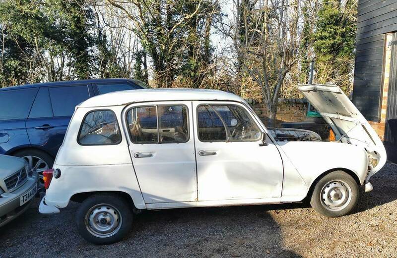

Six-cylinder Posted January 15, 2024 Author Posted January 15, 2024 I when out to the Renault 4 today and found the battery was totally flat. Also the fuel line had disconnected itself from the aftermarket in line fuel filter. It is now on charge and I will try again tomorrow.

Six-cylinder Posted January 17, 2024 Author Posted January 17, 2024 Yesterday @Slowsilver came to help move the Renault 4 into storage, but I could not get it started so for now the Morris got the spot. We then went to the FoD to collect the black Astra and that started no problem. While we were there Slowsilver had a go at pumping the Tyres on the Royale but unfortunately one is so flat the bead is broken and it would not take air. Last was a trip to get the spare key cut for the Sigma which now works better than the original. Floatylight, LightBulbFun, Vantman and 9 others 12
