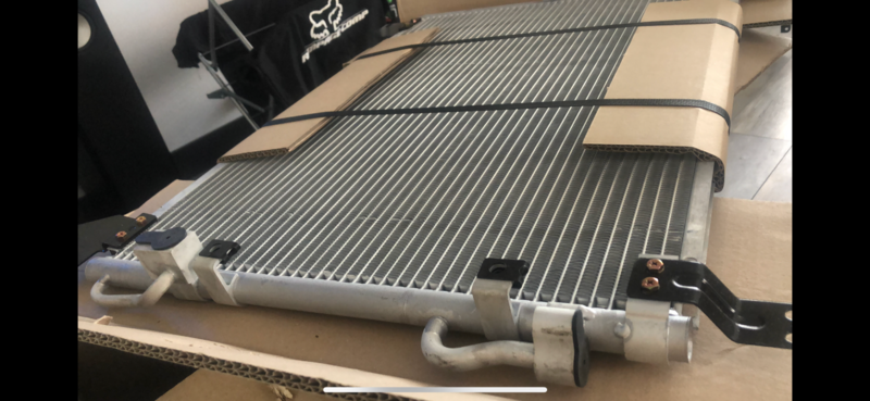

I bit the bullet and called out a mobile specialist. He pressurised the system with nitrogen and his soapy water trigger spray soon found that the condenser was rotten in one lower corner. Score/no surprise. Along with weeping to one of its fittings.

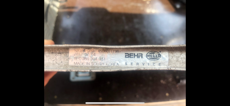

I pulled the rad pack out and ordered a new condenser.
Given that the car was soon to receive a clutch and I'd have to bodge in the intercooler if I wanted to drive it, I just left it apart for a couple of weeks.
When separating the condenser from the coolant rad, the car broke the proud tradition of having never snapped a fastener. Given that some of these have been as small as M6 disc back plate bolts, I let it off, this time.
Second time lucky with the condenser, having first been sent not just the wrong one, but one that was way too out of shape to be trusted.

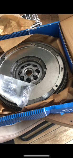

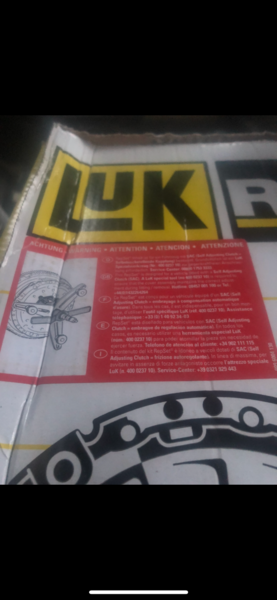

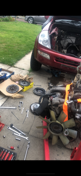

I bought a Sachs branded DMF even though the original seemed fine. Along with a three-pieceLUK clutch kit. The clutch has always been high and it has slipped a few times. None more notably than when I lent it to a colleague and he had to abort towing his twin axle caravan, some years ago.
Perhaps part numbers may prove useful. As we know, there is scant information out there, foe
these things.

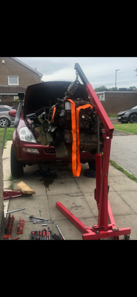

Clutch kit and flywheel in stock, I arranged a suitable date for @jikovron to accompany me in this endeavour that I really couldn’t be arsed with. We hoiked the mighty OM662 out of the bay, with ease, teasing the MR2 in the background that it was to become a veg slurper. It was then that we learned that although the clutch was the correct 240mm diameter, it was a 25 spline example, not the 22-spline variant that the input shaft required. Who knew?
342871E8-13AD-4444-9DD7-BFC7BE51E615.thumb.png.b74b4f49424efeae1eacffa32b627d04.pngDCB4D55C-9BC3-4A2C-9B6D-422771D97EB7.thumb.png.43e772ebeb6114afdce1e95fb8996009.png36674BF9-BEF0-4B3B-8D07-79648BFFF3CA.thumb.png.4bb338a32f073ecfec6b386fd01d836f.png53DD0DFC-73D9-4673-85A1-48B3BC196DC7.thumb.png.33f6bec5554faa05b0729f667ec34c03.png
Certainly not the many clutch vendors who don’t like to specify this insignificant* difference.
The last pic above, highlights some of rhe desperation, whe n we discovered  tbis.
What followed was some desperate stuff. Ron stayed in sunny Houghton-le-Spring for the night and we scoured eBay etc. A plan was to drive to Leeds the next day and pick up an ‘in stock’ 22 spline, 240mm friction disc. I rang the seller and after some arsing on, was told that all of the clutches were made to order – WTF?! - and took 2-3 weeks to be delivered.
GTF, fam.
I then rang almost every motor factor and supplier we could find, in the North East.
No go.

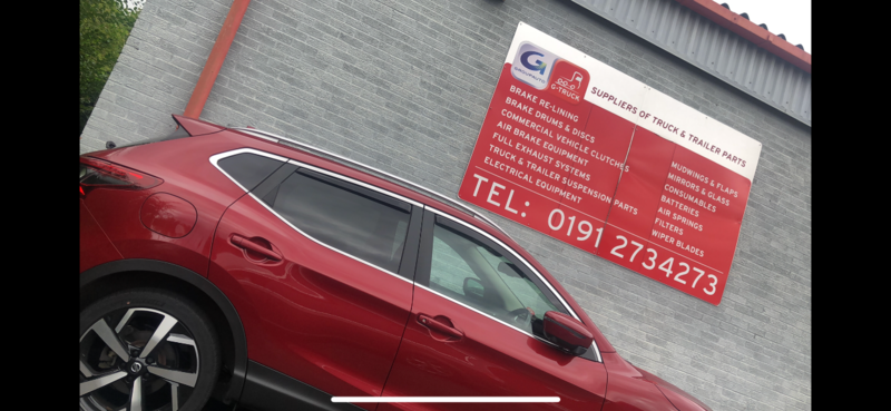

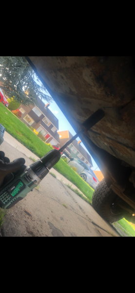

We tried a place that replaces clutch and brake linings, (pic) but they didn’t want to risk it.
Ron then had the idea to try his engineering mate, who kindly drilled the rivets out, with the intention of riveting in the original centre, splined section. It transpires that it differed just enough as to not be possible.
  • Sad 9
We called it there. The engine went back in and I sourced another 3-piece clutch. This was also wrong. I then bought just a friction disc and it was correct. Lots of back-and-forth BS... We decided to remove the very heavy gear/TX box, this time. @filthyjohn was also on hand for reinsertion.
We got there in the end...

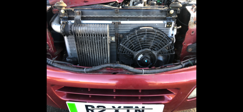

It turns out that the O Rings supplied by Advanced Radiators were shit. Those were replaced and it was holding the charge. Just the fan wasn't kicking in. The combination of WVO smell and the highly refined* diesel lump, along with occasional serpentine belt squeal meant that the burning smell was hard to pinpoint, initially.

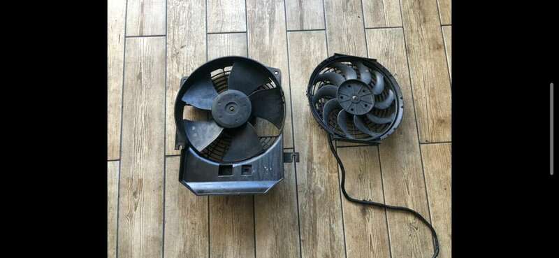

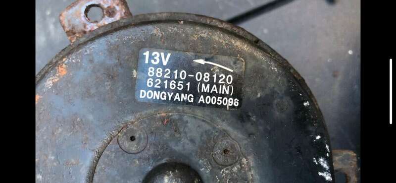

Satisfied it wasn’t the compressor, we had a good sniff about, then the whisps of smoke also assisted. A/C rad fan. It had seized up, through lack of use.
I reckoned I didn’t need to put 12v to it, to prove this.
Fortunately, I had some generic electric fan that I used to have fitted to the MR2 engine lid. As can be seen, it fitted the OE housing a treat, once the DONG WANG unit was evicted. Toyota and SsangYong plugs are even the same. I stuck it on and it kicked straight in.
A9373959-4F8A-4EAF-9FF4-DD215DB752A9.thumb.jpeg.98fcb7fd6ec2fccab2bbde6af432ed83.jpegC299CBE9-CE25-4D21-B96A-65CFAEF4EA45.thumb.jpeg.2fce796110b0bf541c60d1217c6f031d.jpeg93DD8D9B-B381-47C4-9825-70B63488DE8E.thumb.png.f30cd8ccfbb7eb9b2878058e88142cba.png
Happy days and cool cabins abound.

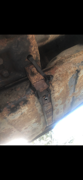

The fuel tank strap snapped – doesn’t really need this, IMO – I effected a top qualz repair, as see here
Carefulling
You can't beat a cable tie.

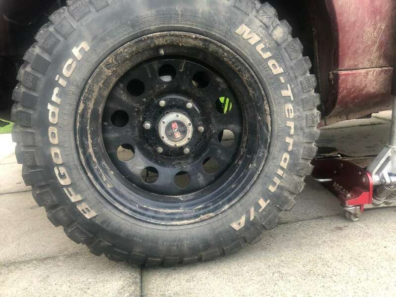

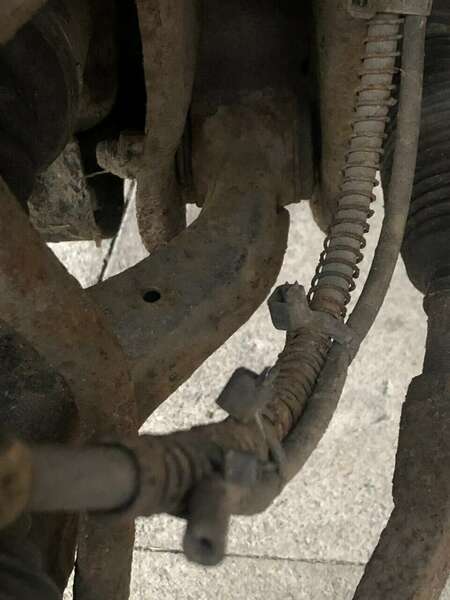

stuck some new handbrake cables on, as the 10 month old eBay jobshad seized on one side and they come as a single piece affair
treated it to 6 wheel nuts again on the OSF at the same time as doing a MURDERED OUT upgrade and banged it in for its MOT.
Before. Pah!
After. Max Mall Crawler points attained

Yeah, that handbrake design can get in the sea! One with standard drums on the rear would no doubt be a lot better.
Fuck knows why they tried to reinvent  the wheel.

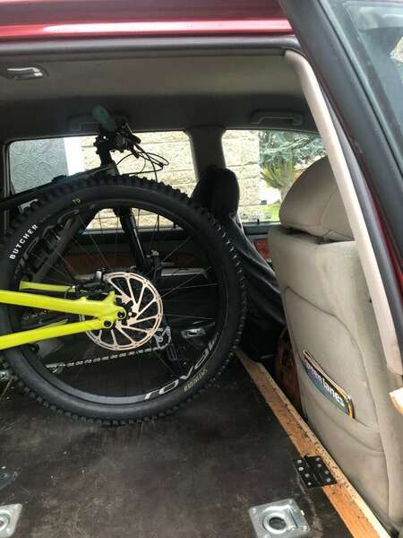

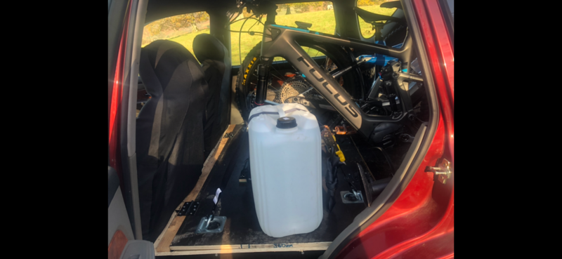

Didn't think my sexy new EMTB would fit inside of this. Certainly not without at least moving the fork mounts, given the wheelbase is longer and the bars are wider.
How naive! Fits great alongside my Jam2.
AA2B1027-B30B-4251-9847-589ABCE997FA.thumb.jpeg.4855dd76846cd4199bba4ea4a010dda1.jpeg94AA0505-D5CA-4F83-964A-0FE149BE7D23.thumb.jpeg.9f912ddaba83beb1e439d92a0eb1b3c6.jpeg
Those blessed with one of these beauties will be aware of how little room the tailgate actually takes up, when closed.
There's a shit load of room, still.

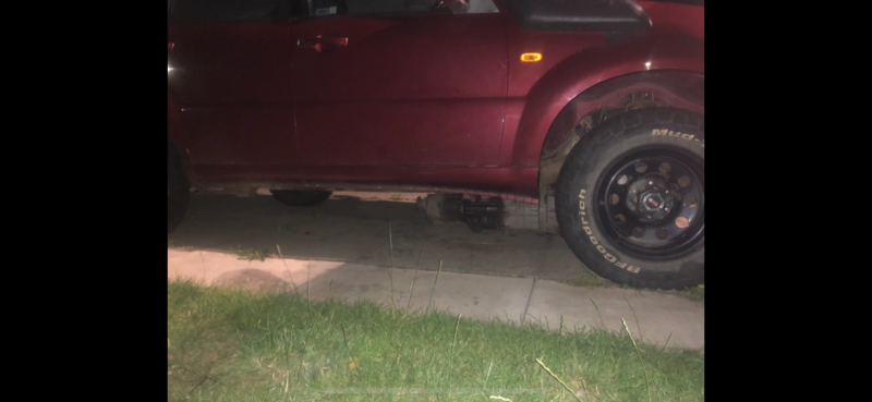

However, I haven't driven it since before December, as the wayward handling it developed was a bit too much.
Problem identified. 😂 Will be repaired before it is used again.
