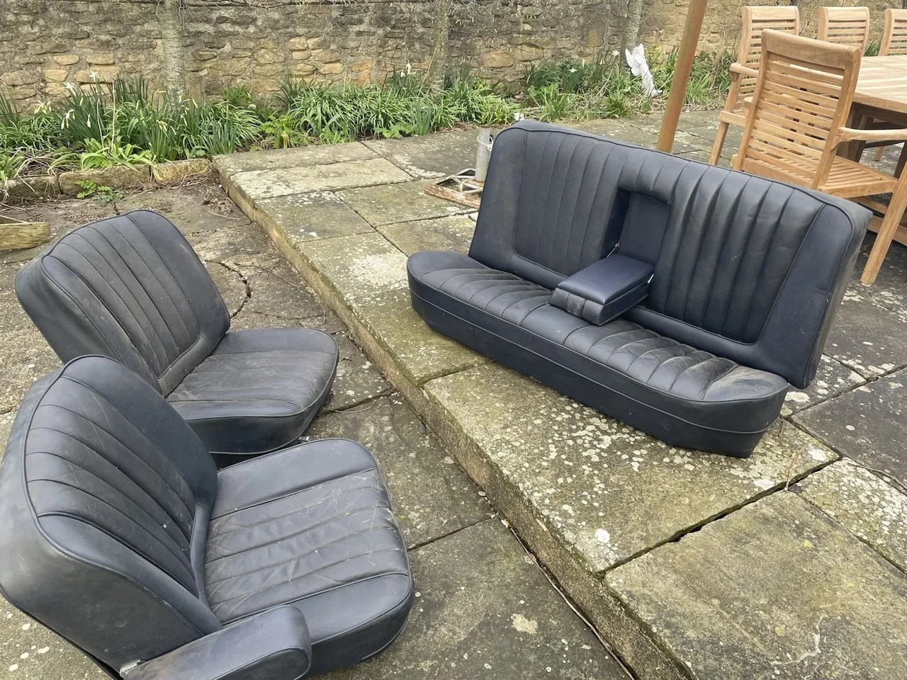

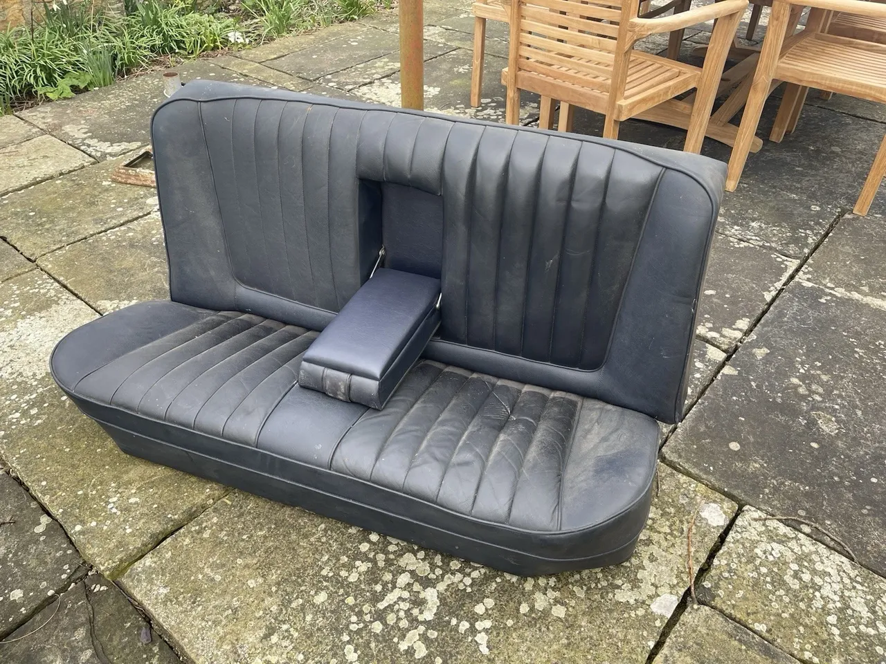

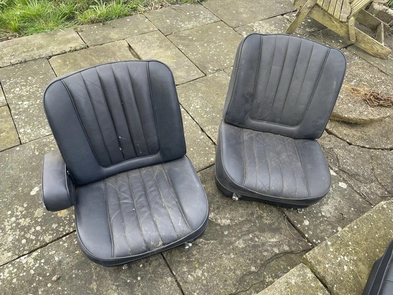

Seats have been sorted for what I think is a reasonable £115. Almost certainly a lot cheaper than even the materials to DIY a new set of covers and foam.
Not even that far away to collect. About an hour each way.
Listing says stored in a loft for years and apparently in very good condition. At least no tears like the one on this. Probably needs a good leather clean and feed to fully bring it back to life.

They look like they'll come round! Be even easier to do 4 or 5 rounds of leather feed too with them not in the car and in this nice weather! Let them sweat it in and absorb it before fitting
I remember an episode of Wheeler Dealers where they had a Maserati (?) with dry leather and they fed the seats, put them in black garbage bags and left them in the sun. After a couple rounds they were as good as new.

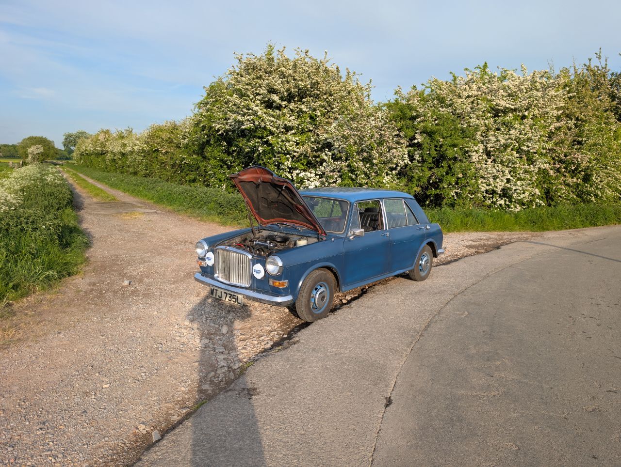

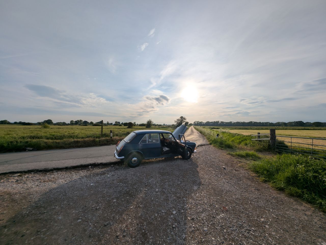

Oh no! Throttle cable has snapped.
funnily enough that happened the last time you drive a 1970's Automatic!
Need any help? Have you broken down anywhere near me?
Bodged the choke as the throttle by wrapping the remains of the old cable around the choke cable. 🤞
Home after that little adventure 😂
Sods law it broke. I've lost the little trunion thing that the choke cable goes into though 😒

Lower picture a definite calendar shot.

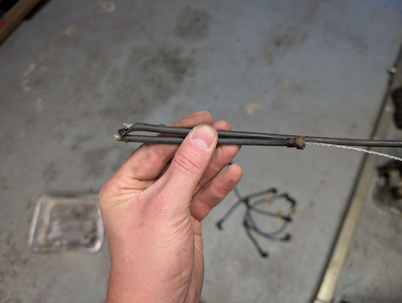

I can tell you that driving home using the choke control as a throttle is quite a weird experience! It was only a few miles so my bodge held up fine.

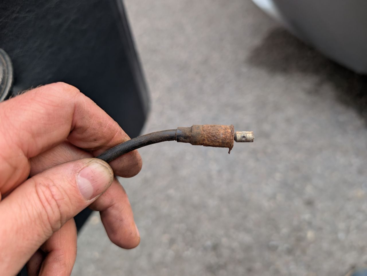

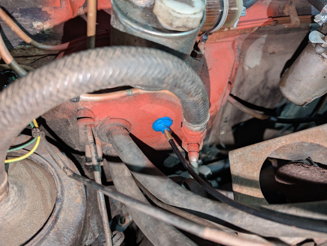

Actually it wasn't the throttle cable that snapped. It was the cable holder on the bulkhead had fatigued cracked off. Like Zel says, cars have a funny habit of being really reliable with previous owners and then crop up issues with new owners. I guess for me it's a combination of bad luck and maybe I'm a bit heavier on the accelerator pedal. This happened just as I was going over a hump backed bridge and I accelerated harder to go over. Maybe I hit the end stop a bit hard and the force between the pedal and bulkhead being squeezed was enough to snap it off?
This bit should be attached to the bulkhead and it's where the throttle cable slides into.
If I realised this was the issue, I would have not cut the cable. Tbh the cable sheath didn't have a whole lot of life left in it anyway. It's a nylon tube on this (rather than a coiled wire sheath) and it's just worn through enough that it pretty much snapped when flexing it.
I did try removing the cable from it but it promptly snapped off. As it's only plastic, drilling it out by hand was easy enough.

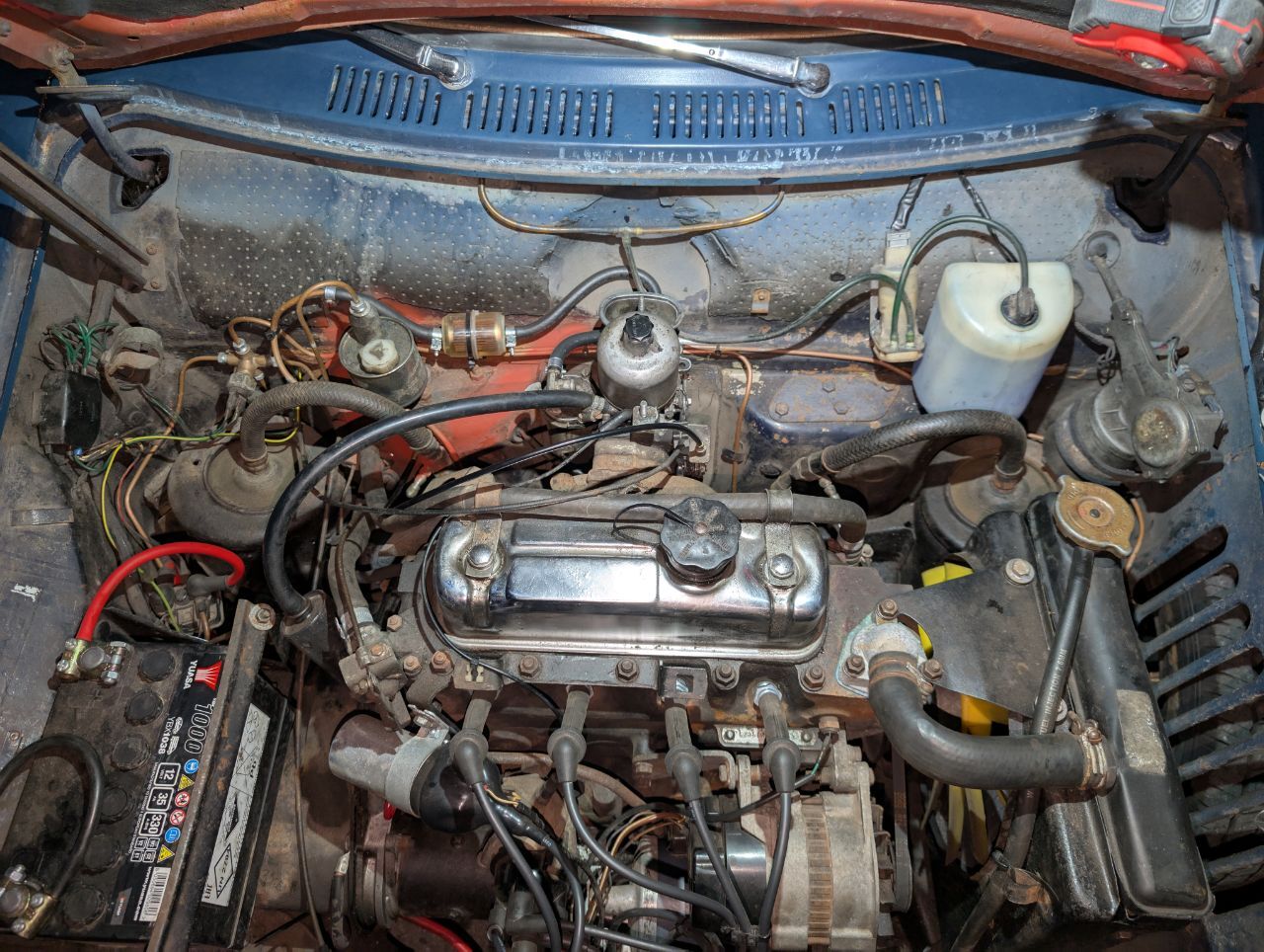

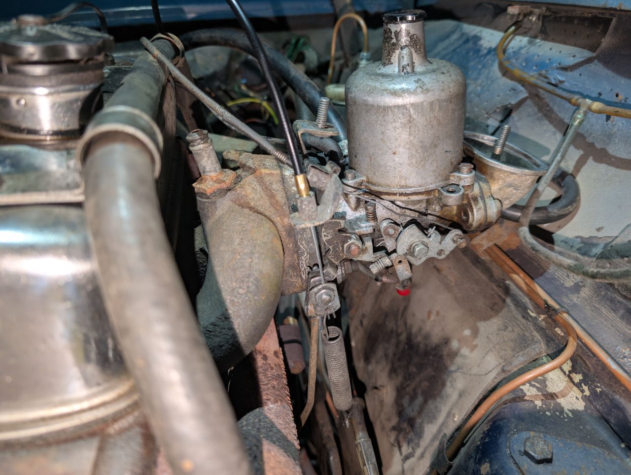

Throttle cable is a brand new Midget accelerator cable. Longer than the one that came off the car but fitted perfectly and tbh actually better. For £10 versus £25 for a 'proper' cable, I'll take that. Just I need to remember to buy a new one for the Midget when I get that far to finishing it...
On the carb end, it fits through this little trunion thing. I cleaned it up with carb cleaner before reinstalling the new cable through it.
Attaching to the carb linkage was the fiddlist part of the job. Not a whole lot of room for fingers in there! Air cleaner is removed for a bit more access.

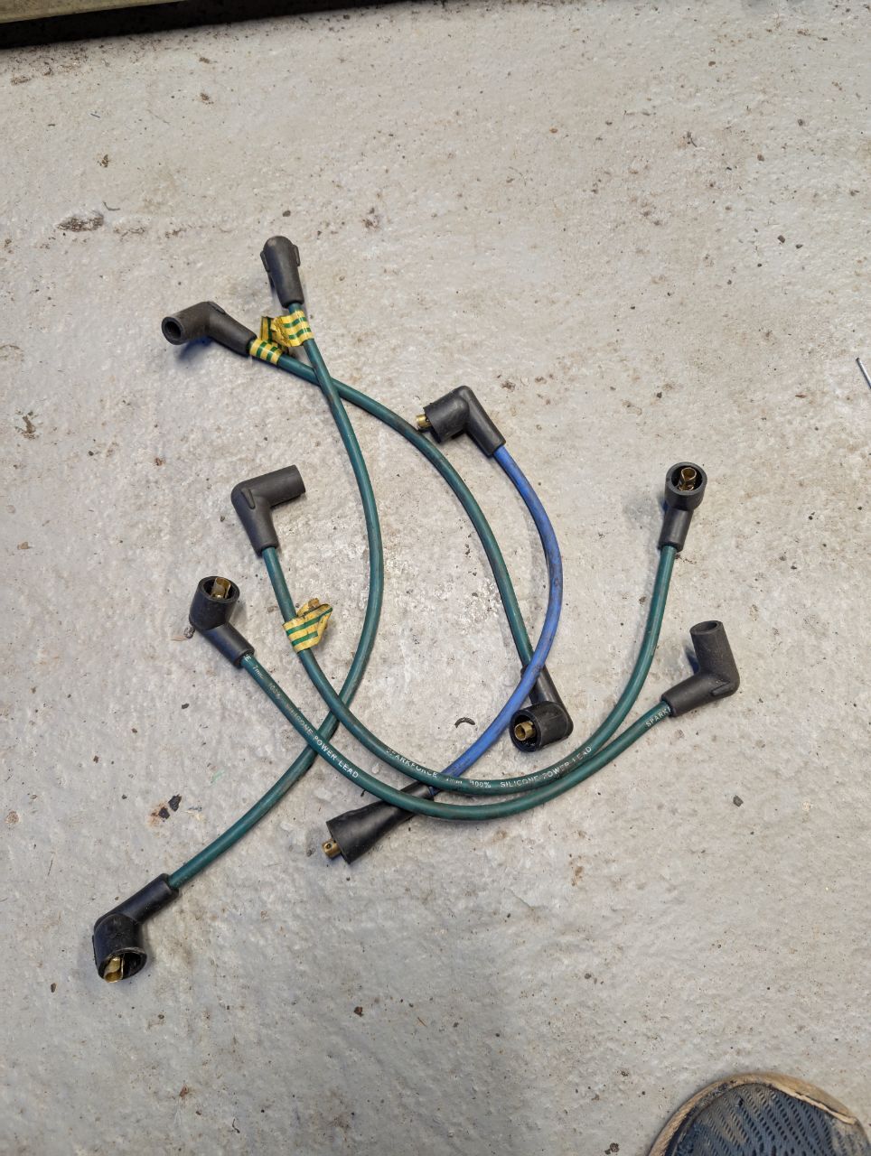

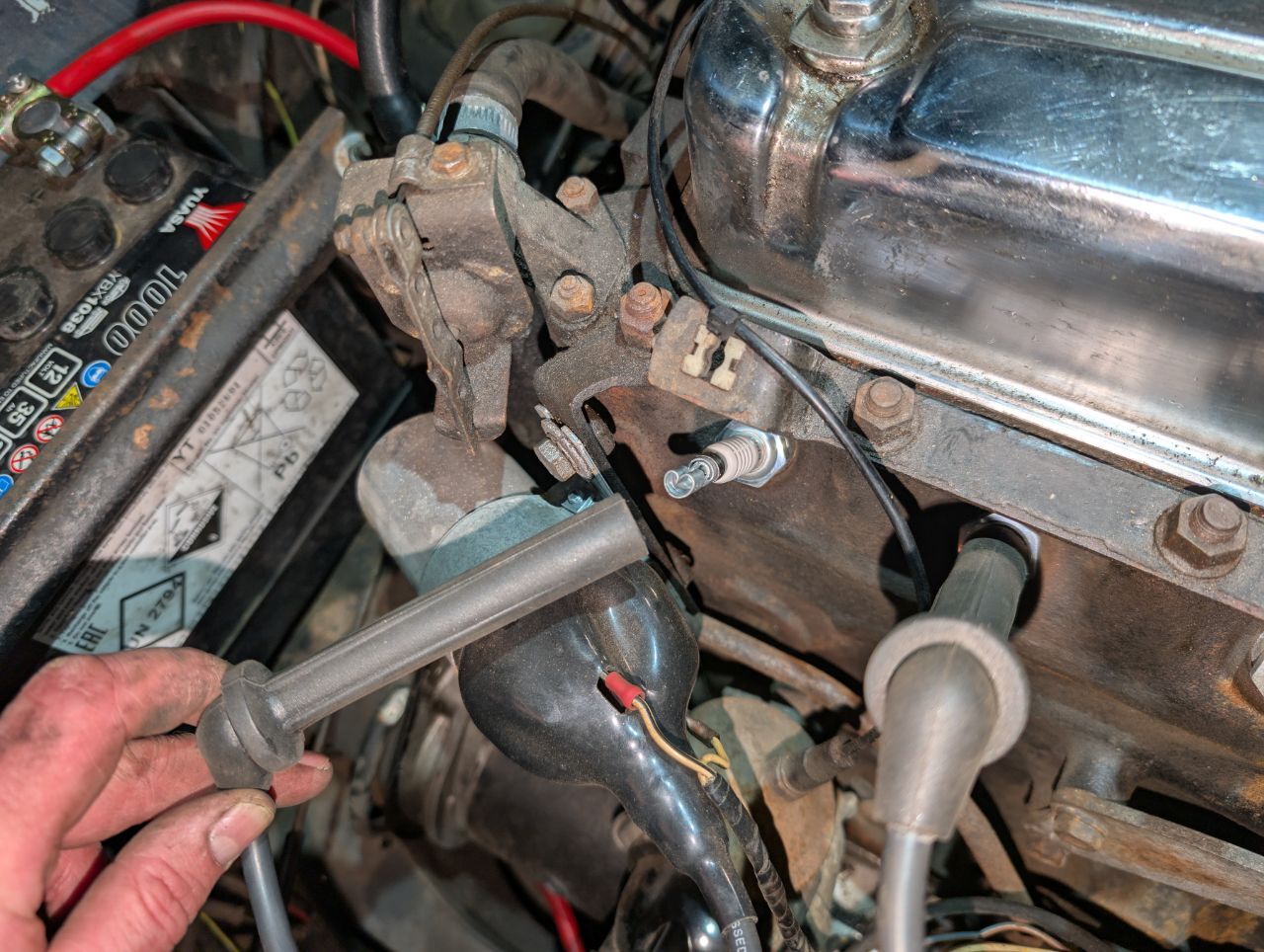

The plug leads on the VP were completely wrong and looked like for some sort of OHC engined vehicle. While they worked, they just looked wrong. They're from before Andy's ownership and probably been on there for years!
When removing the leads, cylinder 1 had the crimp come adrift from the cable. Maybe this poor connection was causing the occasional stumble I got at idle when it arrived?
Looks a bit more right with these on. Runs perfectly too.

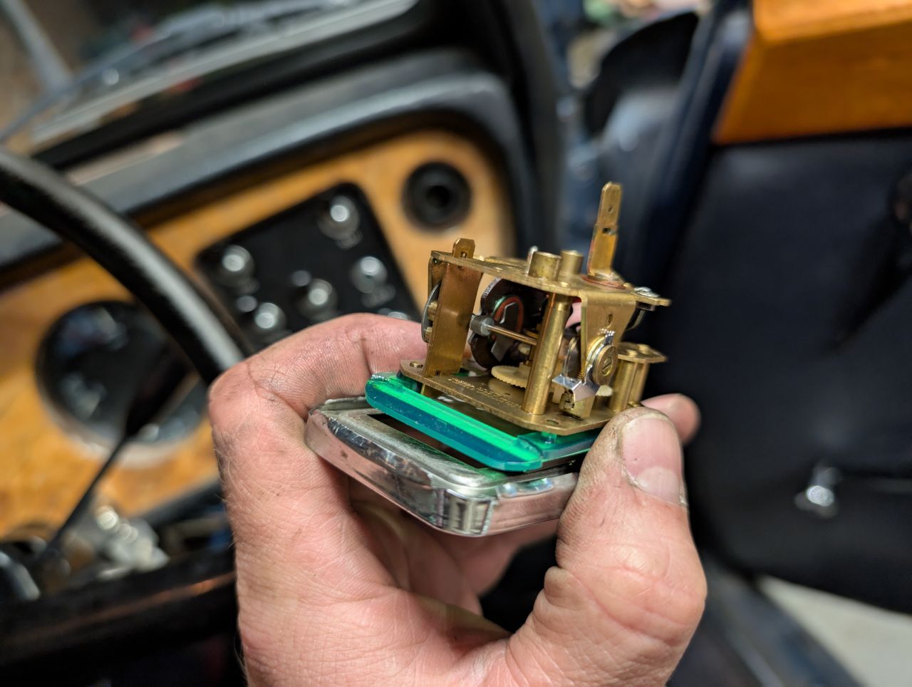

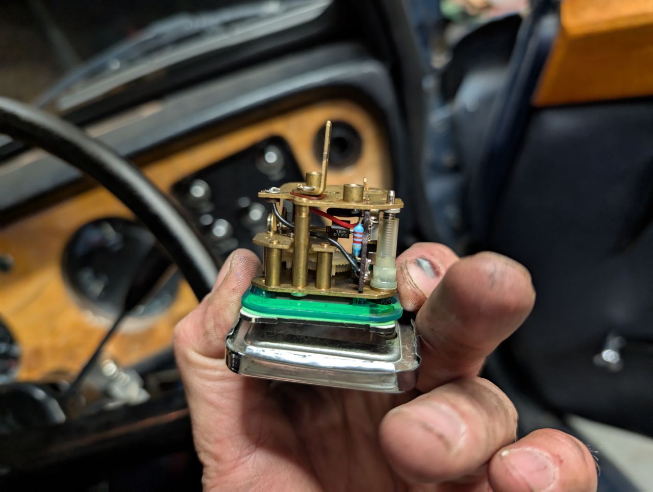

Clock doesn't work. Screws are missing from the back so someone else has been in there before me. Power is definitely getting to it - I found that out as I caught the positive spade on the negative body of the clock creating a spark! 😅
My suspicion is either the transistor or capacitor is dead. Not much else it can be! Quite a neat little design. Basically presumably a little RC circuit that pulses a coil on occasion. This moves an arm with magnets on which powers a winding circuit of the mechanical clock. Basically 70s technology to get around that quartz clocks weren't affordable/invented then.
I'll come back to this clock later as it's going to need a bit of fine handed work to not damage anything. The garage isn't the best place to do that.
Not sure what this transistor is yet (haven't looked) but I imagine a common garden NPN or PNP will drop right in. Capacitor value might not even matter that much either.

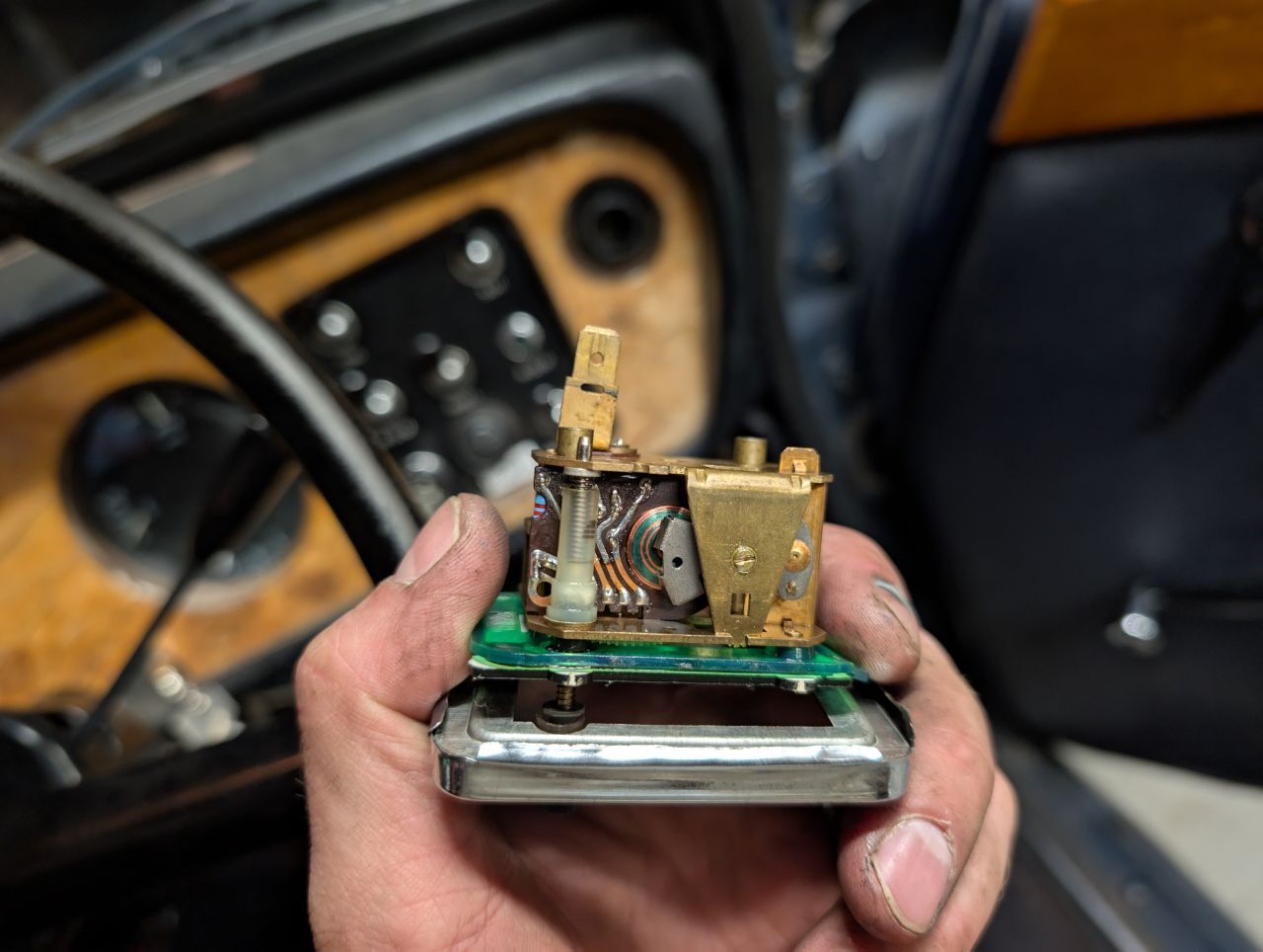

The switch contacts on these stalks can easily be got at by unscrewing the cap on the end. Contacts were clean and looked perfectly fine.
I removed the column cowling in the expectation of removing the stalk in case a wire had broken to the end. Following the wiring down I thought best to check at the connector.
First thing I noticed was some of the contacts had come adrift. Unfortunately not the horn connections but useful to see and fix nonetheless. I think they might be for indicators.
Bending the tab up on the terminal and pushing it back in gave a reassuring click. Now holds in place when you push the two halves together.
Checking the connection on the connector end found the stalk worked perfectly.
