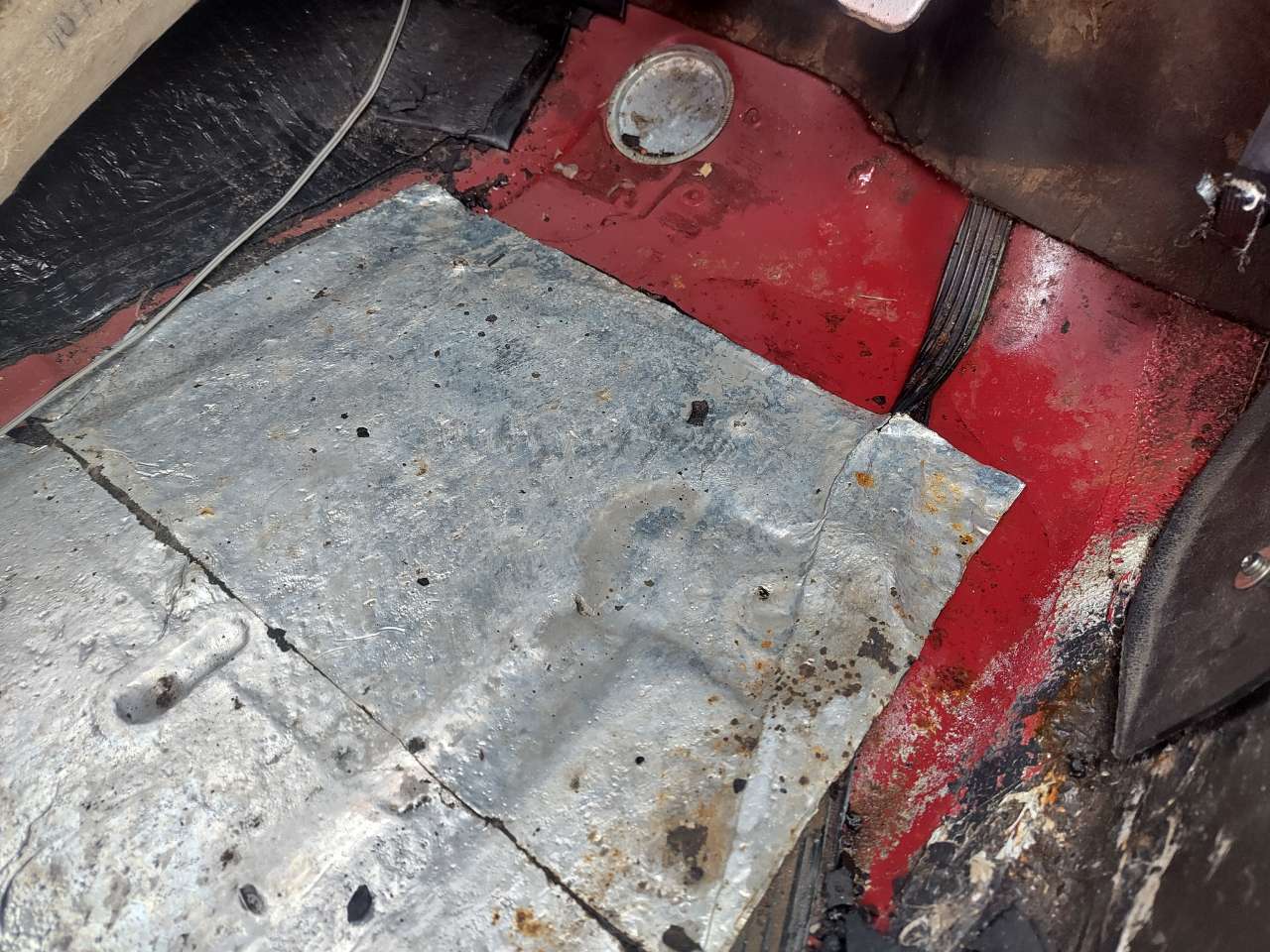

Sunny Jim Posted December 29, 2024 Author Posted December 29, 2024 I've now had this a year and still love it - no intention of moving it on any time soon. A week or so ago I noticed the driver's side footwell carpet was soggy after some heavy rain (where I usually park it slopes slightly to the right so any water getting in was going to end up there). There was some sealant in the corners of the windscreen seal but it was pretty old and flaky so I raked it out and applied a bead of sikaflex all the way across the bottom of the screen and up the sides. Fortunately I'd left the carpet up to dry out because after the next lot of heavy rain I was greeted by this: Smell and a quick taste confirmed it was fresh water so it definitely wasn't coolant from a leaky heater matrix so I ruled that out. The only other way it could be getting in is through the scuttle air intake. To prove my theory I taped up the grill and sure enough it stayed dry in spite of the heavy rain we've had. So my question is, how do I go about sorting this? Are there any drains that need rodding? Am I going to have to remove the dash for access or can I get at it from the engine compartment? Have any of the other C15 owners on the forum had a similar problem and how did you go about rectifying it? @lesapandre @holbeck @Mrs6C @dean36014 @Frogchod any help or advice gratefully received. TIA, Jim. Jim Bell, JMotor and grogee 3
Stinkwheel Posted December 29, 2024 Posted December 29, 2024 Never owned a C15 button previous (rusty) Visa’s have found when water is getting in to the footwell it has usually been small corrosion holes in the bulkhead. Although I’d be surprised if your nice van has that sort of rust. But those bulkhead sound insulator padding things can hide stuff very well Sunny Jim 1
lesapandre Posted December 29, 2024 Posted December 29, 2024 Water sloshes around in the heater fresh air intake. Mine does but no water comes in so I've not worried. Possibly has a drain somewhere. I'm not sure. If your heater motor is still working its a miracle and they are hard to find. Try parking it the other way around might help - or just putting something over the intake when not using it. It will require a long-term fix as the enemy of these is RUST. Sunny Jim 1
Sunny Jim Posted December 29, 2024 Author Posted December 29, 2024 I tend to park it the same way round as it's convenient for getting the dog in and out of the back. So far I've been re-applying the tape but I could get some magnetic signs to go over the grilles. Long term I need to sort it properly but I'm not sure I'm brave enough to take the dash out at the moment. lesapandre 1
somewhatfoolish Posted December 29, 2024 Posted December 29, 2024 Maybe try and take a picture through the grill with a mobile or invest* the price of a pint in a cheapo endoscope and have a look with that? It may reveal something that's pokeable with a bit of wire etc. lesapandre, Westbay, Coprolalia and 1 other 2 1 1
lesapandre Posted December 29, 2024 Posted December 29, 2024 Mines been doing it for years. Only really happens to notice when I jetwash it. I'd do a workaround until the weather gets better. Amazing vehicles IMHO - more like a Swiss Army Knife than a van - all over France still and they are now being restored professionally so they have a 2nd life. Mine made a 300 mile trip recently no sweat. Sunny Jim 1
Westbay Posted December 29, 2024 Posted December 29, 2024 drain Not your model but could be a good 'starter for ten' ... Sunny Jim 1
dean36014 Posted December 29, 2024 Posted December 29, 2024 There is a drain tube in that area. If you unbolt the ecu's out the way you can gain access to the bulkhead area and the drain is in the centre if i rememberrightly. The drain tube just comes out behind the engine area. Sunny Jim and lesapandre 2

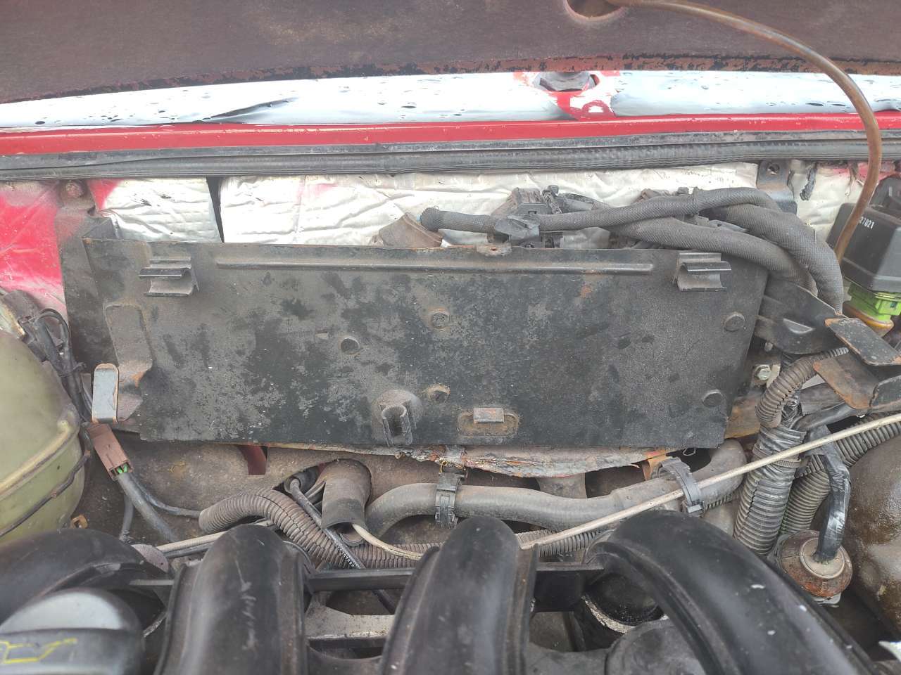

Mrs6C Posted December 29, 2024 Posted December 29, 2024 WHS ^^^ Just had a look at mine. There is a central drain tube running down the rear of the engine bay, from the middle of the bulkhead, as marked below: Access to the top of this is gained by removing the scuttle cover, on which the jack and jack handle are mounted: The scuttle is held on by four bolts (marked below). These can be found in the two brackets that hold the jack in place, two on each side. The bottom bolt heads are a bit crusty on my example, so for now I didn't take these out to illustrate the area behind, but that is where you will find the drain hole into the pipe. Give it a good clean and the water should start draining again. HillmanImp, Jim Bell, somewhatfoolish and 2 others 2 3
