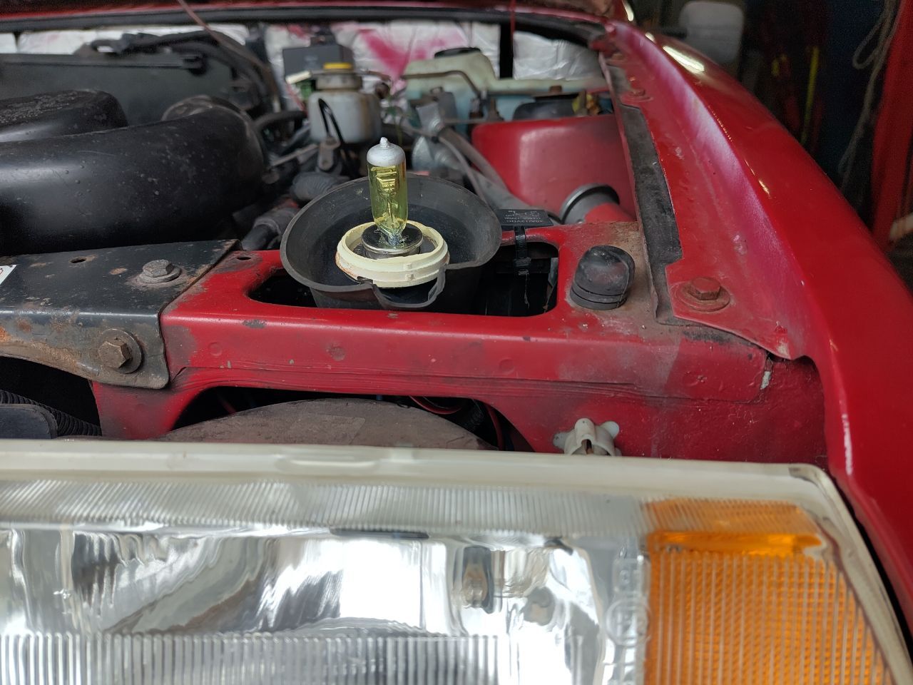

Got a couple of jobs done this afternoon. After a bulb went and I couldn't get hold of a yellow bulb I've been running one yellow and one white. Back to both yellow for maximum Frenchness.

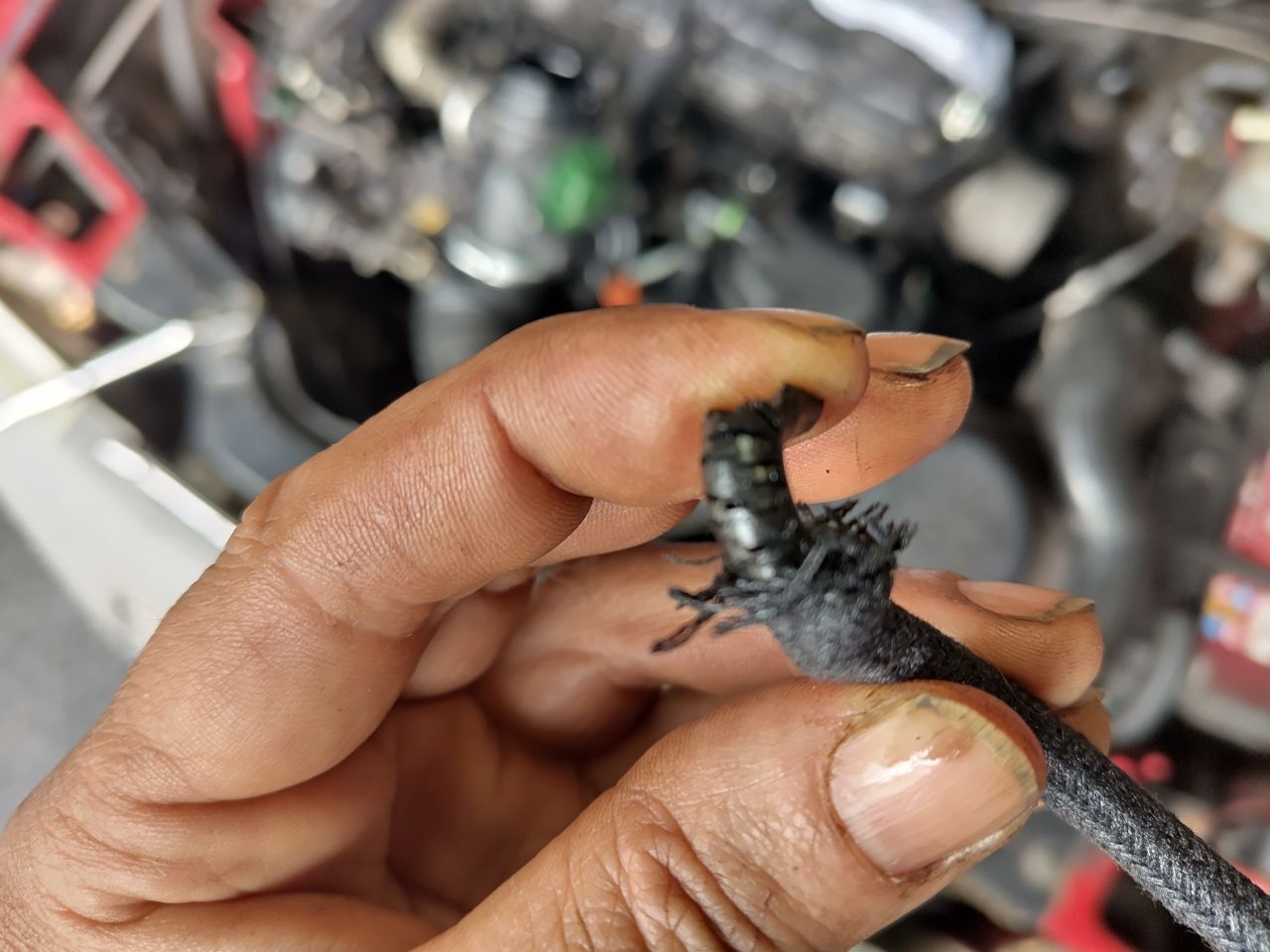

Next I replaced one of the leak-off pipes. FUBARed after only a few months.
Hopefully the Halfords pipe I've been recommended will last longer. I'm a dab hand at removing the intake fanimold now with all the practise I've been having.

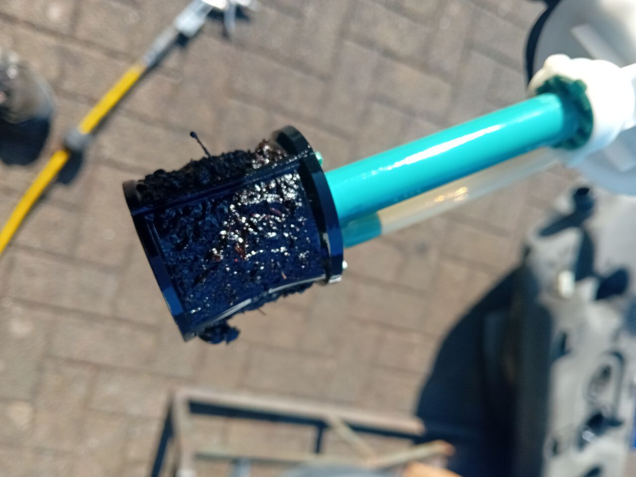

Van was not happy with anything less than half a tank of diesel. Thinking that possibly the fuel pickup pipe might have a crack in it I remove it.
Looks like the pump might have been struggling to draw anything through this.
It's an organic matter that grows in diesel fuel. Boats laid up suffer from it particularly. Also if the van has been run on veg oil in the past. Clean it down and job should be a goodun.
Run the tank right down and replenish with fresh diesel.
There are inhibitor biocides to go in the fuel if it really persists.

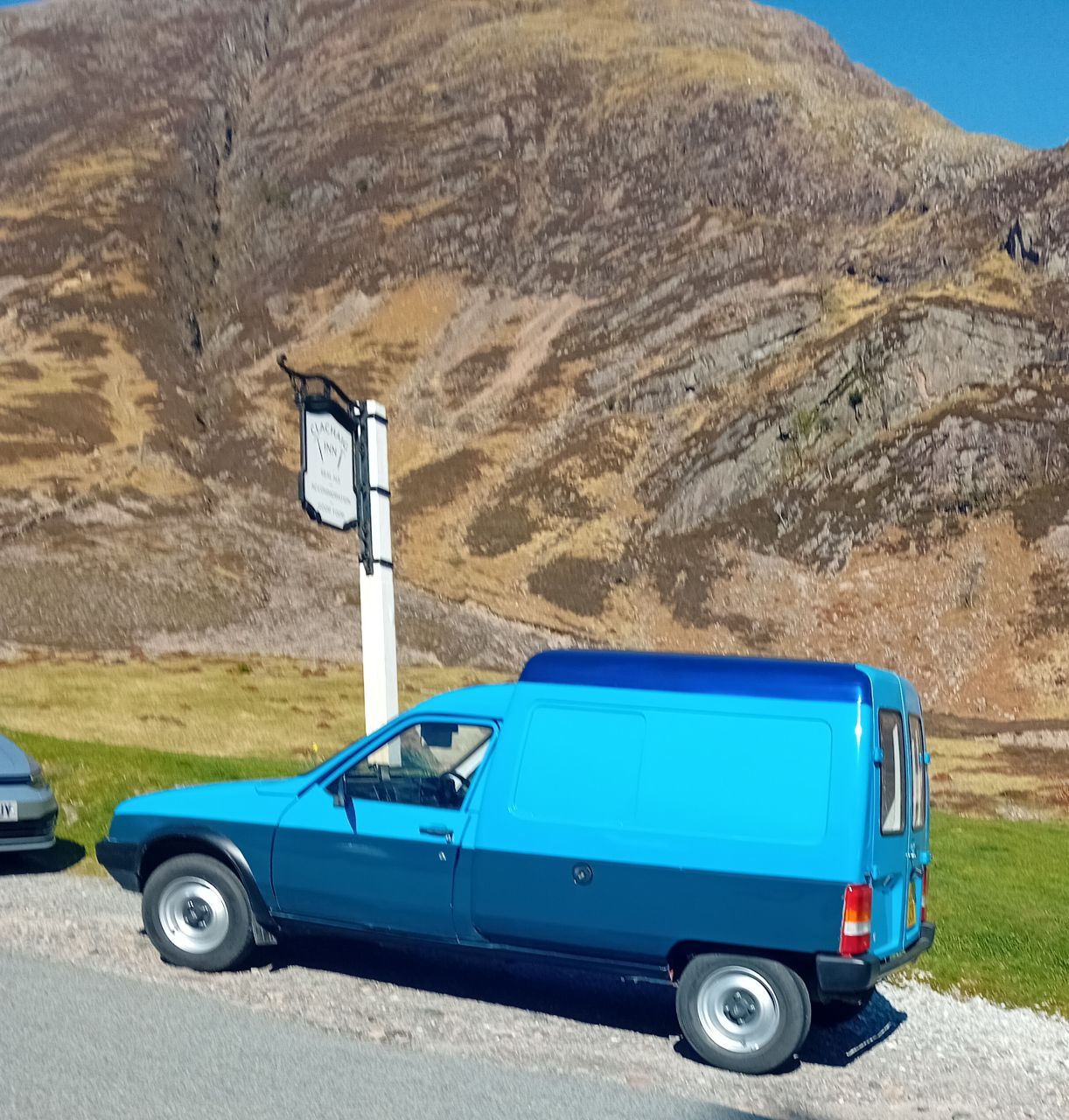

52 minutes ago, Frogchod said:

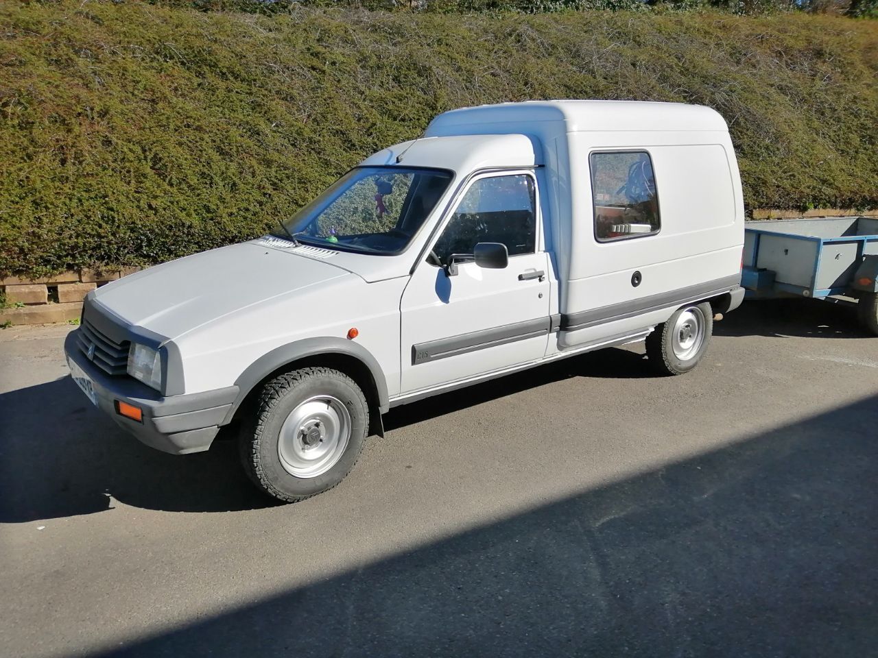

Immaculate C15 spotted today 😊
That looks like it might even have TRX metric tyres and wheels on it!!!!
My old visa Super E had metric factory alloys

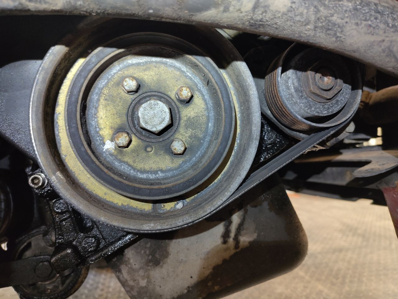

Finally got round to tightening the aux belt that occasionally squeaks on starting today.
It's looking a bit oily, better add cleaning the engine and working out where it's coming from to the jobs list.
Worth getting a spare belt. They do squeak and then fail. Not sure which engine you have but on the earlier ones it's an easy roadside change if it snaps.
I found that out last year in the middle of the French countryside. 😂

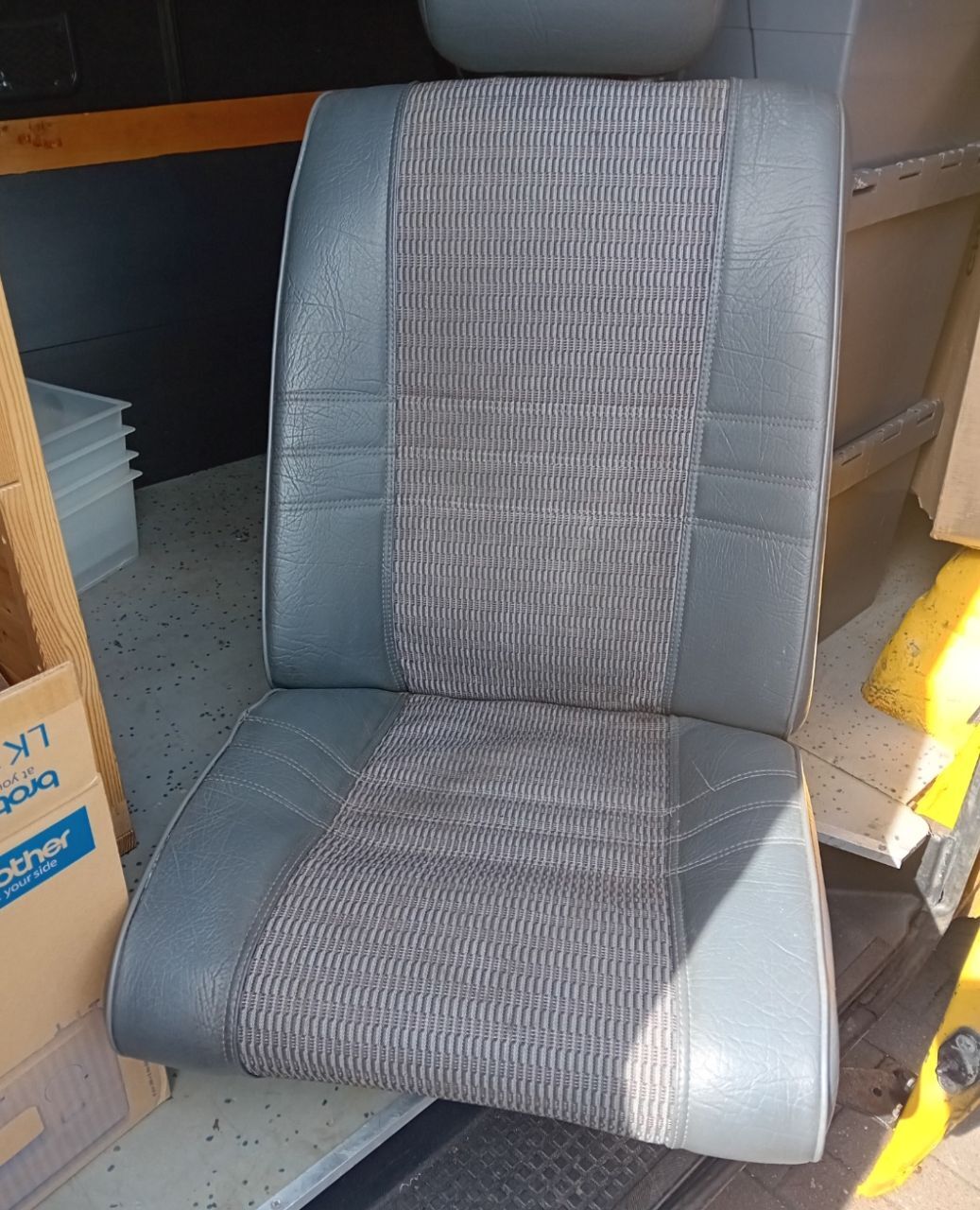

On 29/04/2025 at 15:38, doug said:
Passenger seat free to collect. Also fits the drivers side. Near Ayr.Screenshot_20250429_153732_Gallery.jpg.7f841db4d36341e6f47a898033da2694.jpg
A seat with uncracked vinyl is a rare find!
After having trouble getting a belt in time when one snapped just before the MOT last year I always carry a spare. My engine's a DW8 so I could only change the belt at the roadside if I had a 40 torx bit and a 22mm spanner for the adjuster...

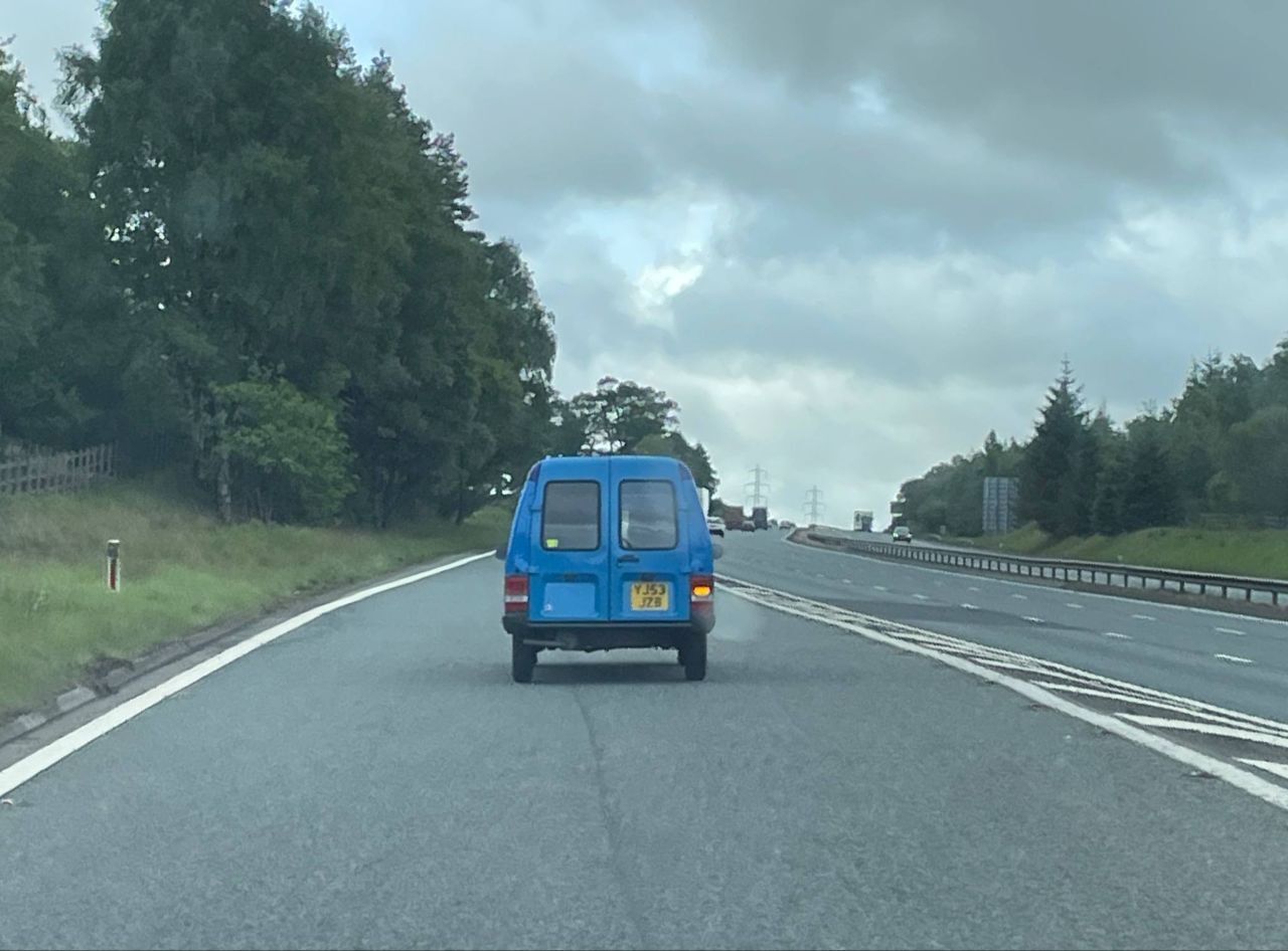

12 minutes ago, captain_70s said:
Spotted on the M74.
Messenger_creation_BE6F5152-24E3-4535-B115-B2756FEABB92.jpeg.804e7e556c2a66c765ef24b21fed748d.jpeg
Me! At the Moffat junction?
Bit further up I think, near Cairn Lodge services. I thought I recognised the two tone!
You were following a new Porsche 911 up the slip road, which spent the next 40 miles failing to hold a steady speed in the middle lane. 🙄
That must have been in the morning heading south. I remember the Porsche as well! I couldn't keep up with it , didn't stop me trying though.

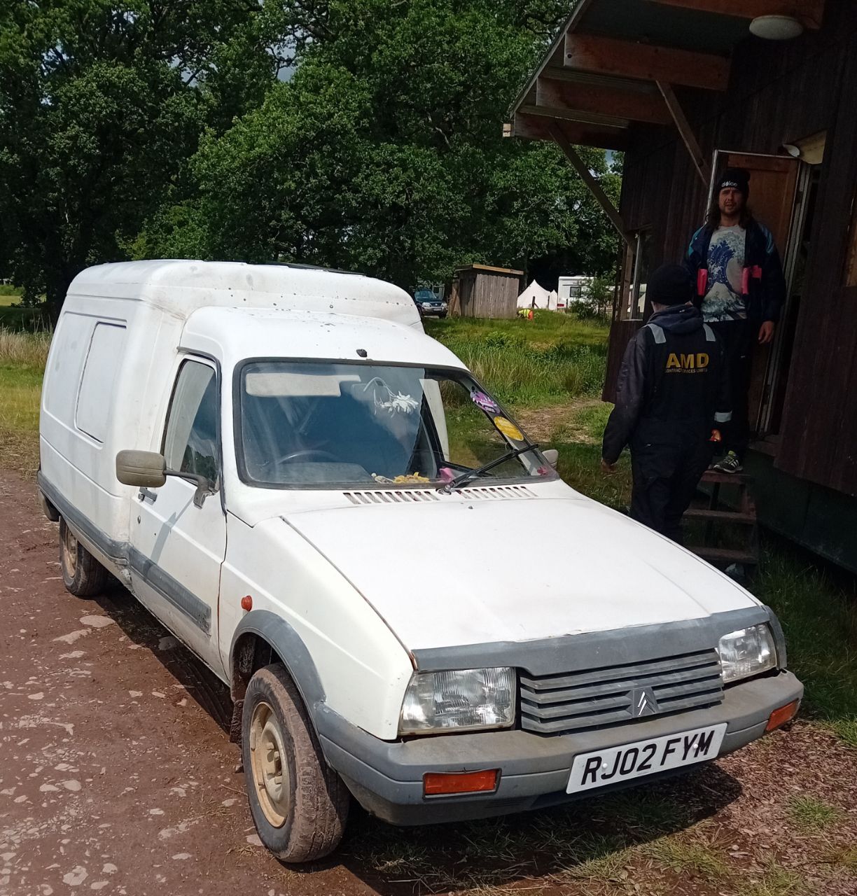

Jeez getting common as muck these. Spotted another one at Eden. This one in much better condition.
This popped up in my photo memory thing from last years Eden Festival. Reg very close to the above pic from this year. Interesting fact that.IMG-20250617-WA0002.jpg.46735fdd8f96d3f17f21c20140ce1ece.jpg
