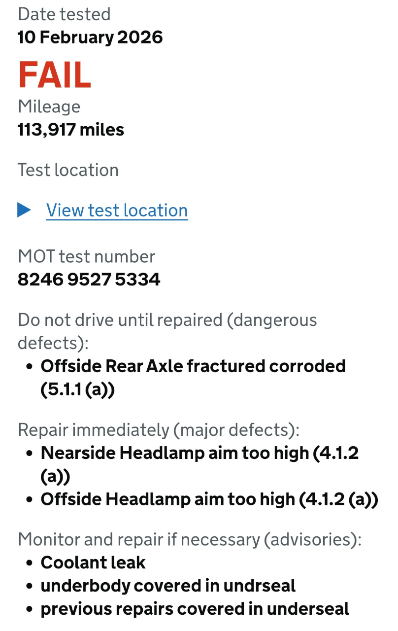

Bugger, I had planned on using it to go to Derbyshire this weekend to visit my Dad.

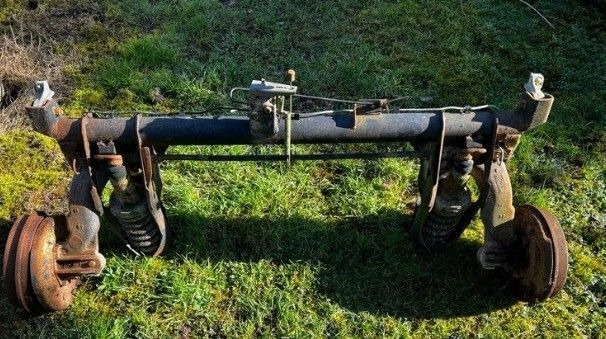

I do have a used axel in the shed but I'd have to check the condition.
Garage are quoting £650 to weld it up. It's a question of what state the one in the shed is and how much it would cost to swap everything over.
If all the bolts come loose it's just like dropping a classic mini subframe. It's not a hard job, just time consuming.
Sounds a lot. Do you have a picture?
Where has it fractured?

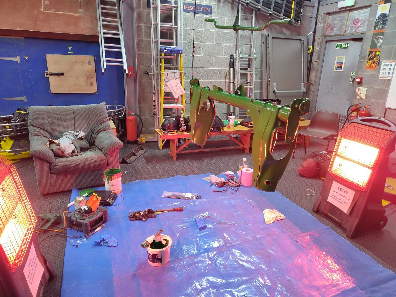

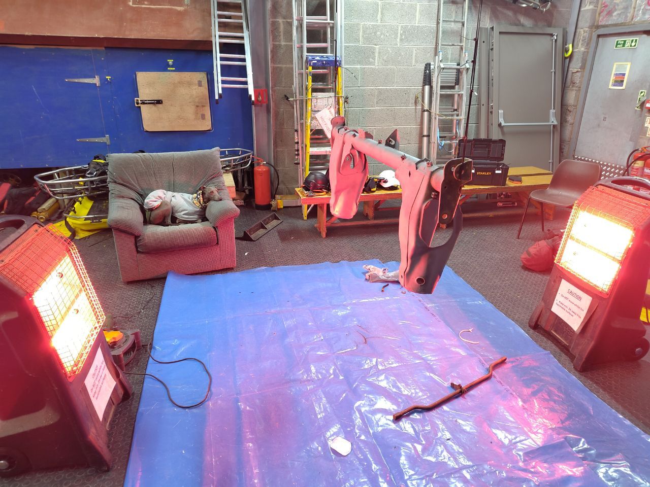

The axle I had in the shed is in better condition than I remembered it being and having taken it to the garage for them to have a look at on my way into work this morning we've agreed to use it rather than weld up the old one.
I'm going to attack it with a wire brush and see how many coats of paint I can get on it this evening after work before I get hungry and have to go home.
Behold an axle of finest green...
It's had two coats of two pack epoxy which was the quickest drying suitable paint I had in the shed. Both the dog and I are hungry so that'll have to do.
