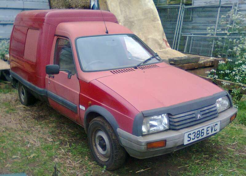

In 2013 I bought a red 1998 C15D van. It had run out of MOT but I was told getting a new one would just be a formality.  I was looking forward to getting it and giving it a good polish. Guess what, it was a very rusty van and repairs would have cost twice its value. I was given my money back but I was still disappointed not to get the red van.
Given their propensity to rust I guess Norwegian winters might have been too much for them.

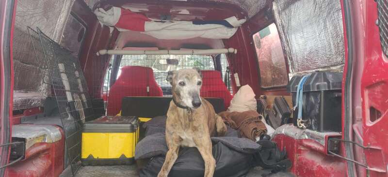

It won't surprise anyone that this is what I mainly transport in mine.
Yup, dog in mog!

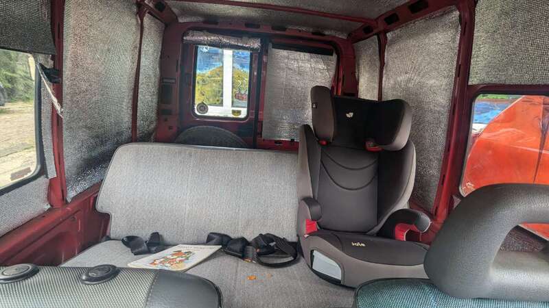

Also seats
And sleeping children
And once or twice a sleeping loserone PXL_20230705_201540601.thumb.jpg.8565c80db2685706f00d96eeb4103455.jpg

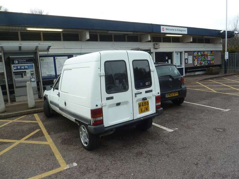

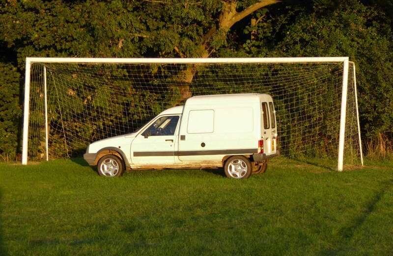

I still was on the lookout for a C15 van and 18 months after the red C15 disappointment I bid on a white 2000 (W) C15D and won it on eBay.
The problem was I was very busy and did not have time to collect it from somewhere near Stoke On Trent. Then @Lankytim put up a wanted advert to say he needed to buy a car as a short term stop gap while his car was worked on so I messaged. I said I had nothing to sell him but if he collected our new C15D that was only about 10 miles away from him he could keep it and use it until his car was repaired. If I remember correctly he fixed the drivers window winder that did not work for us. In due course Tim met me at Kidsgrove Station and I got our white C15D that we have had for 10 years now.

I remember! Thanks for the loan, the throttle cable also had a load of slack meaning it only got around 50% throttle making it extremely slow… soon fixed making it just slow.

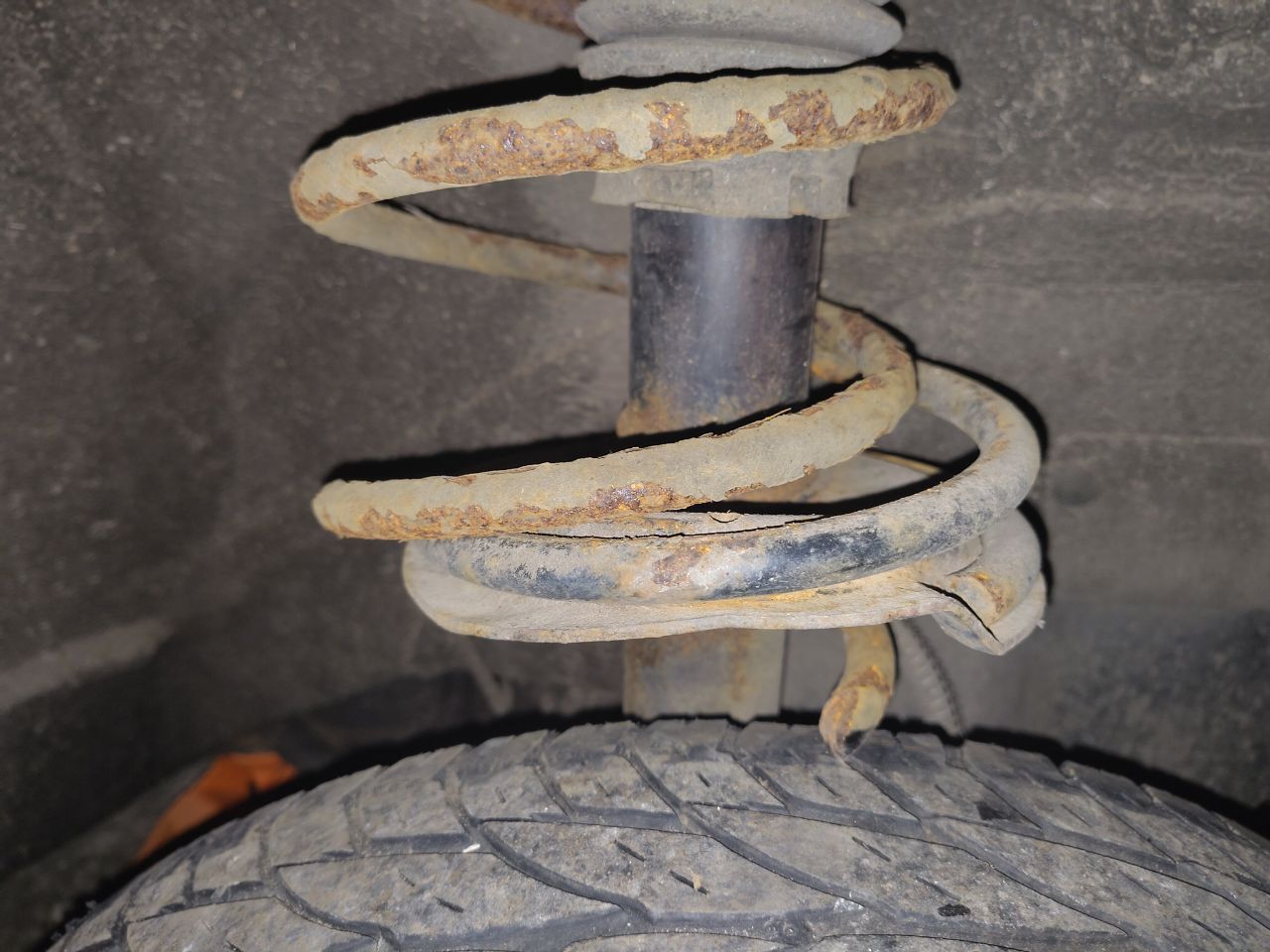

I went to check mine this evening as I was supposed to be using it again from tomorrow.

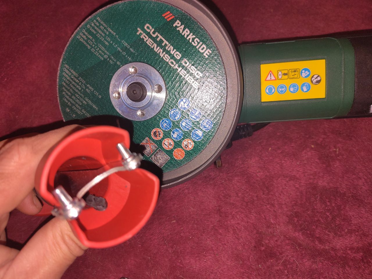

It's been parked up for 6 weeks since I bought the hearse and at first I thought a brake was sticking on but as soon as I put some lock on it was clear something else was amiss. New Parkside grinder to the rescue - I like the way the spanner is stored in the handle - perhaps that'll make it harder to lose.
Cut the spring back from where it was rubbing on the tyre so I could move the van from where it was blocking the lane.
Unfortunately it now rubs on the sidewall of the tyre if I apply too much lock. I'll have to drive it down the lane as there's no way a recovery truck would get up here so I'll cut more away but that's a problem for tomorrow when it's light and hopefully warmer. I don't have any spring compressors and would not be confident using them unsupervised so I'll probably farm the job out to my trusted local garage.

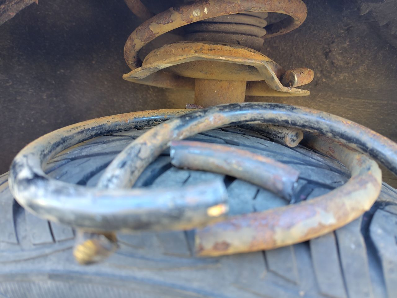

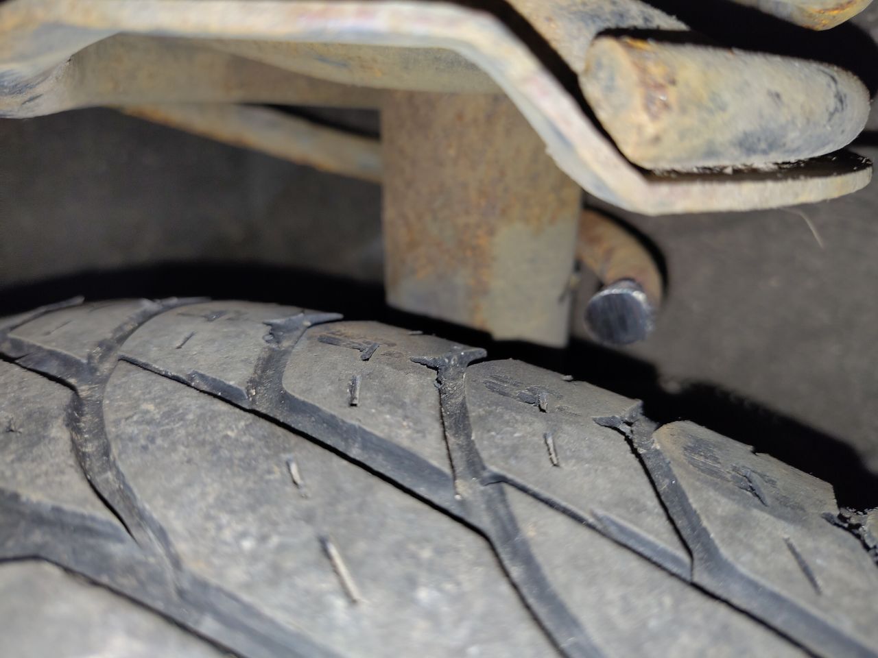

Careful cutting with the grinder and precision hammering got the cut spring back into the cup.
I showed the above picture to my mechanic when I booked it in and as the garage is only 1.5 miles away he said if I'm careful I should be able to drive it there.
It is sitting at a rather jaunty angle but seeing as I'd have to drive it down the lane anyway to be recovered I guess I might as well go for it - what do folks reckon?
  • Like 8
Hard to see at that angle but is there an opportunity for a strategically placed cable tie or two? Just to stop things shifting too far if there’s now not a huge amount of compression stopping the spring from coming loose and dancing around the strut like some sort of epileptic pole dancer.
Cracking idea that @mk2_craig, anything which reduces the likelihood of it coming adrift and possibly taking out the tyre or something worse with it has got to be a good thing.
Take it slow slow, should be fine (legal disclaimer to follow...)
And avoid uneven road surfaces, ah...
It should be fine. I've seen people deliberately cut that much off springs as a form of ghetto lowering then drive around for years.
The main issue will be the imbalance, it will probably pull dramatically to one side, so slowly and carefully is definitely the way.
Or just cut all the other springs to match and enjoy the slammed lyf yo!*
* Don't.
